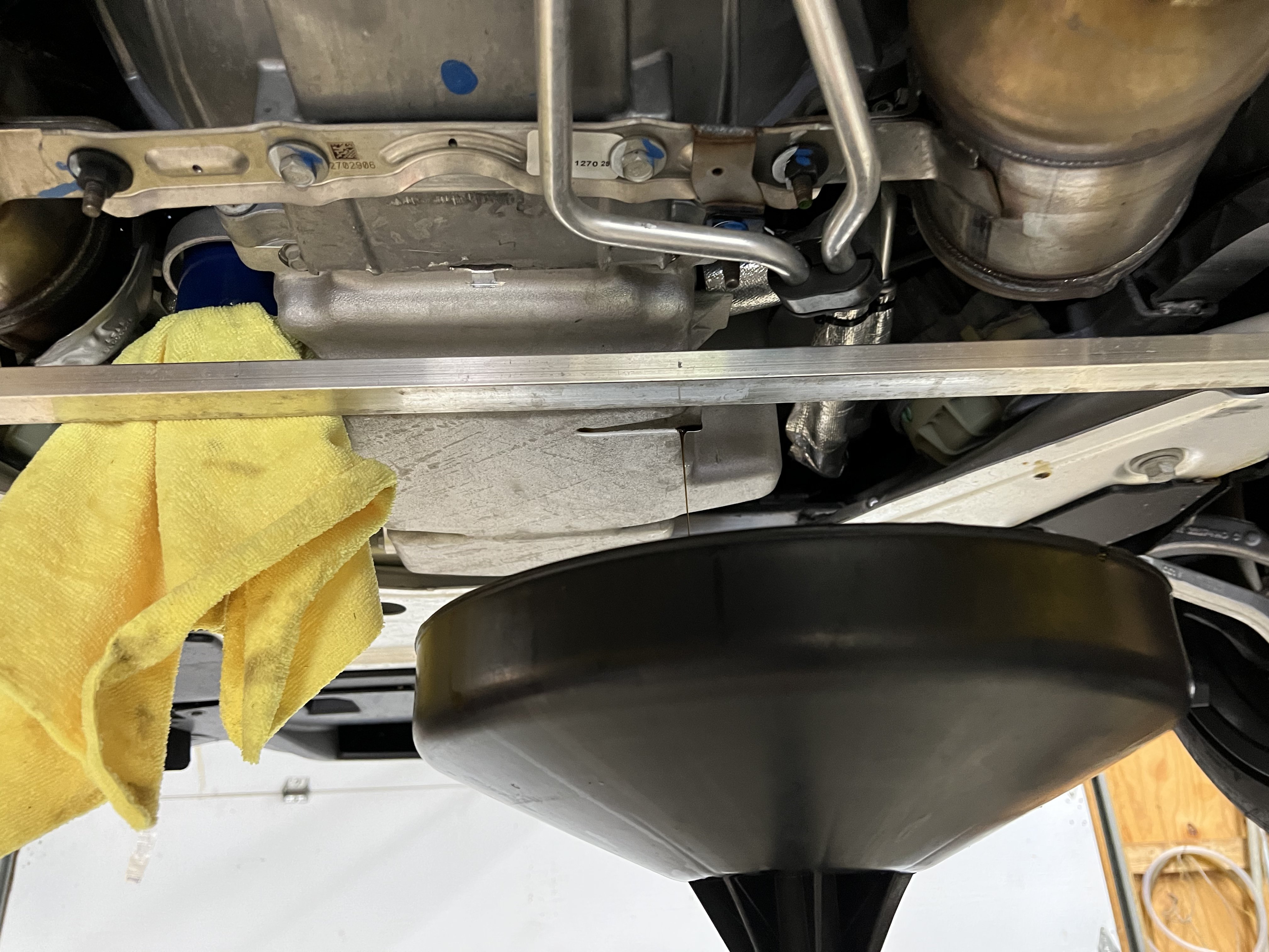

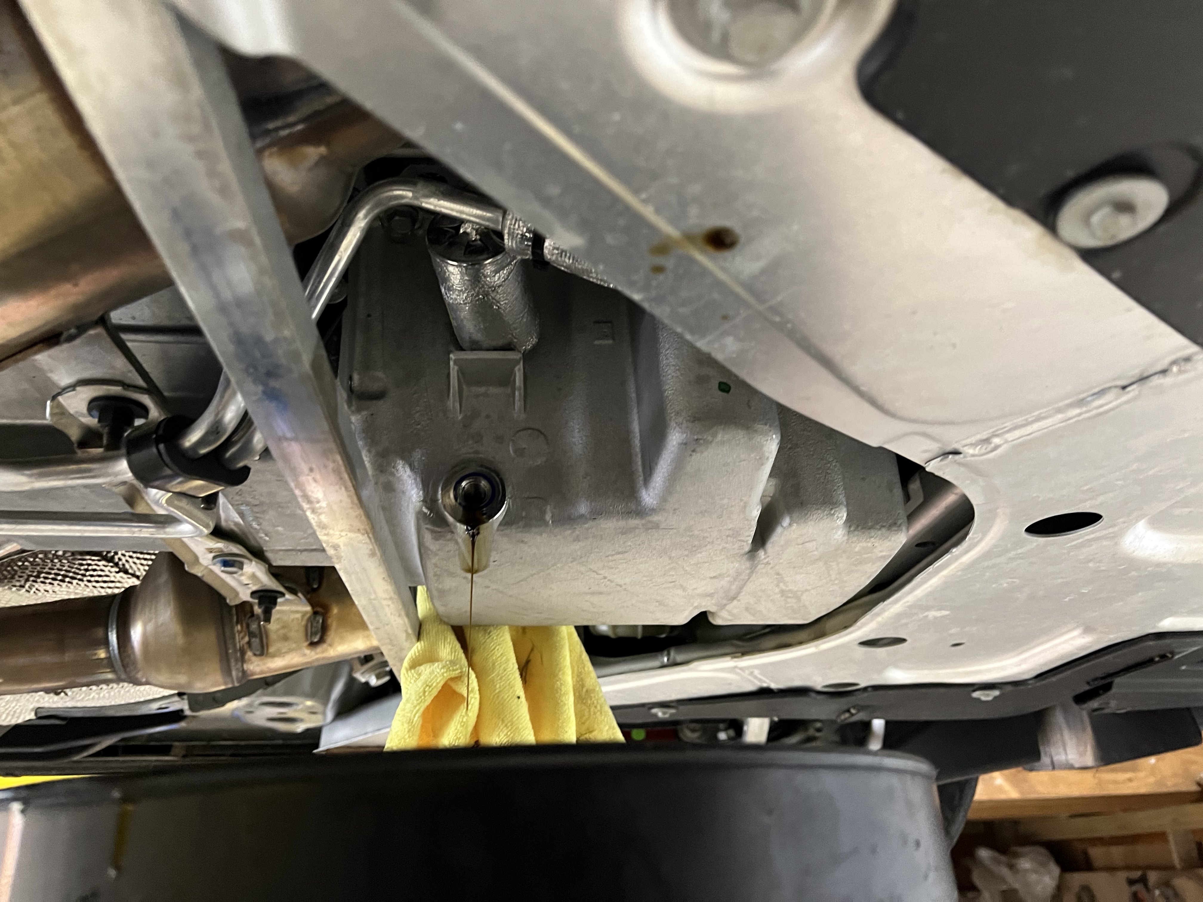

Oil change was pretty simple. I’m a little surprised the filter and drain plug are uncovered and open. The BW does have a helluva front skid plate I’ve noticed.

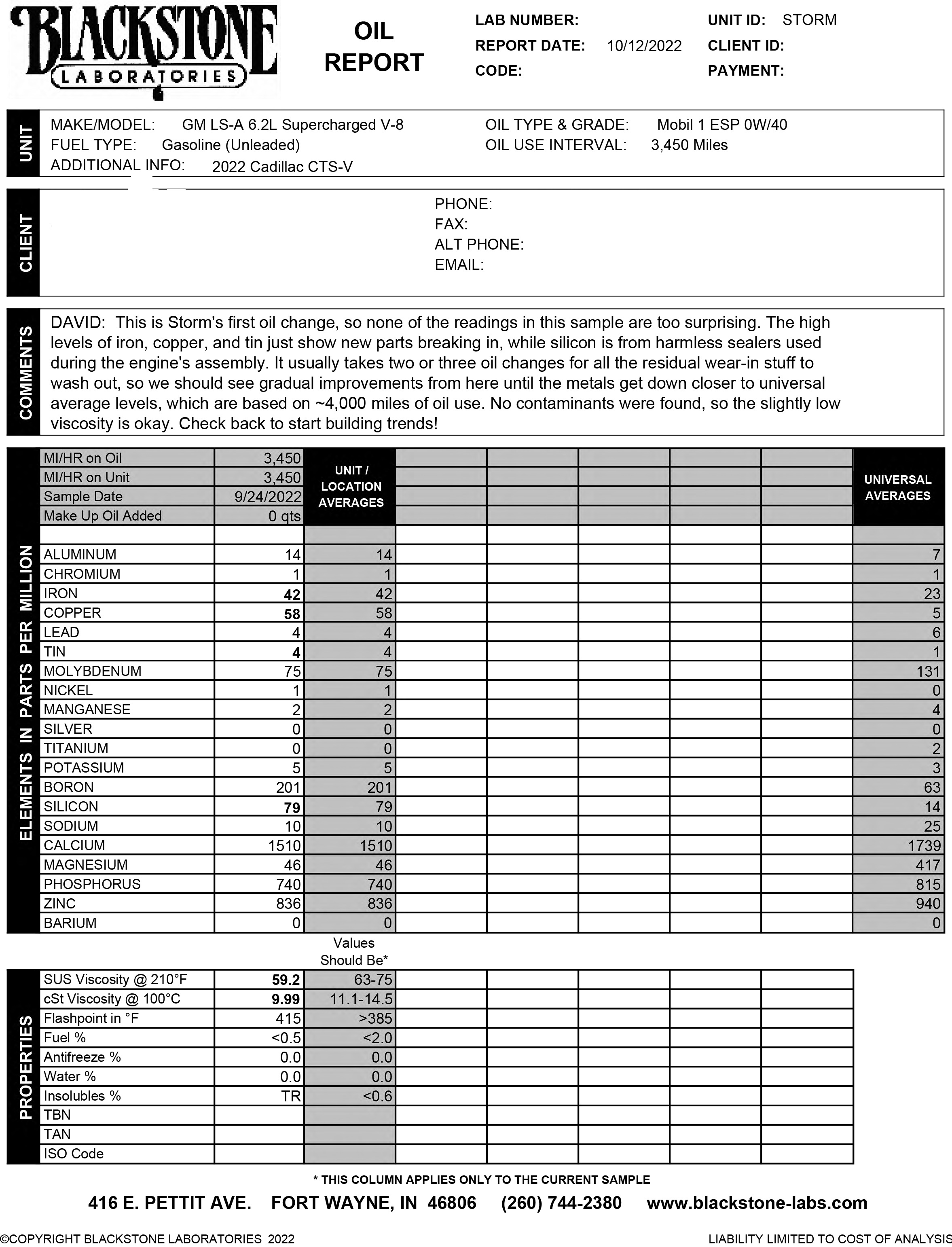

I did my first change around 1,350 miles. Super easy to change. Sent a sample to Blackstone labs.

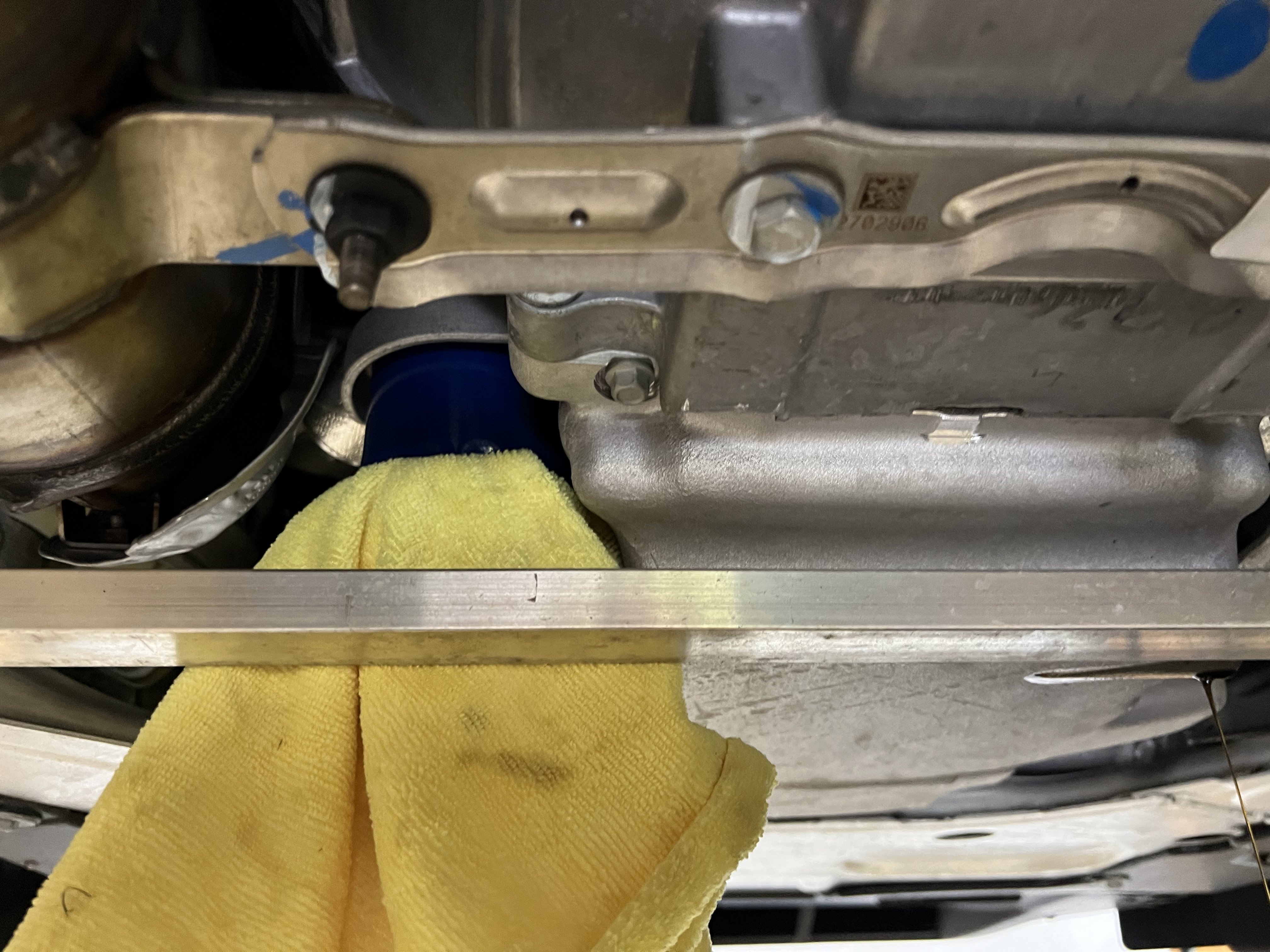

Standing under the car facing towards the front. Drain plug is on passenger side. Oil filter is under the yellow microfiber which I was using to snug up an incorrectly sized filter cap wrench.
