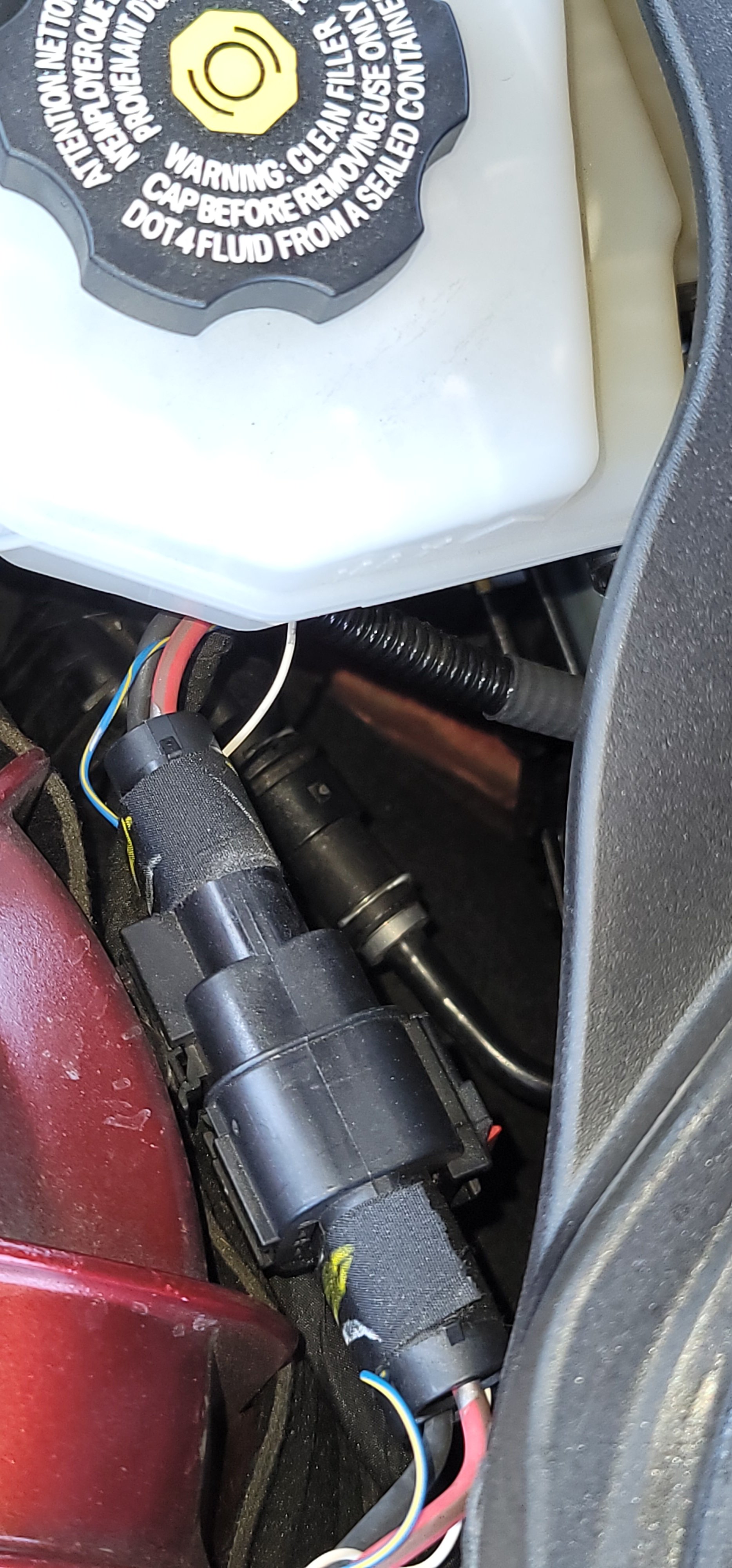

You might want the dealer to take a look at the clutch. There have been some reports on the 5bw of the clutch line coming loose and your symptoms could be caused by a clutch that isn't being fully disengaged.

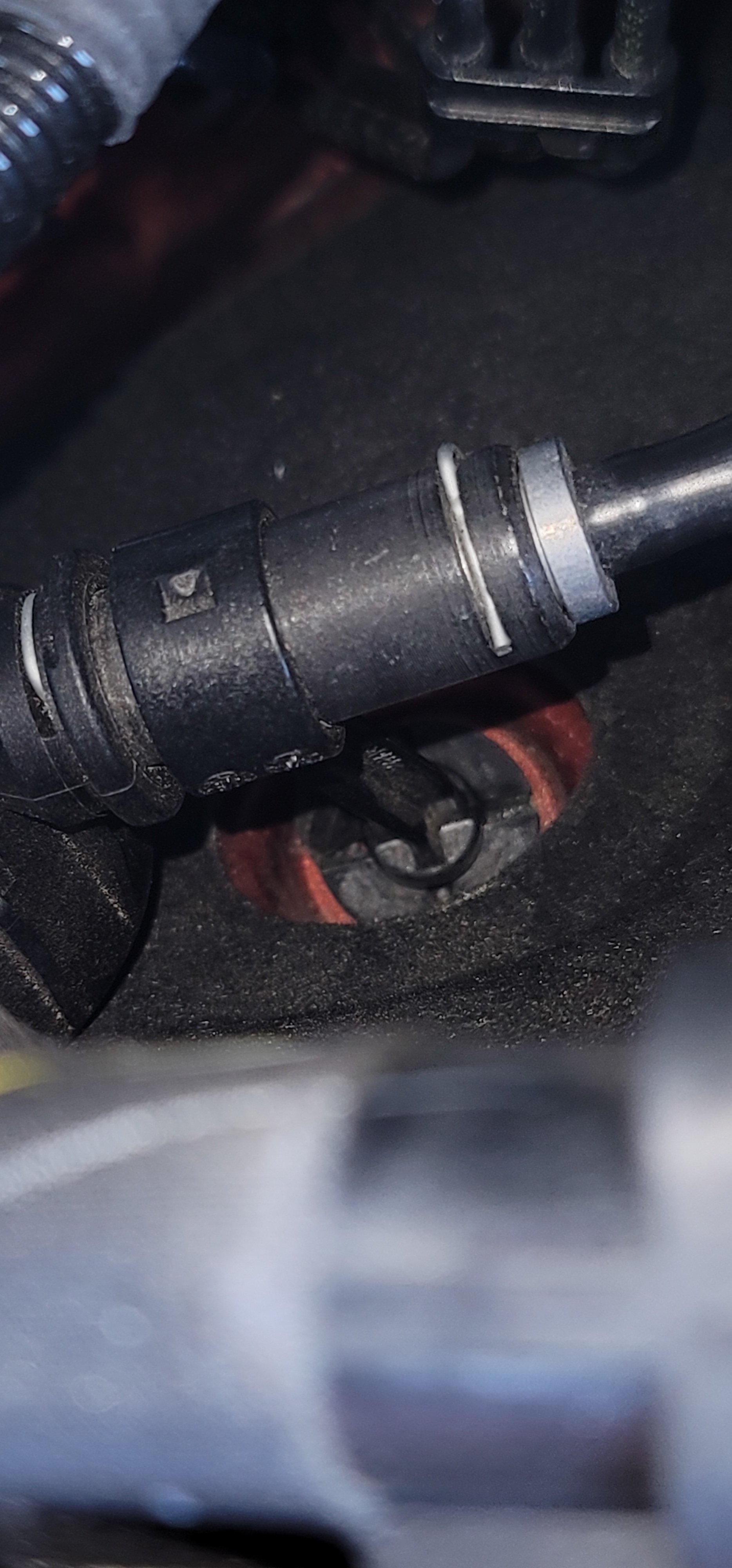

Last night I looked under the hood, under the brake/clutch reservoir there is a round frail plastic bracket (GM 24291900) that was attached to the clutch line (GM 24295659) but it's just dangling there. The bottom of the bracket is a plastic rivet which is supposed to attach to the side of the shock tower but 1 tab was broken.
It sounds like a trip to the dealer is in order. If they try to tell you your car is normal you can point to your experience at Spring Mountain to tell them your car clearly has something wrong after driving one that was not messed up. I’m very interested to hear how you make out. Please post what happens when you go to the dealer.
