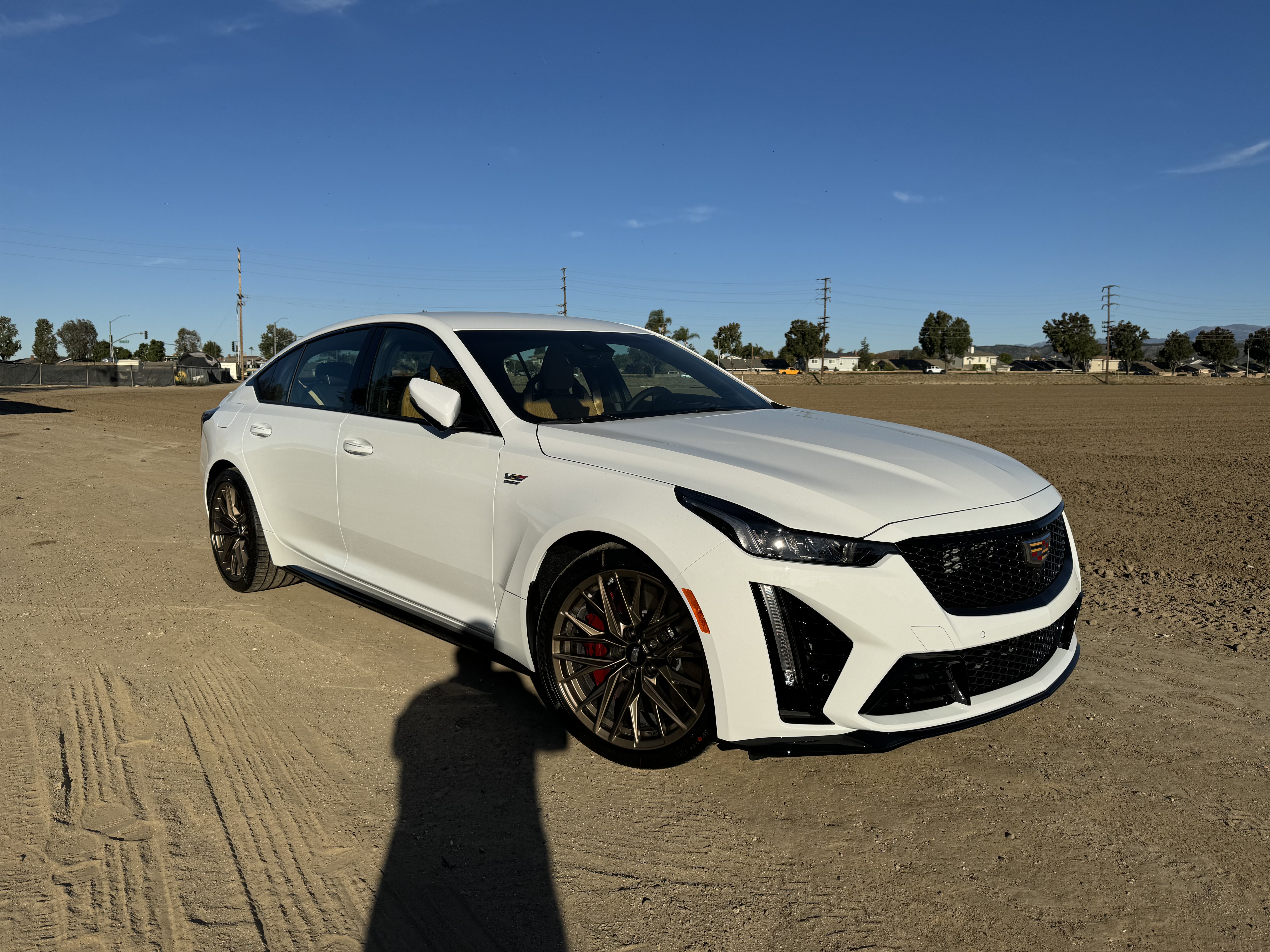

here she is, ill post better photos once it's PPfd.
Congratulations, the car looks great. You have been through a lot so it’s good to see the story end well.
How is the shifting compared to other BW cars you have driven?
Just curious, are the dealers still marking them up?
The shifts are way smoother and more consistent, 2nd gear is slightly notchy at low rpm but no where near as bad as my first car and what I'd consider normal operation.
