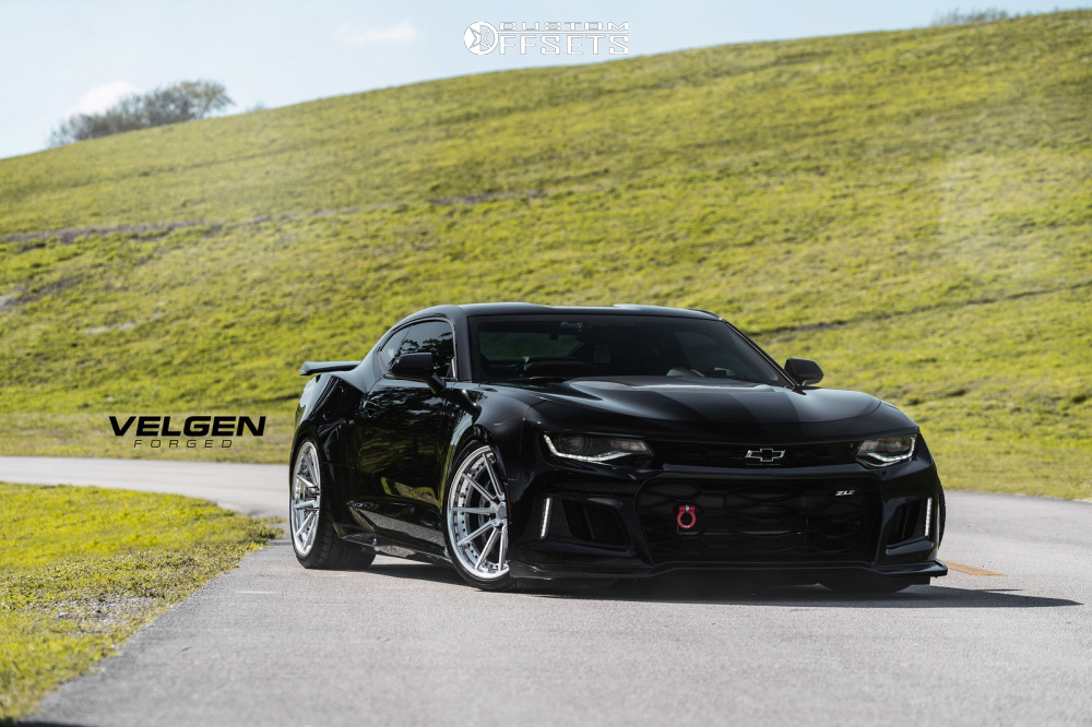

that being said I always thought this zl1 on velgens looked badass lol
  • 633525-3-2018-camaro-chevrolet-zl1-bc-racing-coilovers-velgen-vfmp10-machined.jpg
