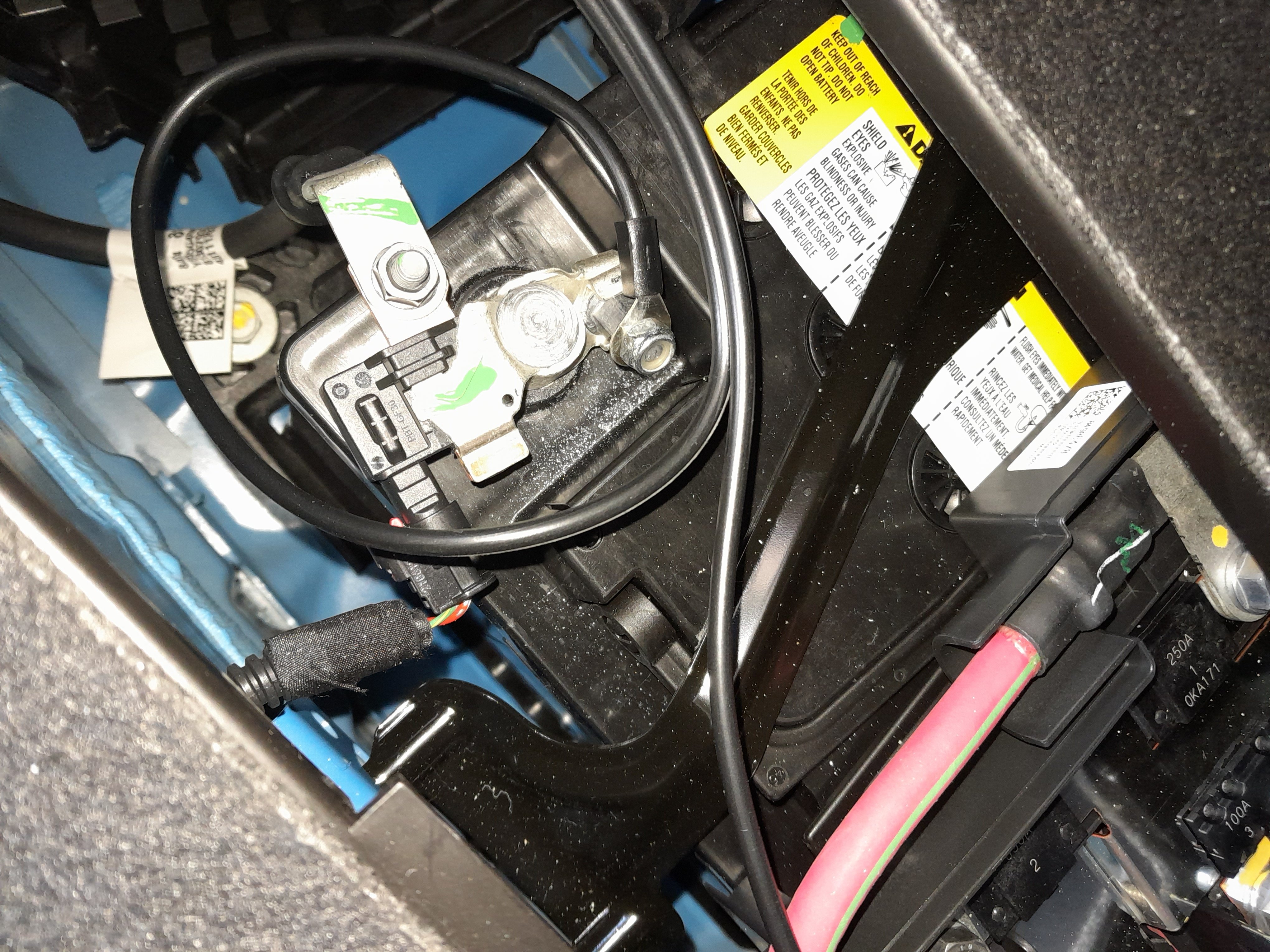

Welp, after charging the charger, I connected to the front battery terminals but got absolutely nothing. After doing some more digging, I found some vids on escalade rear negative connectors having issues so I wanted to check out the rear battery. With no power, I had to fold down the seats, take a bunch of crap out that I've been meaning to take to storage, and climb my big ass into the trunk to pull the emergency handle. Lo and behold, the negative terminal connector was completely DETACHED (pic below). Placing it back on to the battery fixed her right up but it looks like the connector is twisted and doesn't seem like it can be tightened further. I will most likely have the dealer look into it whenever I get around to my first oil change.

Wow, interesting.
As a comparison, on my 5bw, the bolt on the negative terminal sticks out way more. Enough that I was able to add my battery tender leads with an additional nylon locknut. So yea, I suspect it got tightened incorrectly and they thought it was all the way tight but just barely holding on.
