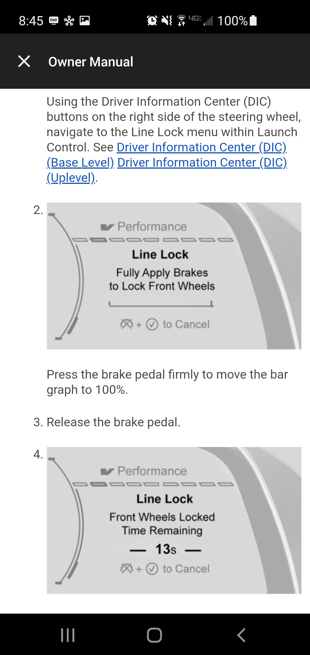

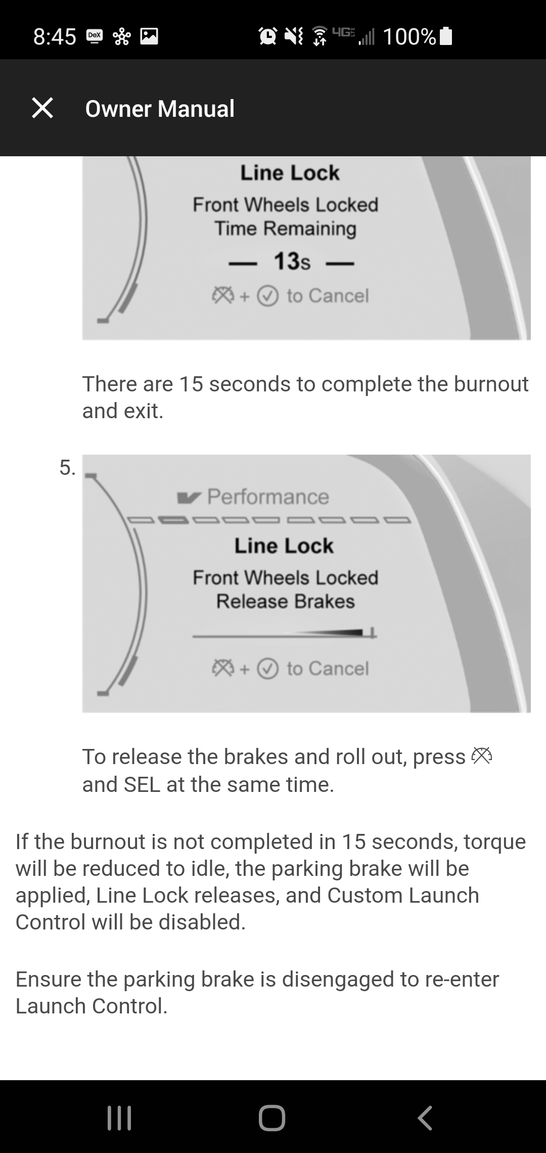

Has anyone used there line lock and how do you do it, how well does it work post picks of burnouts.

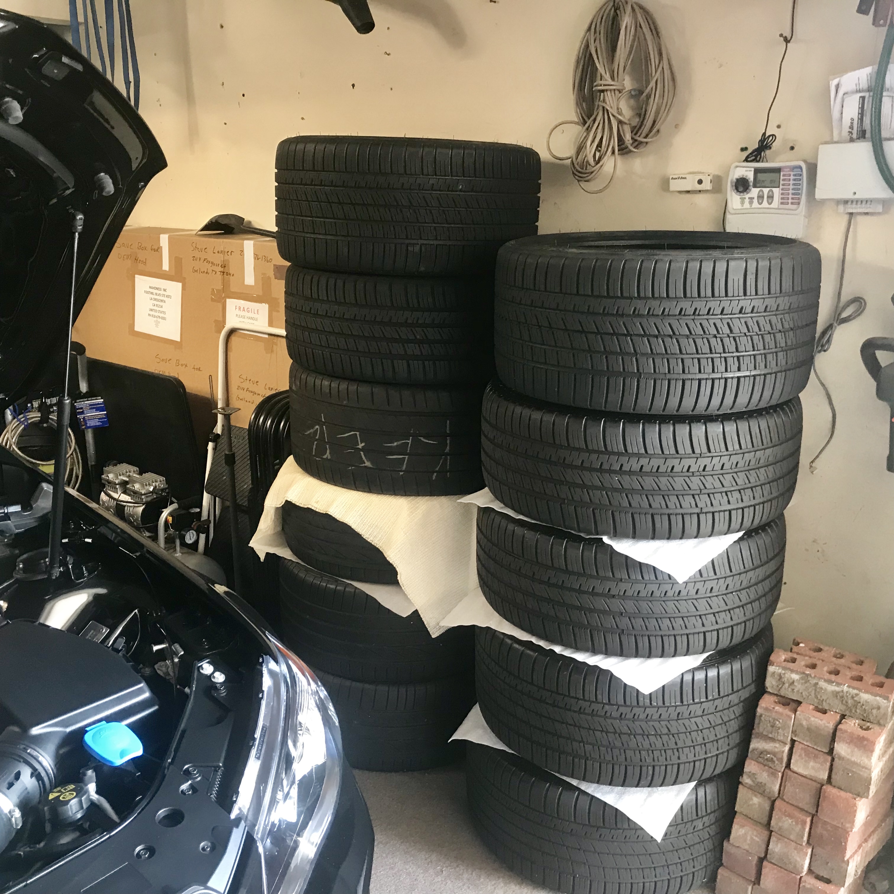

Not everyone is rich like you :p
Please, I'm not "rich", I live in the ghetto in a 25 yr old shit box, I work min 50 hr a week, I have to borrow money to pay the electric bill, and a couple of years ago my son worked at Discount tire so I got them cheap, lol..... There are a few guy on this forum that are "true" ballers, and I'm not one of them!
