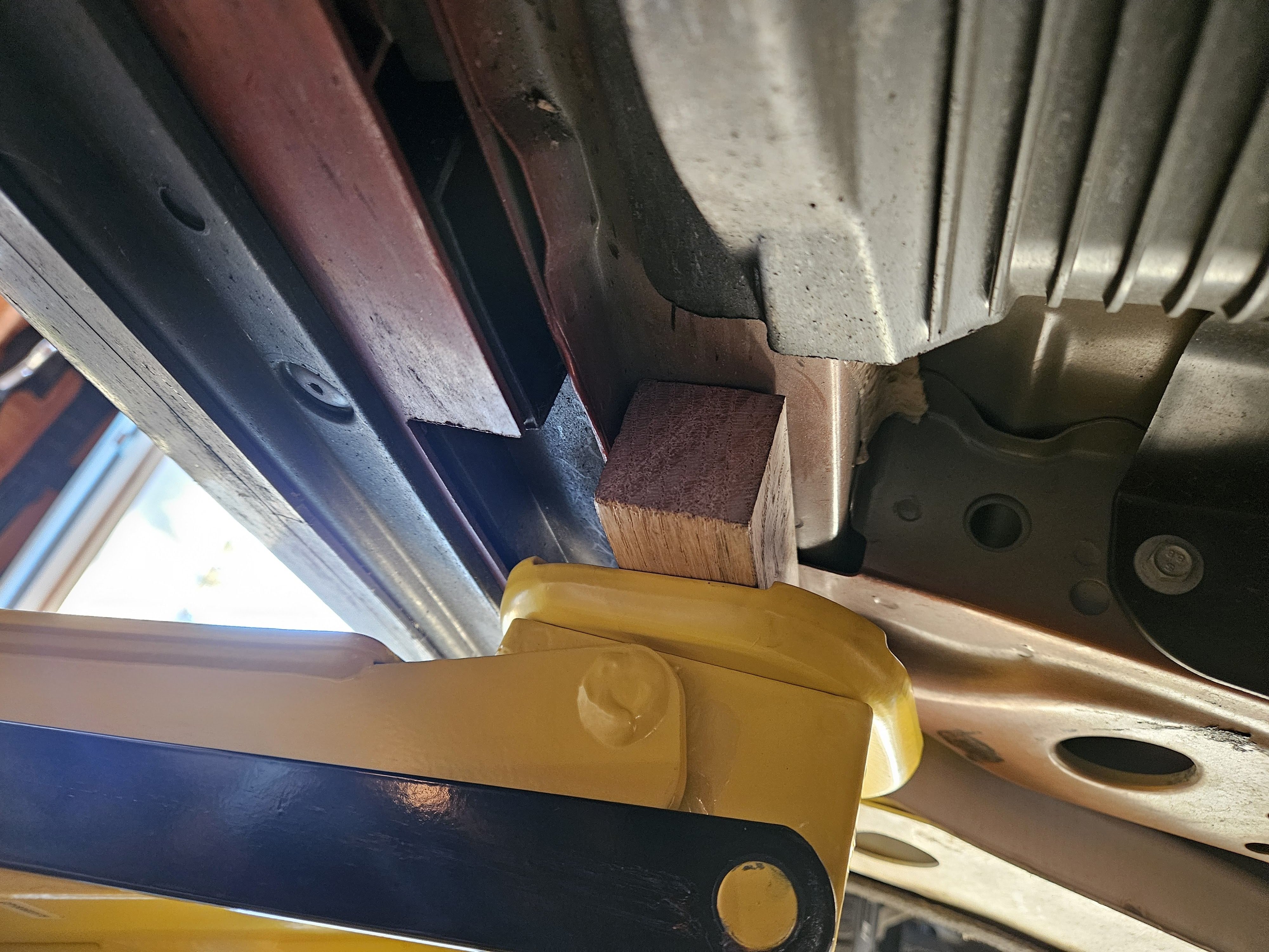

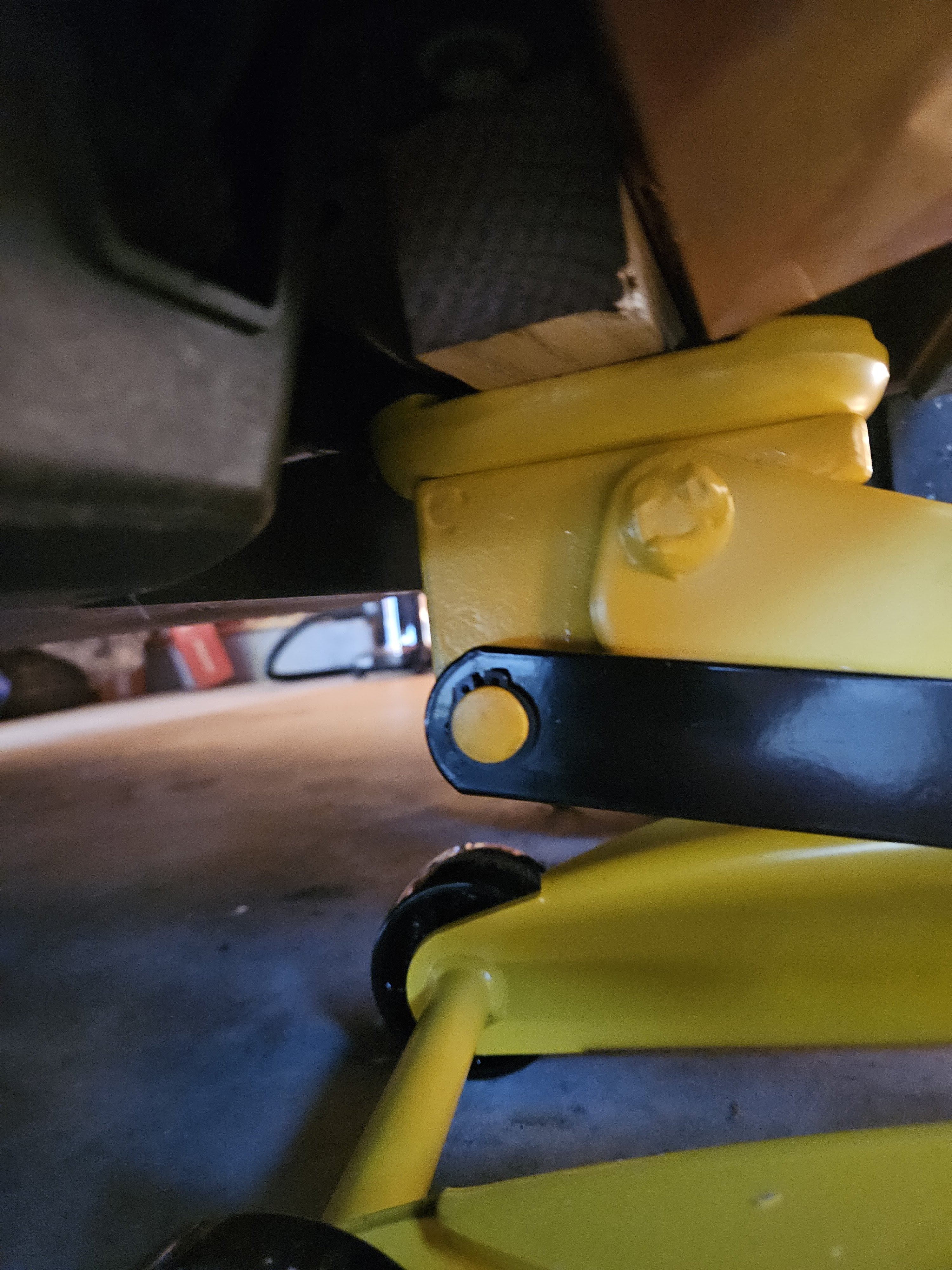

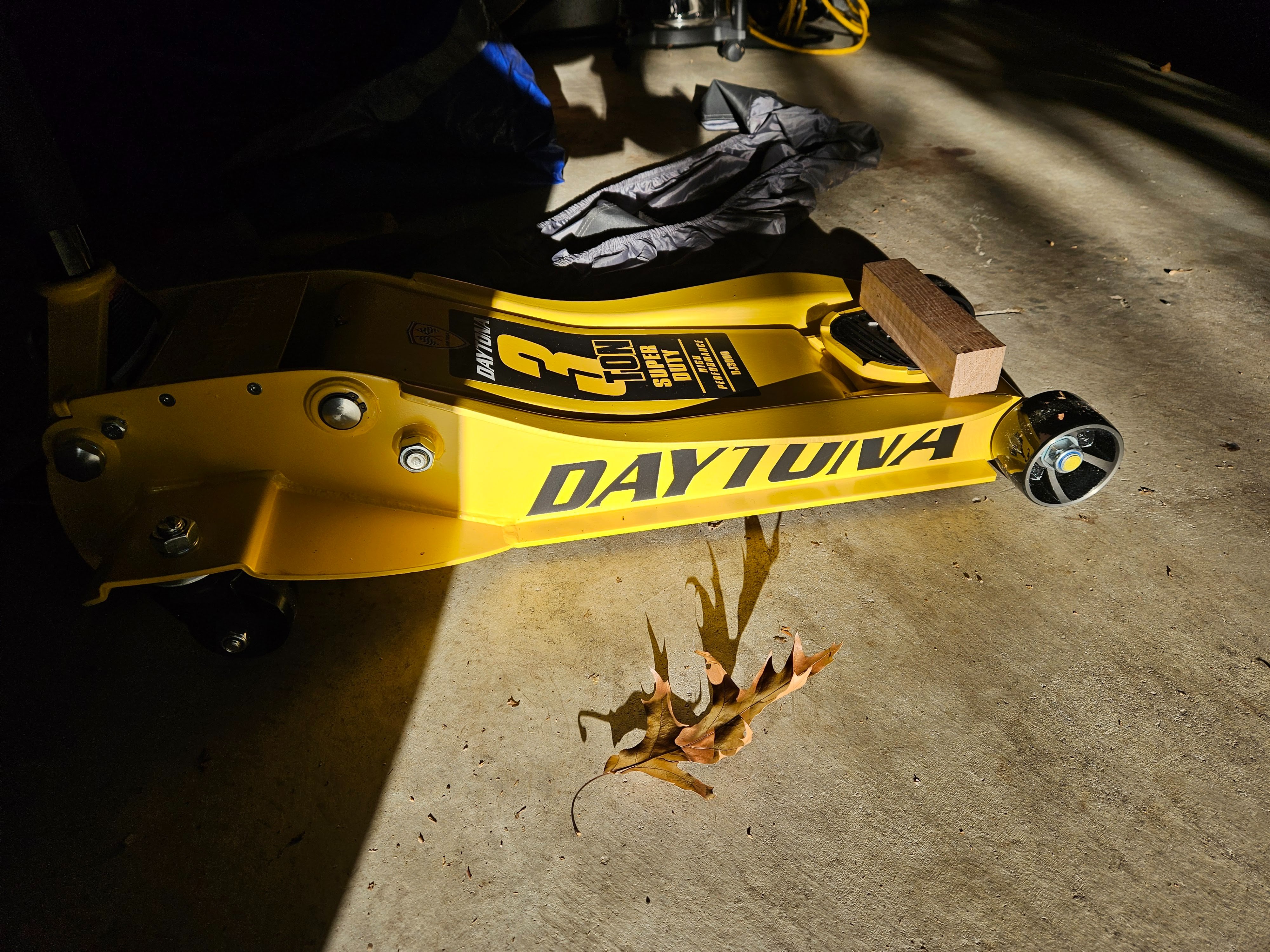

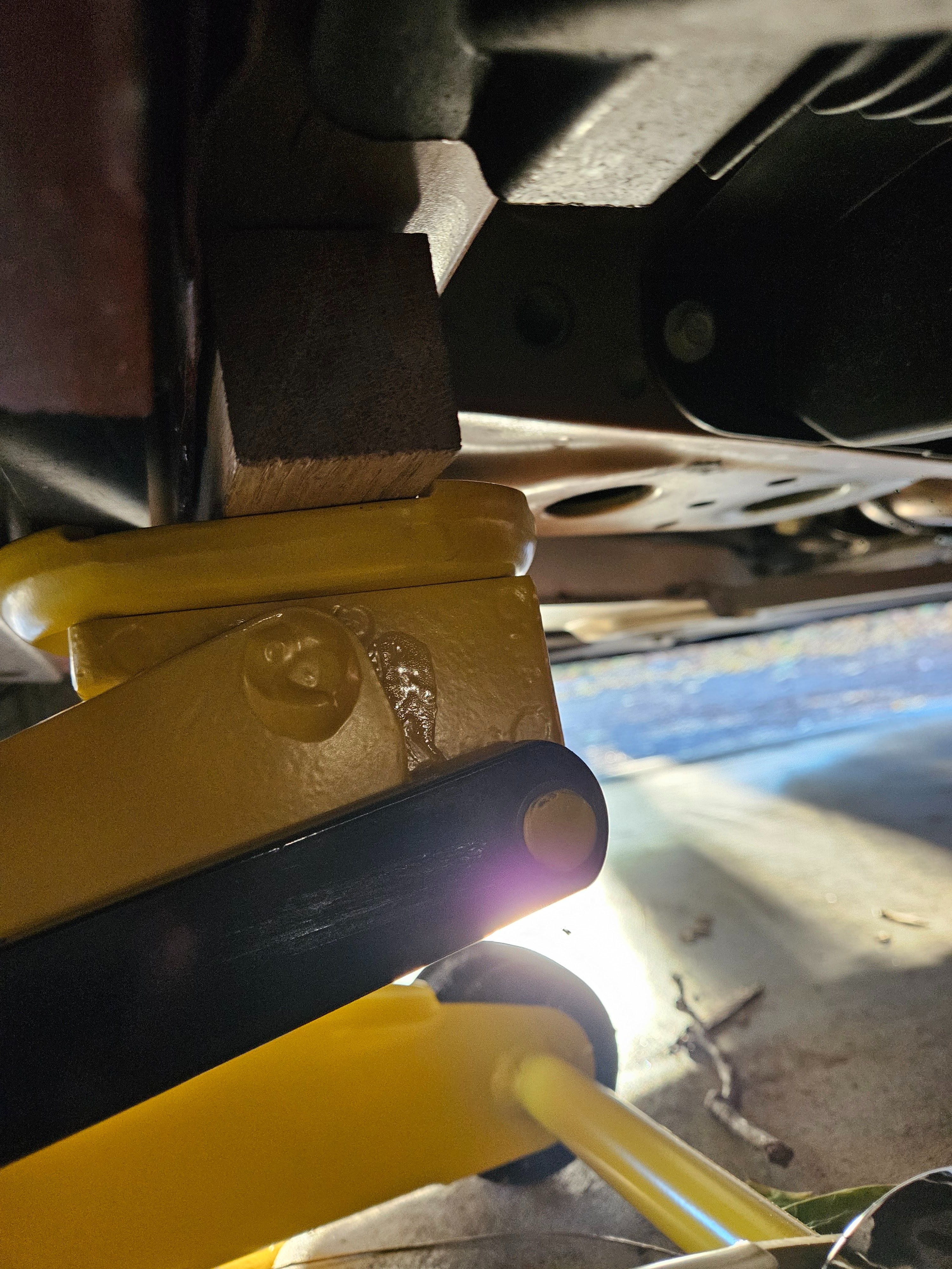

Thanks to this thread, I have been hesitant to even attempt doing my own seasonal tire swap on my 5BW as I have done on my past cars, but just decided to go for it. I first tried the method listed here for the 4BW in this thread but found that the magnetic puck would not fit around the plastic piece next to the pinch weld. So I followed Mirza's advice by getting this Home Depot block of wood and having them cut it to size. Seemed to work ok for both front and rear.

I just notched the plastic piece near the pinch weld so that the ZL1 add-ons pucks would fit.

Thanks for the pictures. Where you did put your jack stands?

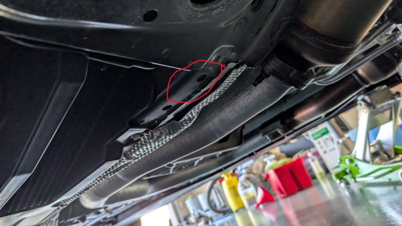

I have a CT5. I read all 20 pages. I placed my hockey pucks just inside the pinch weld as depicted in a few of the posts here. I have pads with slots for the pinch welds but I did not want to lift with the plastic of my rockers or cut it as some have done.
As for jack stands, I figured the steel frame rails which are doubled layered should be strong enough to support the car.
It did not appear to deform at all and supported the car just fine. I do have two jacks so I can lift the car up and lower it relatively evenly onto the stands.
For the rear I used the rear cross member as some have posted here. Yes, it is pretty narrow between the exhaust but it felt plenty stable. However, I also wanted to replace my diff fluid and the jack stands were in the way, so I just put the car back down and backed onto my race ramps to drain the diff. I lifted the front back up to try to level the car so it would still drain properly.
