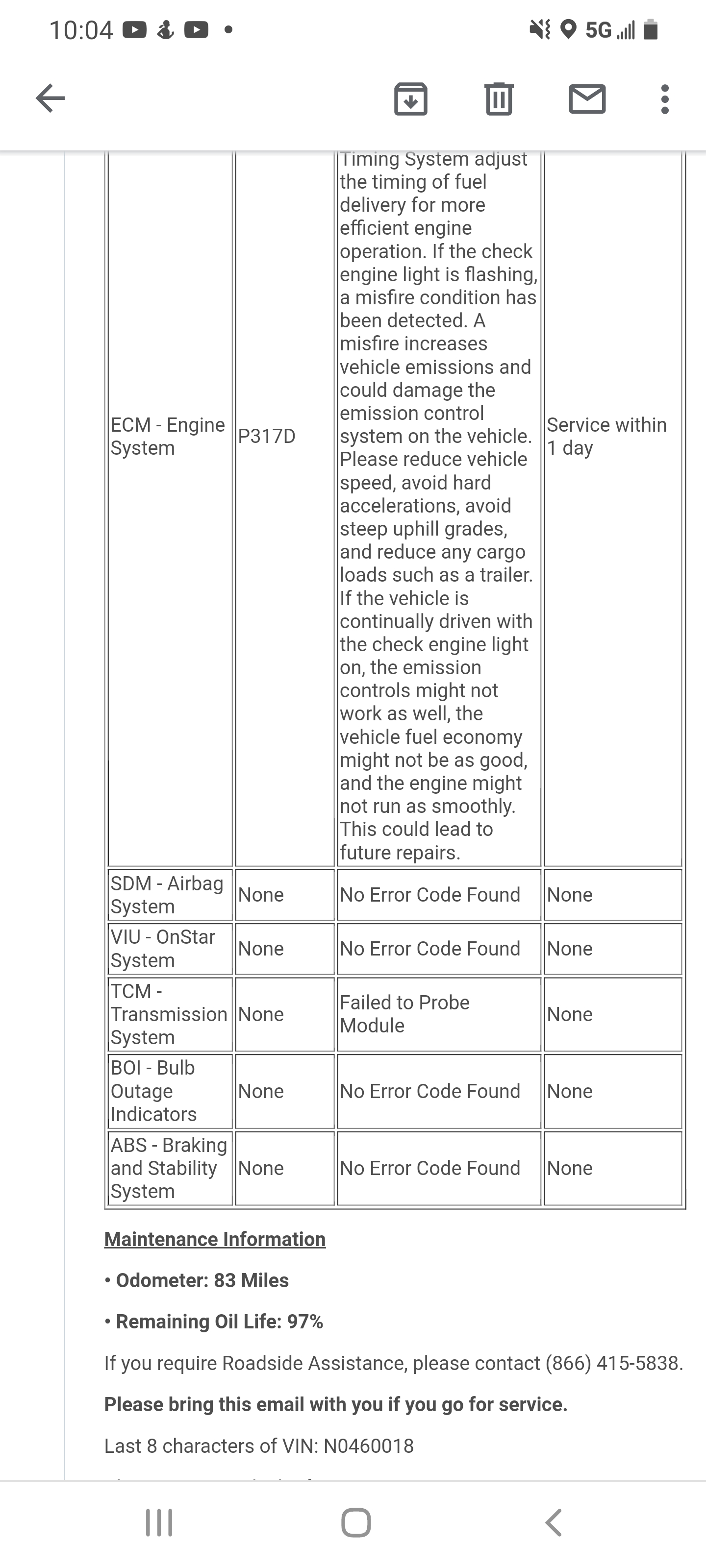

First check engine light, manual transmission?
Any chance your battery was low? I know the code says transmission but given that it's a manual I wonder if that is a catch-all the also includes the differential. I know the eDiffs have issues if battery voltage is low so it's possible it tried to do something with the eDiff and couldn't because of low voltage.
I guess that is possible. I did spend time when I initially picked it up messing with the infotainment with the car off, but after that, I drove it quite a few miles, and then just left it overnight. That morning when I turned it on, the check engine light came on, and I got the codes from Onstar. At this point I'm having my dealer call me and I'm gonna have them sort it out, I don't want to take any risks.
seeing how there is a "failure to probe module" for the TCM, is it possible that there is an issue with the ECU or something not being set up a manual transmission, but rather an automatic? MT's don't have TCU's I assume, maybe the system is freaking out because it thinks the car is automatic?
Sorry for the triple post, but I brought the car to the dealership. They were unable to clear the code, service guy said he is going to order an actuator module or something, I took the car home for now since they didn't have any loaners, they'll let me know when the part is in and I'll drive back in. I've noticed the shifter is starting to buzz at certain speeds in 4th gear, not sure if that's related... I'll have to call back when I get the chance to find out exactly what they ended up ordering.

So finally got an update for you guys. Last week the driver side exhaust actuator replacement came in to the dealership, so they drove to my place of work in a loaner xt5 and brought my car back to the dealership for repair.
They also managed to fix the buzzing in 4th gear, which was actually caused by the rear axle cooler line contacting the first exhaust to drive shaft heat shield due to a dent in the heat shield, which they repaired.
I got the car back in a day, and no longer getting a buzz or check engine light, and it feels even better than it did before (not sure if this has to do with the actuator being replaced or just a placebo). Overall the service experience was fantastic, and coming from a VW, having a loaner dropped off for me and having my car picked up was magical lol, not to mention taking warranty service seriously and not brushing off the stick shifter buzzing.
