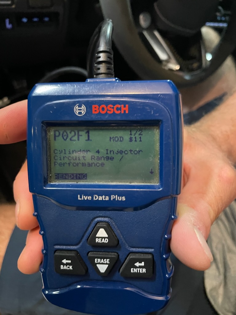

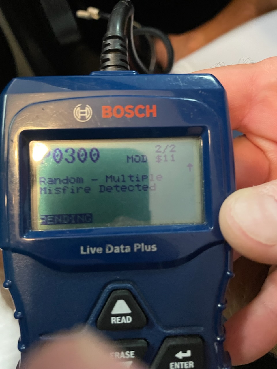

Here are the codes I pulled. The car goes into the shop tomorrow.
Possibly just a faulty injector, which is odd.
