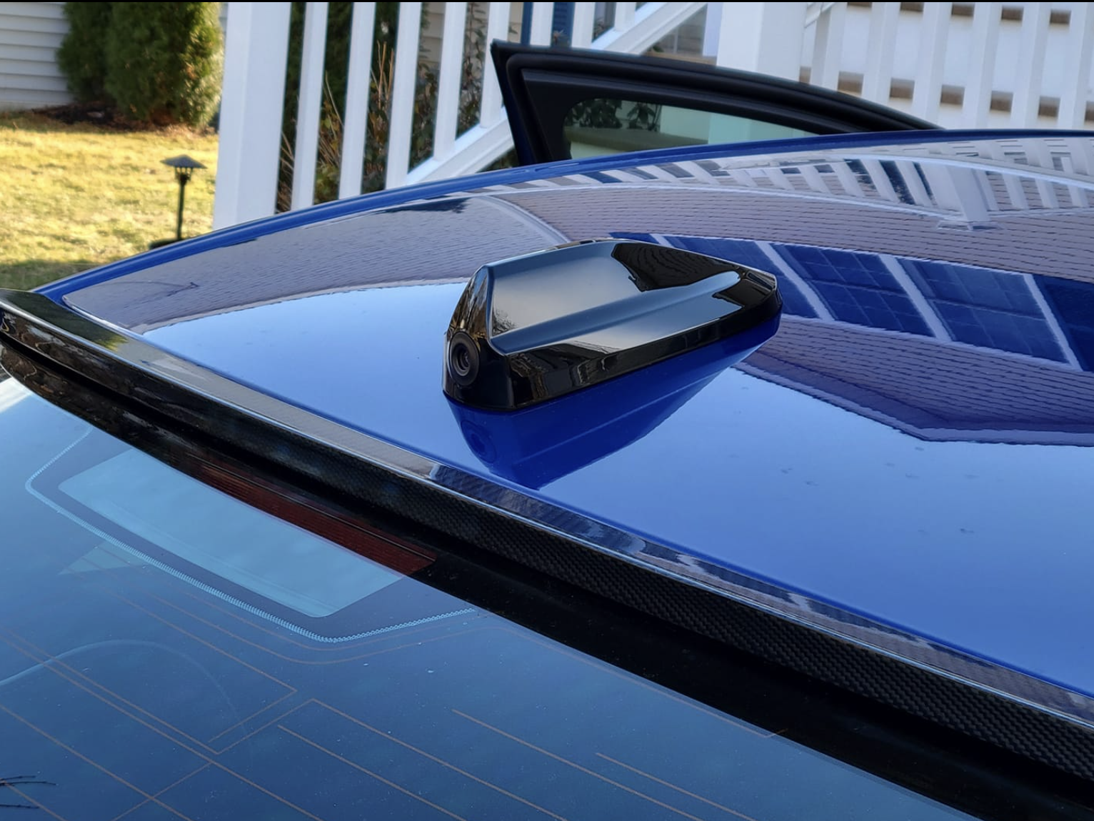

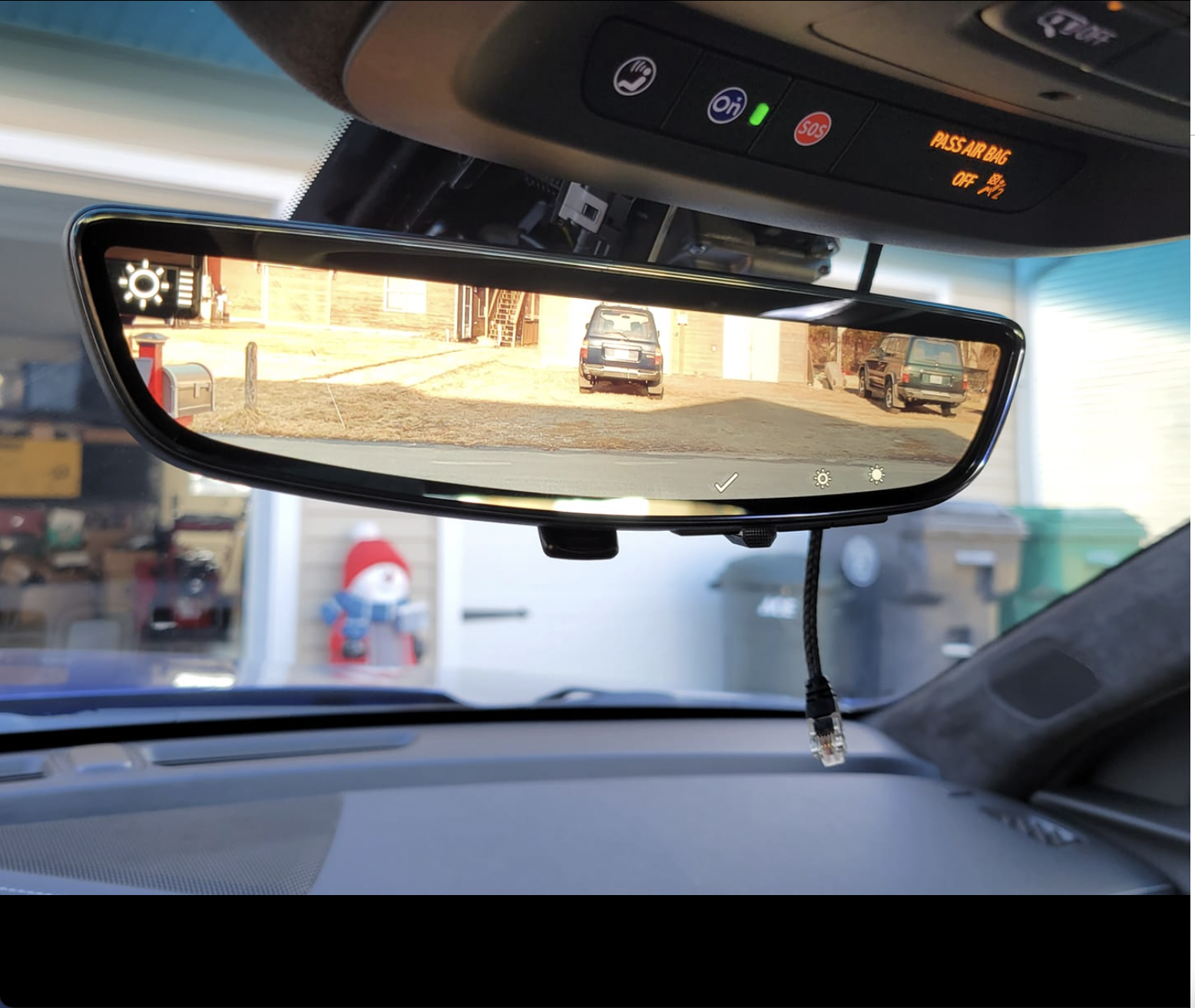

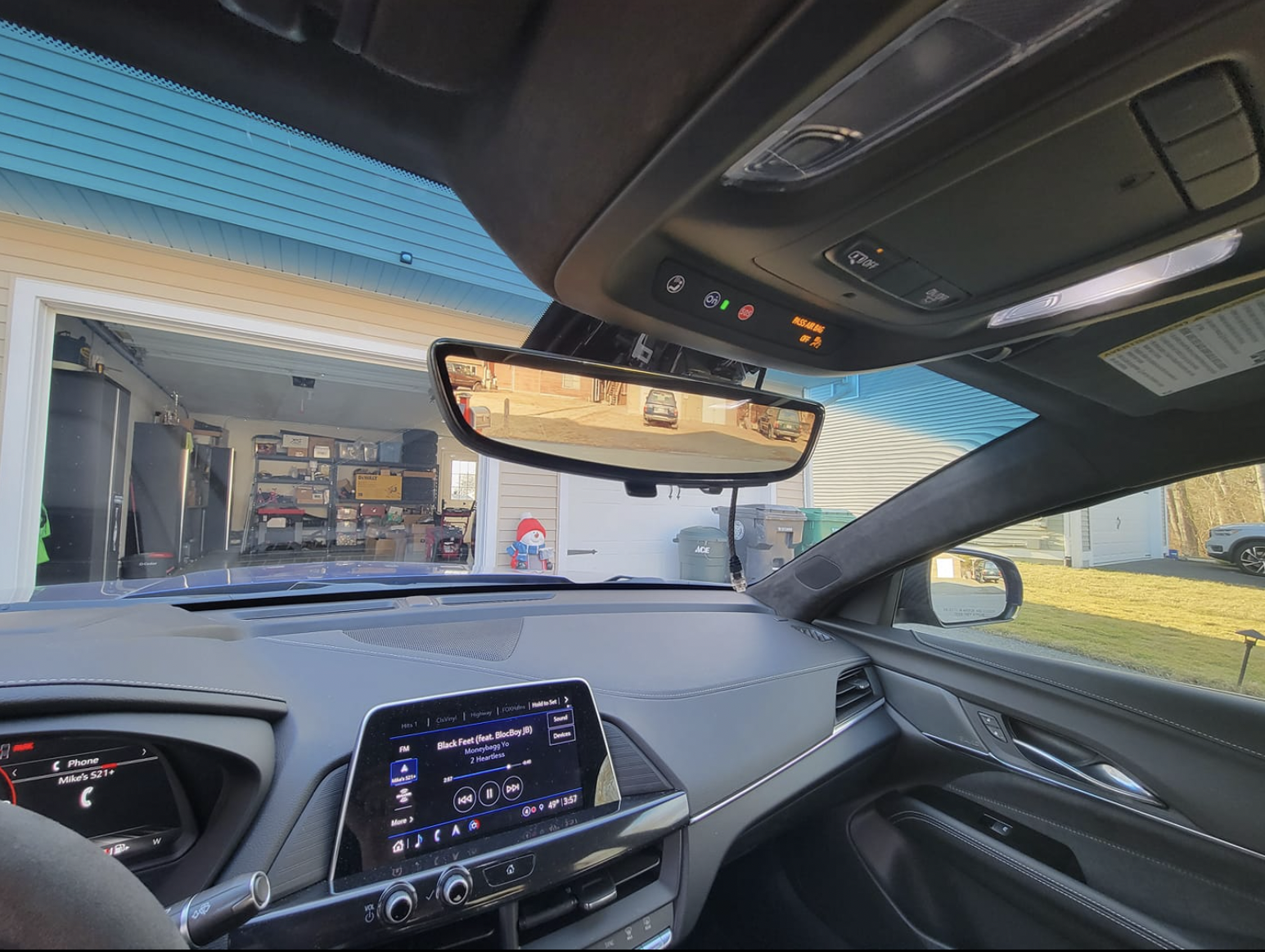

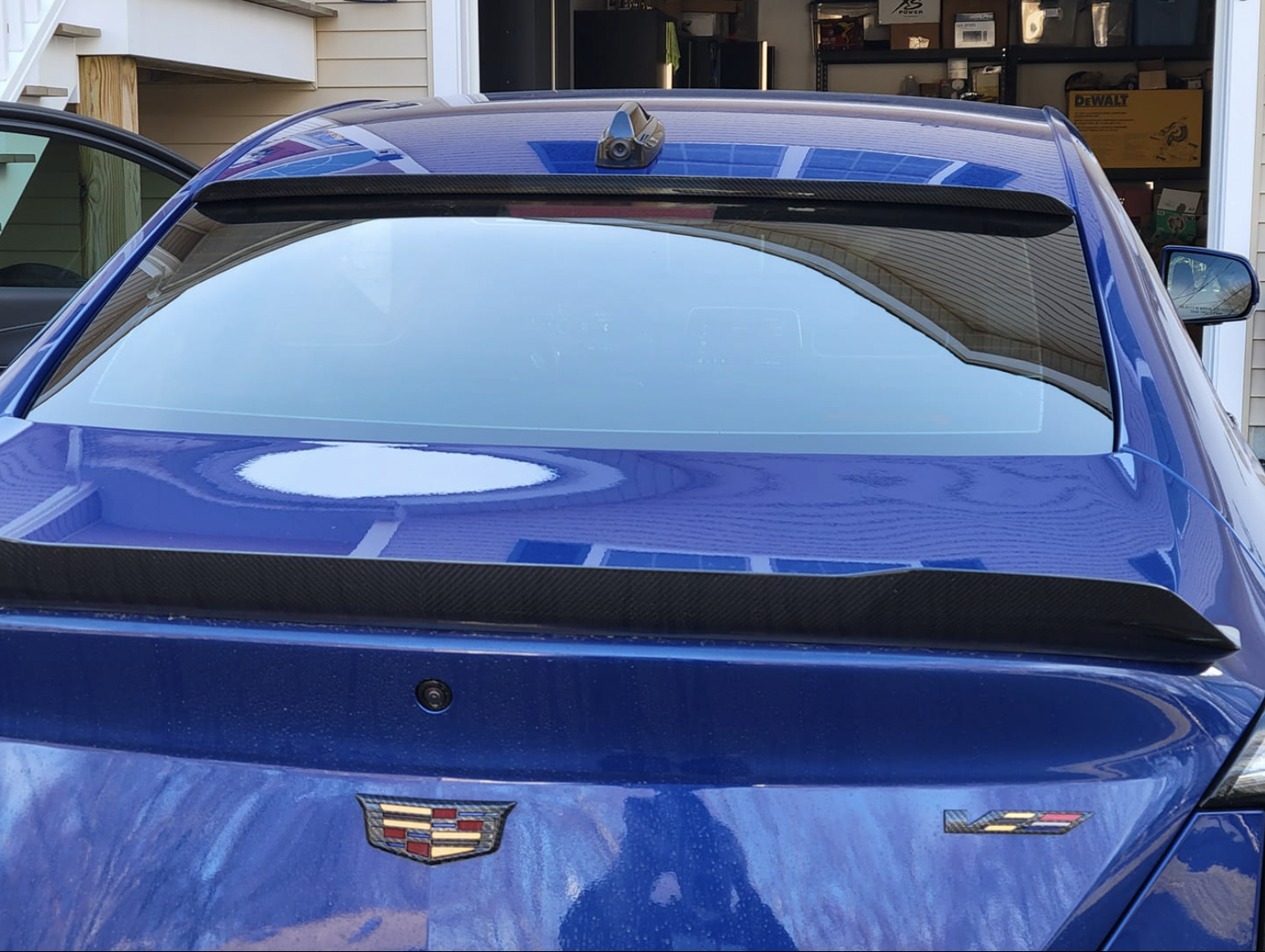

So today i decided to see if i could install the rear view mirror kit from the Ats or the Camaro with the roof shark fin camera.
install took about 2 hours start to finish and required dropping down the headliner and removing the shark fin ,came out great i think not a bad days work if you ask. mine should of came this way from factory.

Love the idea, but not having the antenna body-matched is a deal breaker for me.

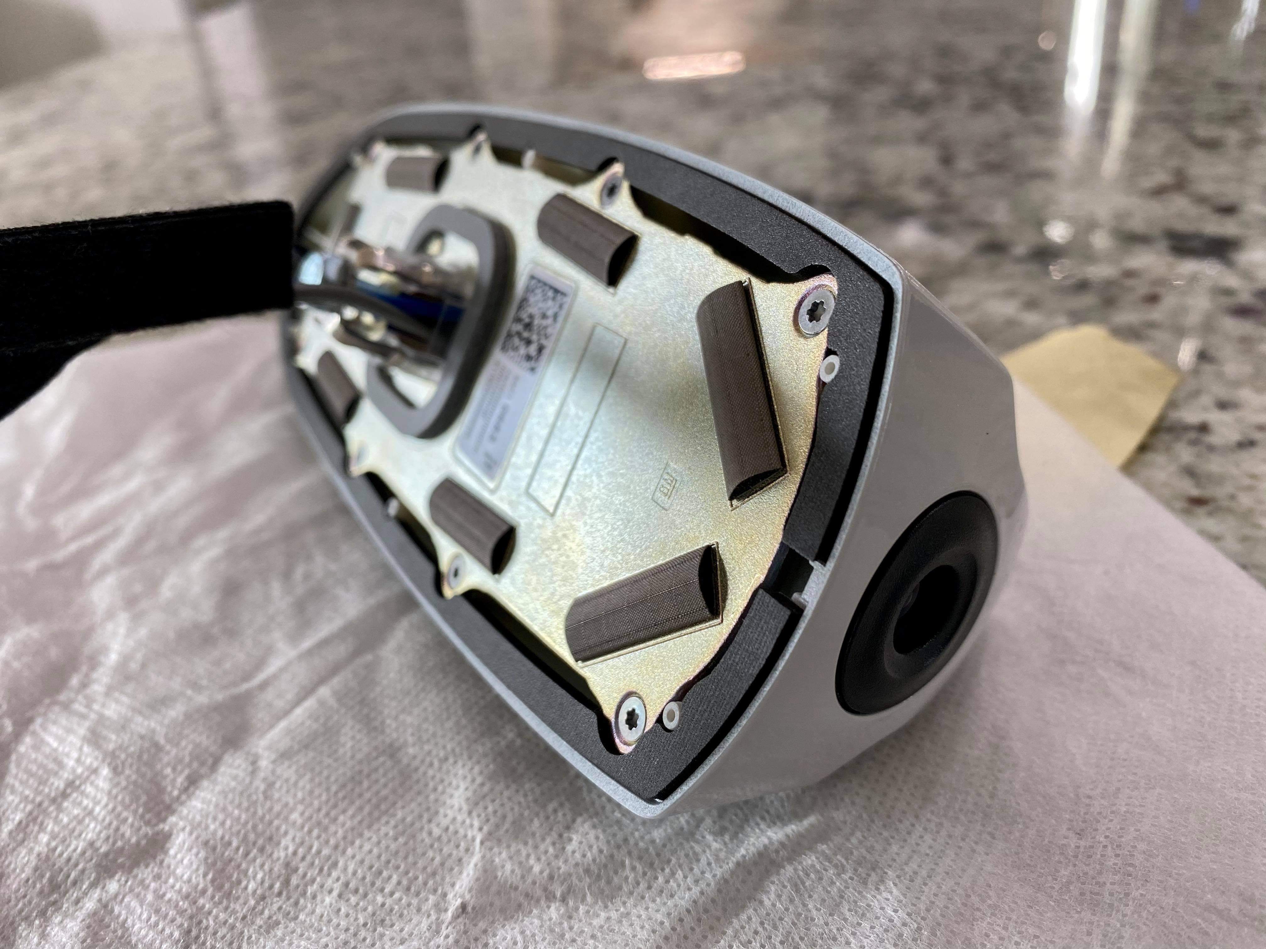

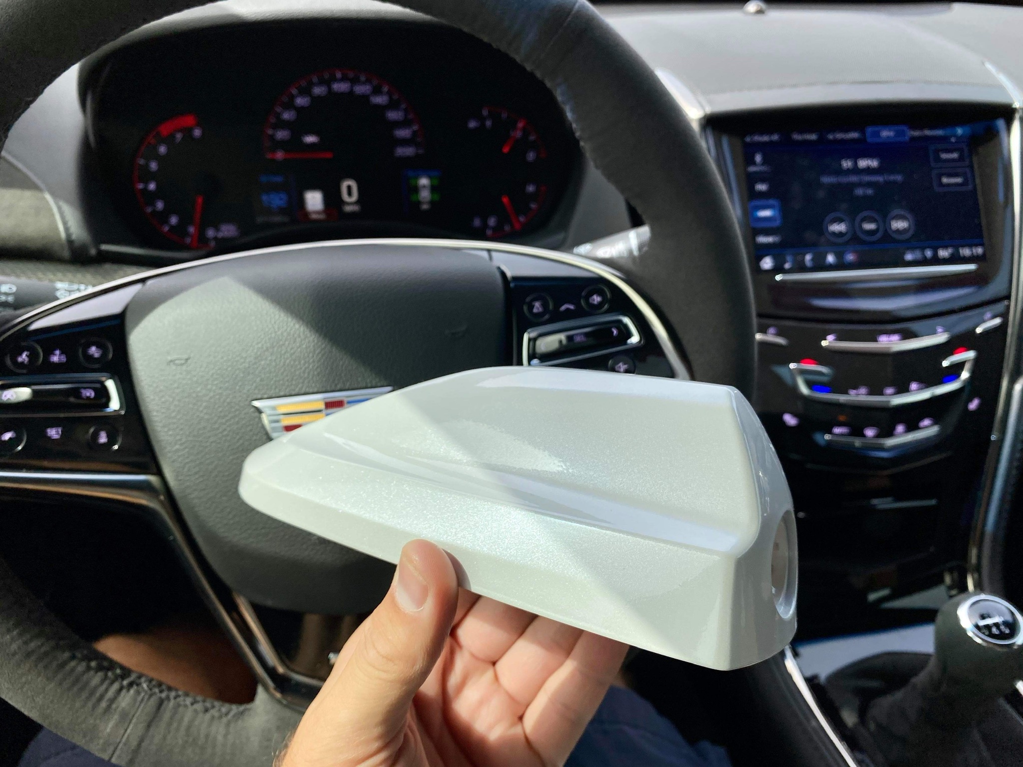

The antenna cover is held on with 8 torx screws and can easily be painted at your local painter.

I have a local painter who does all the custom work for Mancuso Harley Davidson here in Houston. He painted a silver one for me @ $100, whenever you are ready reach out to me and we can try and get one done for you
Perhaps, I'm missing the obvious but, what's the benefit of this? All that I can see is that the rear view is in the mirror as opposed to being in the center screen. 🤷‍♂️
