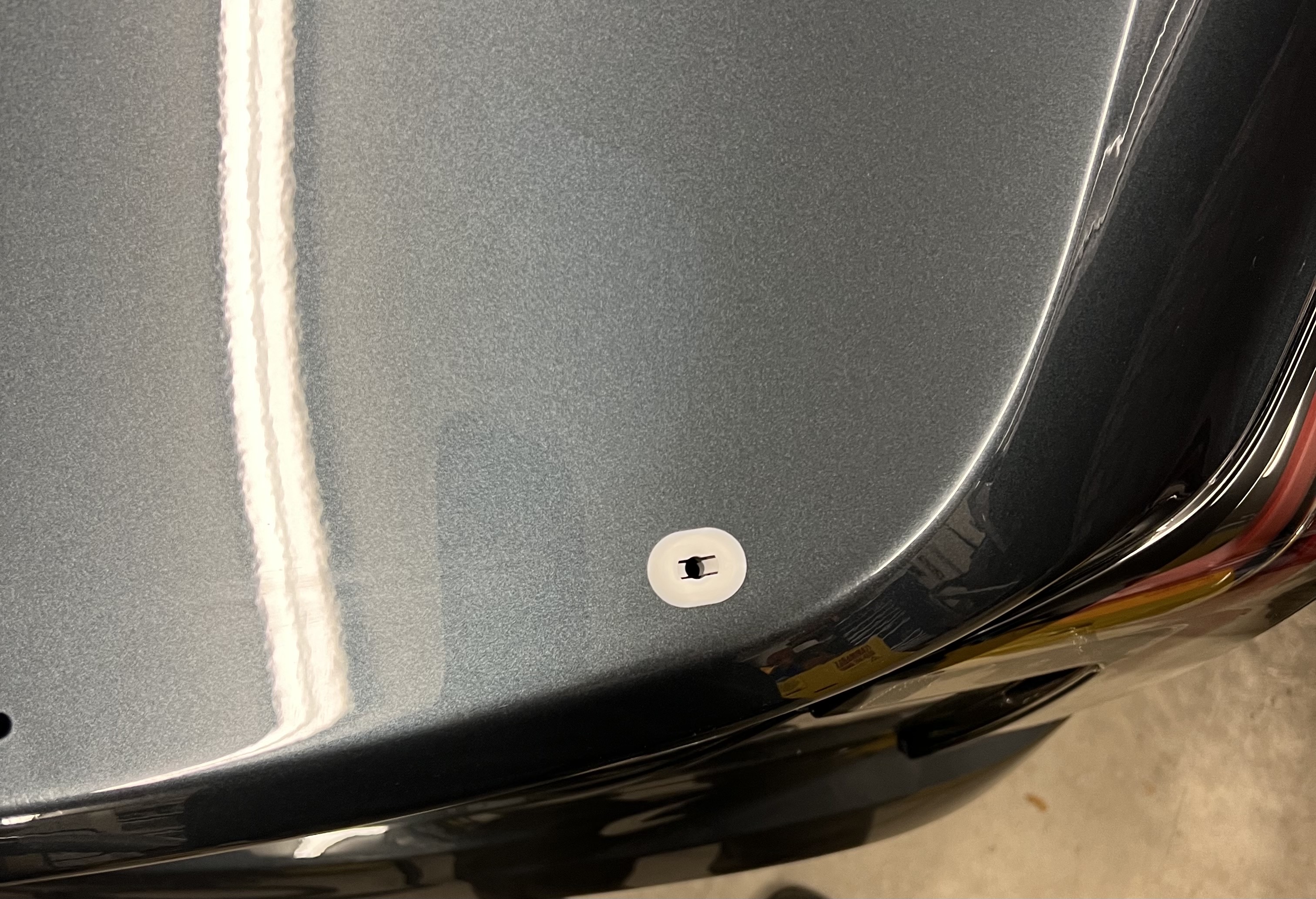

This is what the pre-drilled non-cf1 holes look like. Every other hole is used to mount the spoiler, starting at the oblong holes on the outside. The outsides holes would be drilled similar to rubberduck's post

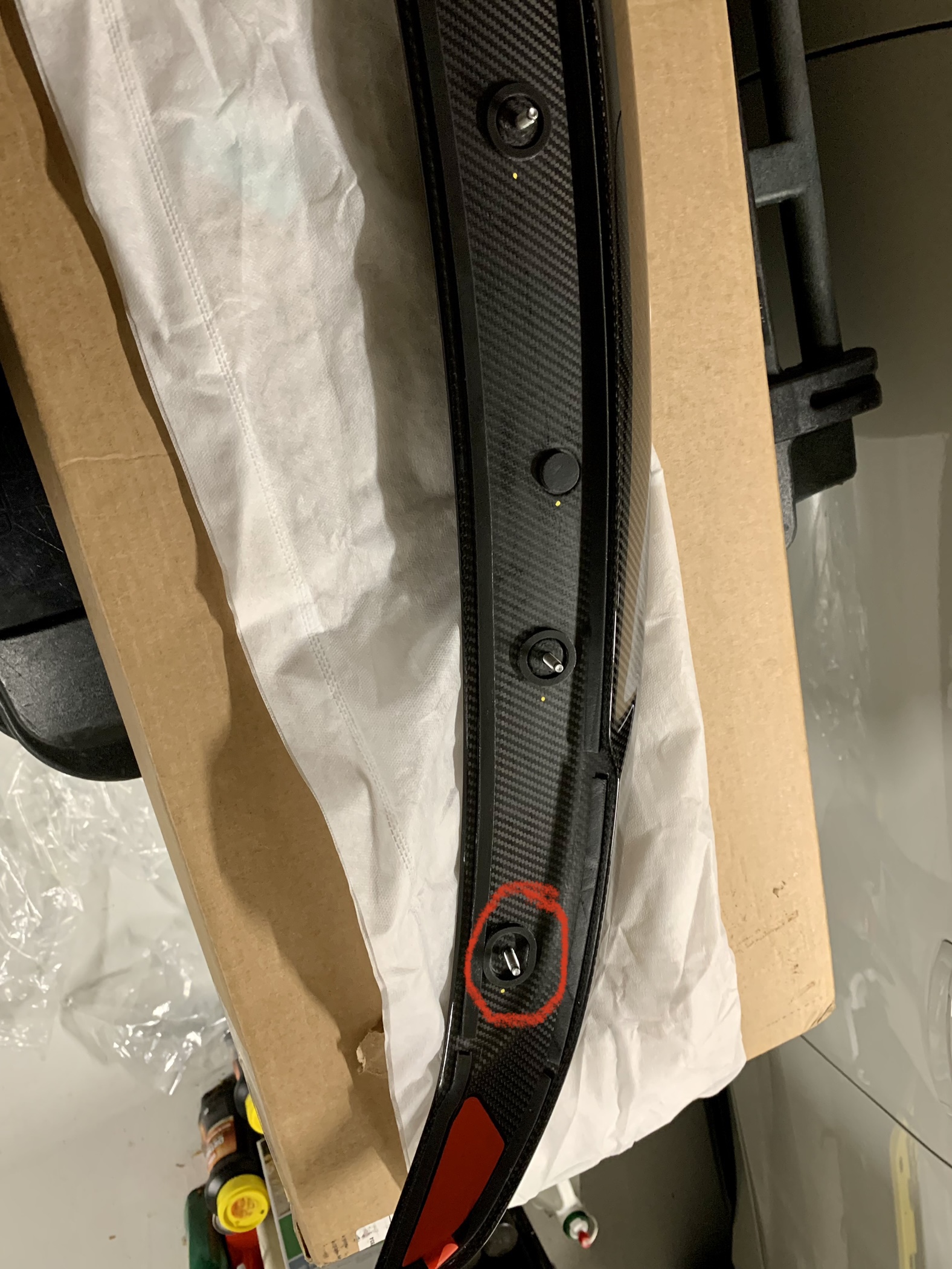

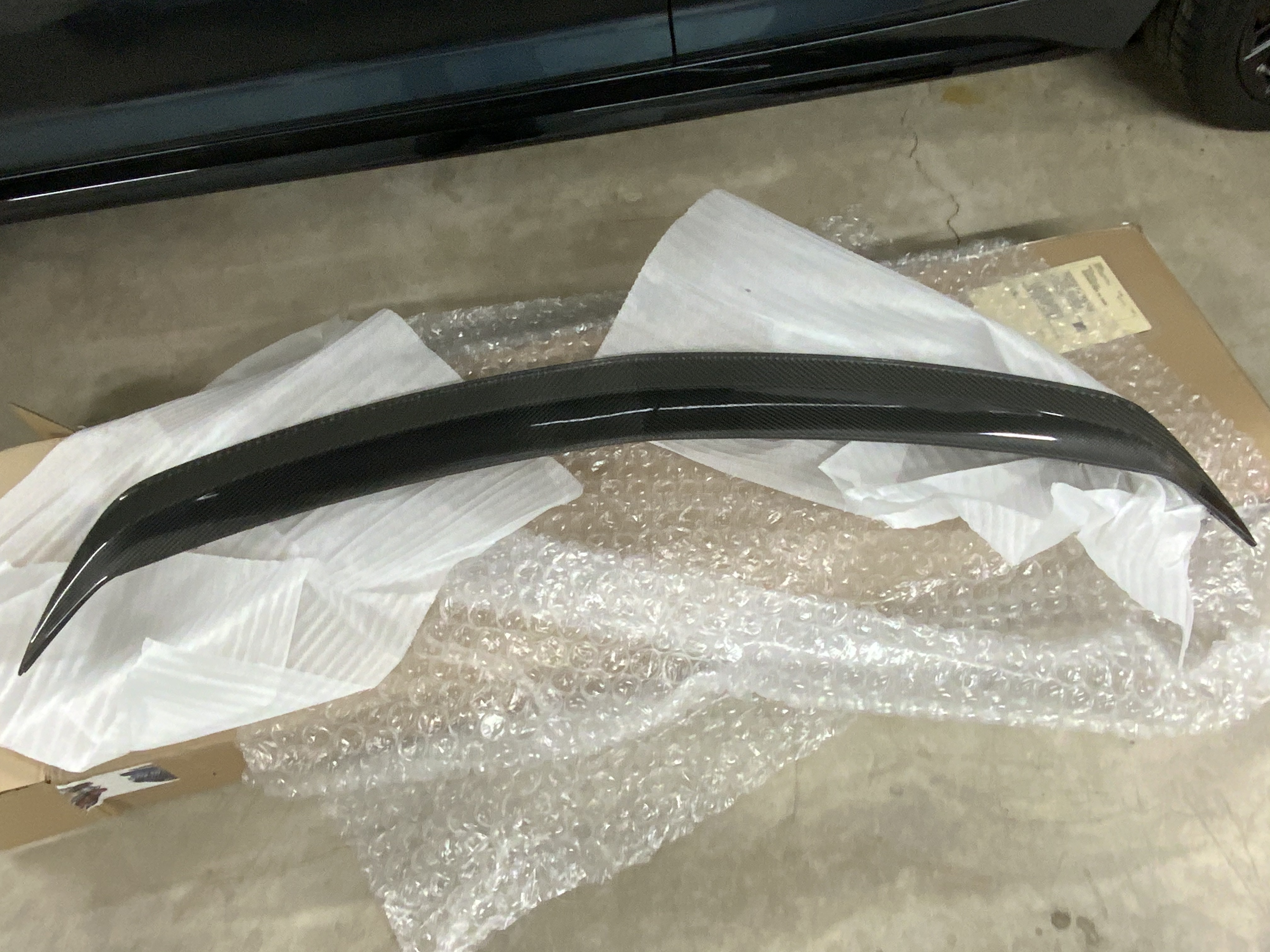

The red circle on the backside of the CF rear spoiler shown is the stud that slides into the plastic nut insert pictured.

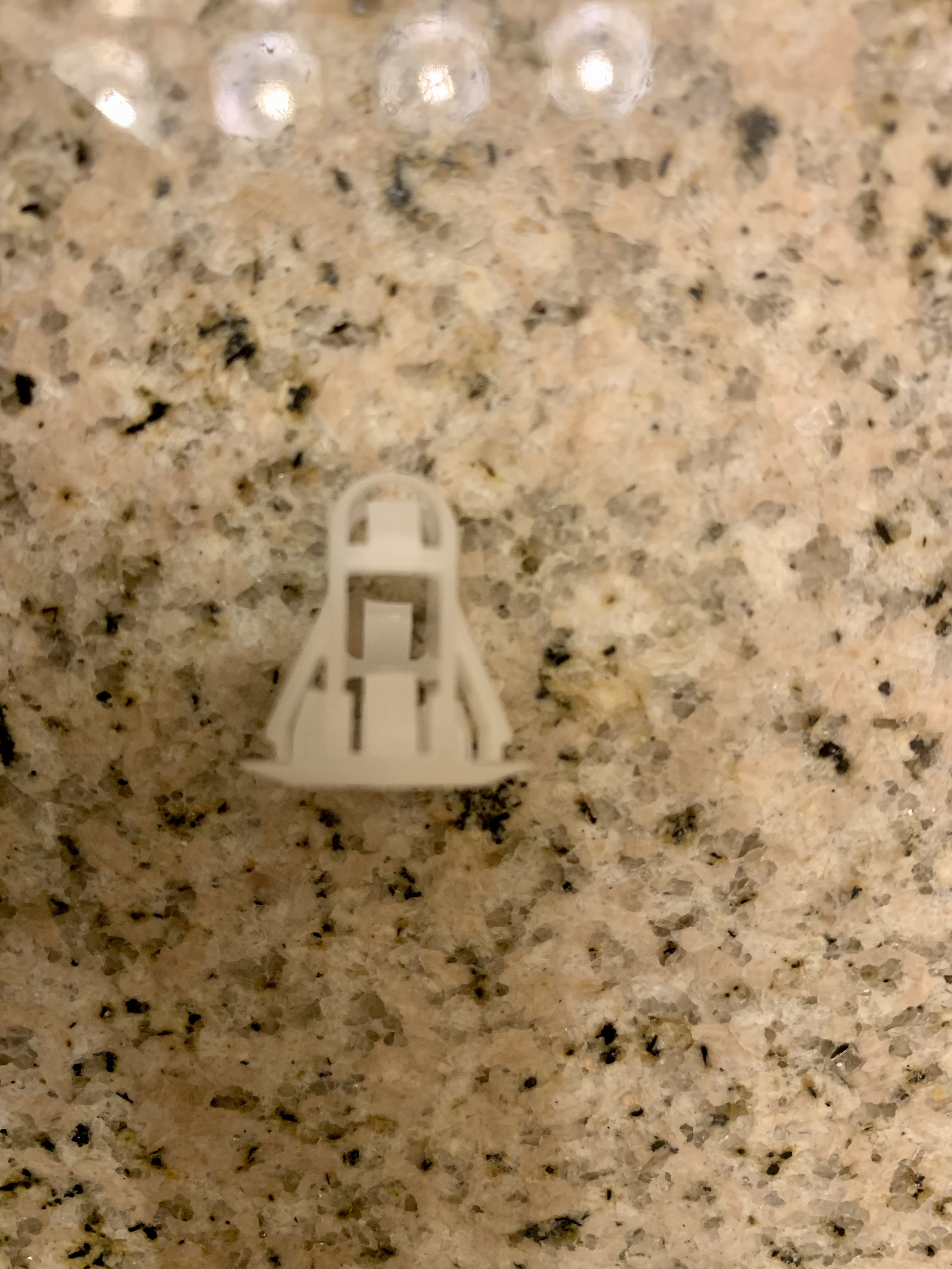

I believe the PN for the clips is 84448584, but not 100% sure. They are inexpensive enough to order at the dealer and find out.

I'm going to install the Tapout carbon spoiler after the ceramic cures and I have a warm day to help cut through the tape on the stock spoiler. The 4BW has those same white retainers on the outside, right? I assume you didn't reuse them for yours and you used the Tapout nuts? If so, isn't the hole larger for the plastic retainer? I was going to order a pair of retainers in case I broke to originals like it seems many have done in their removal experiences. I thought having the retainers to look at might also help me figure out how to disengage them without destroying them.
Sorry not trying to hijack this thread, I broke one of the stock retainer clips on the 4 and when I tried to reuse one of the good ones, I couldn't get the tapout wing to sit flish against the trunk. I pulled it off and switched to nuts to torque it down tight. It's the same clip that was posted above. I did have to use washers as the nuts slid through the larger holes
