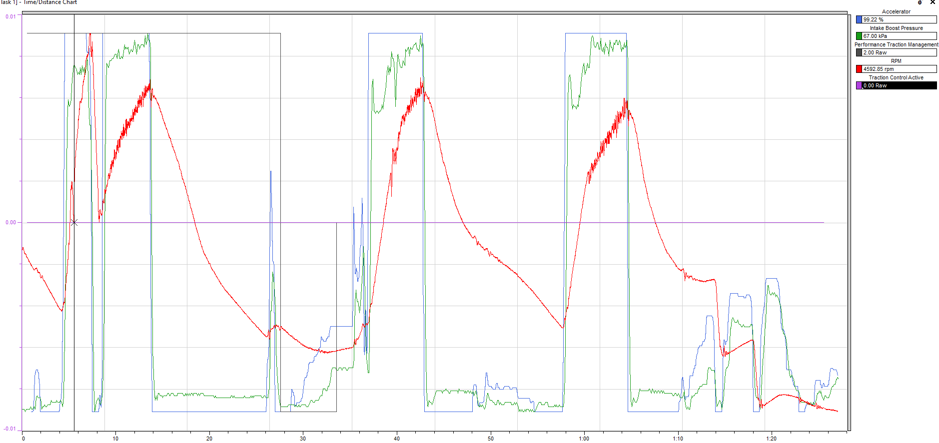

Latest update - Still no joy! GM decided to install a special data recorder that transmits data back to them. I have a button to push when the car does its thing. It isn't difficult to reproduce but GM didn't want the dealership driving it that hard. While I trust my tech, I understand. So I took it out and made it fail pretty badly today and pushed the red button they installed so they know where in the data to look. My only concern is that it took them a week to get the data recorder working and transmitting correctly. The GM FSR had to come in at least twice and work with it. Anyway, the hope is that they will be able to locate the issues by analyzing the data.
I also recorded a couple of runs on my PDR and have used the Pi Toolbox to examine that. It starts missing around 4500 and on one run, stopped accelerating totally at 5000 rpm. I have attached a screen shot of the Pi information and you can see the manifold boost going nuts just prior to the misfire starting. I have no idea which is causing which as they replaced all the Supercharger seals. Really not sure this is the least bit helpful in identifying the issue but though you might find it interesting.
Also got TC errors and Rear Axle errors while It was making these runs. Having so much fun!

Update - GM has analyzed the data I have generated and concluded that it is a fuel starvations issue. They have directed the dealer to replace just about everything from the high-pressure fuel pump forward. GM says they will look at all the parts and try and figure out which was the cause; that is assuming that fixes the problem.
But I have felt all all along that it was a fuel issue.
Dealer is waiting for all the parts and I am a little hopeful.....
this sounds like a similar problem to mine. the starvation nuked all the spark plugs on one bank as well as the rings. required engine replacement. they also replaced the fuel rails, evap canister, fuel lines, and fuel tank.
