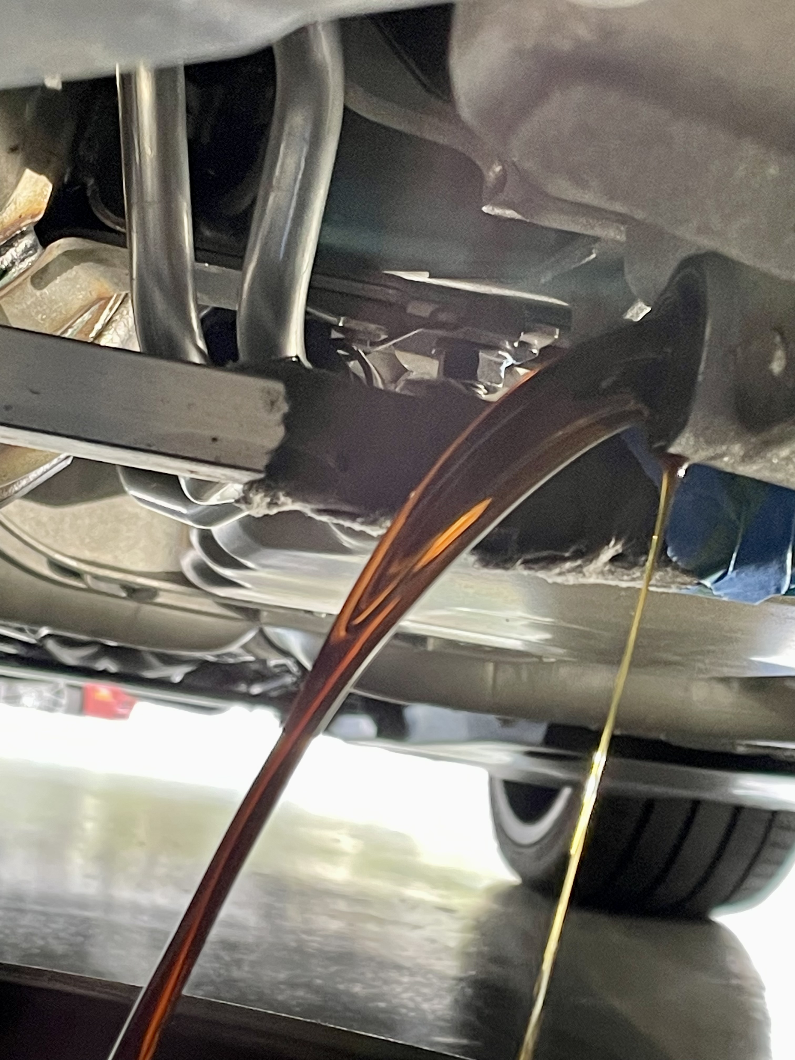

For the oil change topic- I will not go to a dealer unless I have no choice!! I changed mine at 849 miles and didn’t mind paying for the oil & filter myself. Last year on another car that I took to the dealer for a brake flush, they forgot to reinstall the brake reservoir cap🤬 and contaminated my brake fluid. I didn’t catch it for months because the brake reservoir was under another cover. Changing the oil & filter myself also allows me to check under the car issues, granted with this low miles, didn’t expect any.

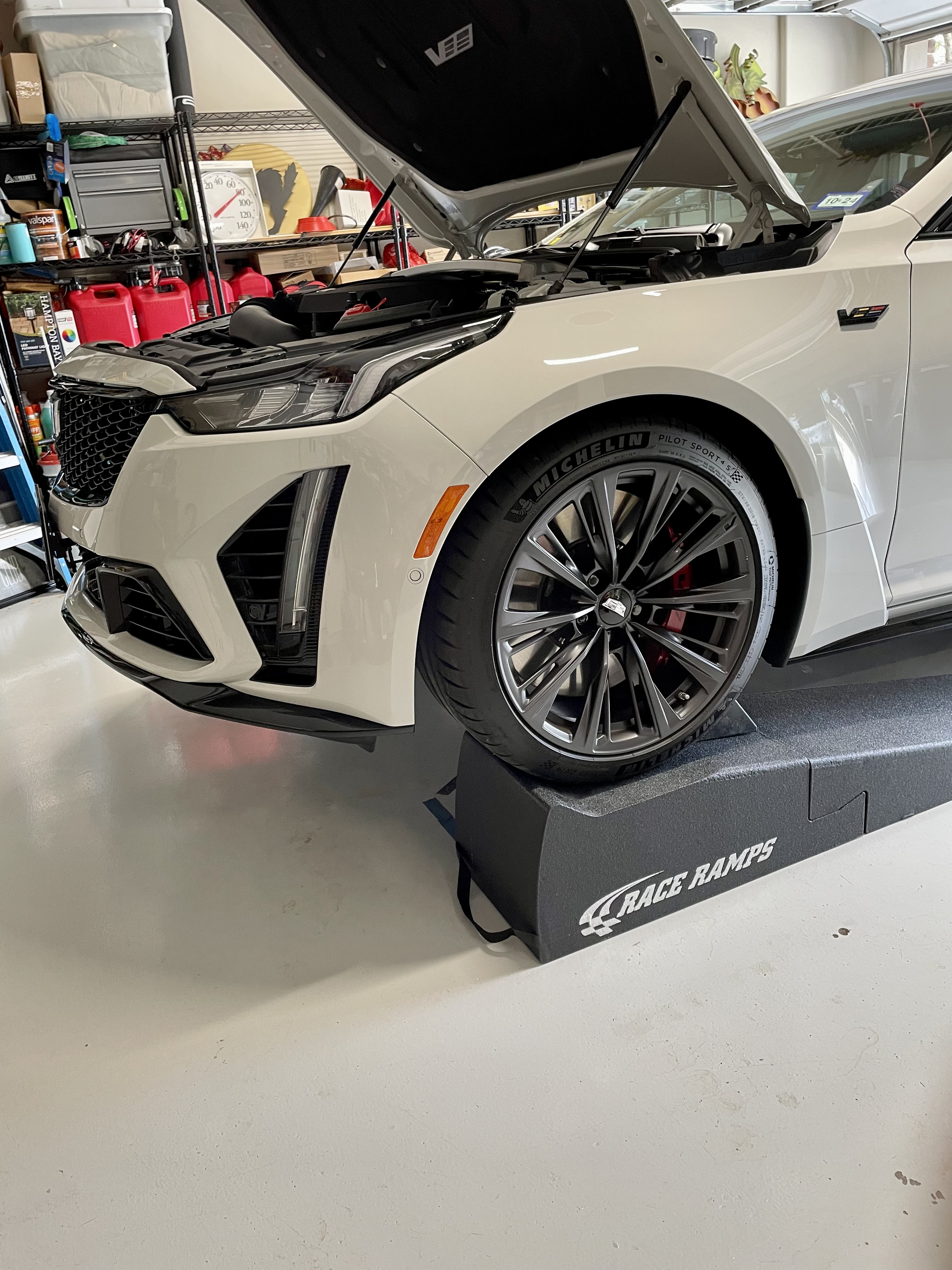

I changed my oil at 1000 and then every 3000, mainly because I don’t drive a lot of miles. I read that it is a good idea to change the oil the LF4 in the 4BWs sooner than the oil life monitor suggests. I bought the race ramps and the oil is pretty cheap at Walmart.

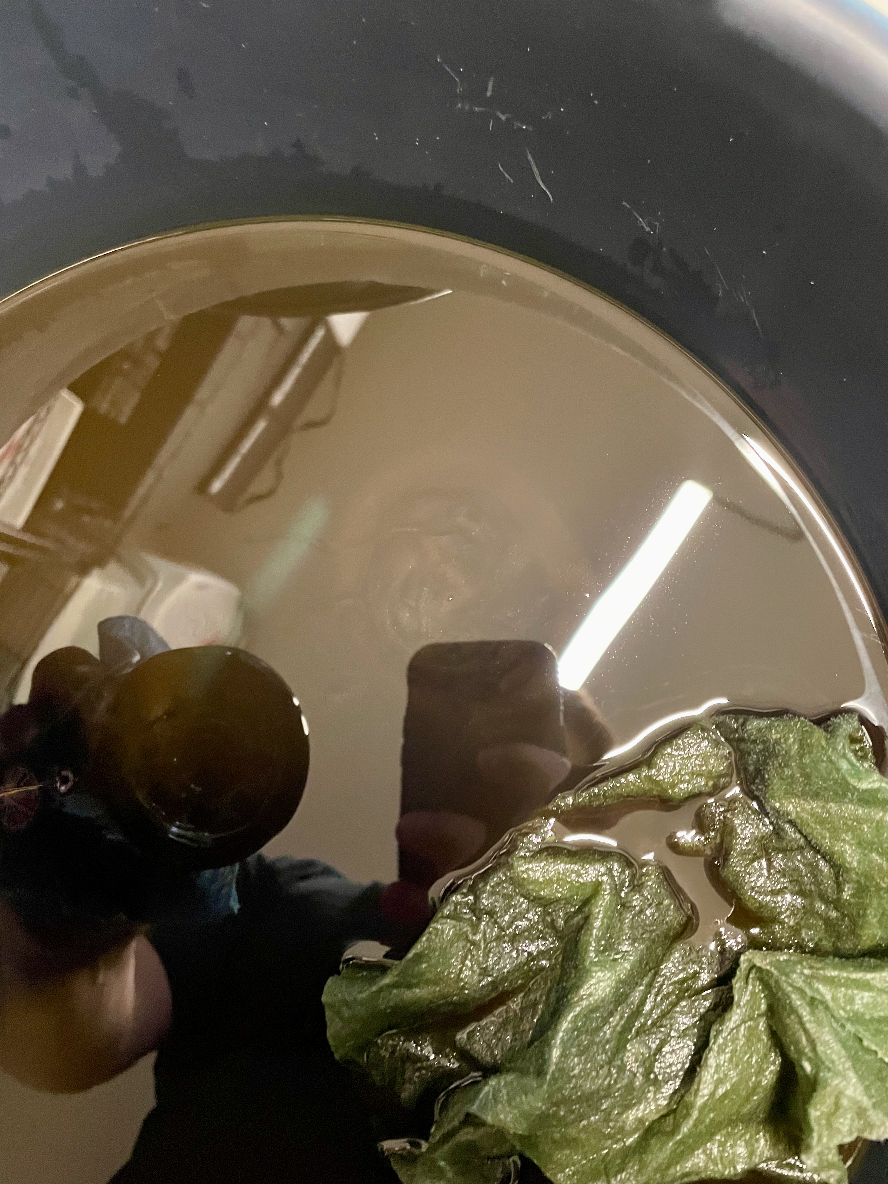

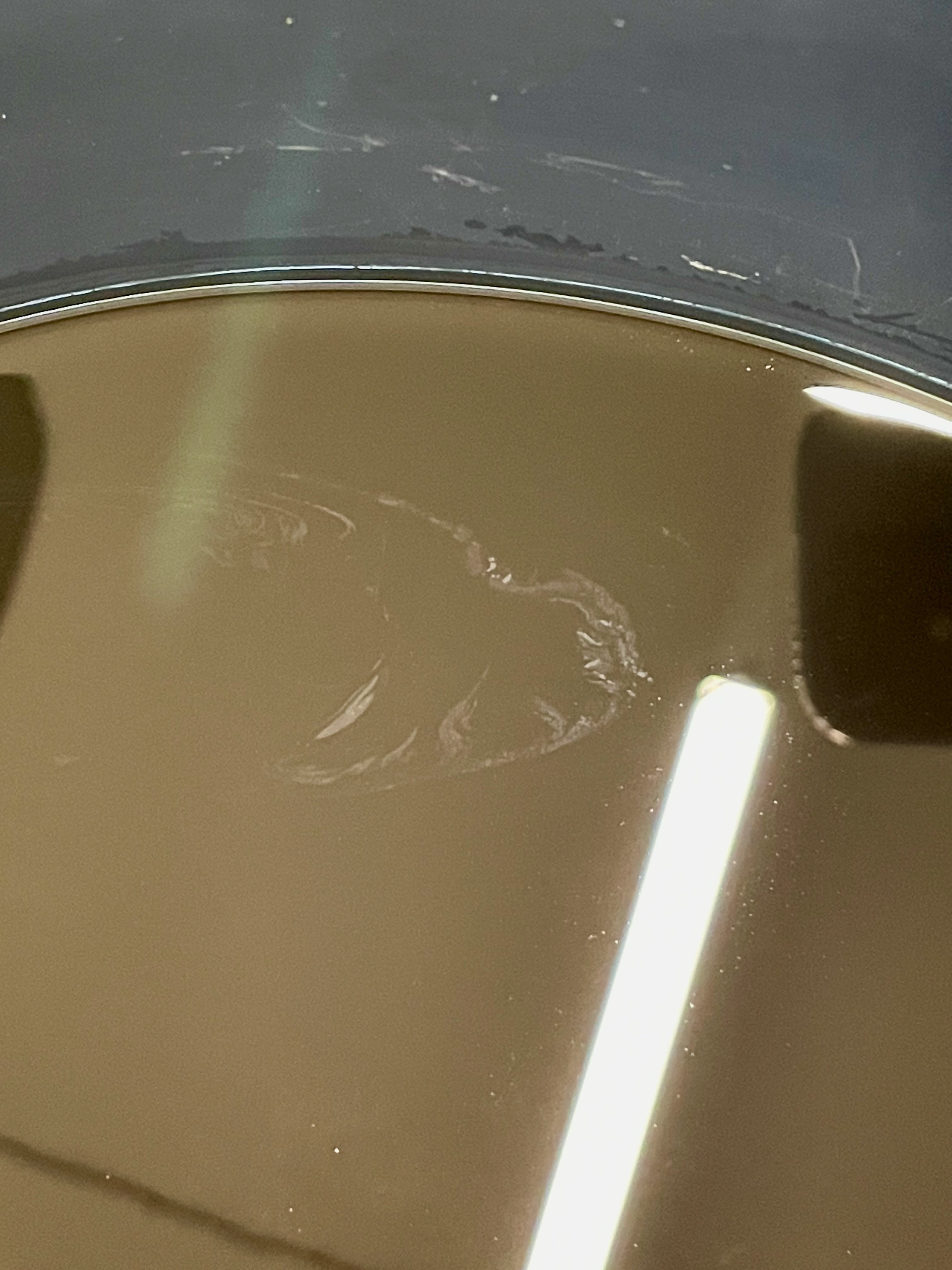

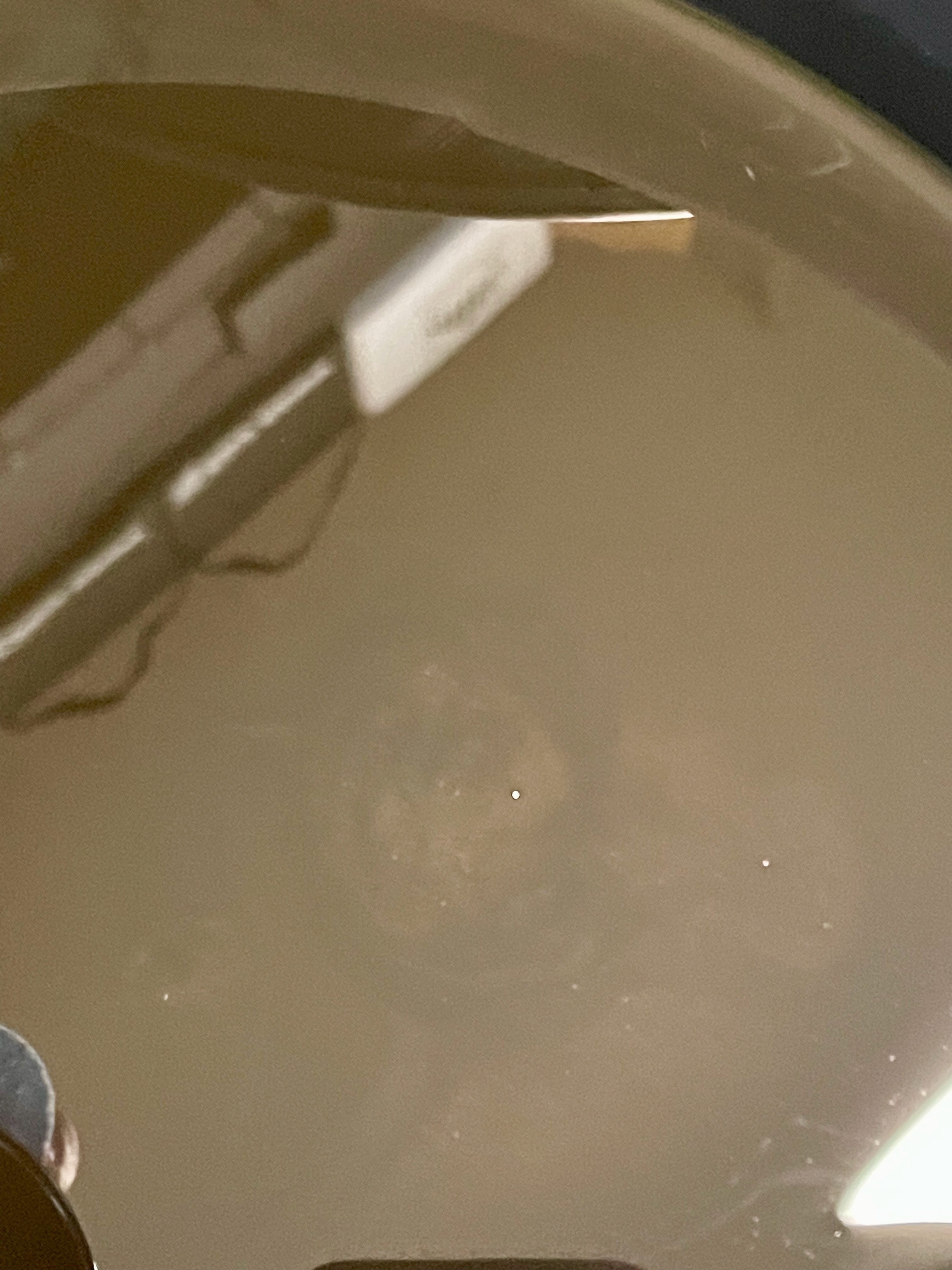

When I changed my oil at 849 miles on my 22 5BW, my oil filter left a nice puddle of shine metal in the oil when it was turned upside down for a couple of minutes to drain before disposal. See those pictures below. Normally you would miss this if a dealer changes your oil & filter. BTW - I expected some metal, so not shocked BUT glad I removed it from further circulation. I will change one more time at 1500 miles, then annually or 3000 miles, whatever comes first for my peace of mind.

849 miles on my 22 5BW, shiny residue in oil from factory oil filter (excuse the rag that fell in by accident on 1st pic). All the oil in this particular container came from just the oil filter removal that drained out from the engine:
