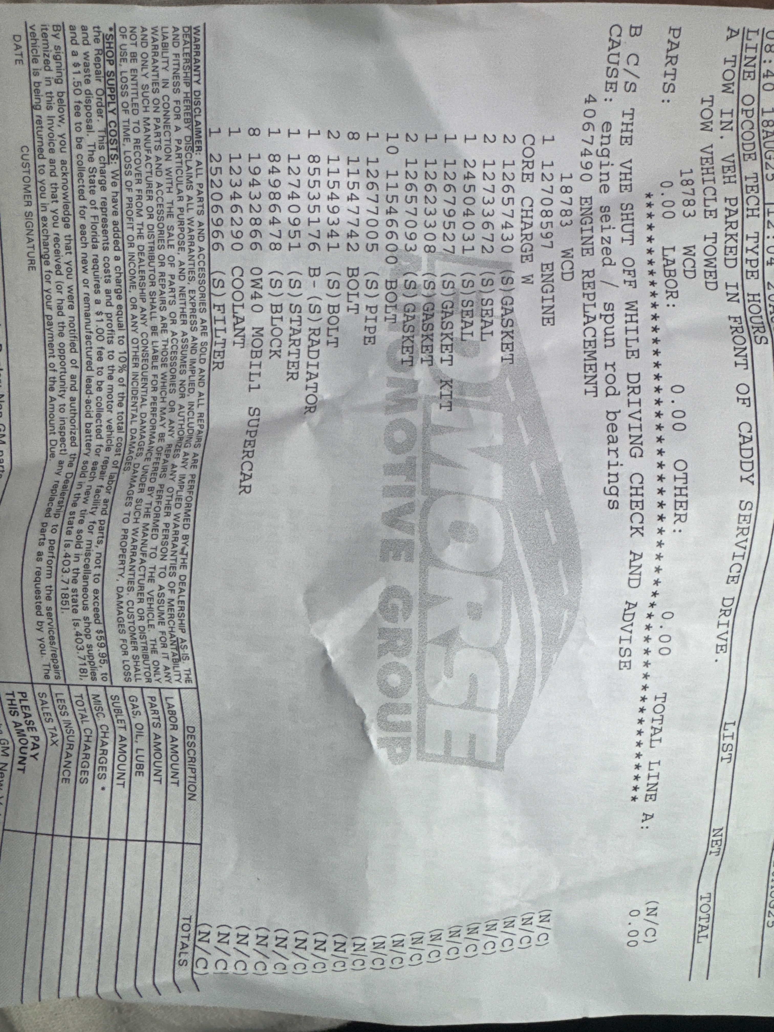

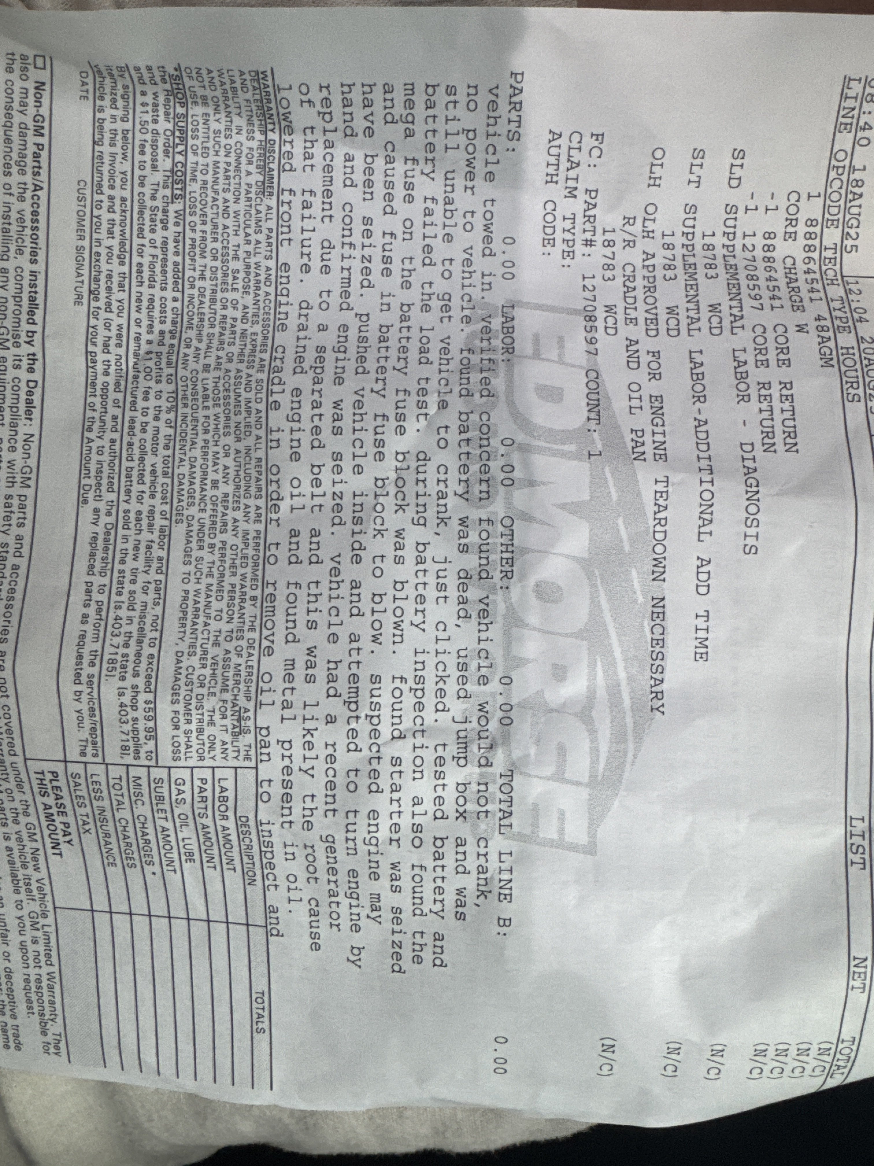

Here’s the part numbers and the description from tech also is there a way to physically tell if it is the lr4 like numbers or what not on the engine, also in the last pic it said the eun(engine unit number) changed. Is there a way to use that and see ? Thanks for all the help everyone i really appreciate it it !! So i should get an oil change around 500-1000 miles , i asked him he said no but that doesn’t sound right , and he never explained the break in lol like so there rules of rpm or speed or anything ?
Per this, you're good: Genuine GM Parts 12708597 - 6.2L LT4 "Blackwing" Wet Sump Engine Assembly, Service
@Jakemey, the work order only lists 8 quarts of Mobil 1 supercar. Check your oil. LT4 requires 9 quarts.
Better safe than sorry.

Can you provide a print out of your receipt from the shop with the part numbers they replaced?

I'm not concerned at all that they replaced your engine with an LT4 long block. I'm certain they did.
Well, yeah, now that we have the part numbers...
