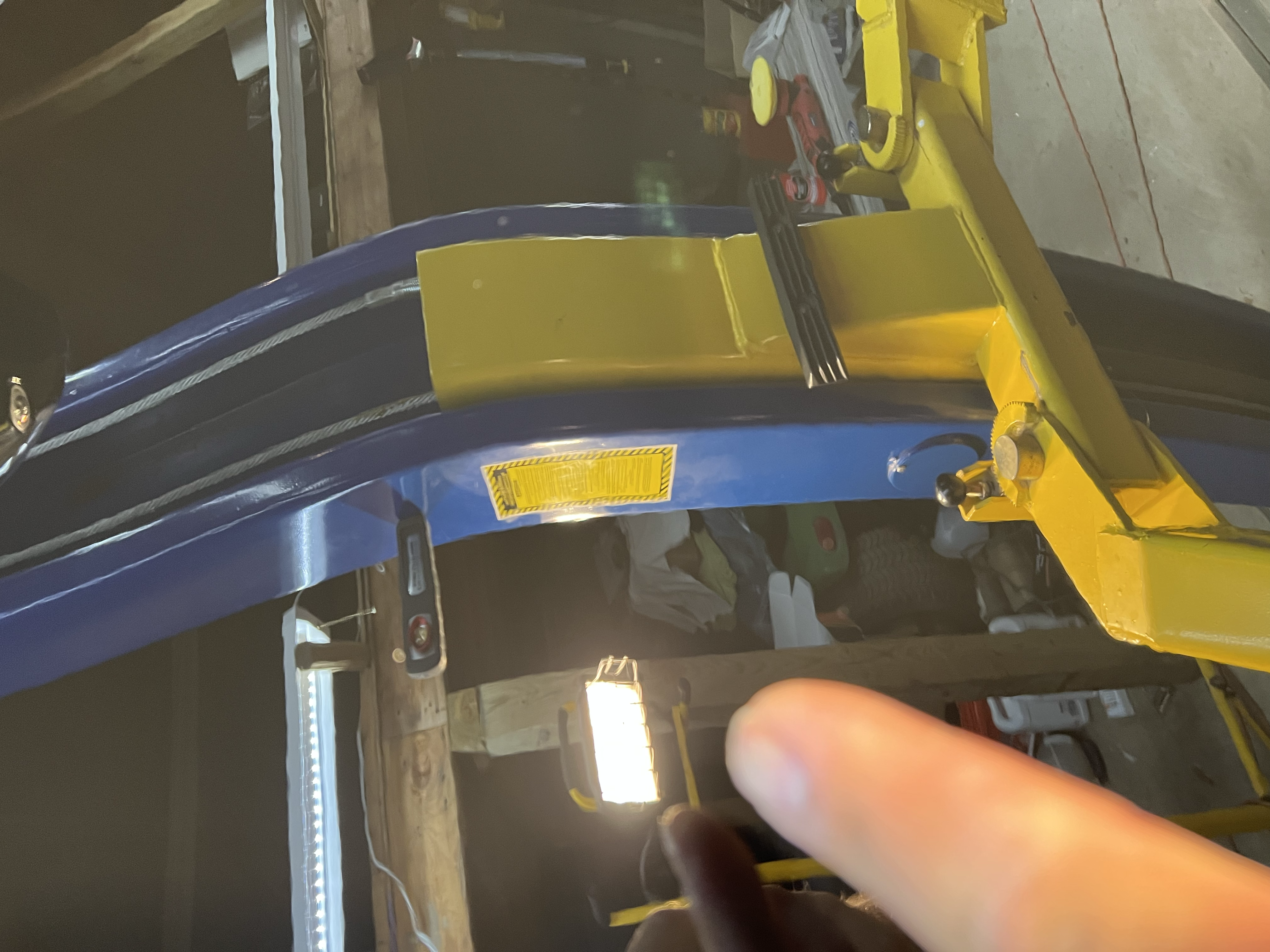

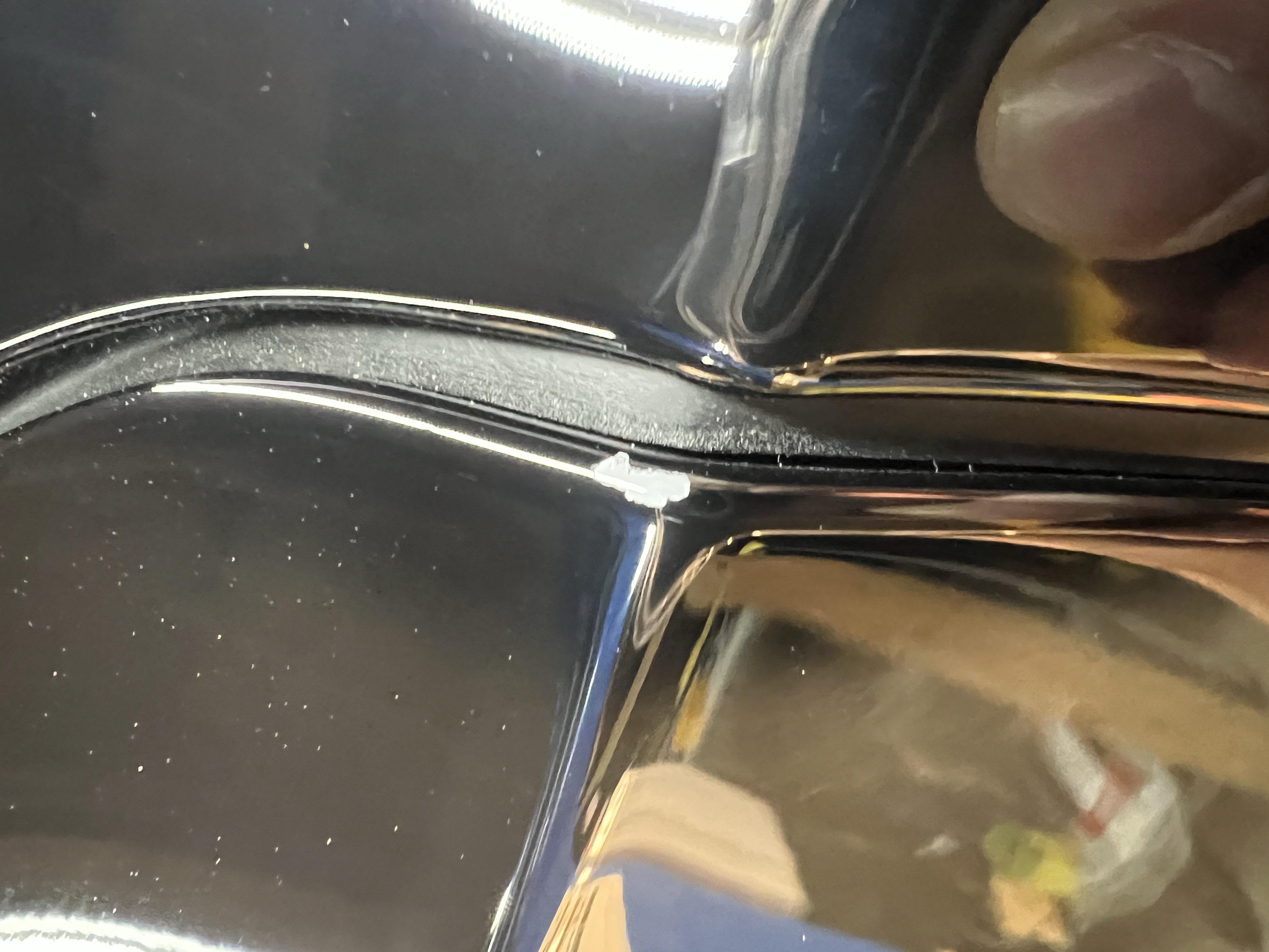

I had a little free time last night and worked on more paint correction. I found a nice paint chip on the leading edge of the passenger door where it meets the front fender. The amount of defects I'm finding is ridiculous. I towed the car home in an enclosed trailer from the dealer who left all the wrappers on it and did not wash it. It still has 4 miles on it.
Paint chip

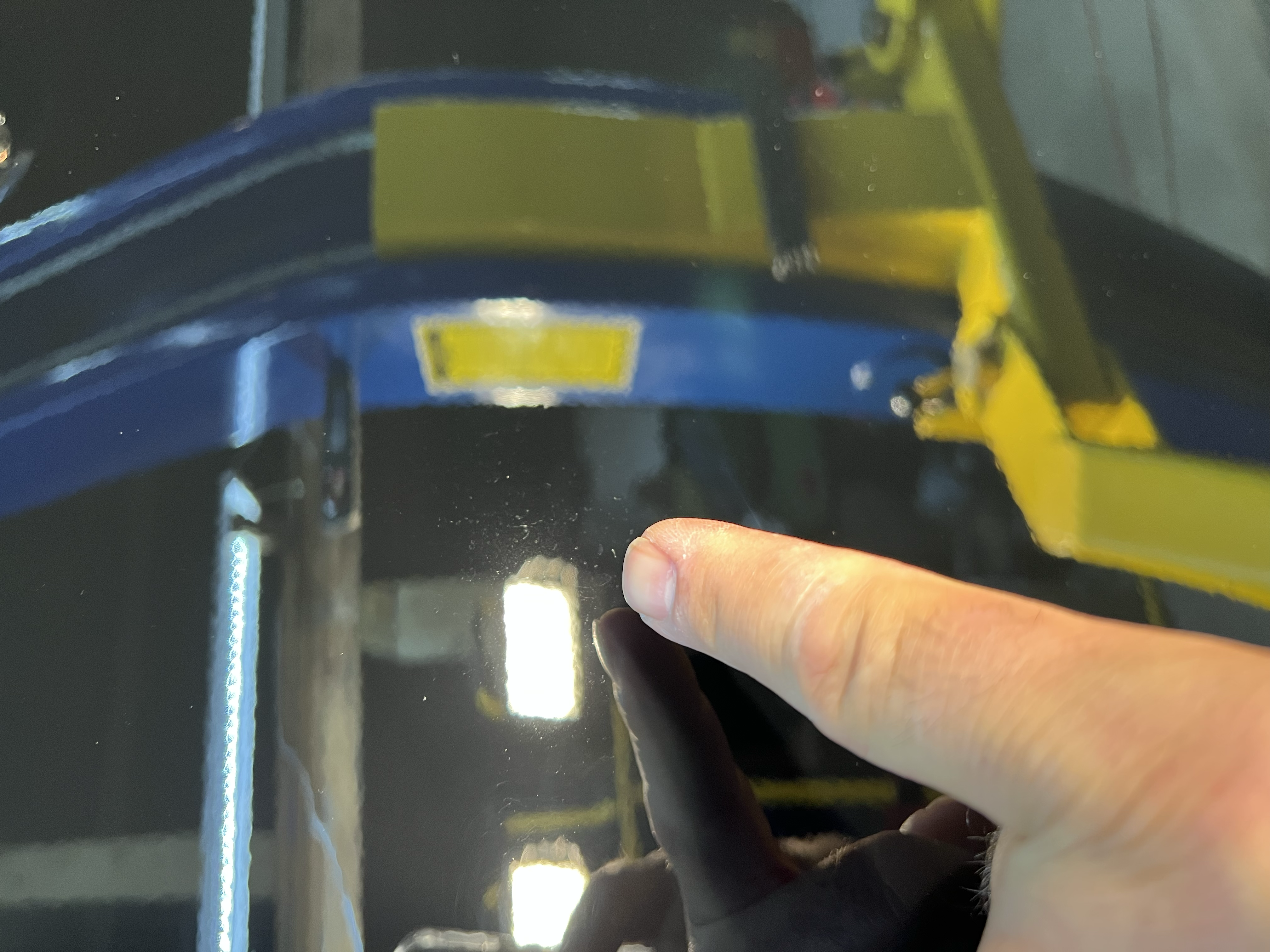

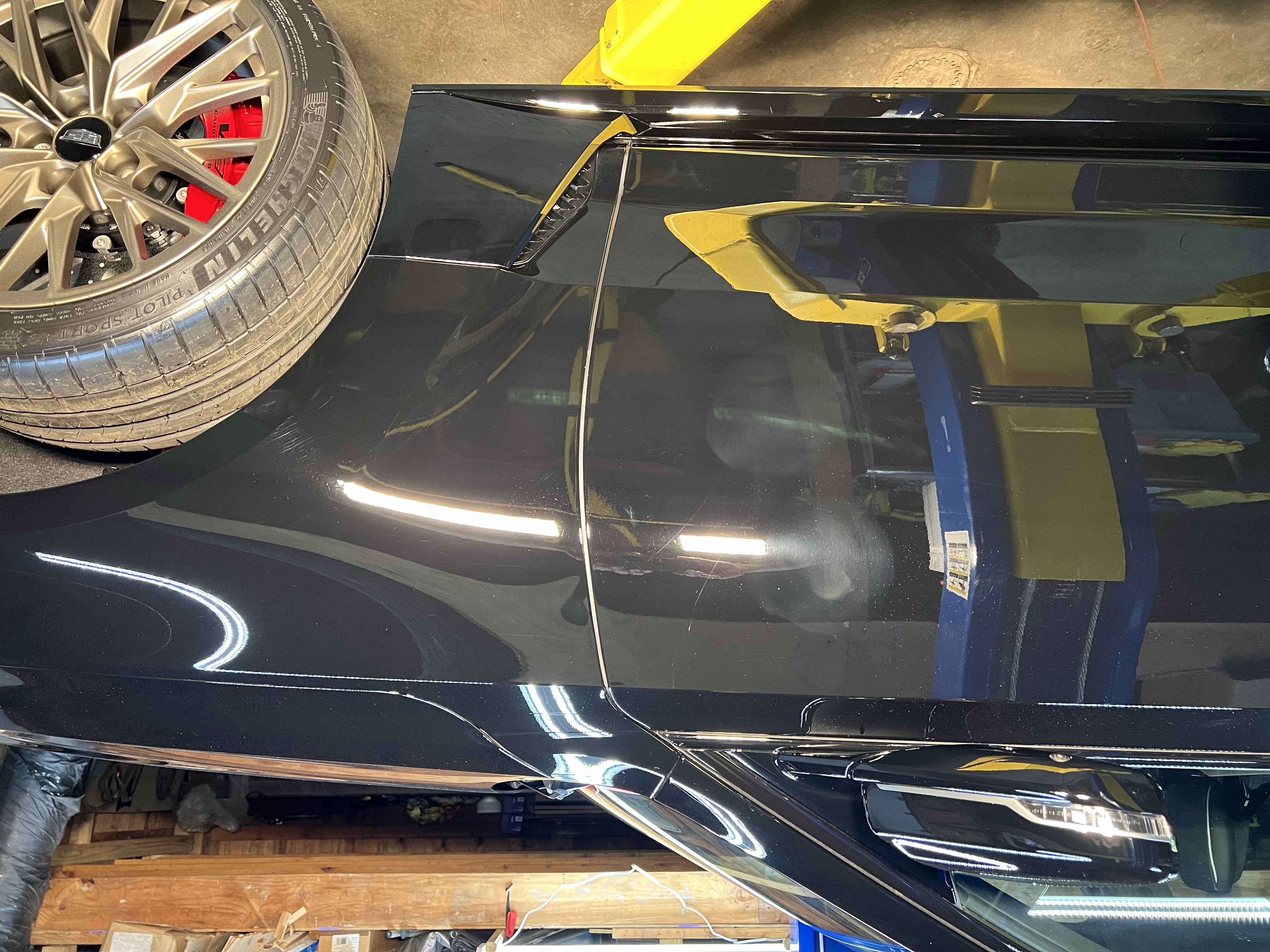

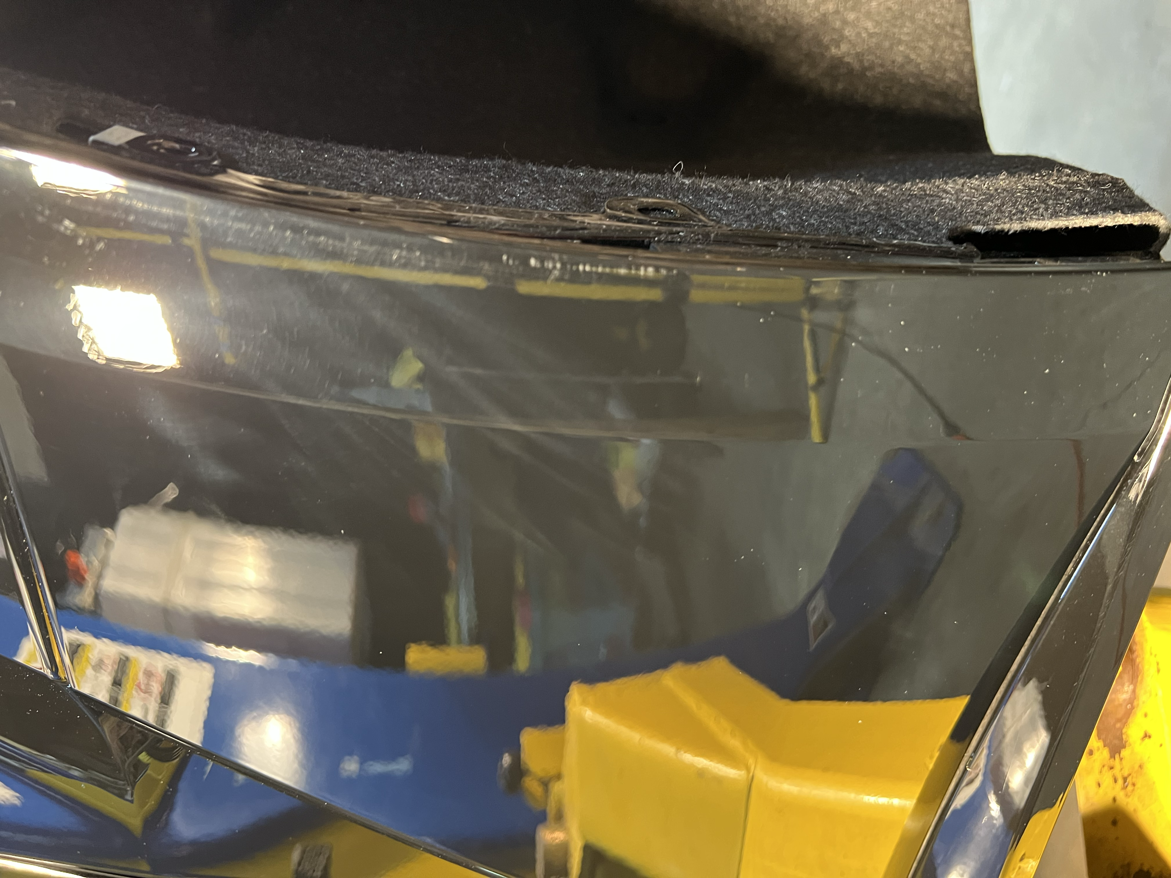

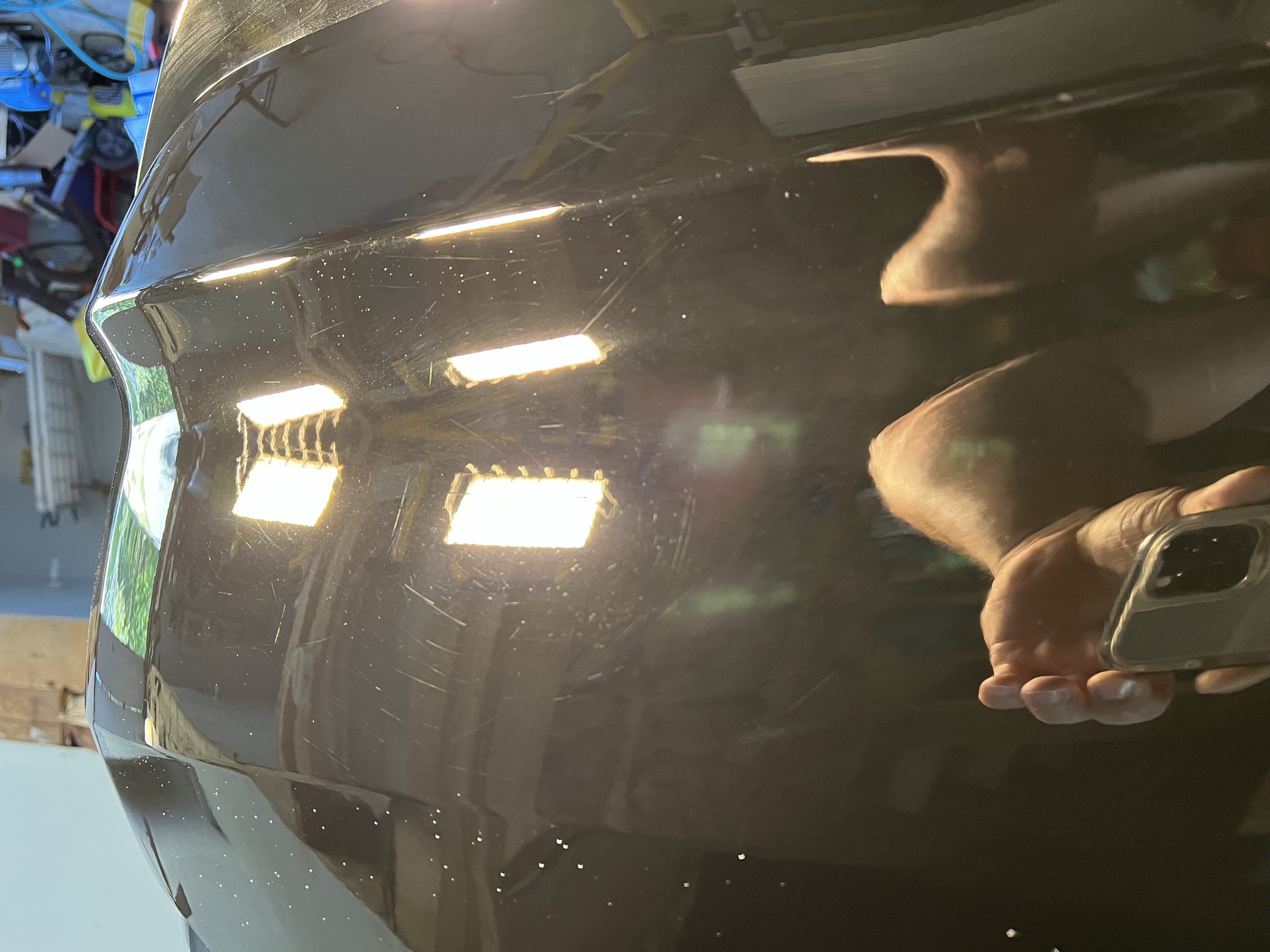

Passenger side before. Notice the two 6-7" circle areas where it appears someone spot sanded dirt nibs or something then tried to quickly polish out the sanding marks.

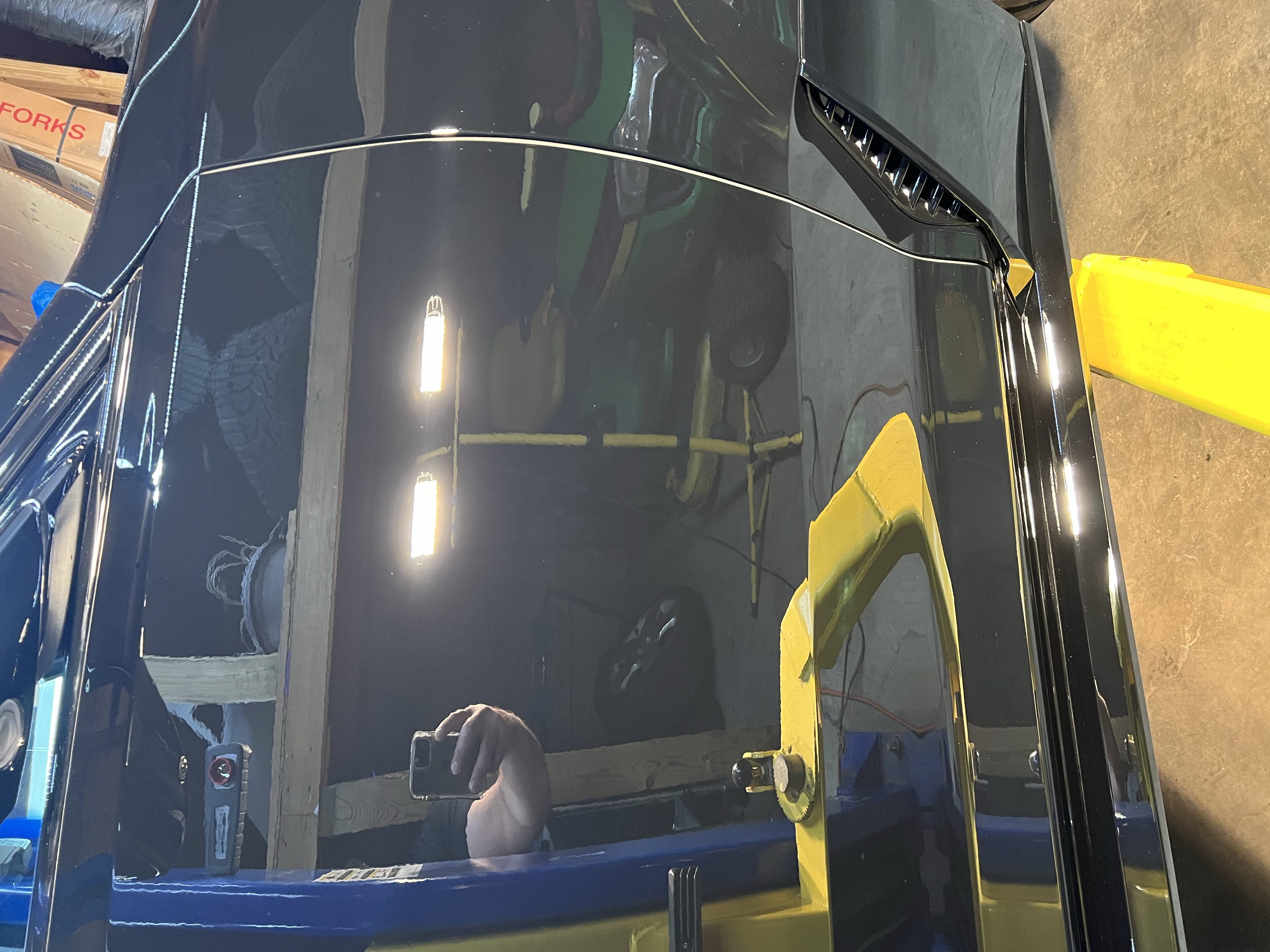

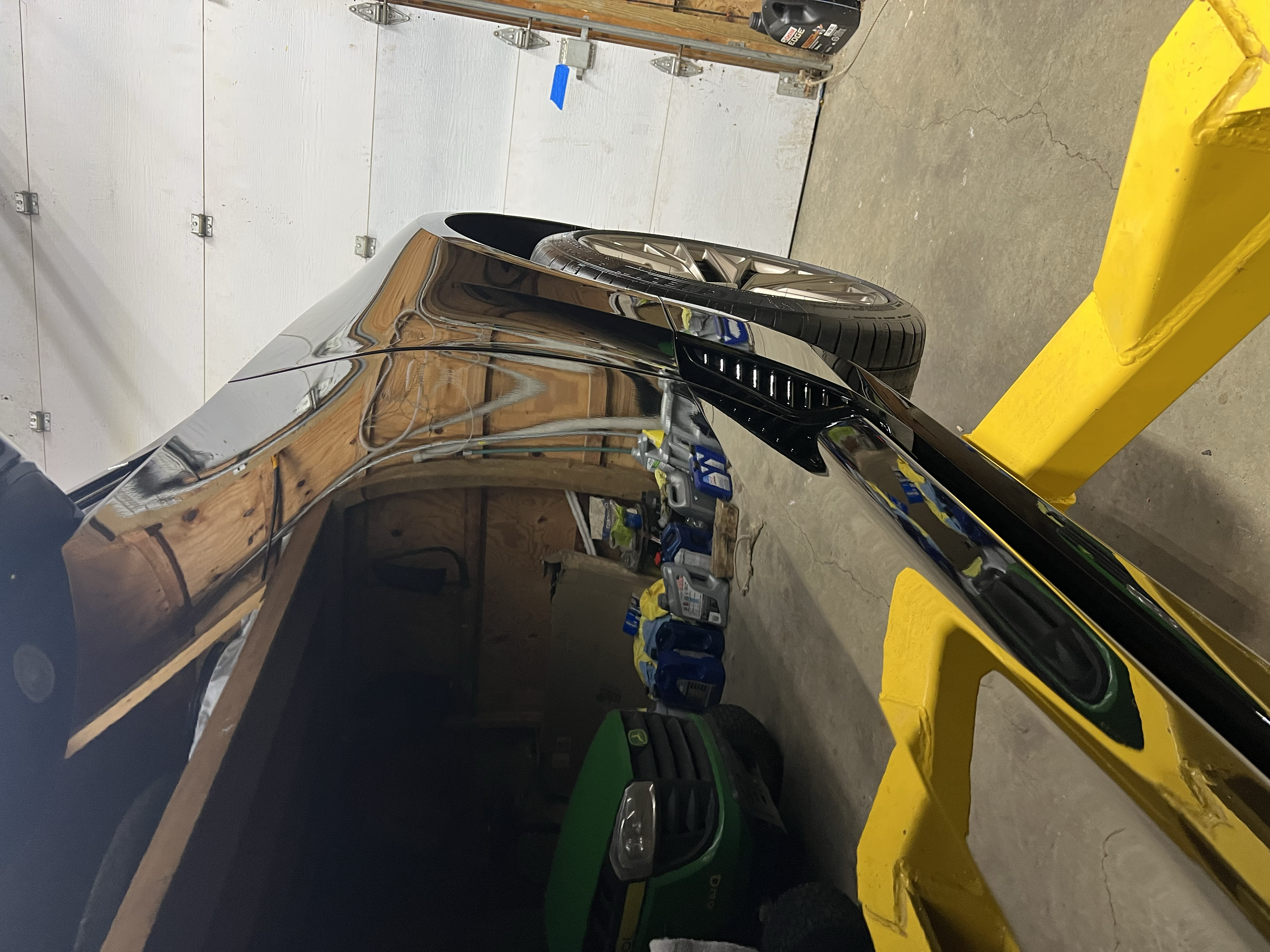

The lower part of the fender where the vent is was buffed by someone who should not be holding a buffer. Hard to see in the photo but it has buffer trails/holograms.

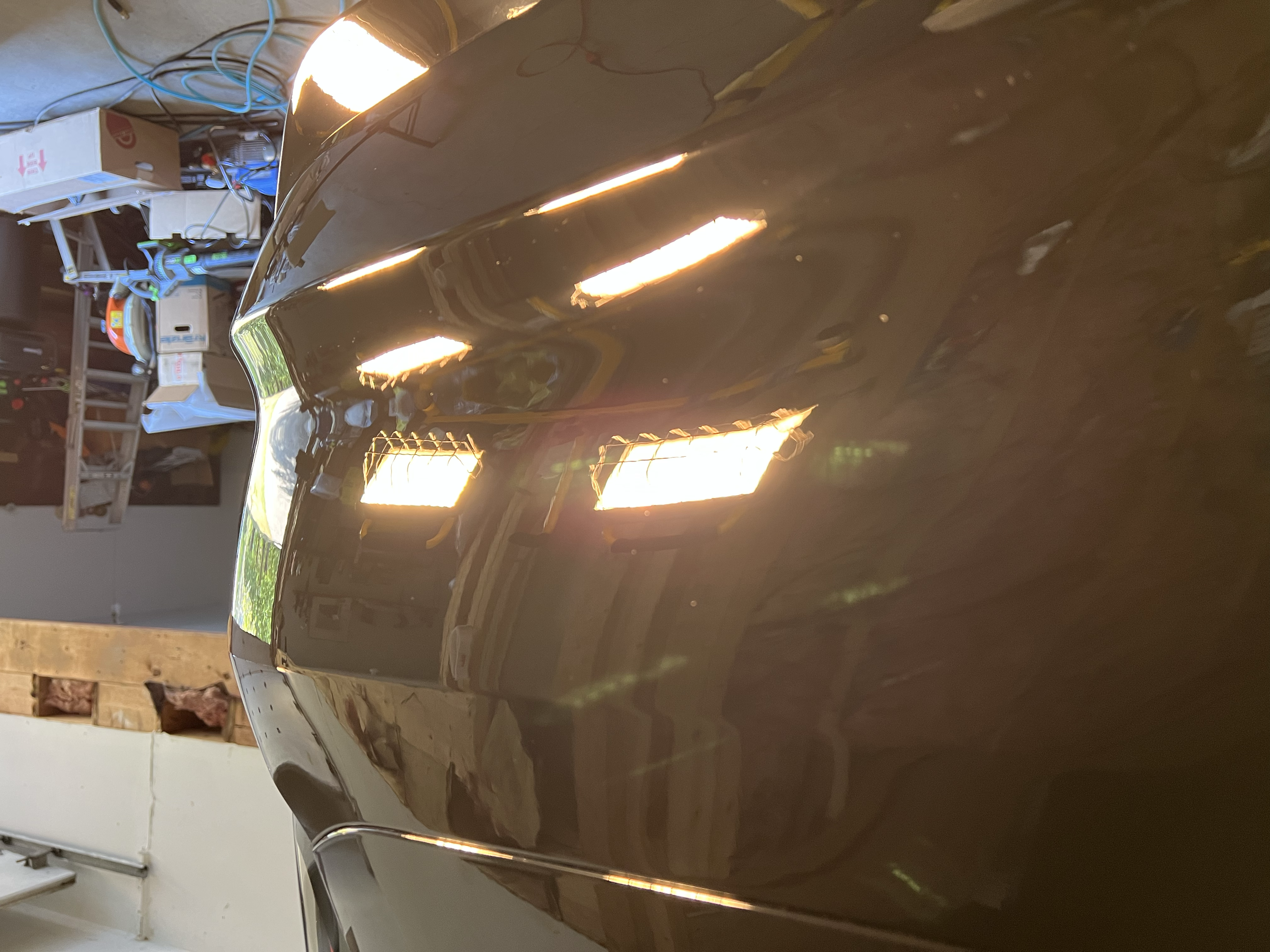

After griots fast correcting cream with a griots microfiber pad and then griots perfecting cream with a Rupes yellow polishing pad.

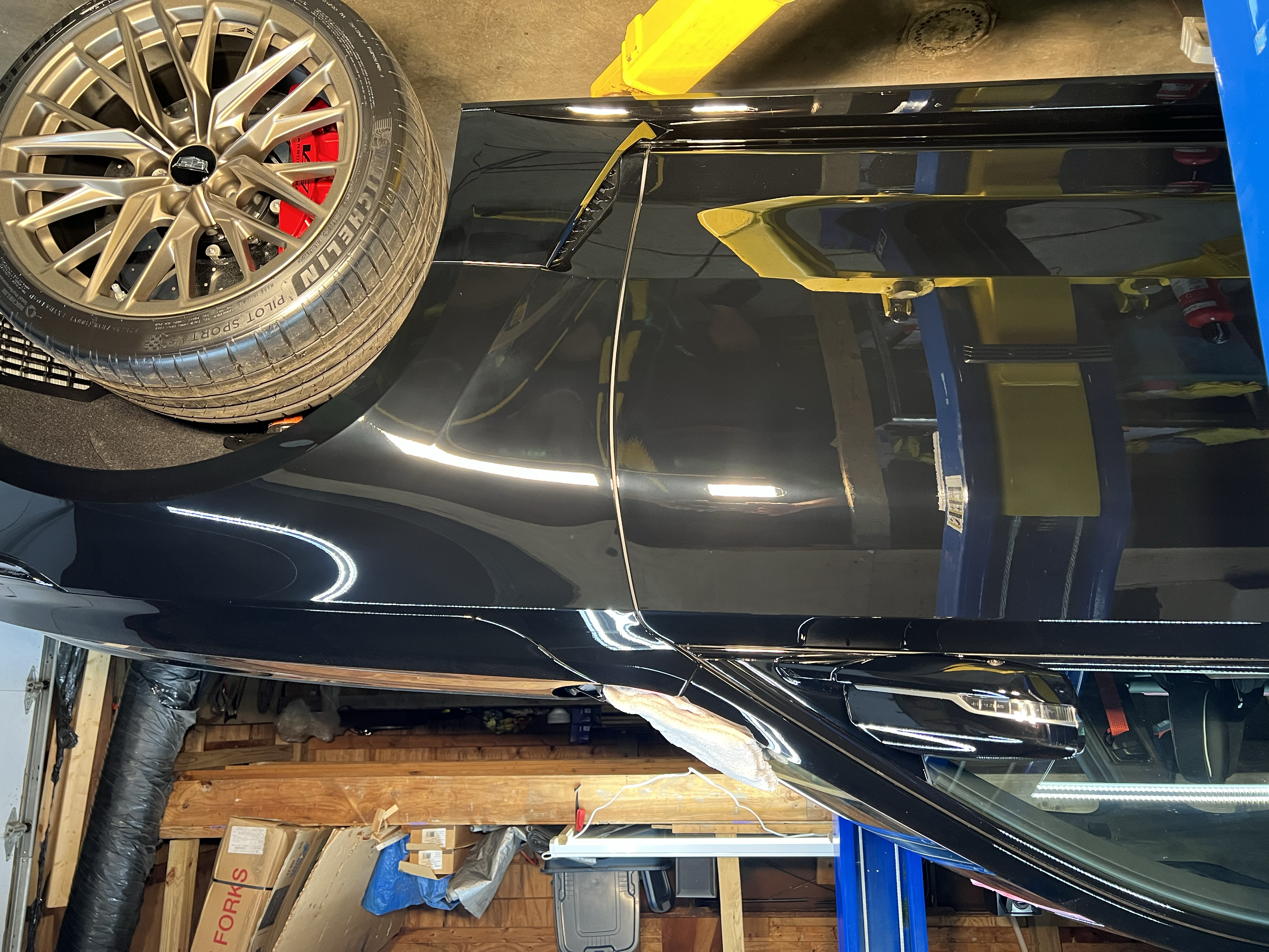

After FCC and MF pad (First stage of correction)

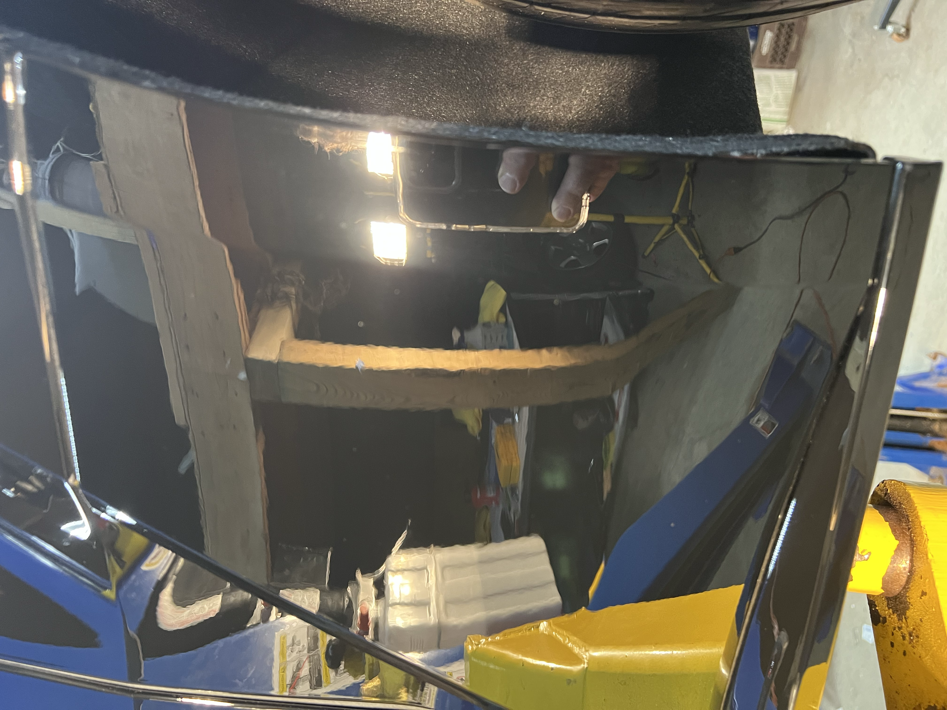

After both stages of correction
The paint looks much deeper, wetter and more black after correcting. Really noticeable in person. Hoping to finish the car this weekend. My wife's birthday is today so I might need to spend some time with her.
Nice work! What do you plan to do about the paint chip?
