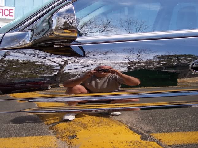

I just helped detailed my buds 04 GTP with 150k miles on the clock, he was shocked how she came out. I should've charged him.. LOL
