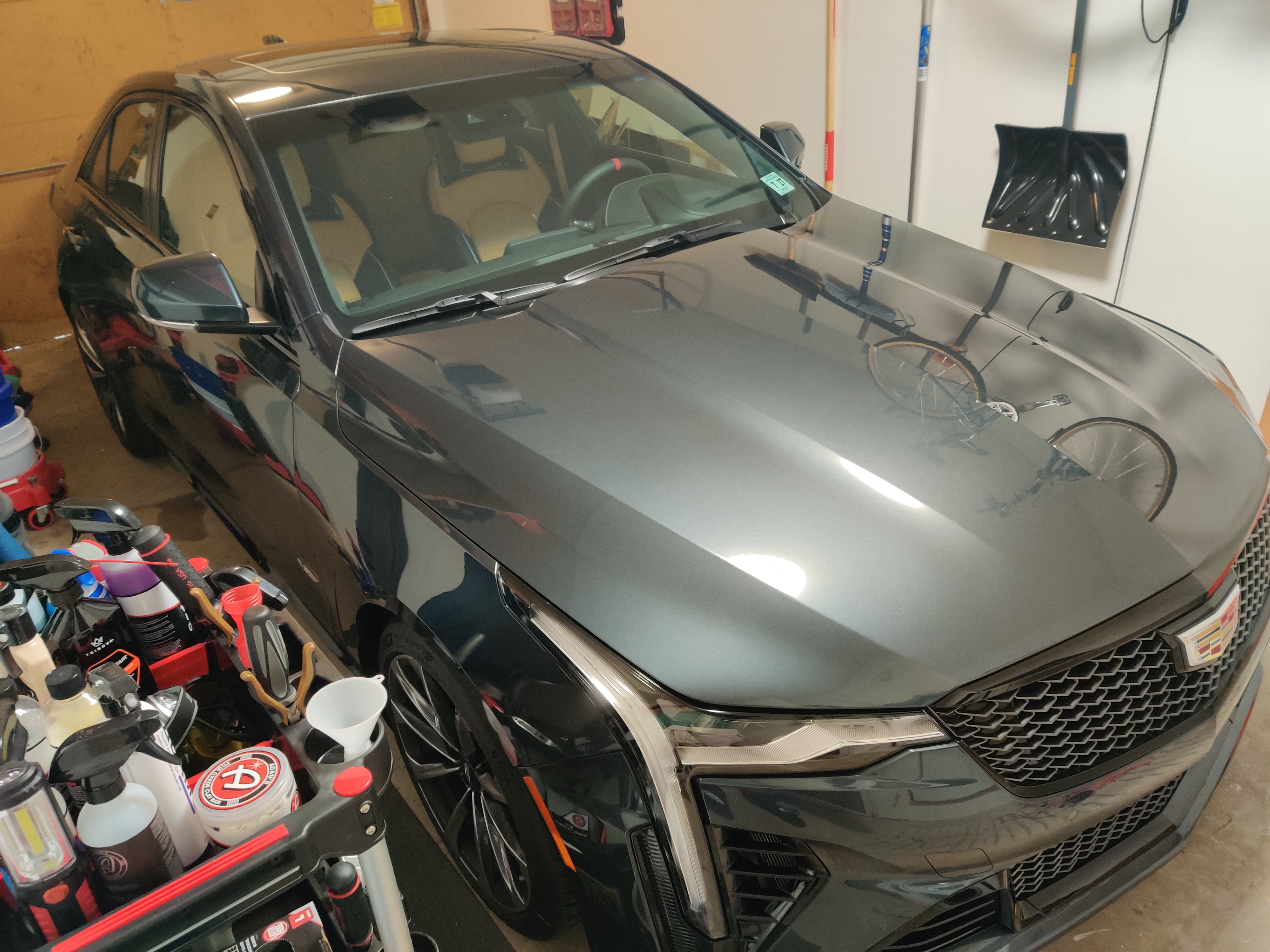

Car baking outside after full ppf....ceramic next .
Starting to get in and start to compound and polish to prep for ceramic coating. Anyone else have progress pics from yourself or your detailers?

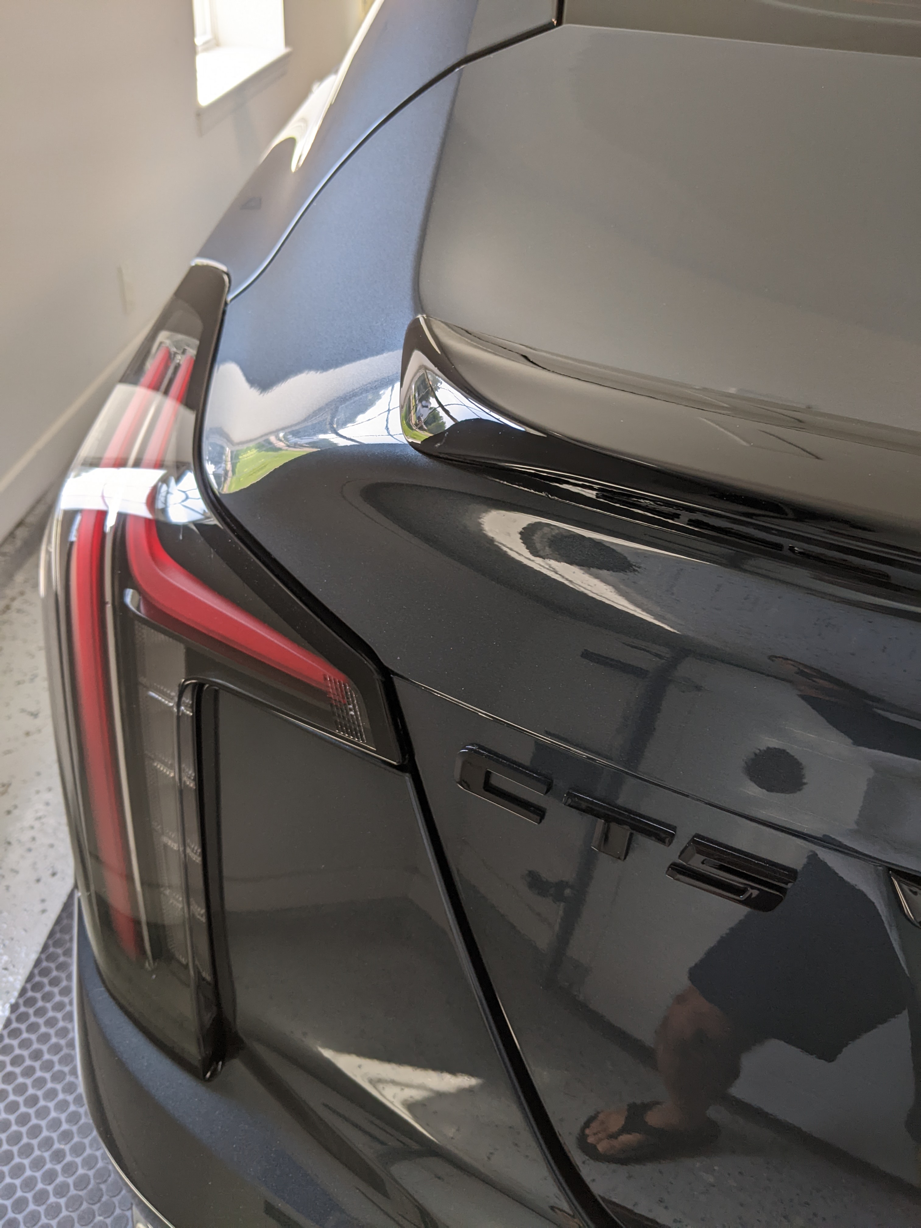

Did a full strip wash x 2 with Adam's strip wash, then surface prep spray down, followed by Adam's Graphene Ceramic Spray. It will be my daily so I coated 2x the horizontal surfaces, then added ceramic boost.
It'll probably last a few months before I will have to coat it again, but I think by then I will have the car wrapped in vinyl.

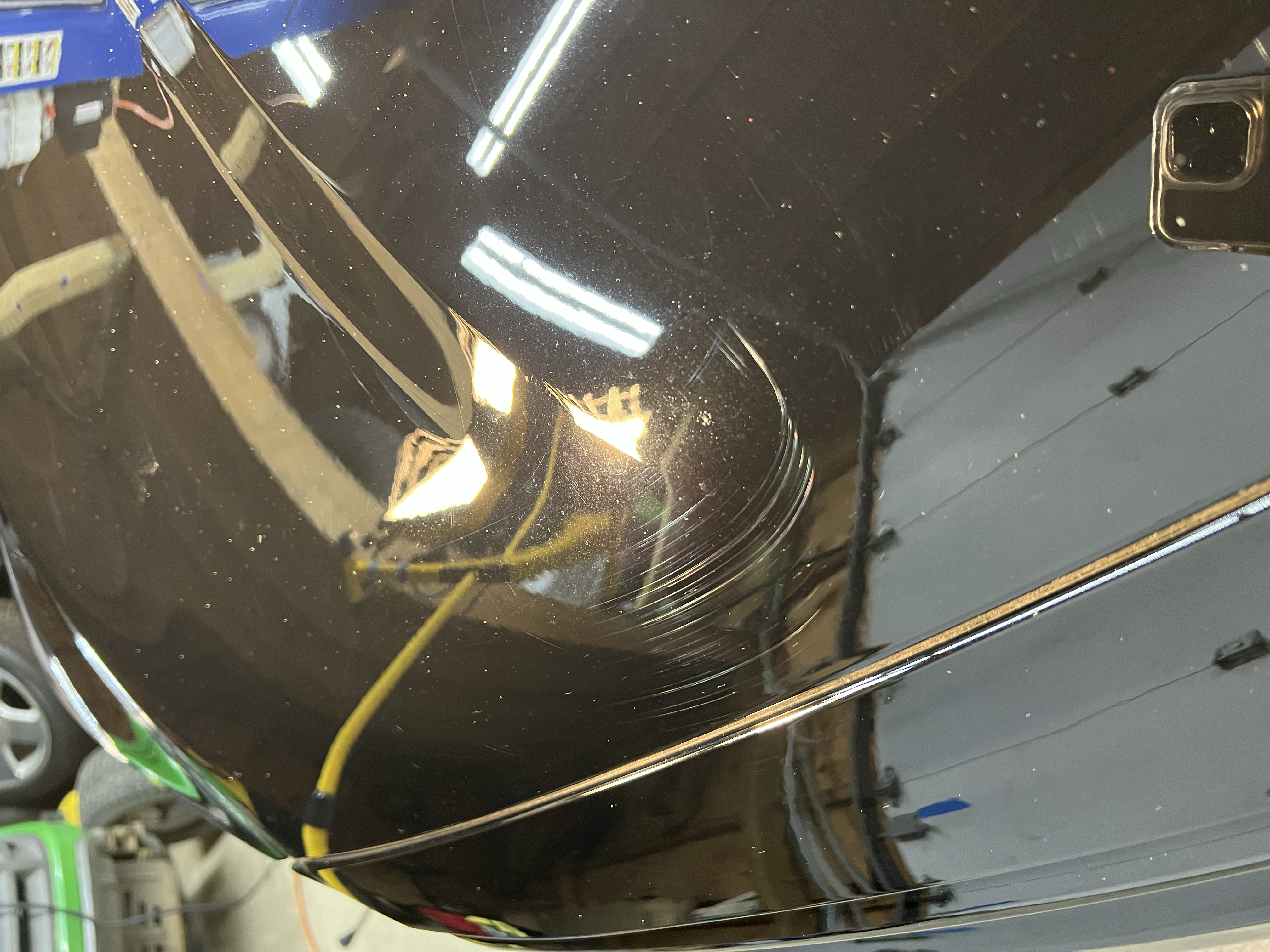

During

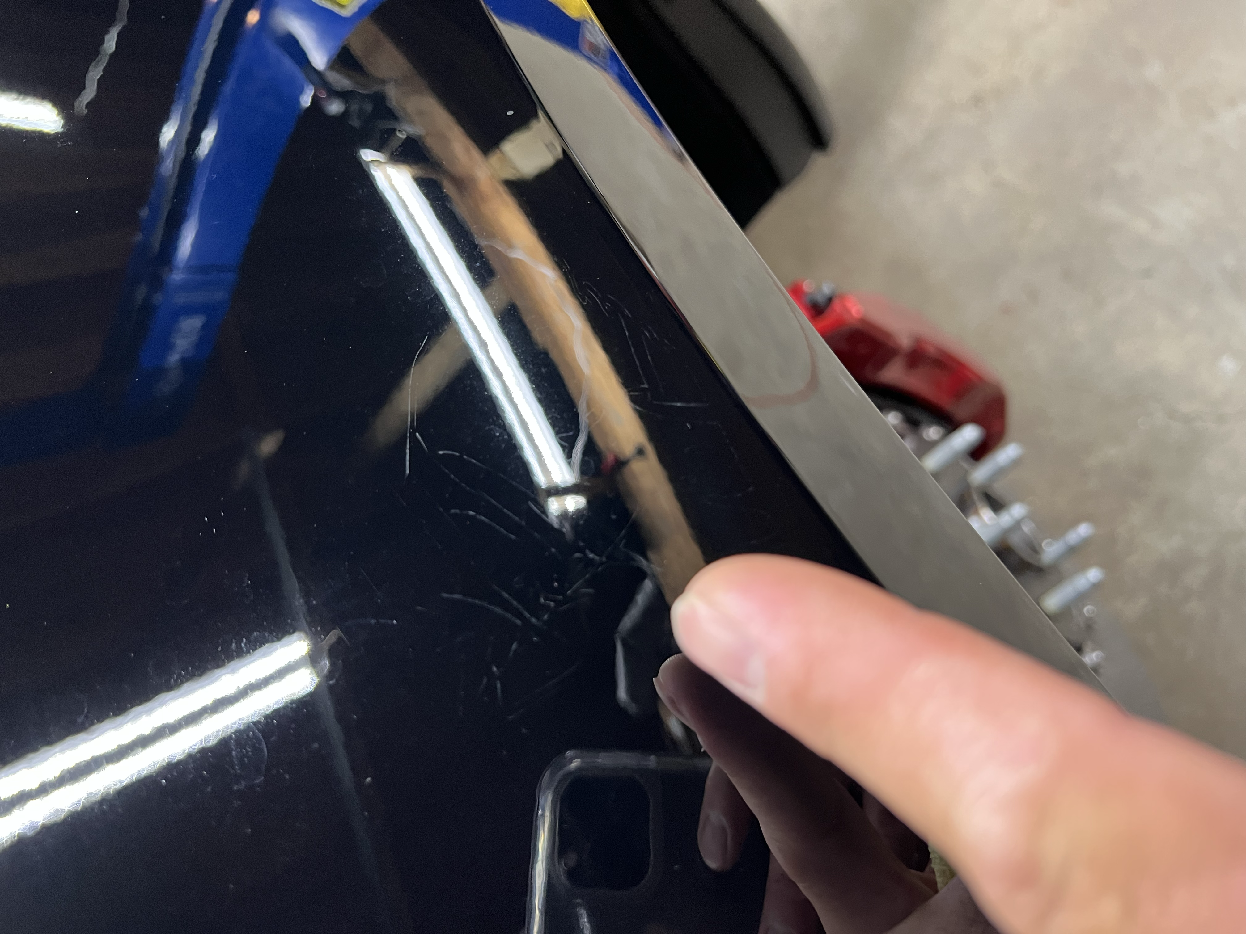

Left side is compounded right side is polished

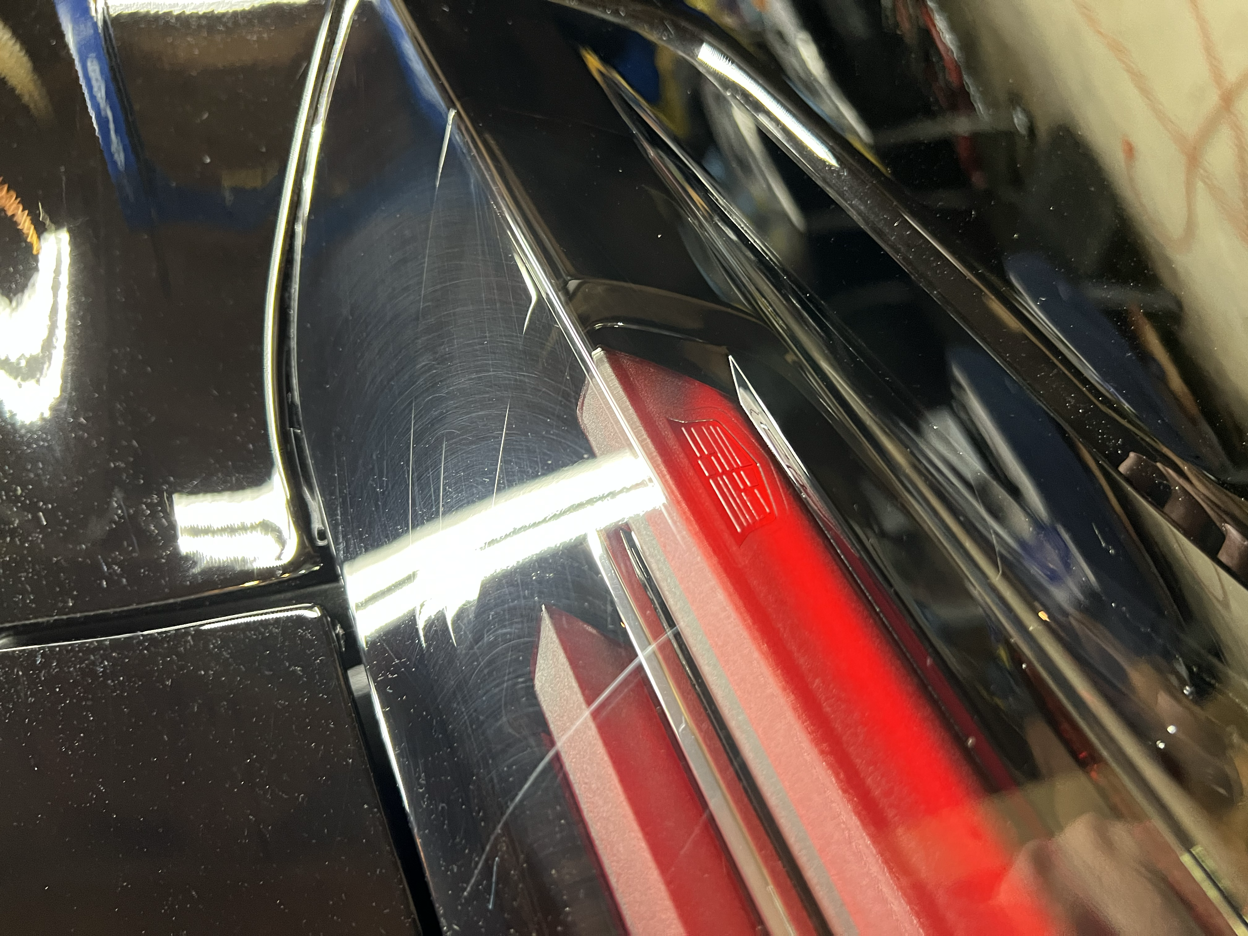

Before an after

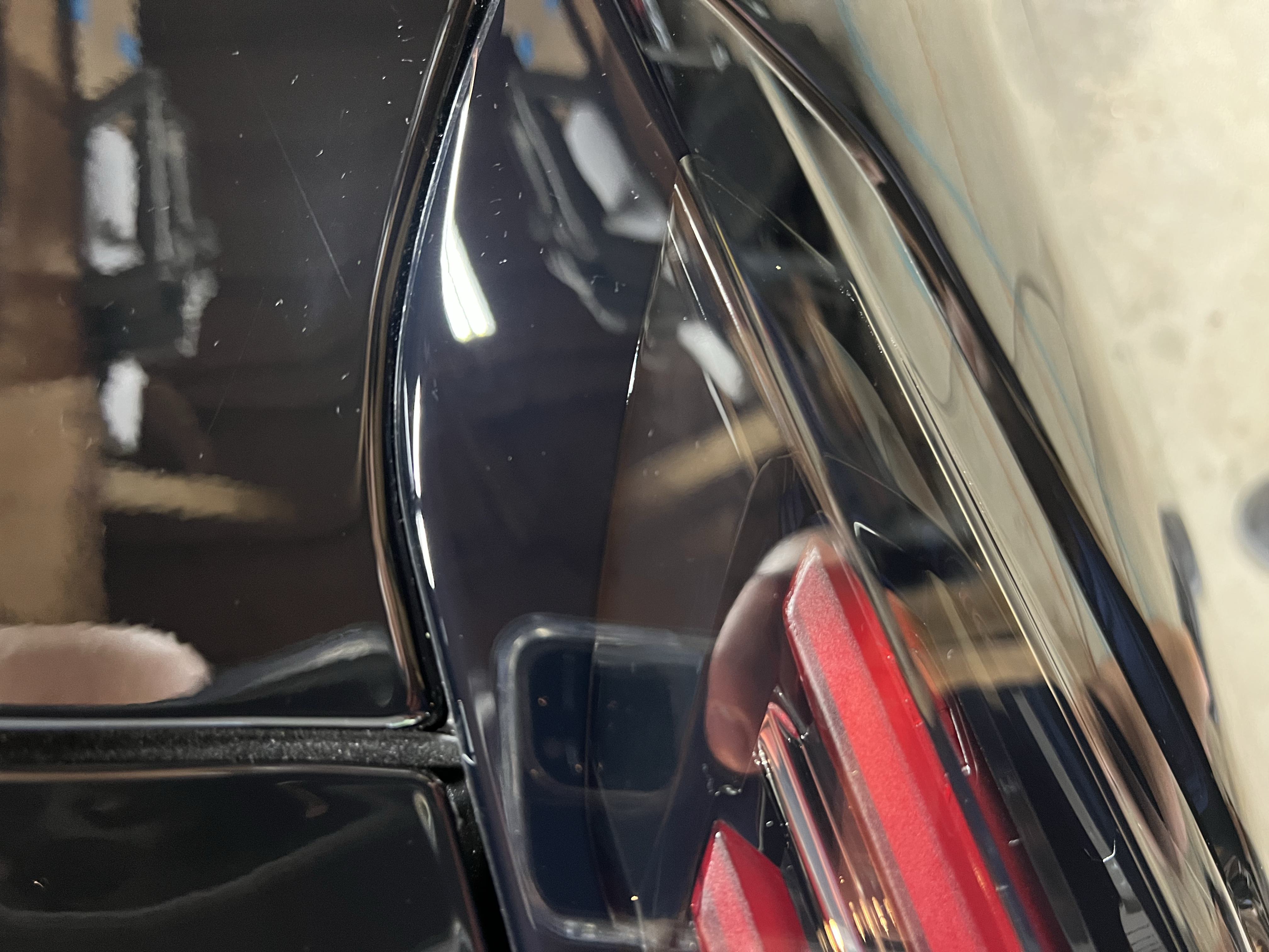

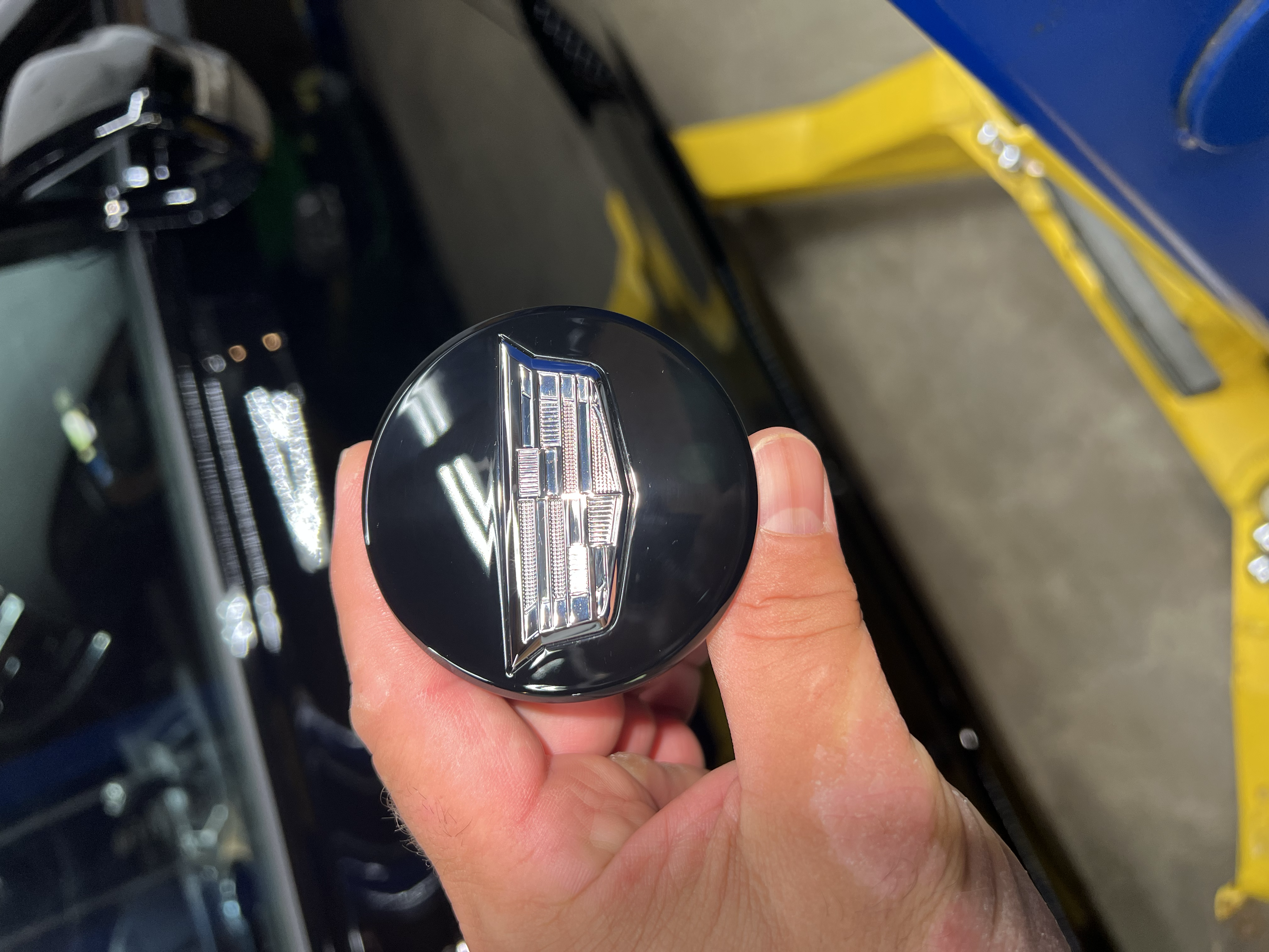

Before/after polishing center caps

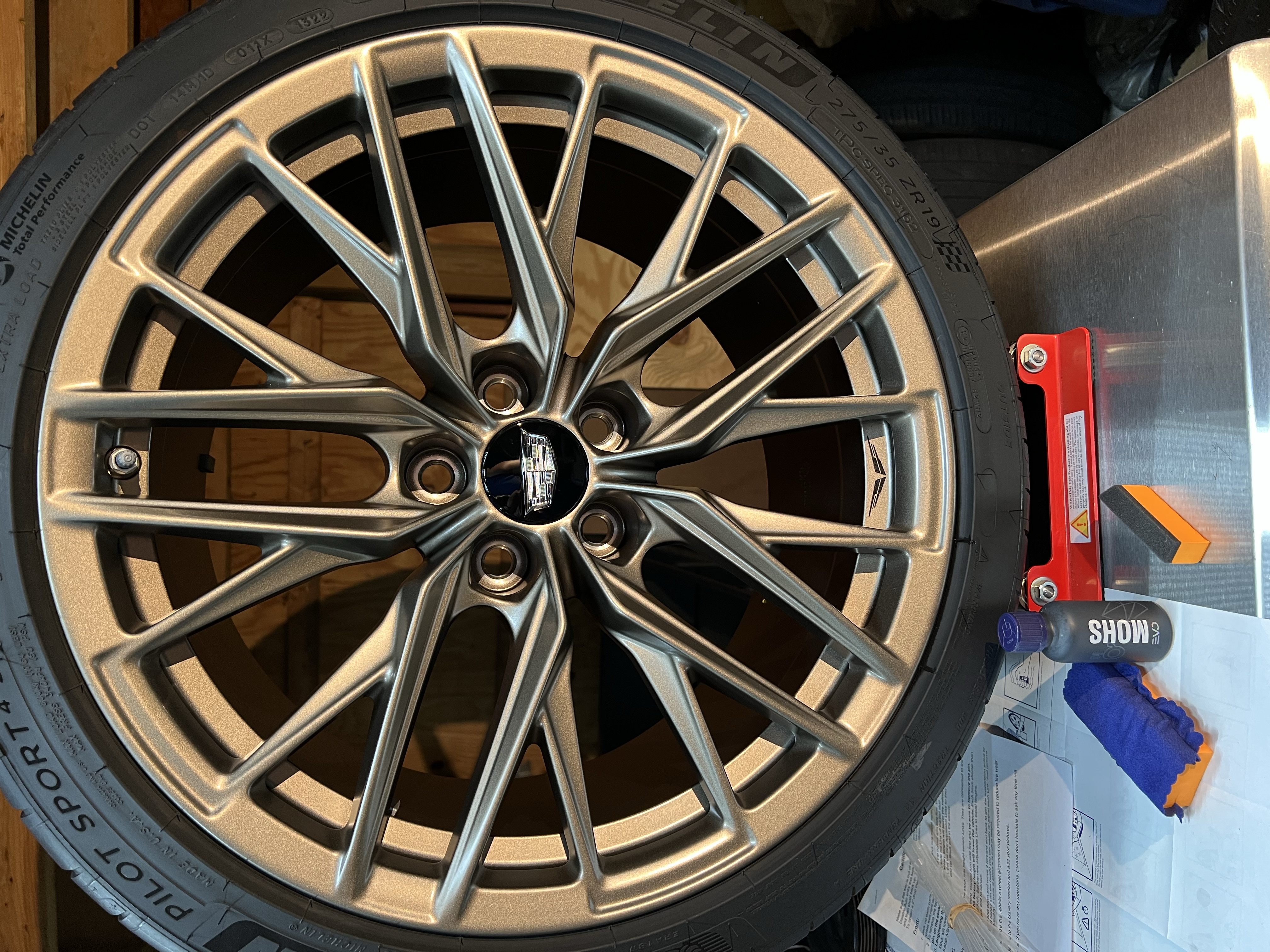

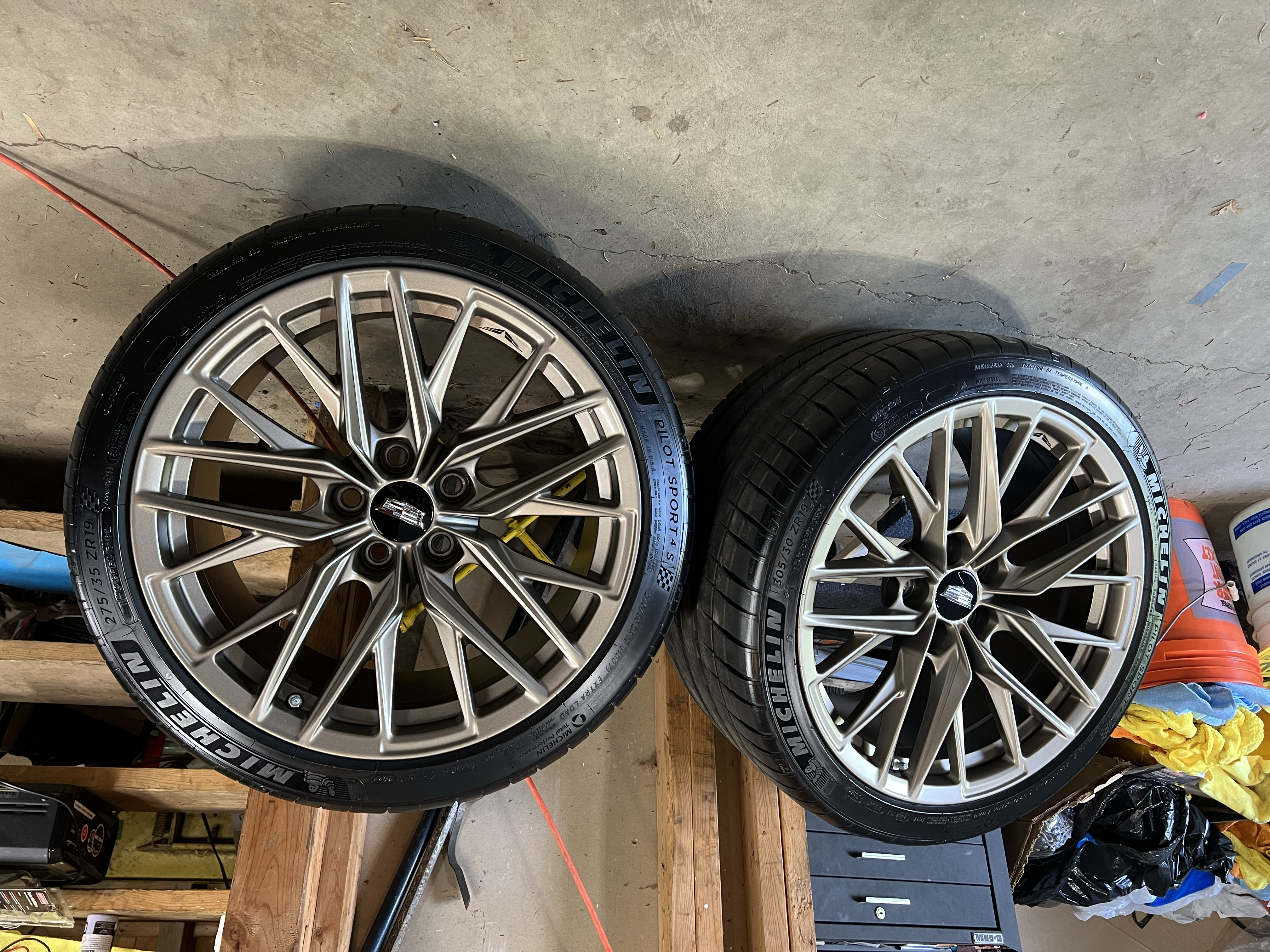

Wheels/tires before coating both.
After coating wheels with Gyeon Mohs and tires with Tuf Shine tire coating ( 3 coats)
Calipers got coated with Gyeon Mohs as well.
