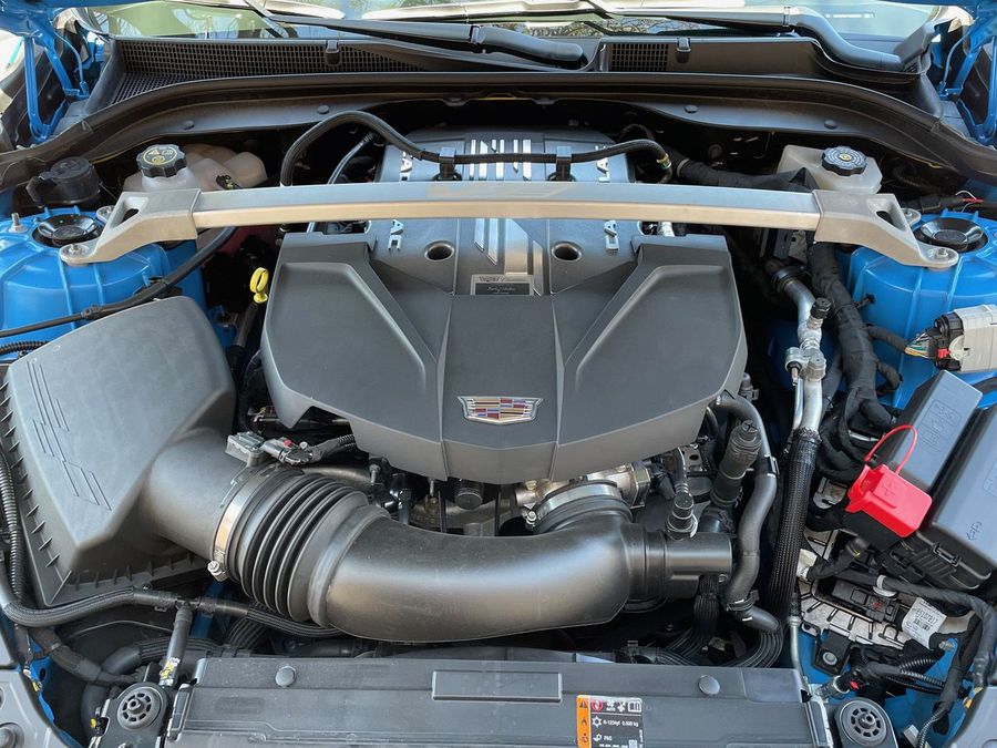

I want to do something custom with my engine cover. Just not 100% sure of exactly what to do.
One idea I have is to paint either the inner(around the cadillac emblem) or outer section electric blue to match the body. Maybe the whole thing?
Another idea was to have a replica cover made out of carbon fiber. In that case the cover would have to be sent away and it would probably have to be completely smoothed out.
I may do both.
I picked up 2 spare covers to mess around with so I can leave my original one untouched.
Anyone wanna give photoshop a try...

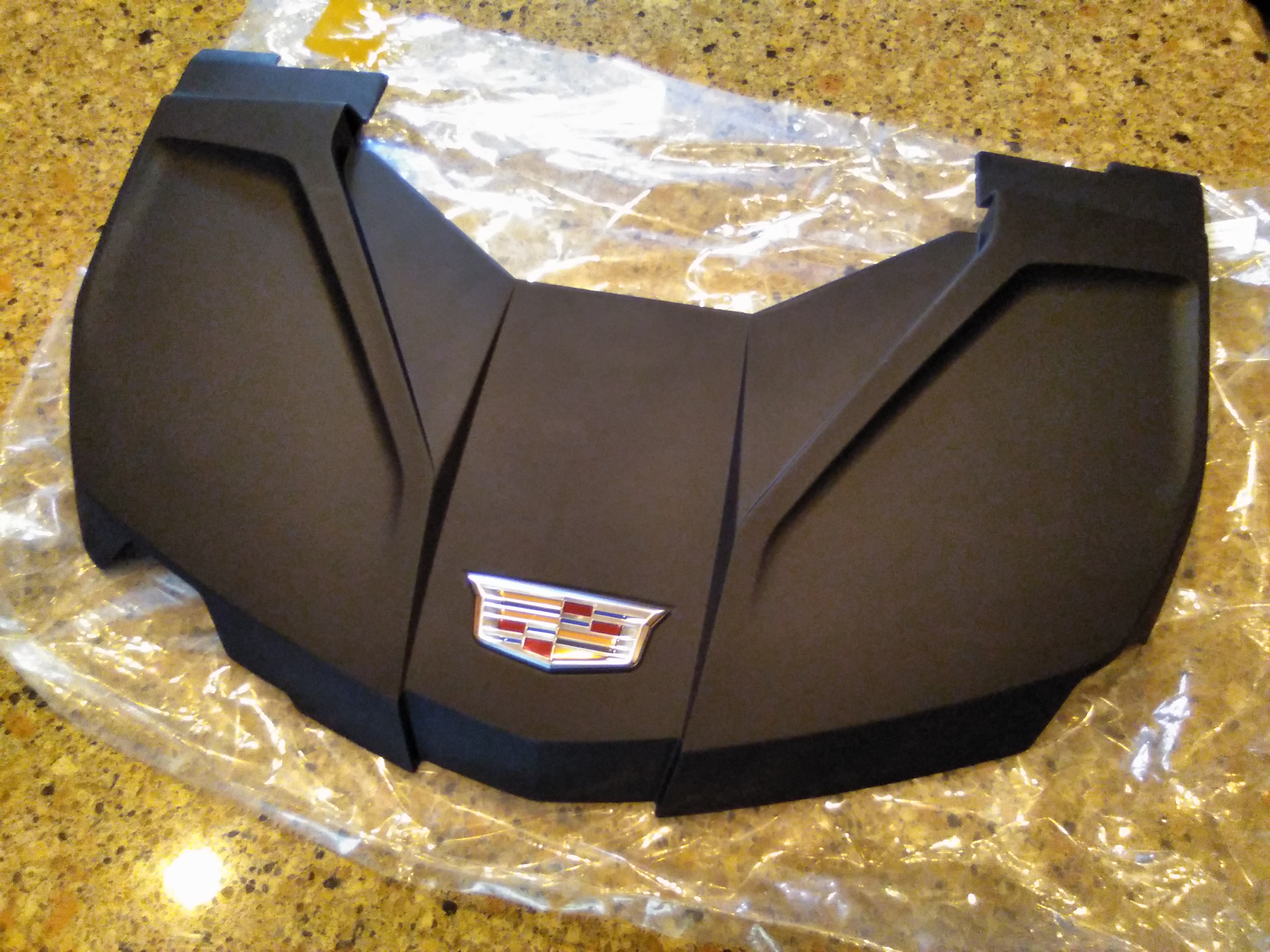

Finally got started with sanding down the texture. Once I have it all smooth and ease some of the sharper lines, I'll lay up some fiberglass to make a mold. If that turns out good, I'll do a lay up of carbon fiber and see how it comes out. I'll also eventually paint this smooth plastic oem one electric blue.
GTANotch88
Oct 19, 2021
282
NJ
'22 CT5-V BW
Smoothed, primed and wet sanded. Ready to make a mold now. Also found a source for 2x2 cf twill already woven with the chevron, "v", pattern. That should be slightly easier to lay up. Just not sure how well itll lay up with some of the sharper lines, but worth a shot. I can always adjust for a second attempt since I have a few ideas/options to deal with it.
