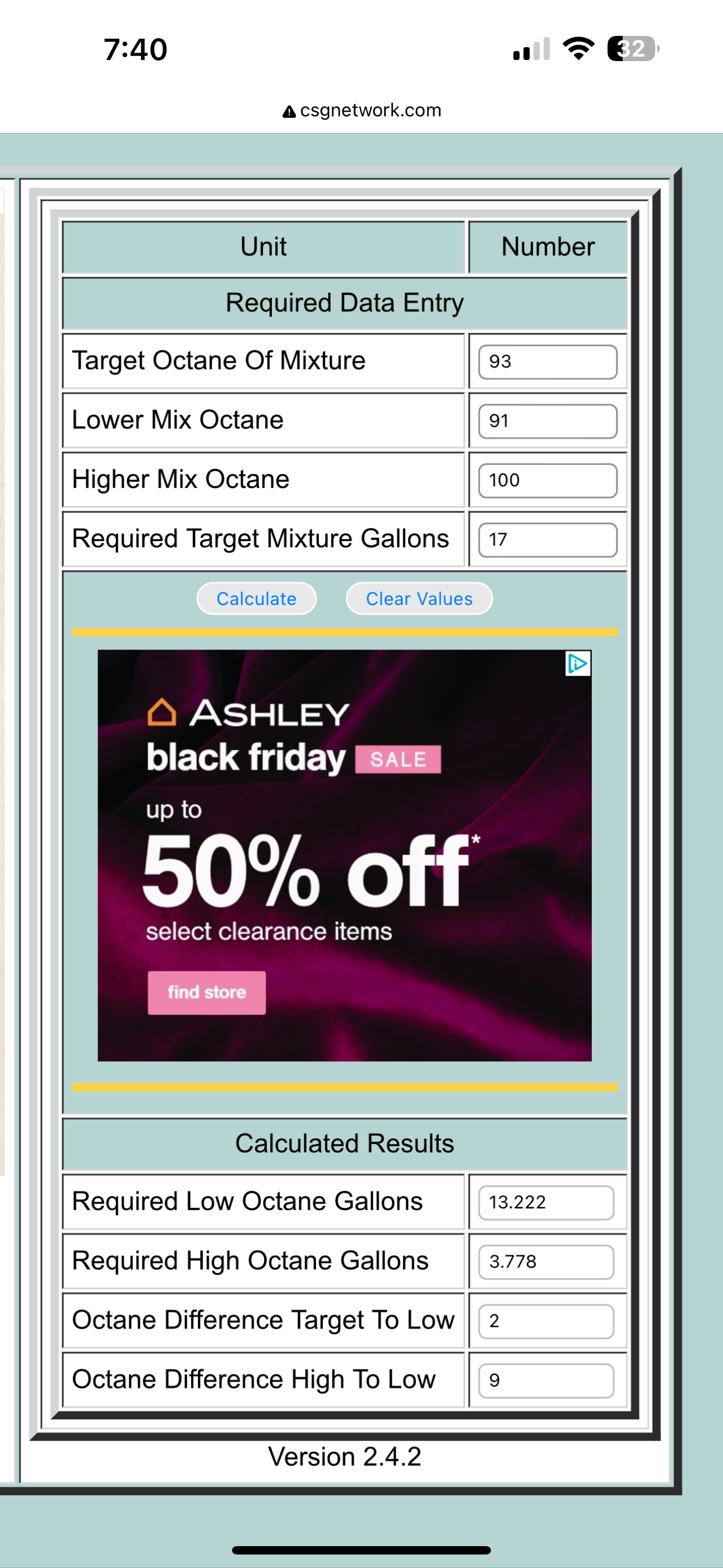

Octane boosters may only raise it 8 points (.8 octane) and some such as Boostane Professional say 23 points for $30 a can. In theory adding 1 can to your tank of 91, your at 93.3~ octane). In CA (91octane is $5.50 a gal). that's like paying $6.04 a gal...as crazy as it sounds that's actually worth avoiding knock/detonation.
sunoco gt260 100 octane is about $85 for 5 gal.
17 gal tank, to get to 93 your spending an additional $65 a tank. In CA (91octane is $5.50 a gal). that's like paying $8.11 a gal.
