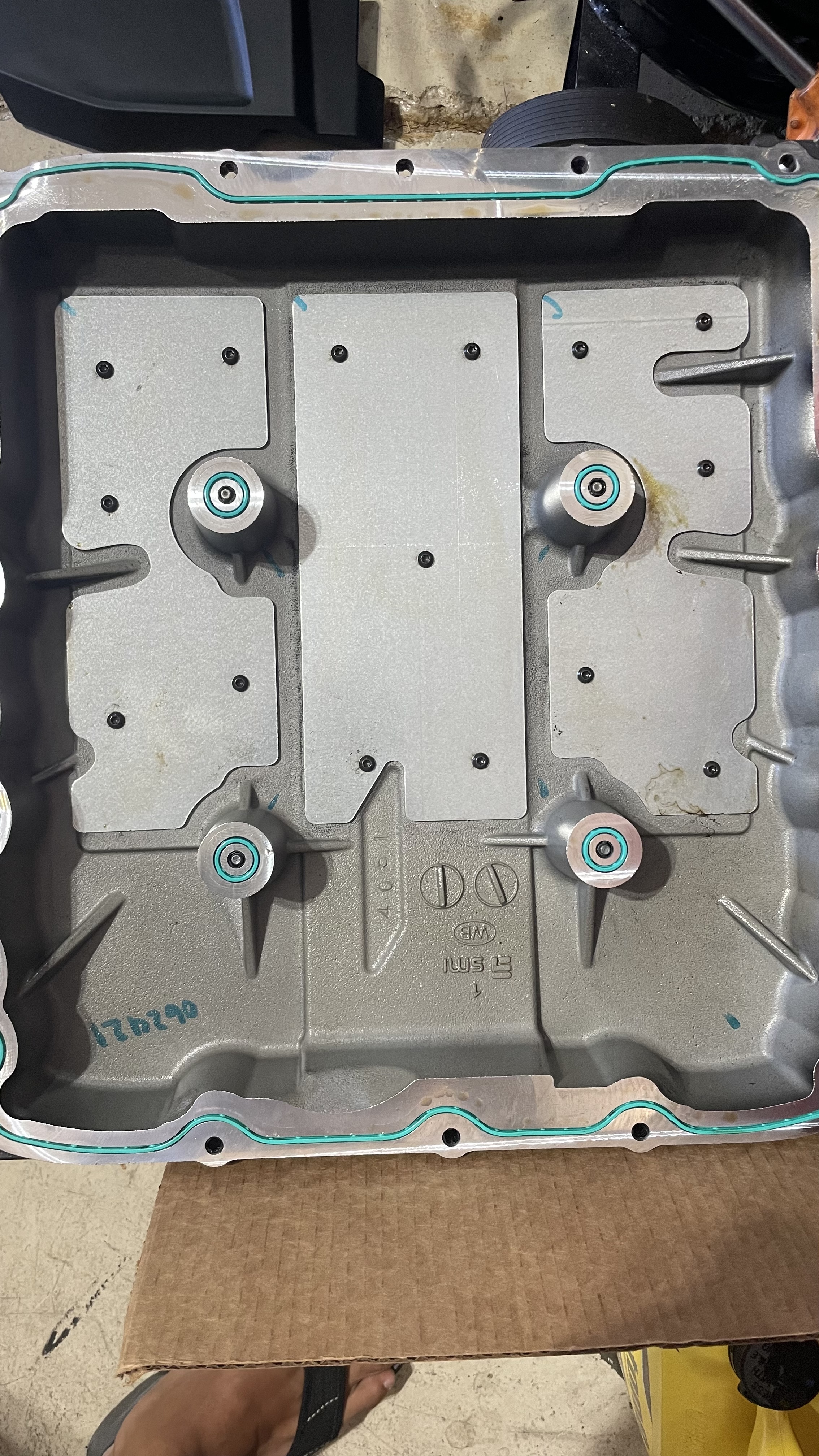

Hey guys. I just got my 5BW back from my speed shop.
Stock SC ported by Kong
103mm TB
Green filter
These numbers represent operating temperature runs. So, the numbers are "real world" and not cold runs. I'm very happy with the results. Removing the insulated plates from the SC lid allows her to whine a bit more, which I like. 70 WHP is a big difference in how she drives. I know we can't tune our cars, but I will need to get to know my 5BW again. Very different animal now. I'll post a video next week as we didn't get one at the dynojet run on Friday.

Just took the plates off or did you smooth out the inside by shaving down the webbings?
