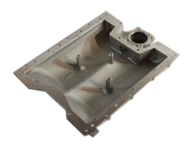

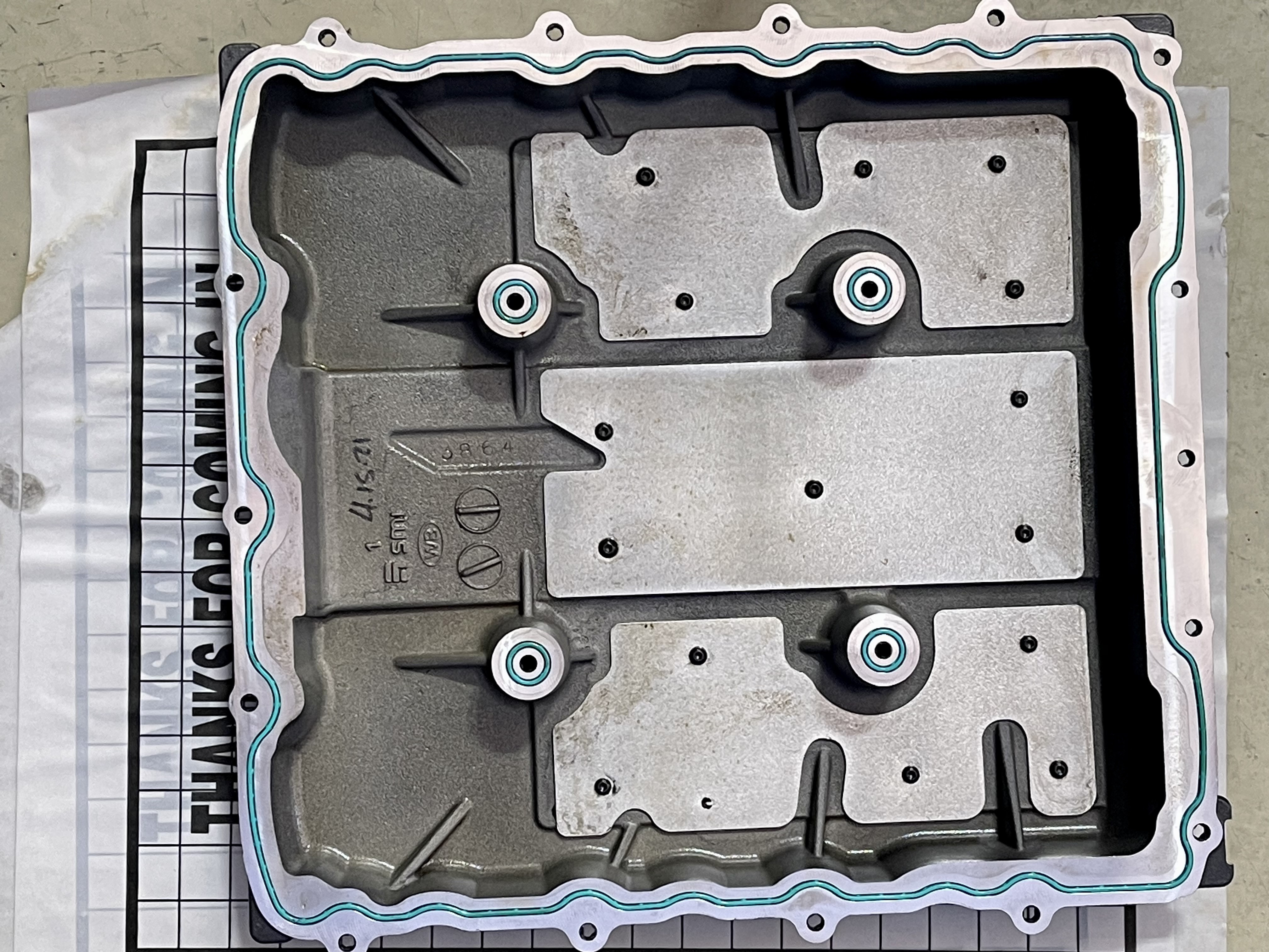

There have been many posts about wanting more whine from our Superchargers. The first picture is the 5BW SC lid and the second picture is the Hellcat SC lid. The three plates screwed onto our lids have insulation between the plates and our lid whereas the Hellcat SC does not have these plates with insulation. I am going to remove the plates before we install the Kong X ported SC. I'll post the dynojet video to show the numbers after the upgraded SC and TB which will also let us do a noise comparison. Should be interesting.

Incidentally the CTS-V only had one plate in the center of the SC lid.

Well, looks like i have my next project for tomorrow.
Anyone happen to know the torque specs for the lid bolts?

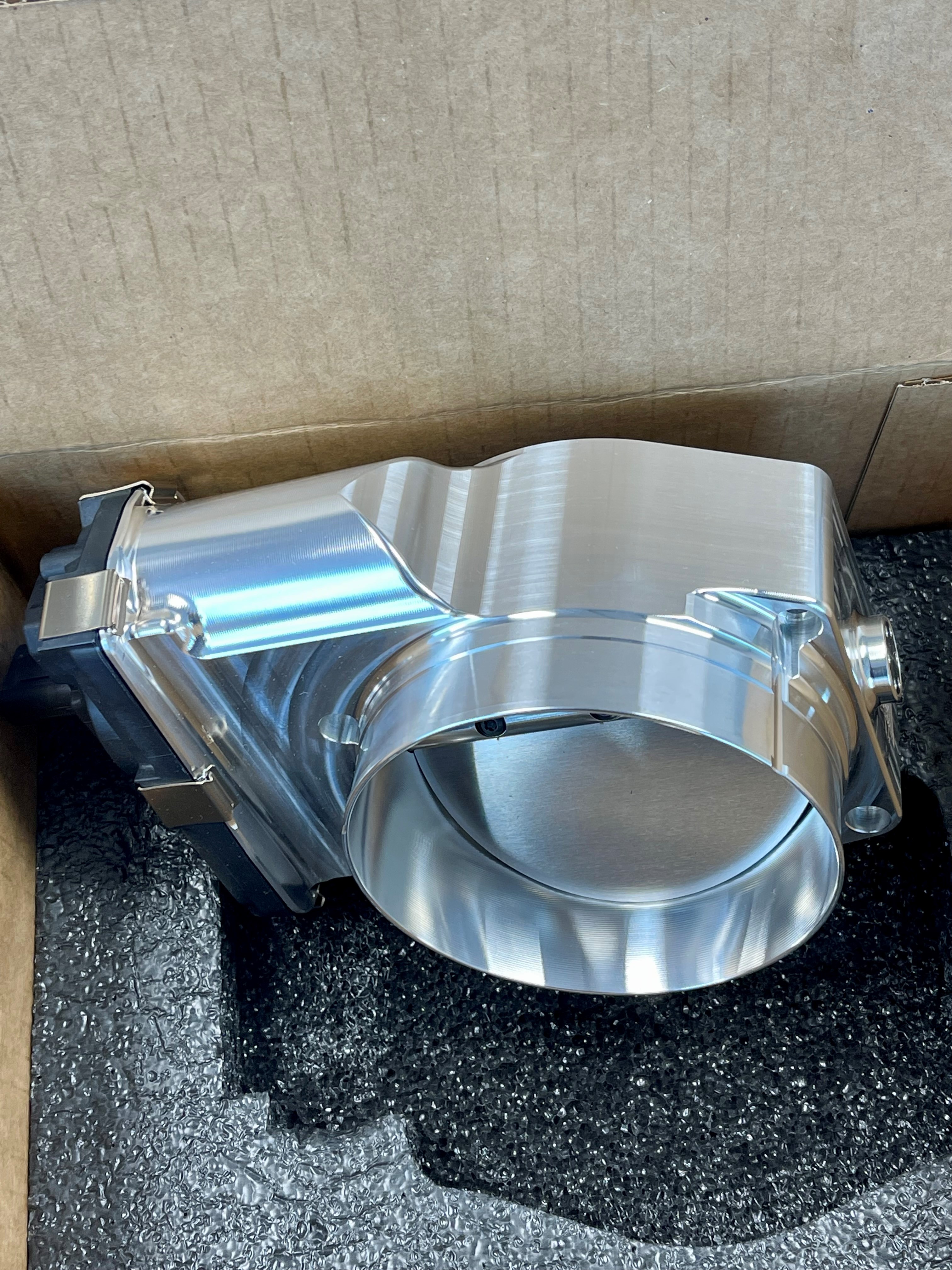

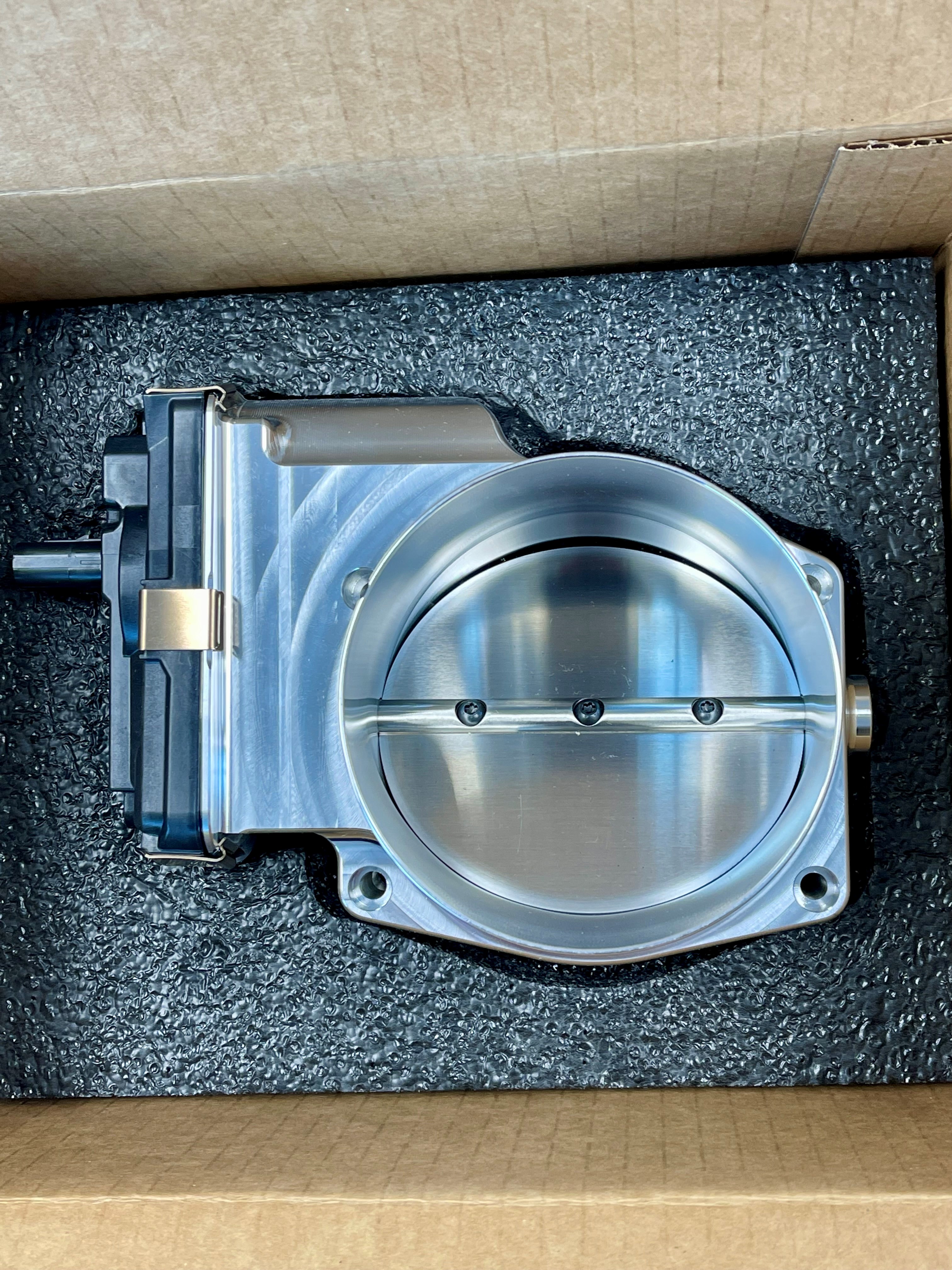

I thought I'd share a couple of pics of the Nick Williams 103mm TB. We should receive the ported SC back next week. I hope you guys have a nice weekend.

I'm skeptical on the real-world gains of the ported blower without at tune. Yes, I saw the YT video where the car picked up 60 rwhp, but FishinV ran pretty much the same time as the ported blower car (within .10) with slicks and an otherwise stock car.
Equal cars with a ~60 hp advantage should be multiple tenths quicker in the 1/4 mile.
A big reason they dont do much better in the 1/4 mile is the launch is held back by the tune, just like the V3. The 60' is never going to be better than 1.7 without a tune. There is a torque vs RPM table under torque management that reduces torque until approx 30 mph. (max is around 40%). On my V3, that table alone picked up 3 tenths when i tuned it. Went from 1.75 to 1.47 on the 60'. Its there to protect the weak link which is the 2 Piece driveshaft
