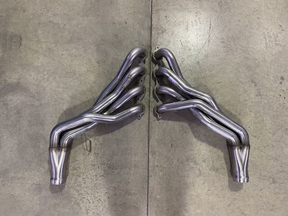

Photos of the headers and exhaust?
Those instructions could certainly be better with much better photos. Like removing clips, show a before photo of what it looks like and how its mounted, then show it "removed"... whether this means just releasing the line from it or actually prying the entire clip off which can be a nightmare and will usually break them. Also show the factory headers unbolted and coming out and the new ones going in. Also, show the braces before and after removal.
This may be a great opportunity for you guys to make a video of this install and post it on YouTube.
