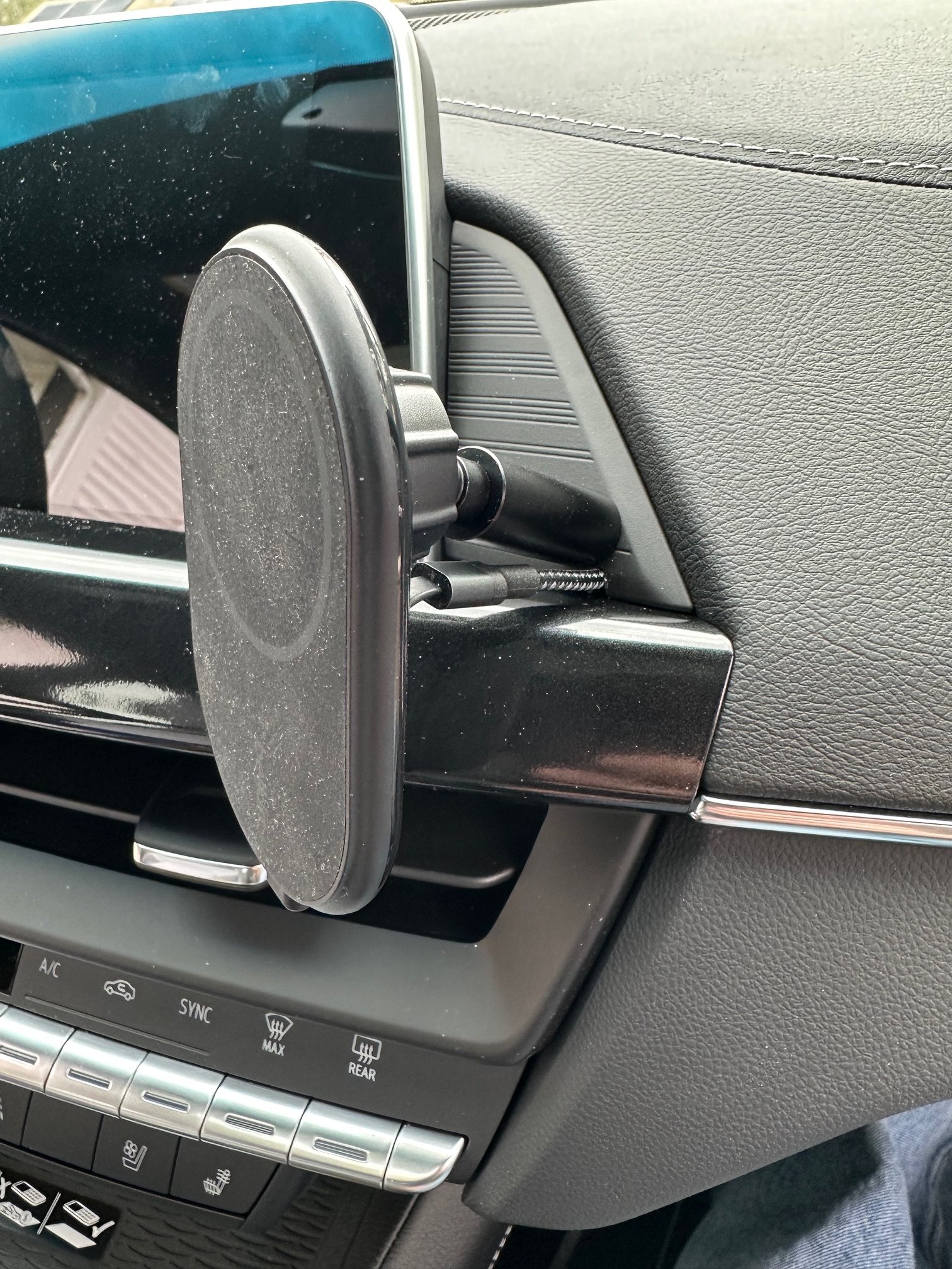

So, with zero commercially available solutions meeting my requirements, I turned to my engineering instincts and capabilities. The triangular trim piece to the right of the infotainment screen seemed like a great place to anchor a mount for a charger. Phone would be mid-upper dash height and above/away from all other controls, and not intruding on passenger space or HVAC control view/access. And it pops out nicely, with a bottom hook and top clip mount connection which should hold be able to hold the added load of a phone+charger.

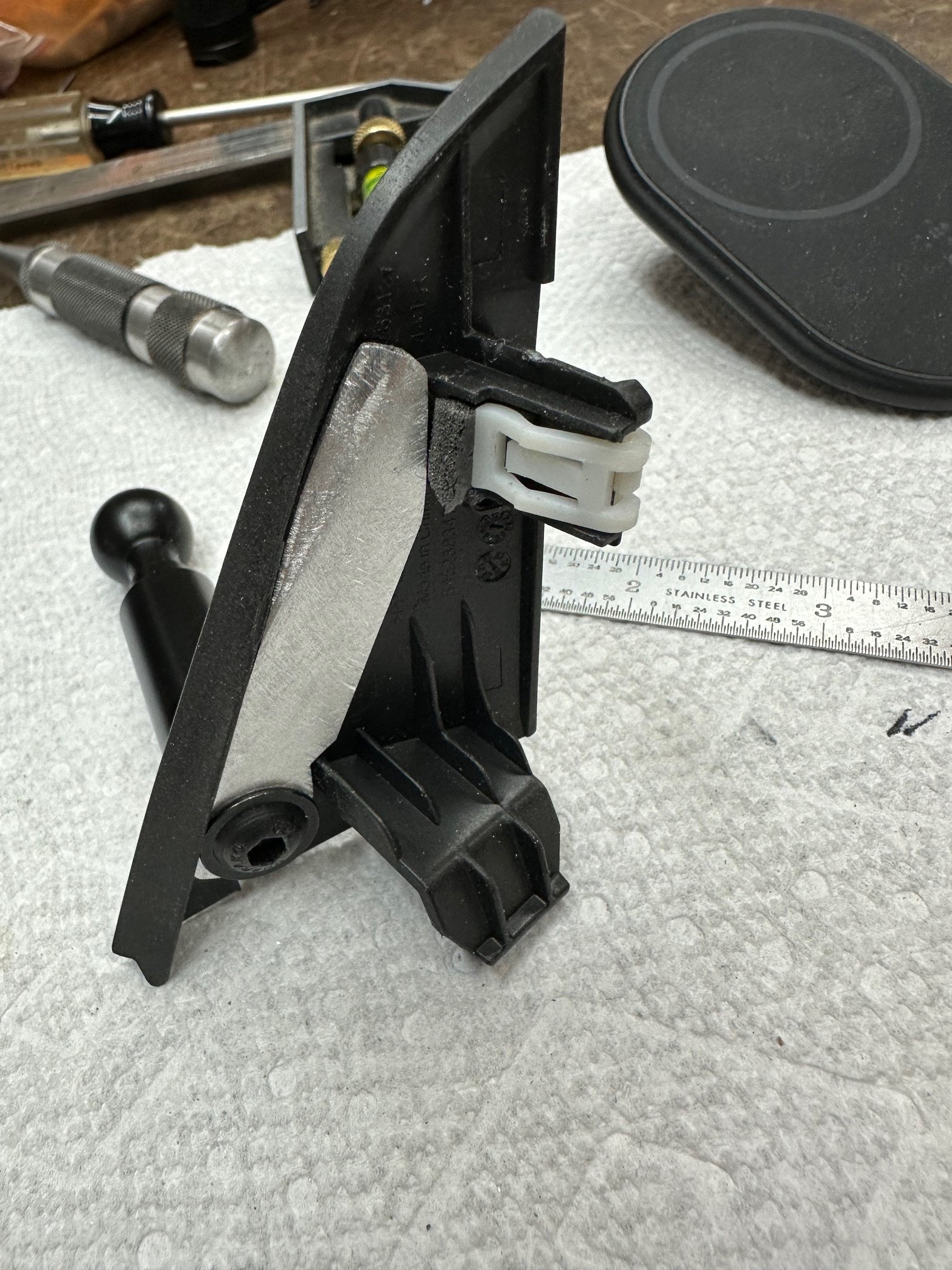

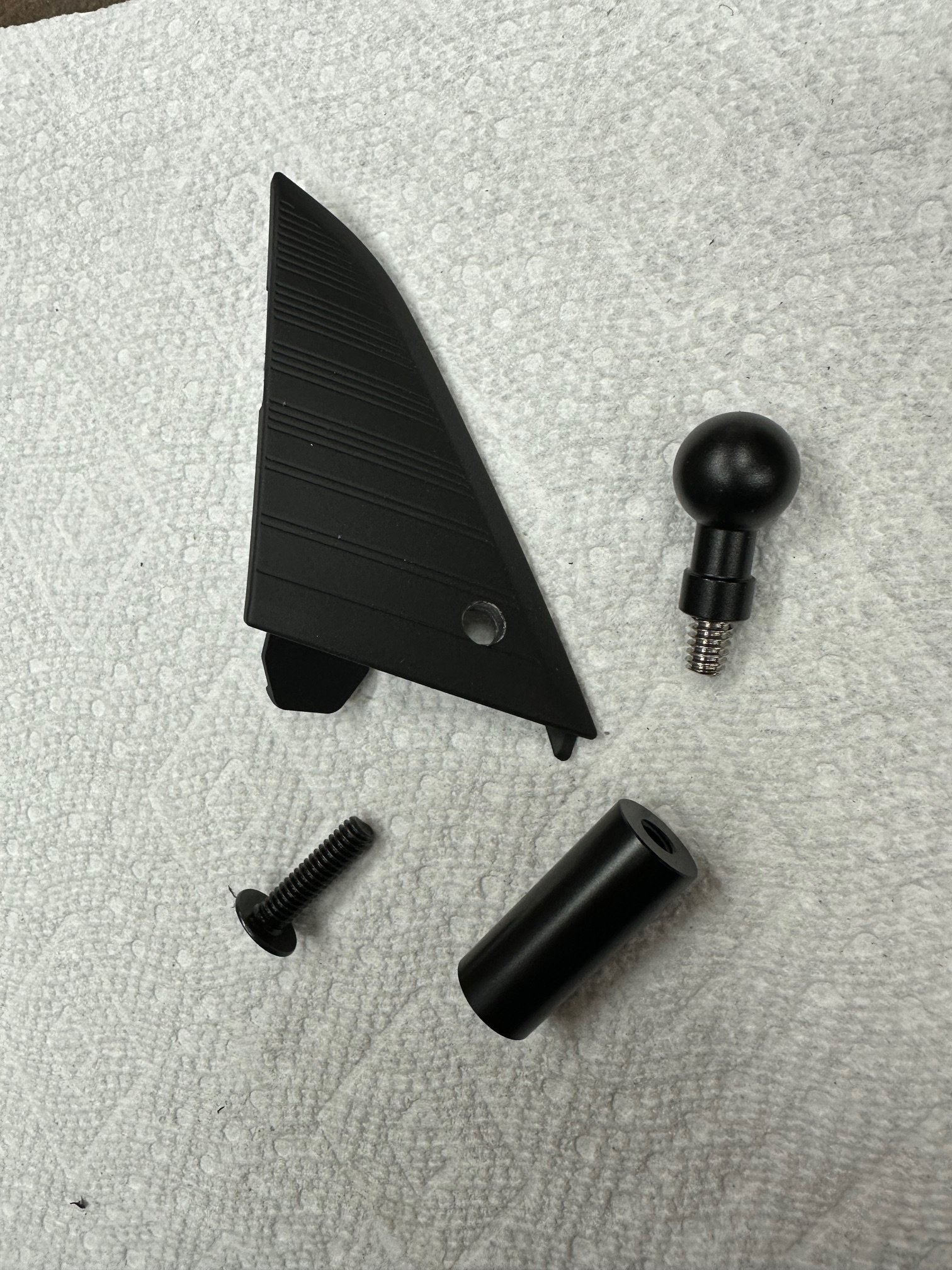

Bought a replacement trim part (84763137) for $12 to work with (in case I f'ed up, could still get back to stock) and collected a few 1/4-20 mount parts to get from trim plate to a 17mm ball mount for a phone charger.

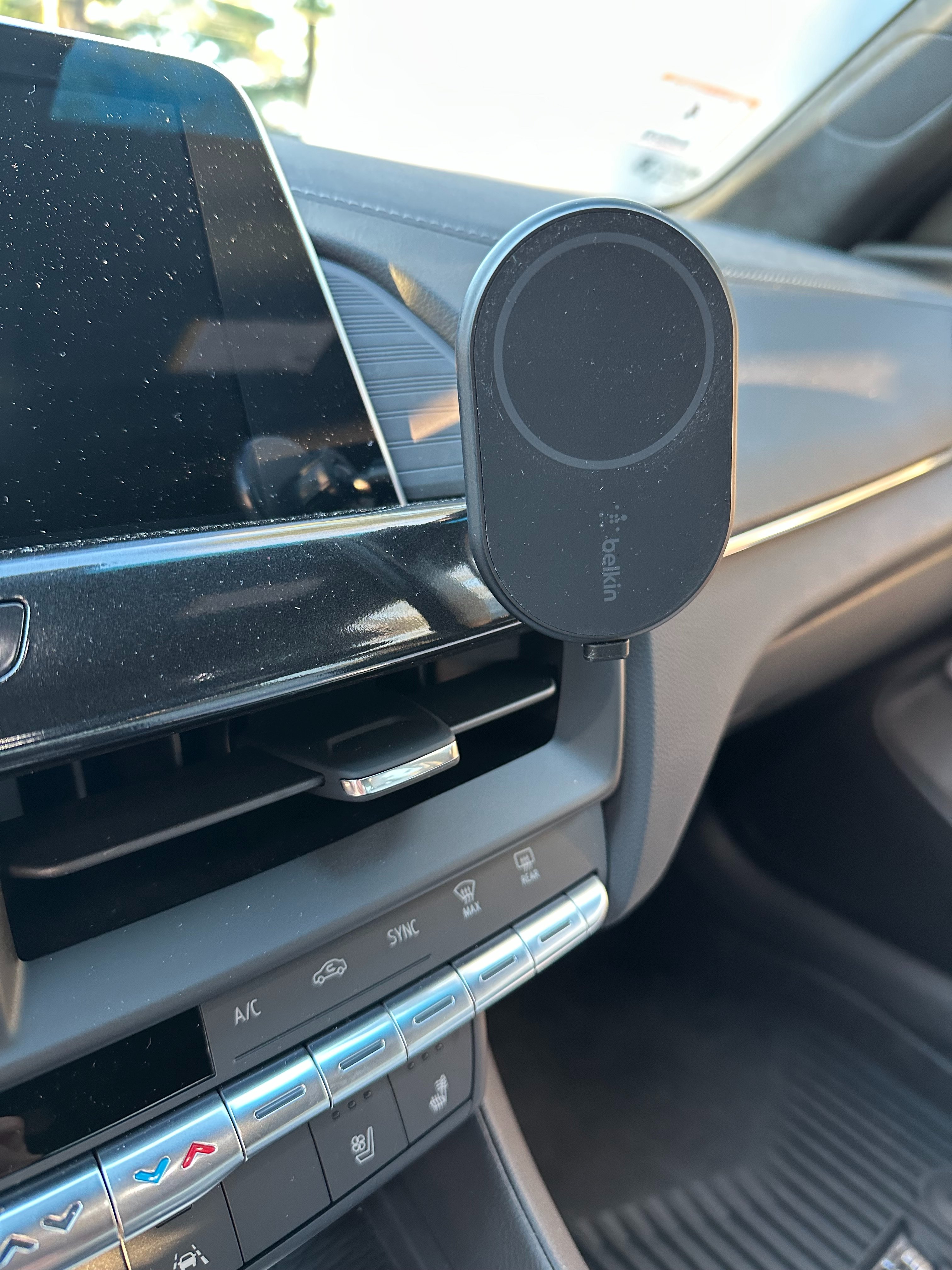

Drilled hole, plus small channel for charger cable, in the trim panel to connect the mount parts. Added 1/2" x 1/8" aluminum bar stock stiffener piece on backside of trim panel (necessary to avoid the trim panel bowing out under the moment created by the phone mount load) and closed-cell foam shims under the OEM trim clip to make sure it has extra "stick force" given the additional load from the phone+mount. Belkin MagSafe charger attaches nicely.

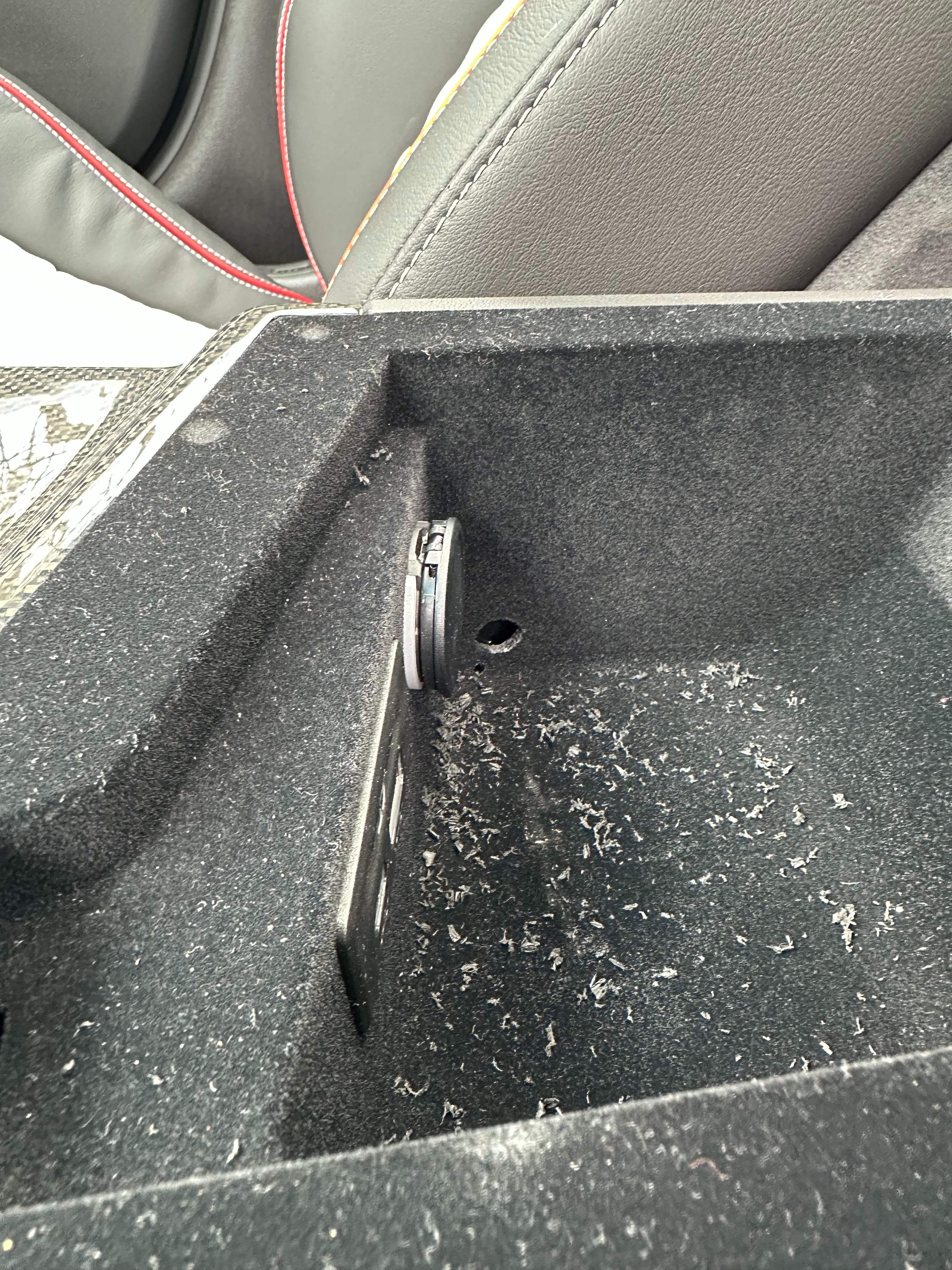

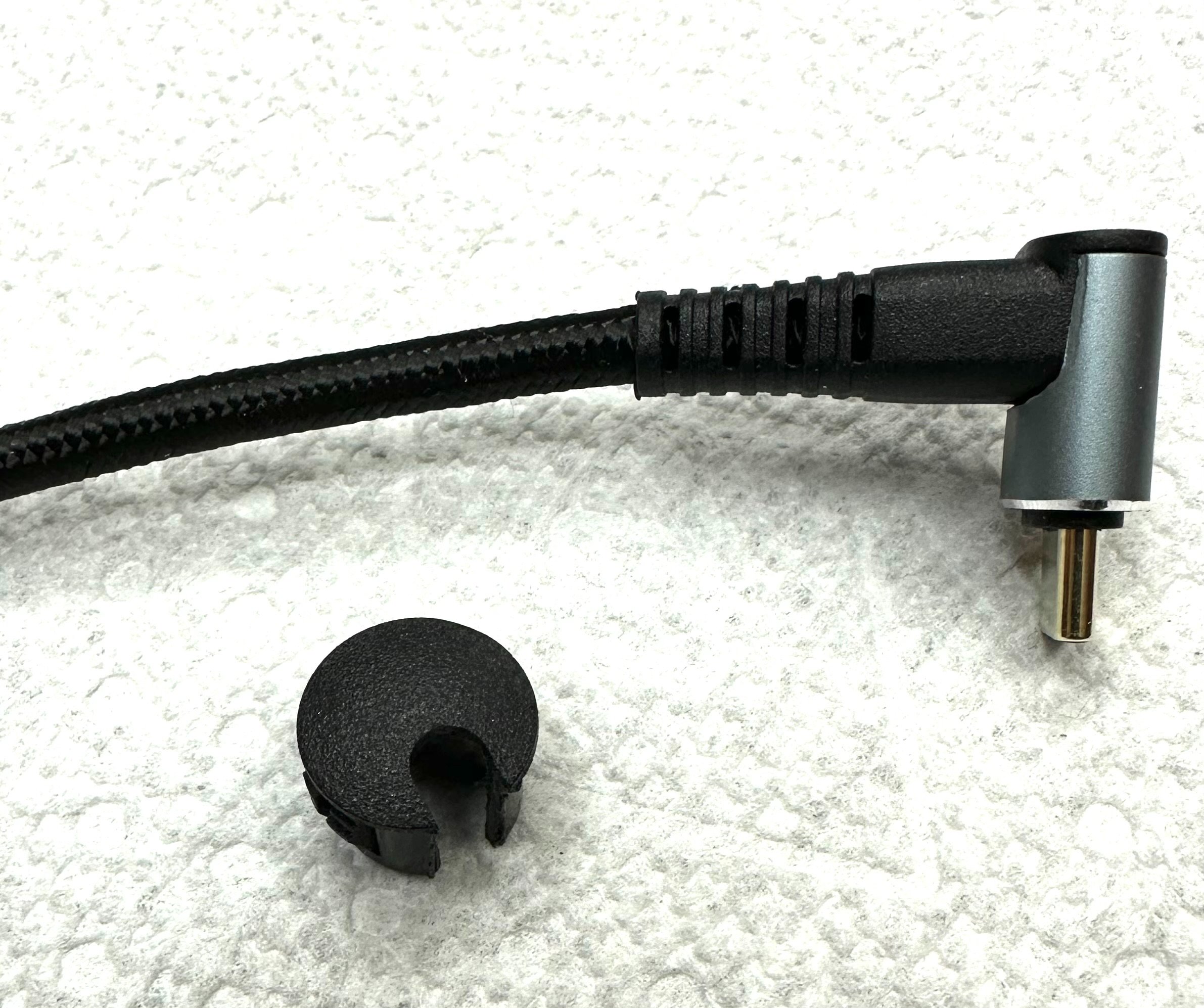

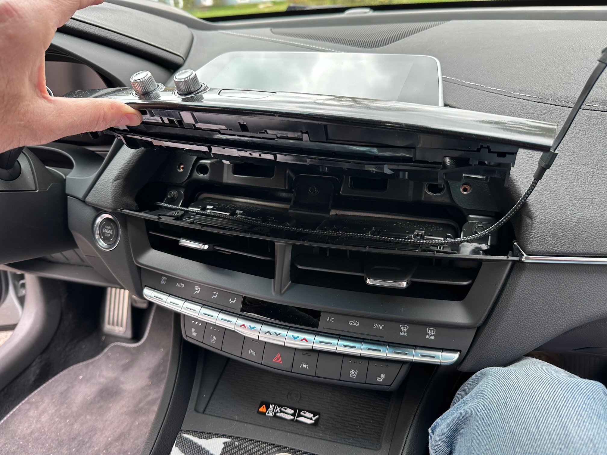

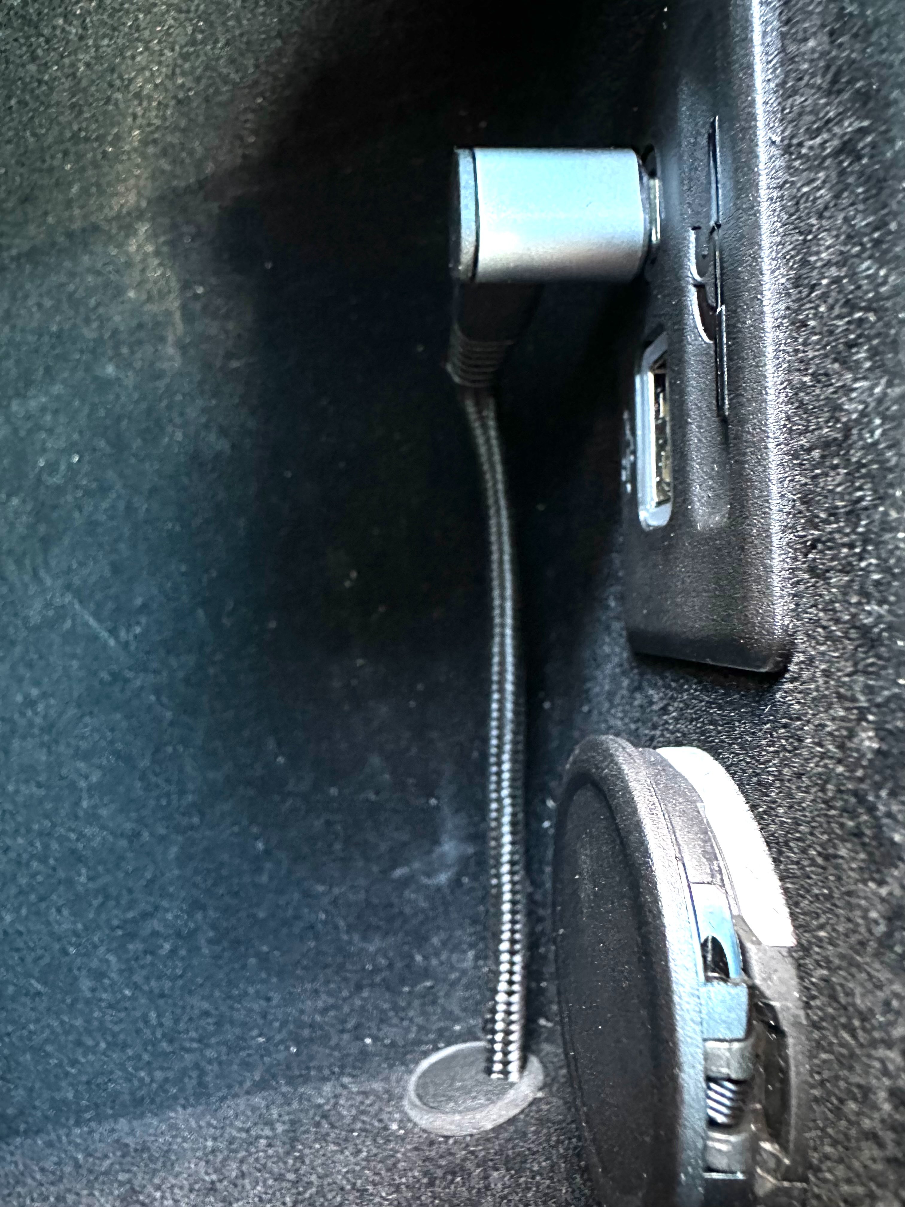

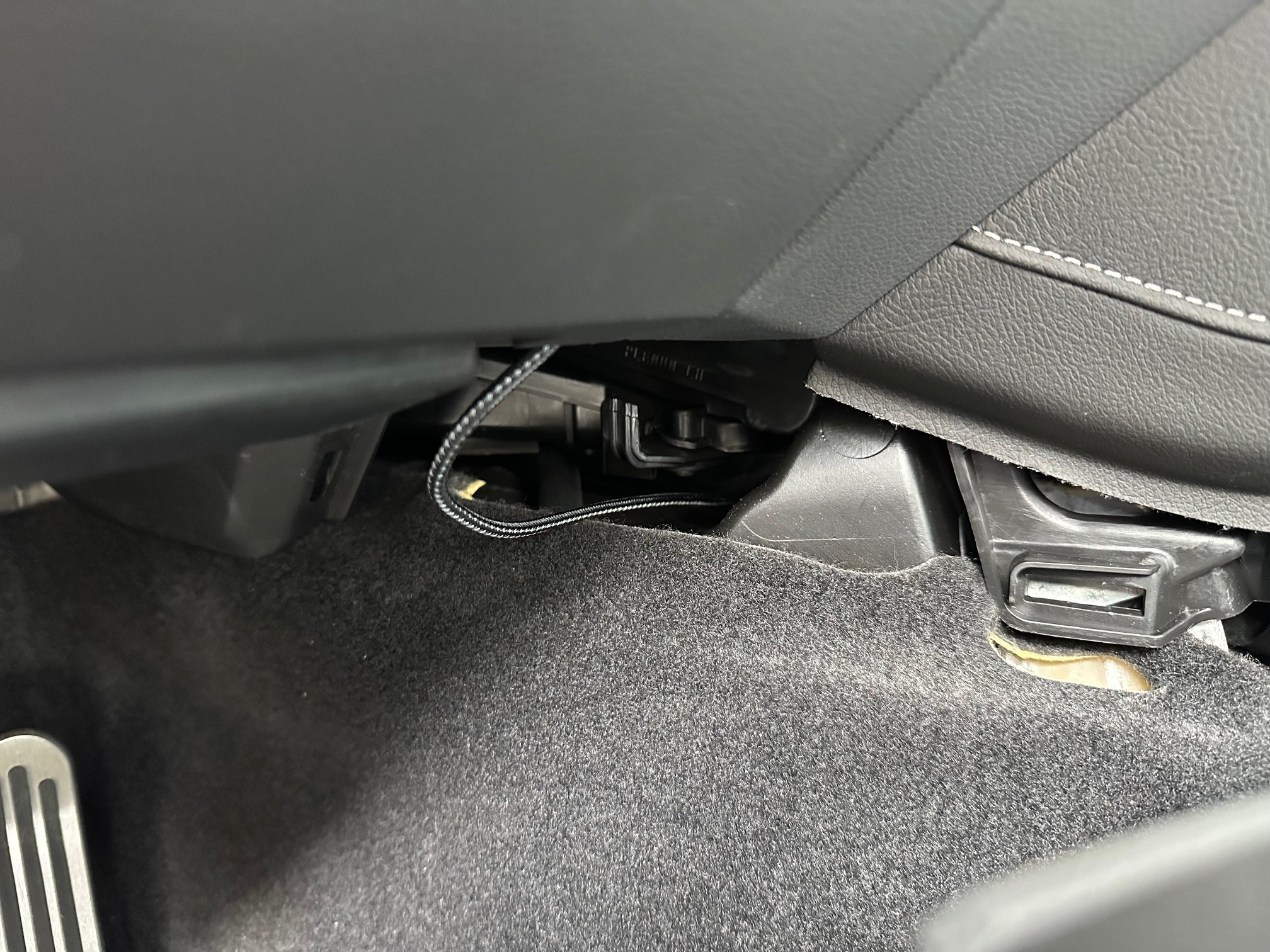

USB charger cable routes right to left under the infotainment screen, down drivers side console trim to center console, across to passenger side of console, then down passenger side of console then under side trim back. Mates to USB-C right angle extension that plugs into console armrest storage area and exits through a hole drilled in front-right corner of console storage area. Modified 1/2" hole plug and neoprene gasket nicely fill the hole in the console side.

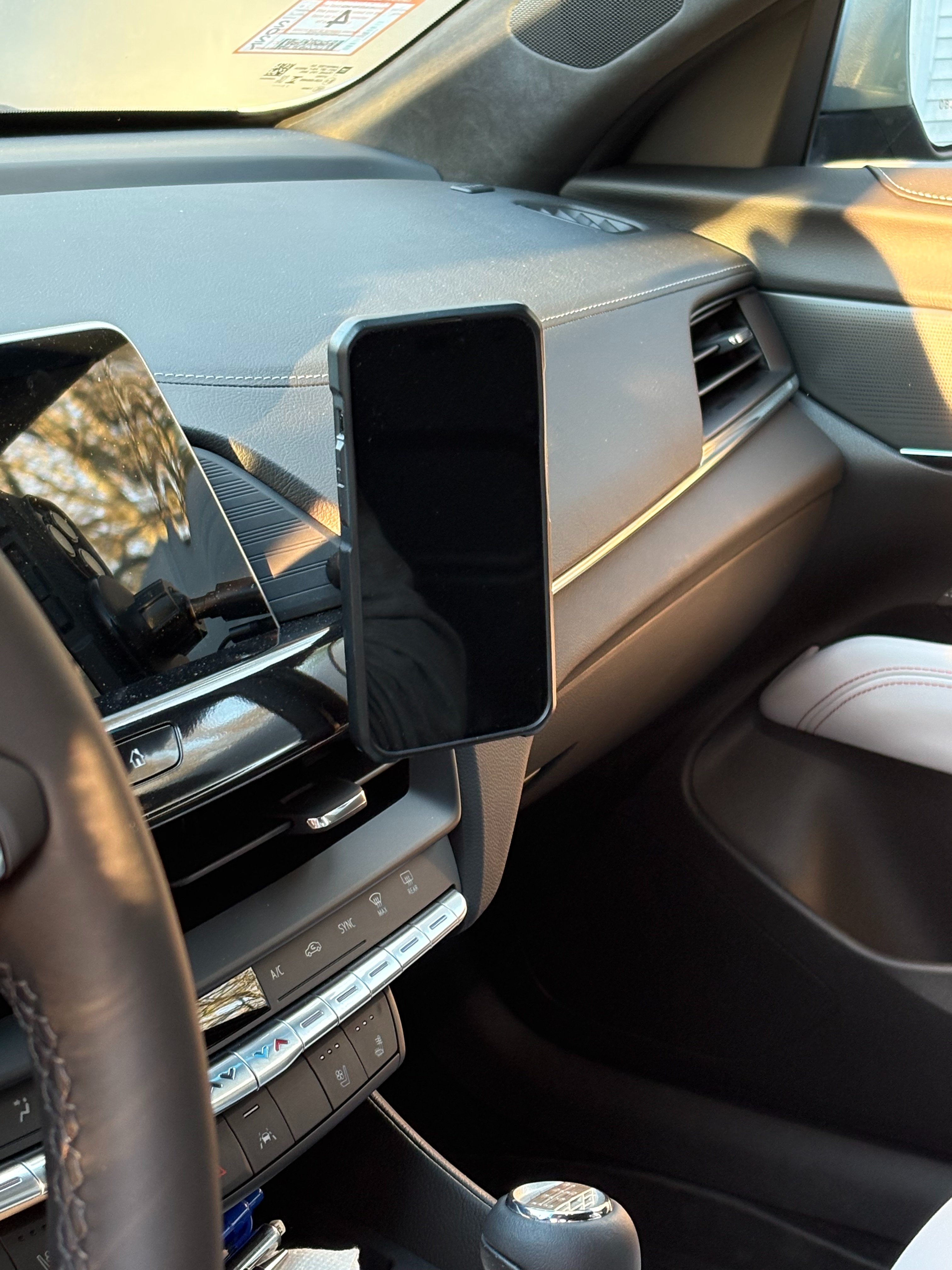

Works well and looks like it sort-of was designed to be there
