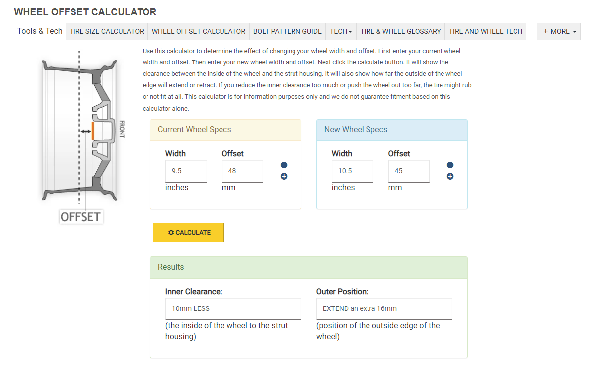

+45 on the back with a 10.5 is pretty low offset for these cars. Is there a +50 option?
Its +45 on a 10.5" wheel, opposed to a +48 on a 9.5" OEM wheel. That where I was hoping for a little clarification. They don't offer a 50, I can do 45 or I think the next closest is 30.
there's 25mm in an inch, so figure half of that goes to the offset. So a +45 on a 10.5j would be like +35 on a 9.5j

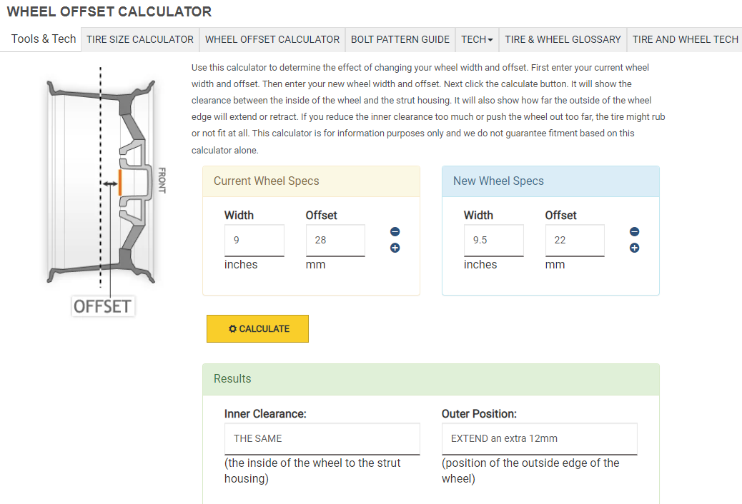

Here is the difference on 1010tires calculator... I did the front and the rear. This is based of my OE Bronze 18's. My push is, winter is coming and I live in PA. Our roads arent the best, and while I have no intention of driving in bad conditions, rain can turn to snow in a minute here, and I dont want her penned up in the garage

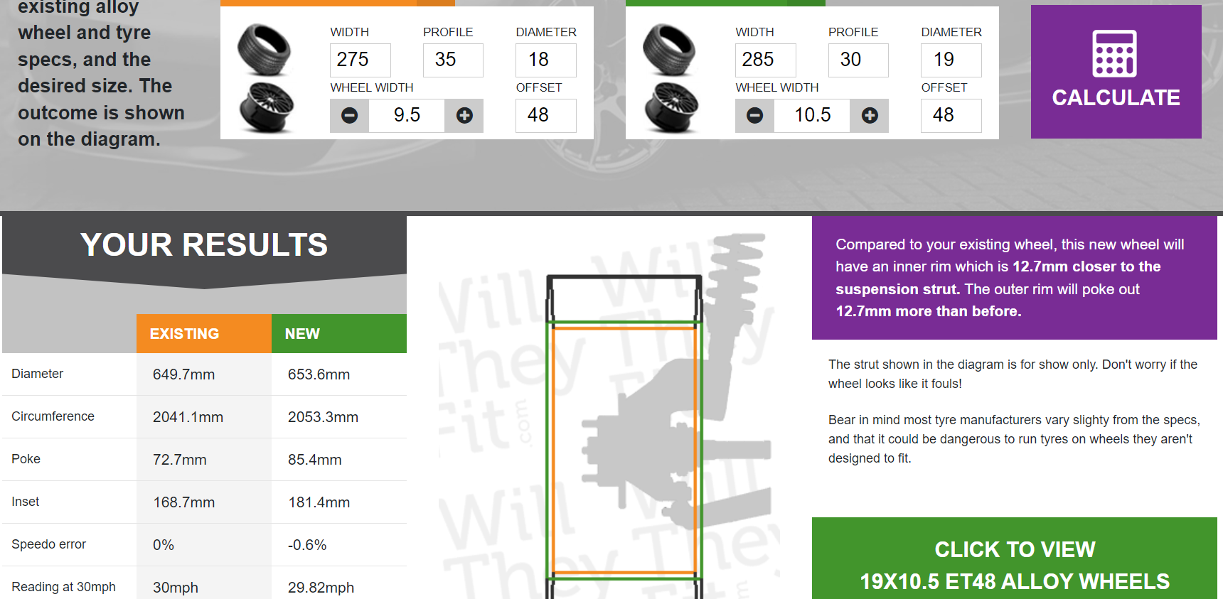

For a 10.5" it looks like you would need a 48mm minimum to sit flush with the body. just my math... I measured roughly 13mm spacing from the stock rear wheel to the edge of the well. and here is the wheel specs.
