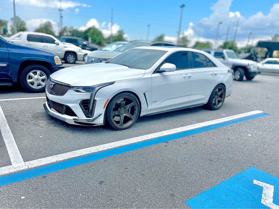

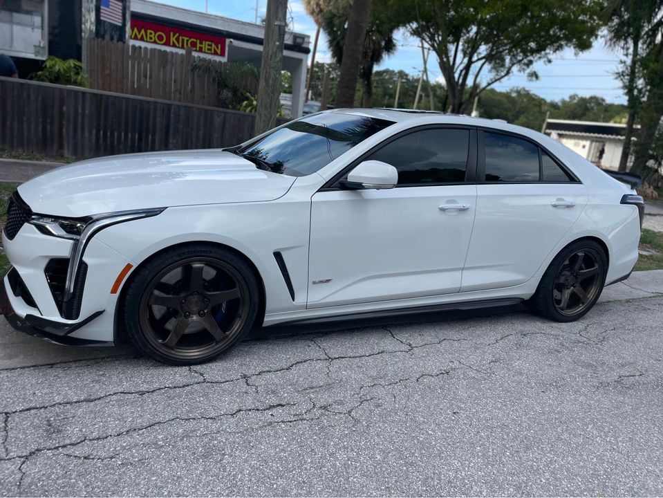

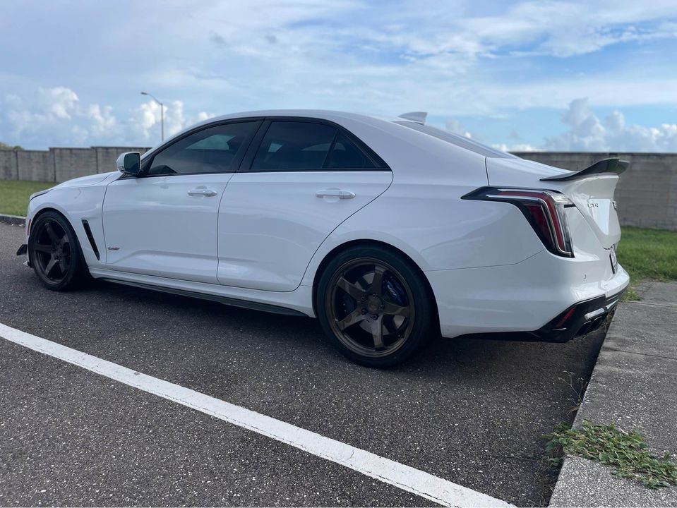

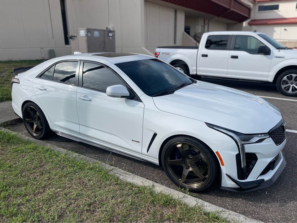

Found on facebook marketplace.
BC Forged RT50 on brushed bronze. 19x9.5 and 19x11 rears
Rears are +52 and fronts at +28 plus running 15mm spacers on front
IMO 19x9.5 +30 F and 19x11 +45ish rear would be about perfect

Its my car. You dont wanna go +45. Tapout Scott is running +45 in the rear and its pokes out noticeably with 305s. +52 is good, maybe push down to +50. 305s are pretty square on the 11j wheels.
Fronts, with my 15mm spacers, im effectively +13. Think 5mm less would be better since im running 265s up front right now and really want to go 275 or even 285.

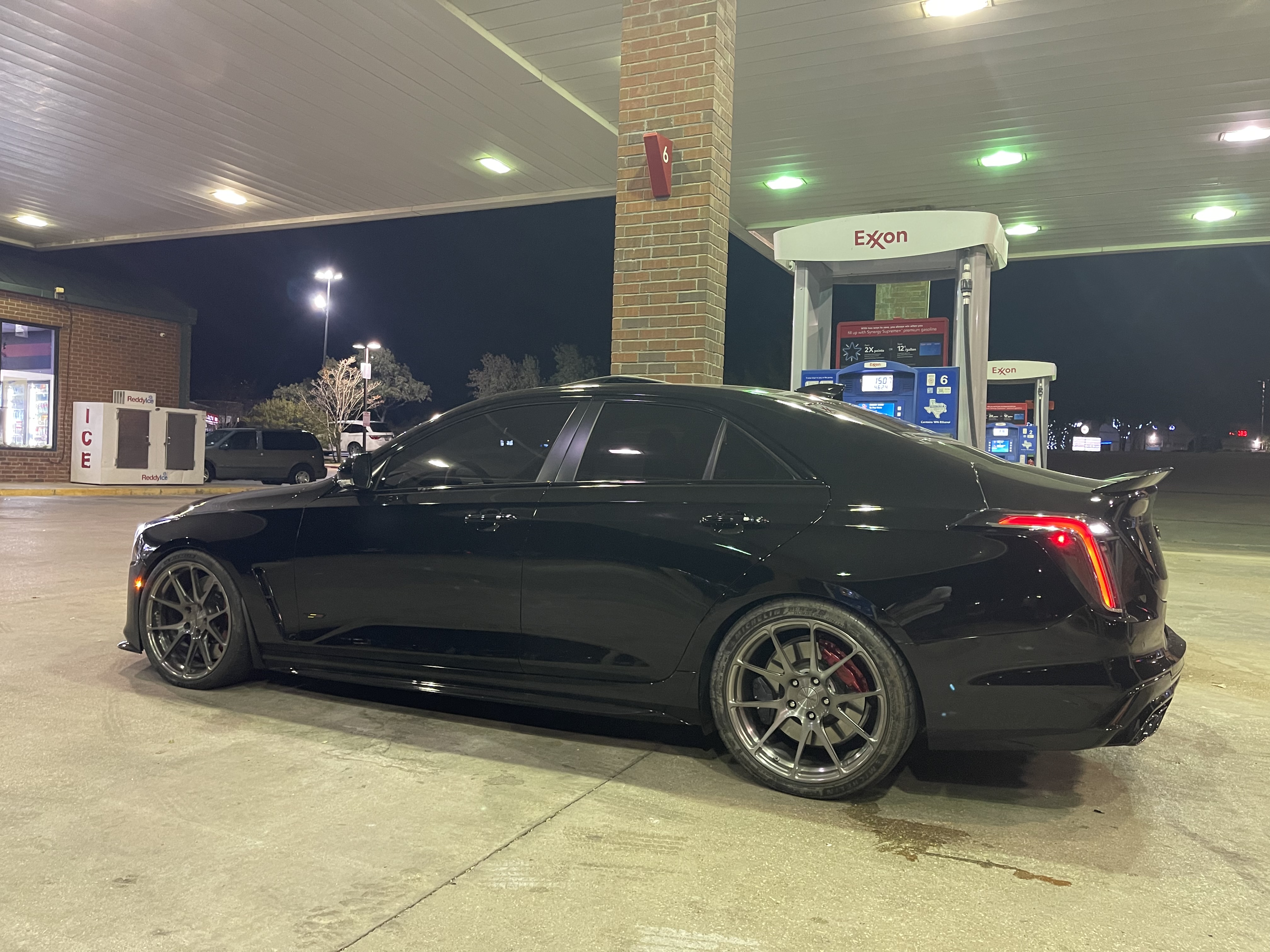

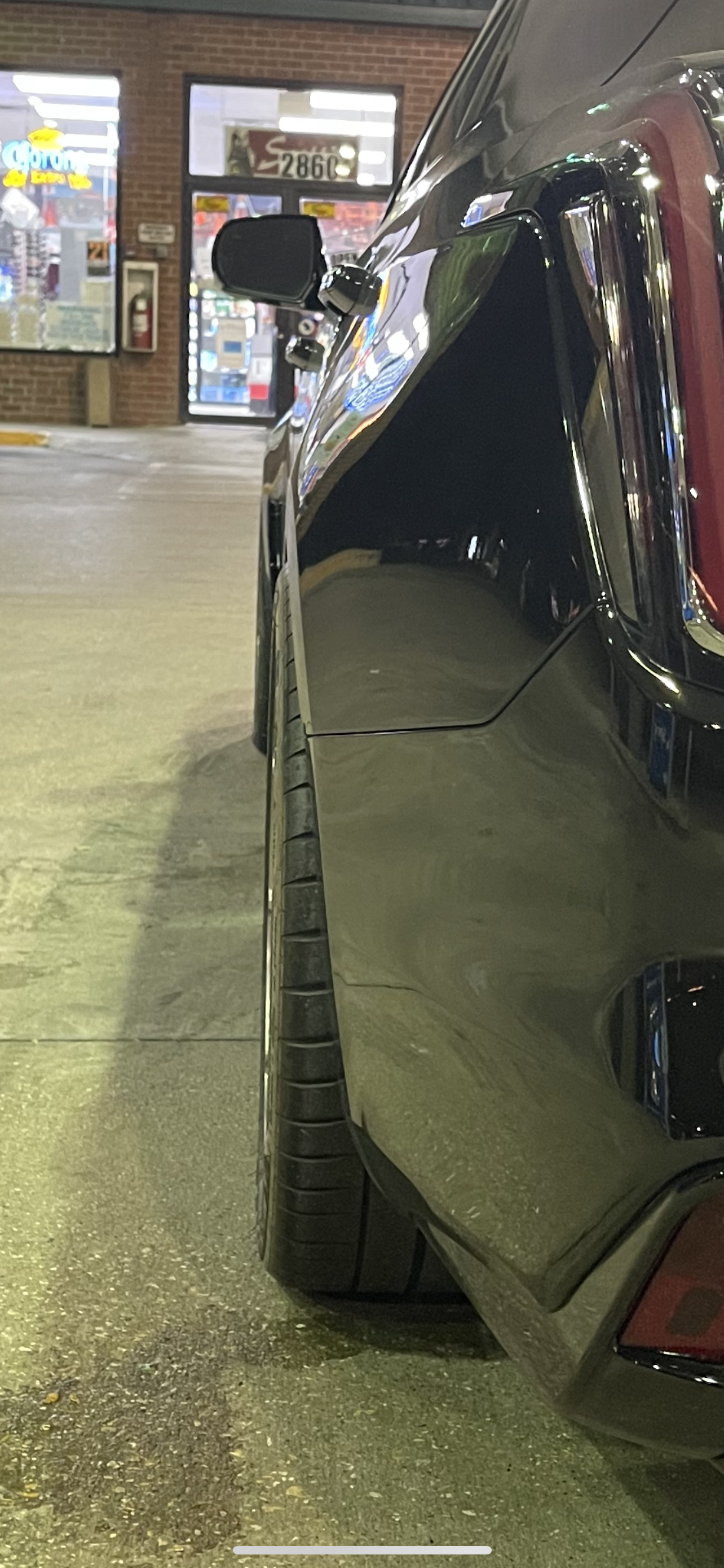

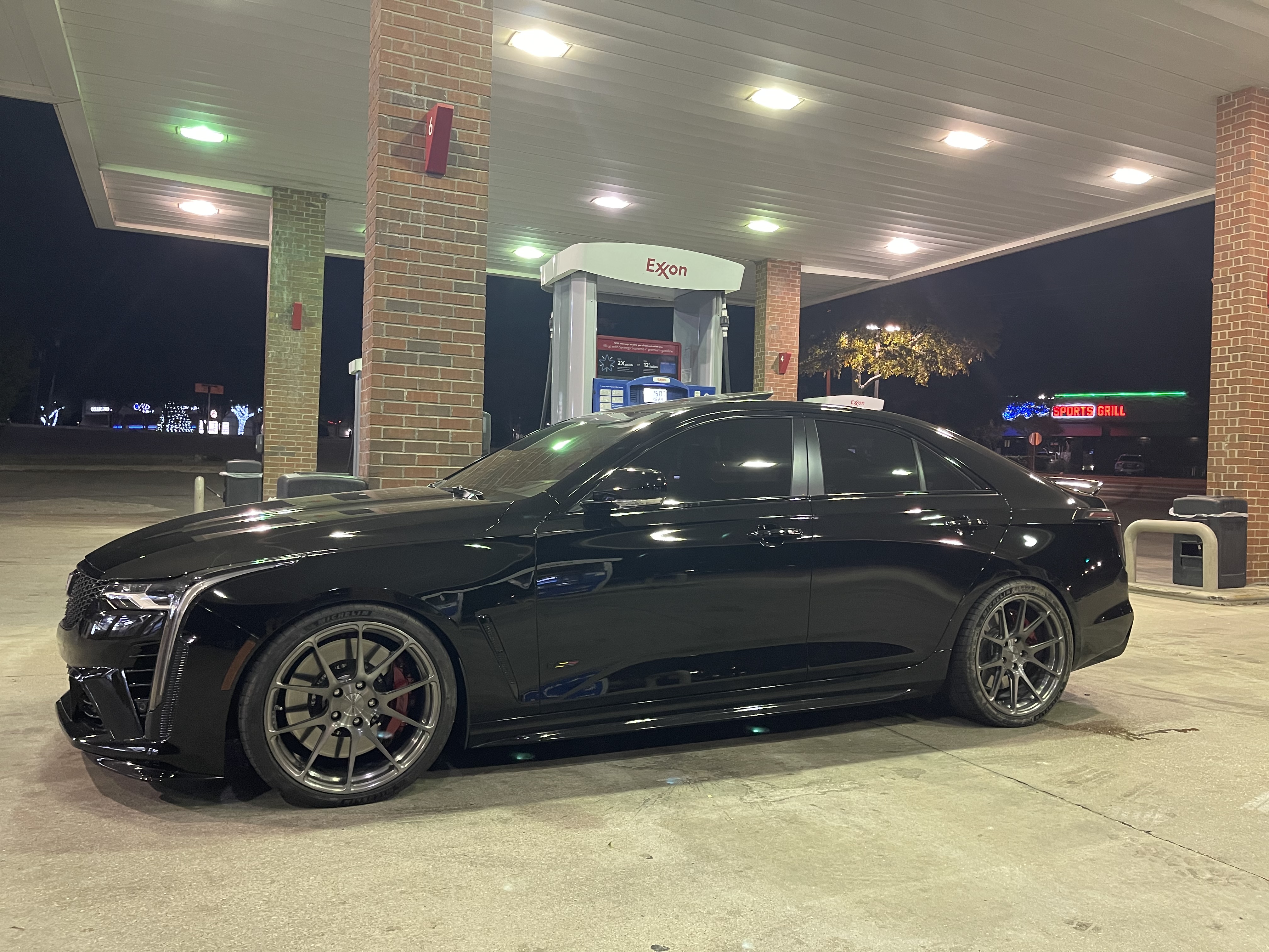

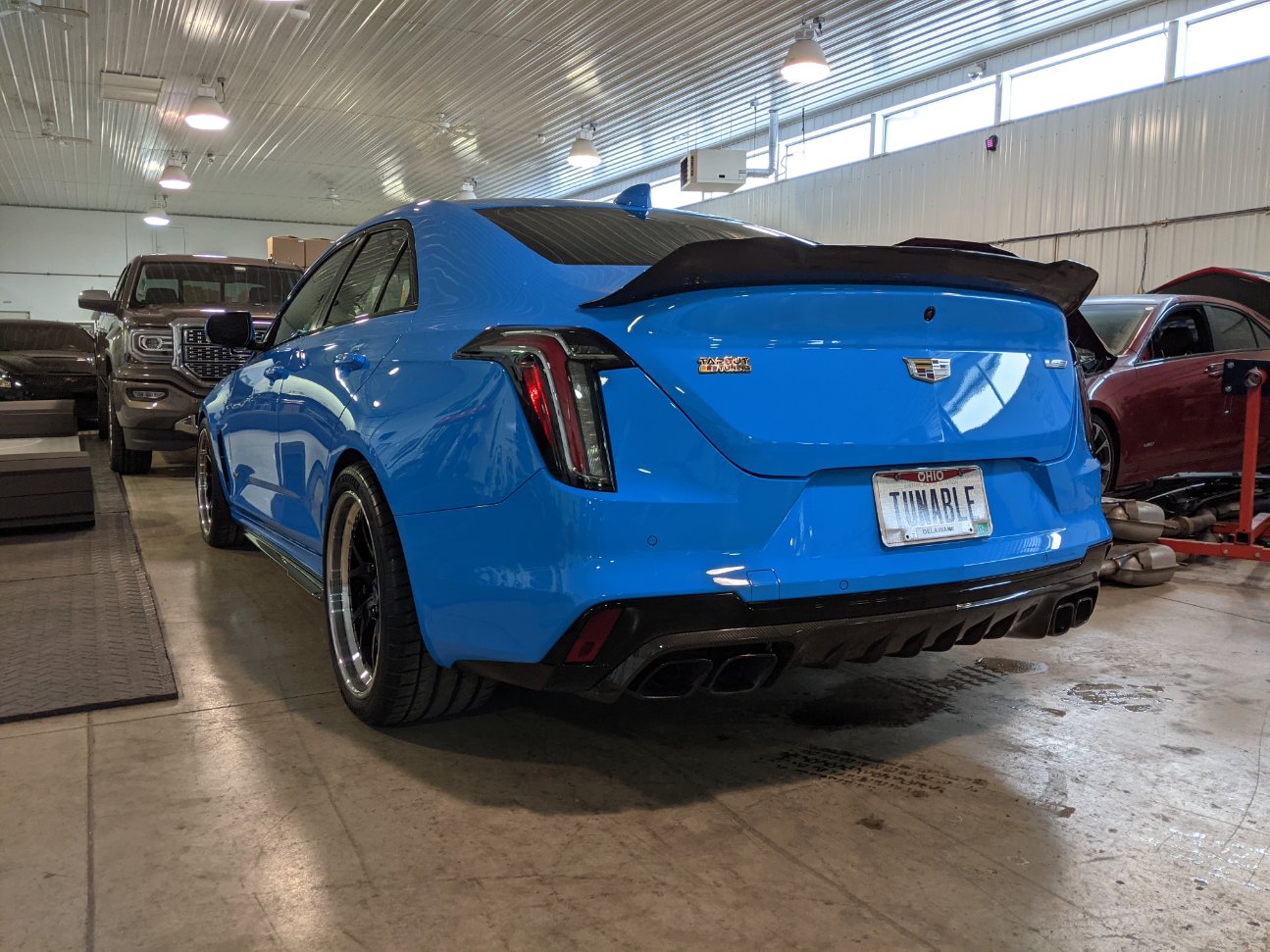

My CT4 BW with Forgeline GA1R’s
19X9.5 +25 front on 275’s
19X10.5 +57 rear on 295’s
Turns lock to lock as normal and no issues with rubbing in the rear. Lowered 7/8”-1” on all four using Swift Springs. Front has a 1/4” spacer and rear has a 1/2”. Would rather been able to using only a 1/4” spacer for the rear but needed 1/2” to clear the caliper. Wheels were originally built for a CTSV so I’m assuming this is the variable of with the caliper ordeal. Had issues once I went to a 1/2” spacer where the stock lug nut couldn’t catch any thread on the stock stud length. Ended up grabbing a shank style lug nut with a 3/4” depth that worked perfect. Issue #2, OD of the shank lug was 3/4” & ID of the bolt hole on the wheel was only 5/8”. Grabbed step bit with a 3/4” max tolerance and got to drilling. Wheels fit perfect now.
Your car looks great, but drilling the wheels instead of just getting longer studs is super f-ing sketchy.
Agreed. Thankfully there’s still over an inch of sidewall on the concave section before it runs into the spoke of the rim + the OD of the shank lug matching within a 1/32 of the stud hole ID. We had this on a jig / press to accurate drill these to insure everything was level. This was definitely not the first option, but coming from a hot rod type application, this is where the idea came from.
All I can say is...check those wheels often for fatigue fractures.
