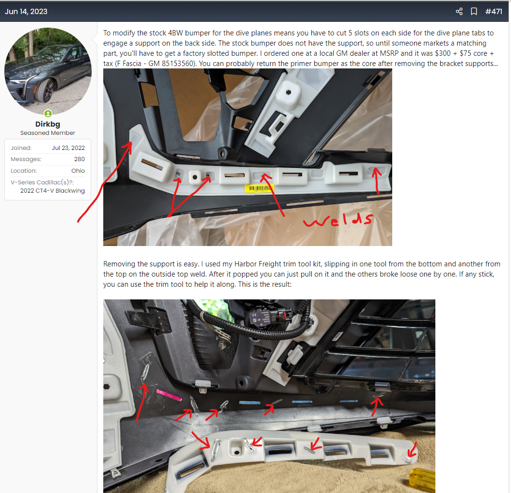

Some information for anyone else considering a CT4 BW Dive plane/splitter upgrade. I wish I knew this before I did mine, but now I know I can pass it on to others and save you the effort and money. I at one point considered detaching the backing support from the OEM CF bumper and cutting the slots in my original non-CF bumper. But I didn't want to risk making a template and getting positioning of the support bracket wrong. So I spent the money to have the replacement CF bumper painted, and had the PPF and ceramic redone. But, here is what I found that makes me wish I had used the original bumper and slotted it. It turns out the non-CF bumper has an outline of the support bracket AND the four slots it uses. The fifth (outer) slot is already in the outside support bracket - it's identical to the CF bumper. And so the slot is already positioned. So if you had a bracket, you could cut the slots, attach it, and you would have the CF bumper using your original bumper. Even if you have to buy the whole bumper, it was only $400 MSRP from the local dealer. It's much less from the online dealers, but the shipping is more than the part. It's a very large box. I have pics of it further up the message thread. Here are photos of the CF bumper, and the original non-CF bumper I replaced on my car.
How difficult do you think the mounts would be to remove from the carbon pkg bumper? Hard to tell how they are attached. Was waiting on the Tapout mounts but they've been pushed back months, so thinking of ordering a cf bumper and removing the mounts and attaching them to my existing bumper and cutting the slots.
Removing the supports was simple. I mentioned it in the previous posts, but they are simple little tack welds (about 4 or 5) you can separate with a trim tool or thin blade like a stainless steel spatula. I reattached with the epoxy I mentioned in the posts, and I think they are held on better with that. I also think you could return the bumper cover after removing the supports to get the core deposit back. Keep the box, they want it returned in that. The box is really big, you'll need a pickup truck or van to carry it. Again, I kept mine because I had already had it painted, ppf, and ceramic coated so I stored it as a spare.
