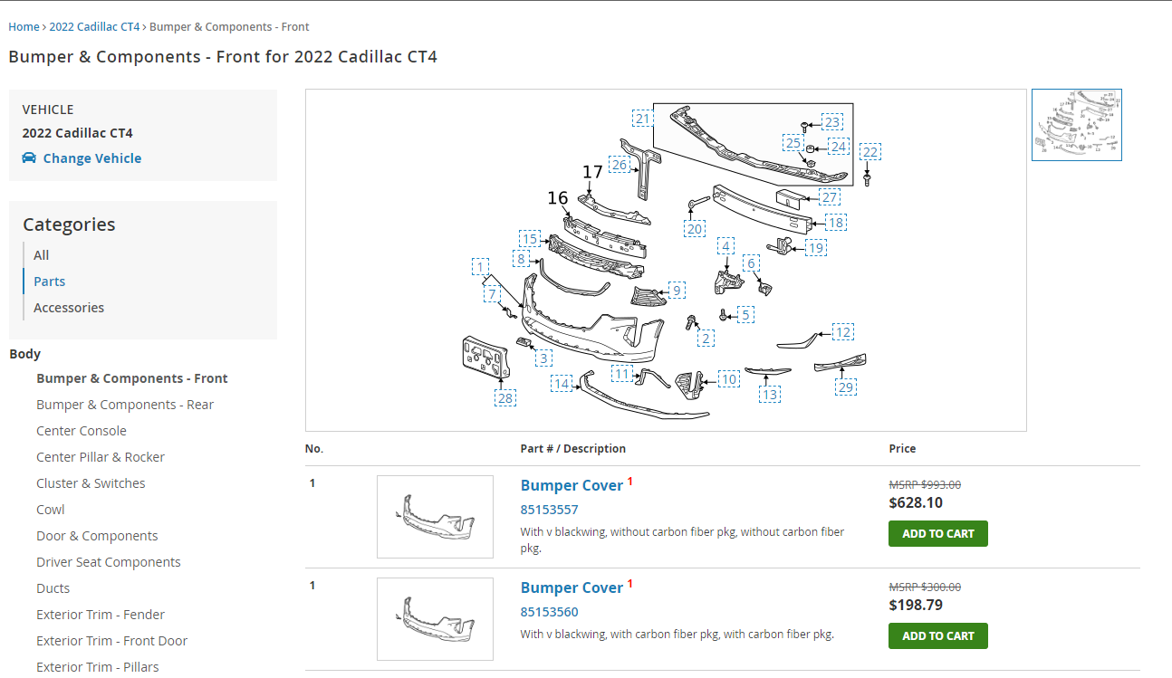

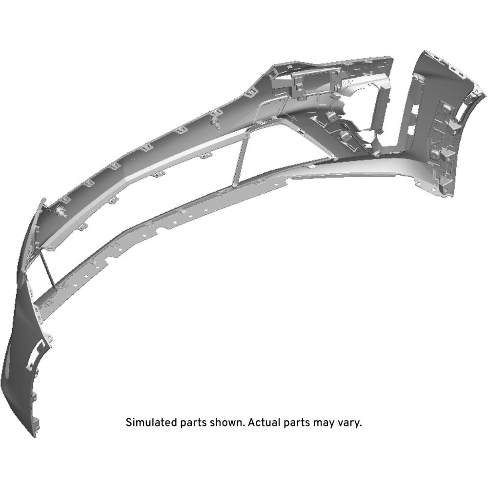

Are you just going with the splitter and not messing with the deflectors (dive planes)? I know they say the deflectors need a support for them in the front bumper cover, so on the gmpartswarehouse page I saw this crazy thing:
So the standard (non-CF) bumper cover is $628.10, but the one with support bracket for CF is only $198.79? If that's true, I might get one just in case I decide to go with a CF1 upgrade to my 4BW. There is the extra cost of painting, PPF in my case, and who knows what else with clips and fasteners. I would think the fasteners are the same except for the ones for the deflector attachments.

Correct, My plan is to not install the dive planes. I'm getting the wheel well deflectors from tapout but will stop there in the front of the car. The hassle of getting the bumper off, reinforcing it on the backside and cutting out the holes isn't worth it to me for the look.

I went through the motions of ordering the bumper cover and I found out some interesting things. First, there is a $75 core charge. Second, the shipping to Ohio from any of the online parts I found ranges from $350 to $450 dollars. So even using the local dealer at $300 MSRP to save shipping, there is still +$100 for core and tax. Not to mention body shop costs for painting, PPF replacement, and assuming I can swap the nose myself. Guess I'll be keeping the standard aero.
Yeah there are some annoying parts that had core charges that didn't make any sense. My second set of wheels had a $50 per wheel core charge which added $200 to the cost. I was also looking at a replacement trim piece for the dash that has since been corrected but originally was $30 but had a $75 core charge..... Like wtf it's injection molded and cost $2 to make no one can resell this if it's sent back. Gmpartswarehouse is in upstate New York and only charged me $12 to ship the front splitter to the Philly region. Box was massive but light. Perhaps try there? Gmpartsstore also has a discount code that should still work (7OFF)

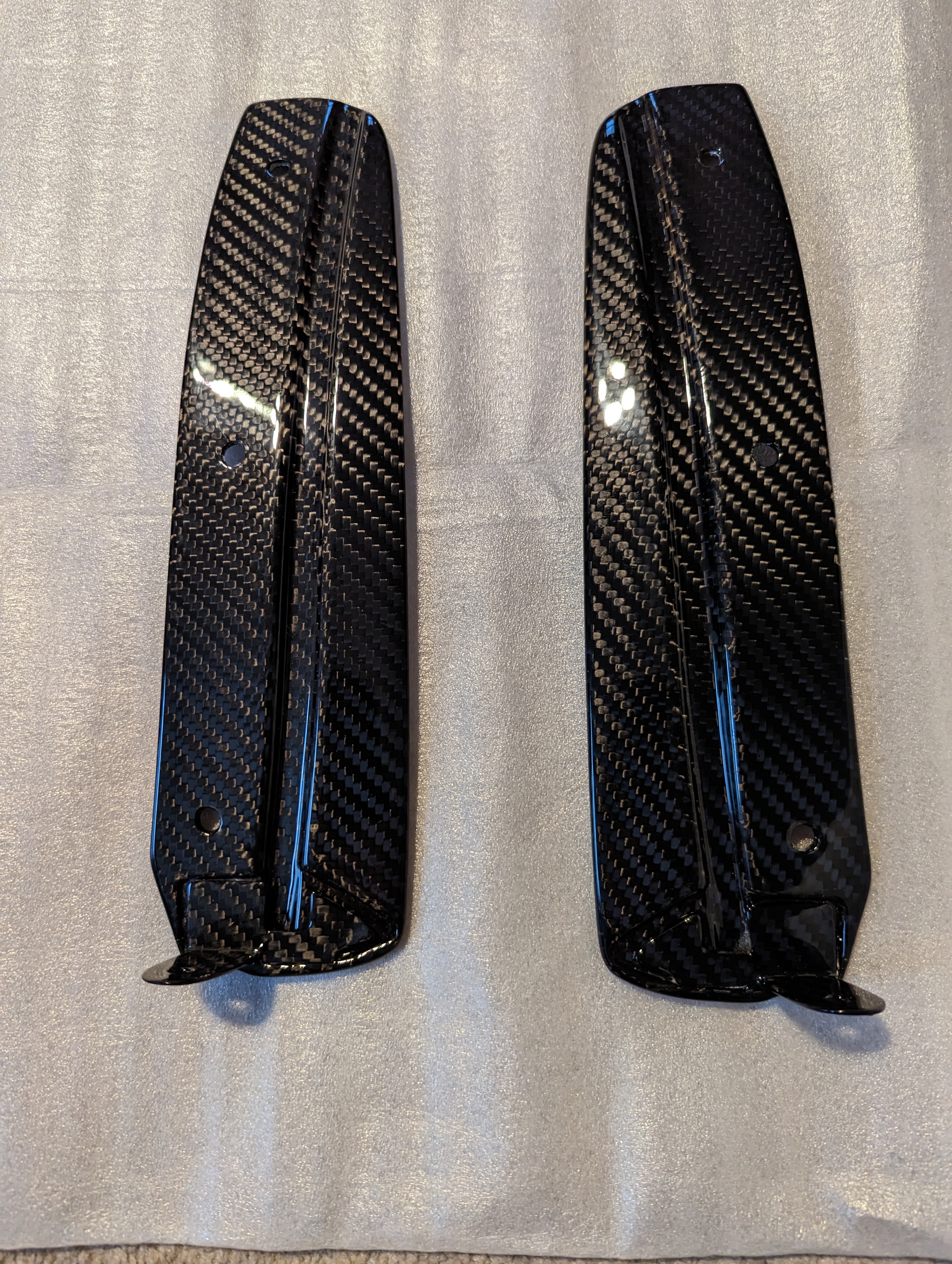

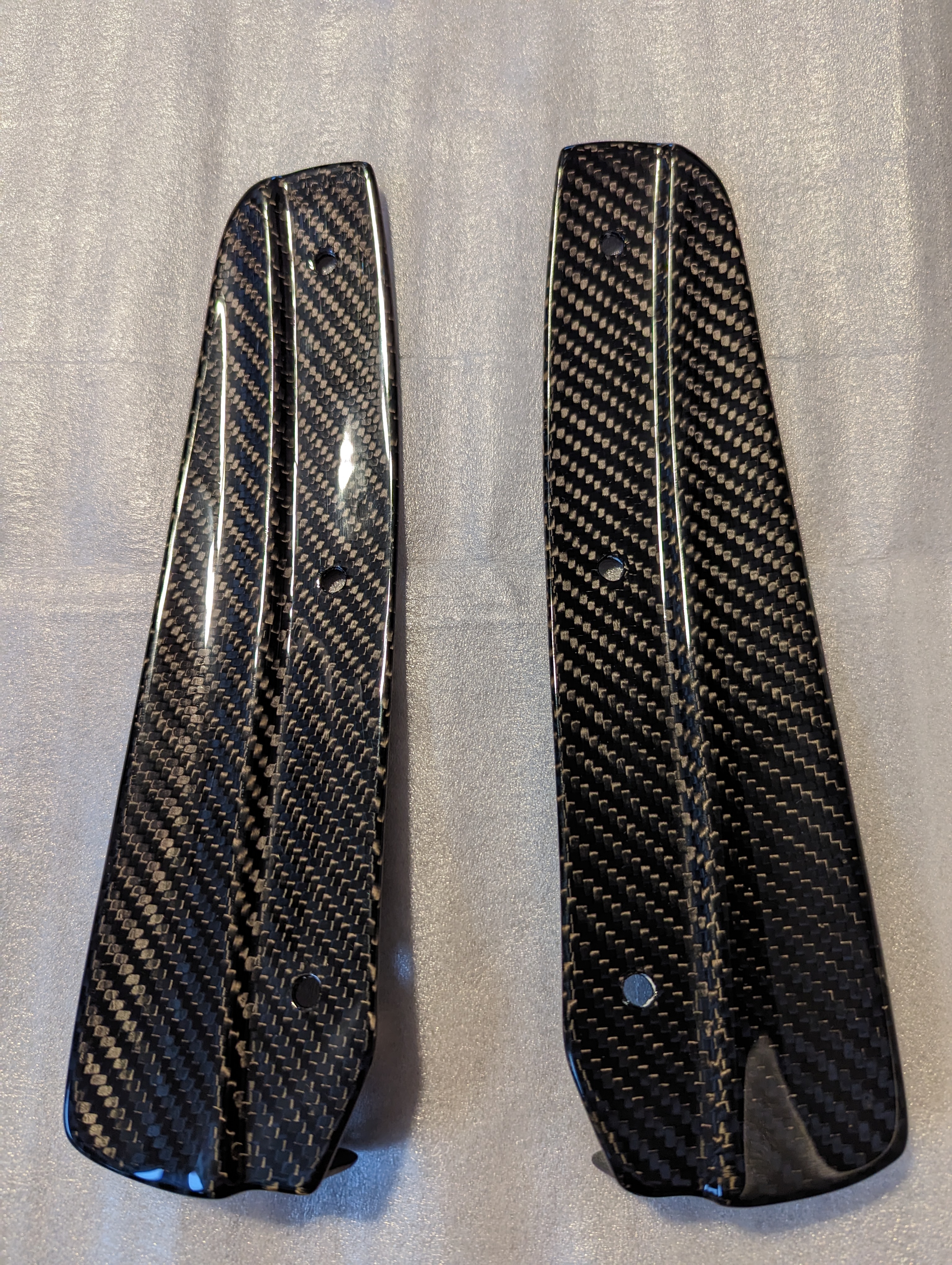

I dropped by and picked up the wheel deflectors and rear spoiler from Tapout Tuning this afternoon. They still had deflectors, but I got the last in-stock rear spoiler, at least of the OEM pattern.

looks awesome! I've got fedex tracking for what I assume are the deflectors. have not gotten a tracking for my spoiler that I ordered last week..... hopefully they didn't sell you my order lol. I posted in another thread, but I think to install those wheel deflectors you're going to need extra bolts and a speed nut. I ordered extras but will be away on a business trip for a week. if you end up needing some and what I ordered worked, I can ship some for cost of shipping.

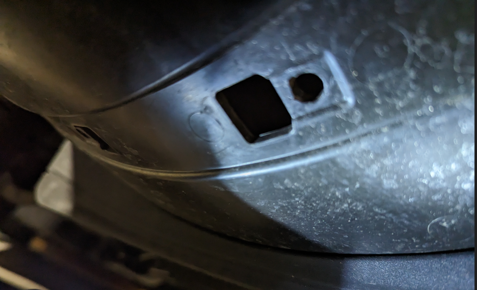

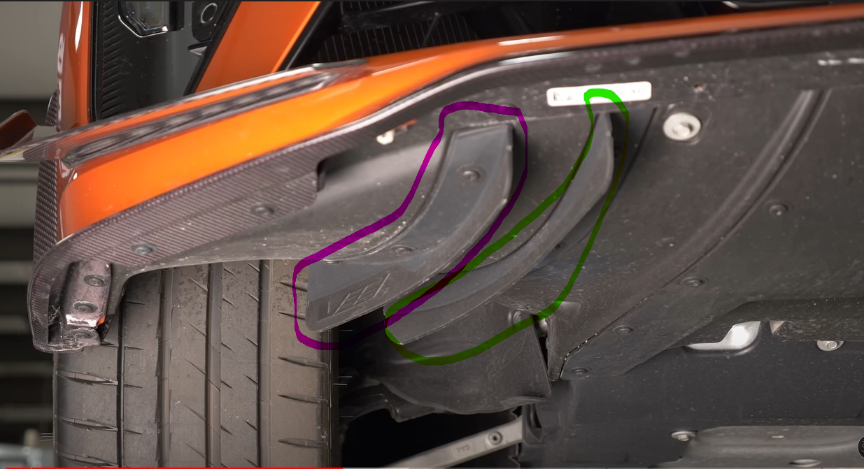

I mentioned I was ordering two inexpensive parts that were listed in the parts diagram called part 29 Air Deflector L&R for $5 and $7. I think I know what they are. In the Savagegeese video they have extensive images of the underside of the car including this. I looked under the nose of my standard aero car, and it has the part I circled in green. It is missing the part circled in pink, and there are three holes matching those screw locations. So while it may not be necessary, it is an additional part the CF cars have the standard car doesn't.
I wonder if those parts attach with the same 11548579 nuts and screws the carbon wheel deflector uses.
good call out. I did not jack my car up when doing the front lip so I only saw those from the sides and assumed both were there (used that savagegeese vid to confirm how the factory lip was mounted). I may have to order those parts in then. were you able to peer up in the holes to see if there was a nut or anything to mount to?
I stuck my phone under there and got a pic. It looks to me like the same clip nut and screw for the wheel deflector would be used here.

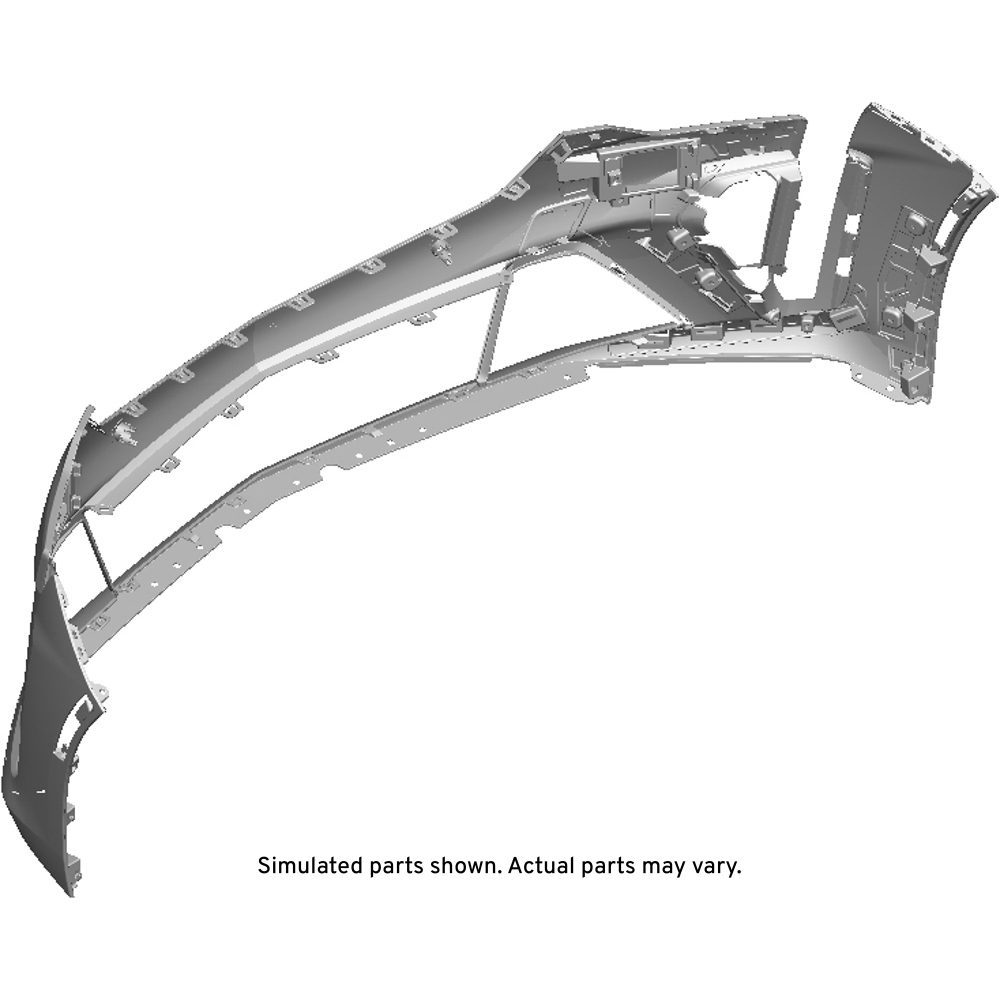

unfortunately I found some diagrams that are going to confirm that the dive planes will require a new front bumper - you can see the cf bumper has all the mounting clips present on the inside vs the non cf one that is smooth. likely a plastic piece that is plastic welded to the bumper at the factory but there won't be a way to get that separate since they have different p/ns for the bumpers. so if you are dead set on the dive planes, it'll require a new bumper that must be painted.
