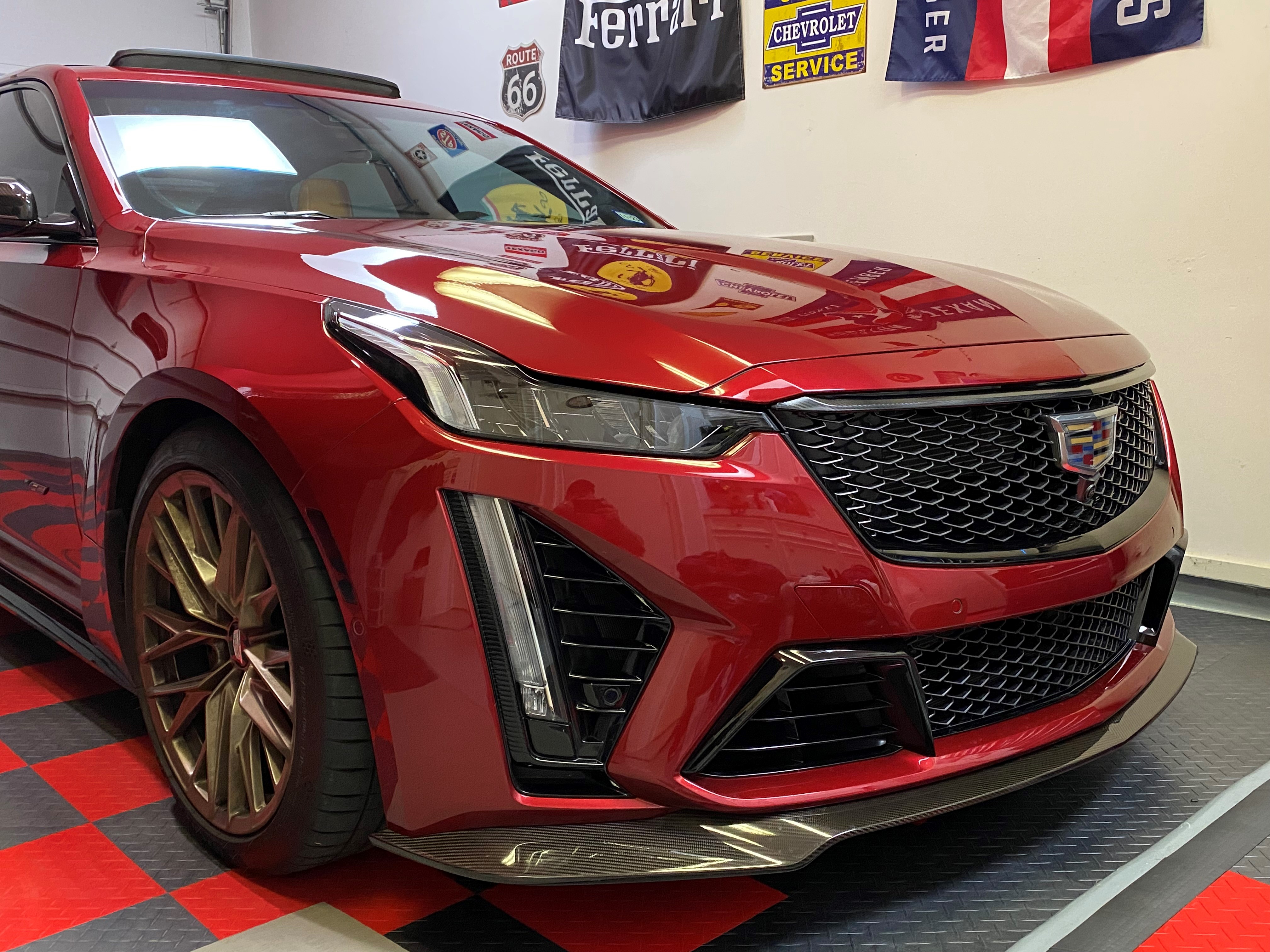

I can’t tell from the picture you posted, but did you add the cabron fiber trim right above the front grill? If you did where at? Im also interested in adding the CF pieces
I purchased this 5BW from the original owner. The top area right above the grill is a carbon fiber wrap. It actually looks really good. If I replace this piece, it will definitely be the last part that is done.
It would be the first for me. Since it’s the cheapest 😂. Front splitter looks great. I’m just scared it’ll scrape my drive way. Plus my BW is black. Not sure how noticeable the CB would look

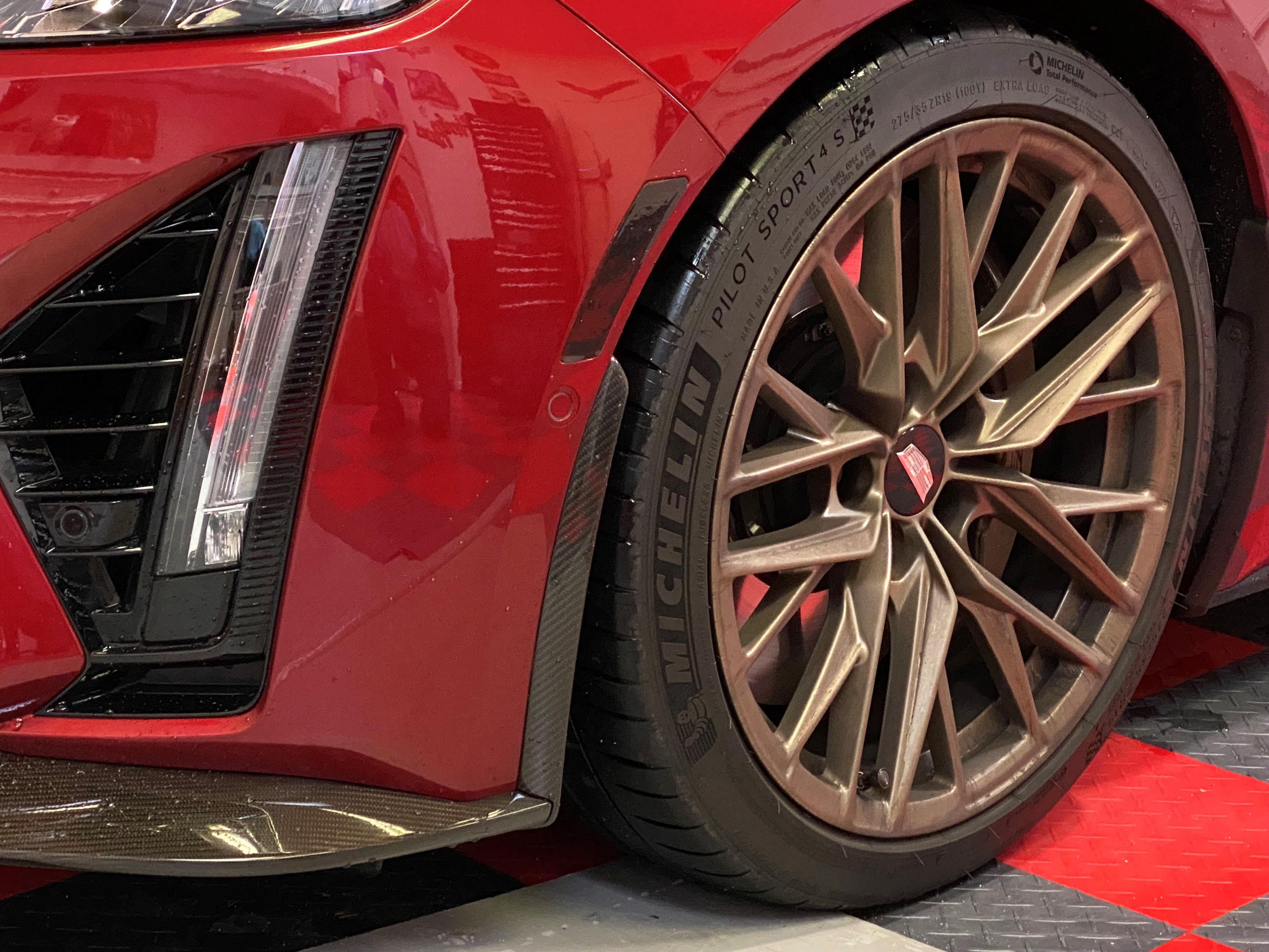

Yes, I bought one box which has 8 strips. I only used two of them. One under the center of the splitter and I cut one in half and used each half under the splitter scallop where it comes closer to the ground. My CF splitter has 5.5 inches of ground clearance in the center and 5 inches where the splitter jogs down a bit. Those were the two places I used them. Also the bottom of our CF splitter is only 3/4 of an inch deep and these are bit deeper than that so I just trimmed them with a scissors to 5/8th of an inch to make them fit properly.

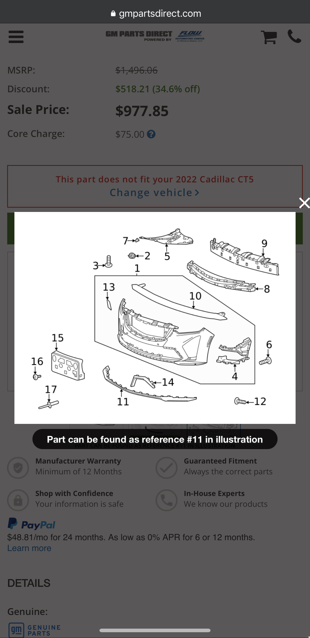

So checked site, not very specific about them.
Fender extension 84618177
Fender extension 84618178 no description of left and right. $622.15 and $578.74 respectively.
Spoiler package 84331245 $1369.29.
No illustrations or actual description.

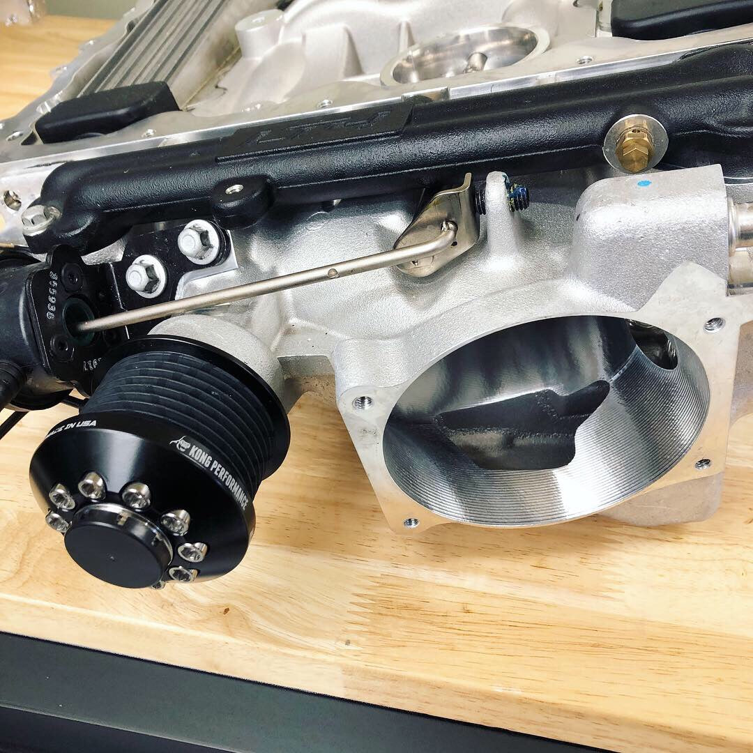

Think I'm going with Kong Performance about porting my blower manifold first.:_rock
I'm sorry I don't have any installation pictures, not good by me. It was quite a mission. The bottom facia has to be completely View attachment 13634taken apart to properly take the stock lip off and install the new cf piece. It was a two-hour job, but well worth the time and effort. I would think that this install is very similar, if not exactly like the install on the 4BW.
Looks great, double take and I see you placed your Vee Badge on the lower door, looks like the 4BWs? Hmmm, Deception in the works! LOL!!!! Congrats, looks like factory.
Think recently they posted a test run on the Dyno with 660HP at the wheels and it sounded great! Stock pulleys, just port your charger and bolt it back on. Instant HP!
