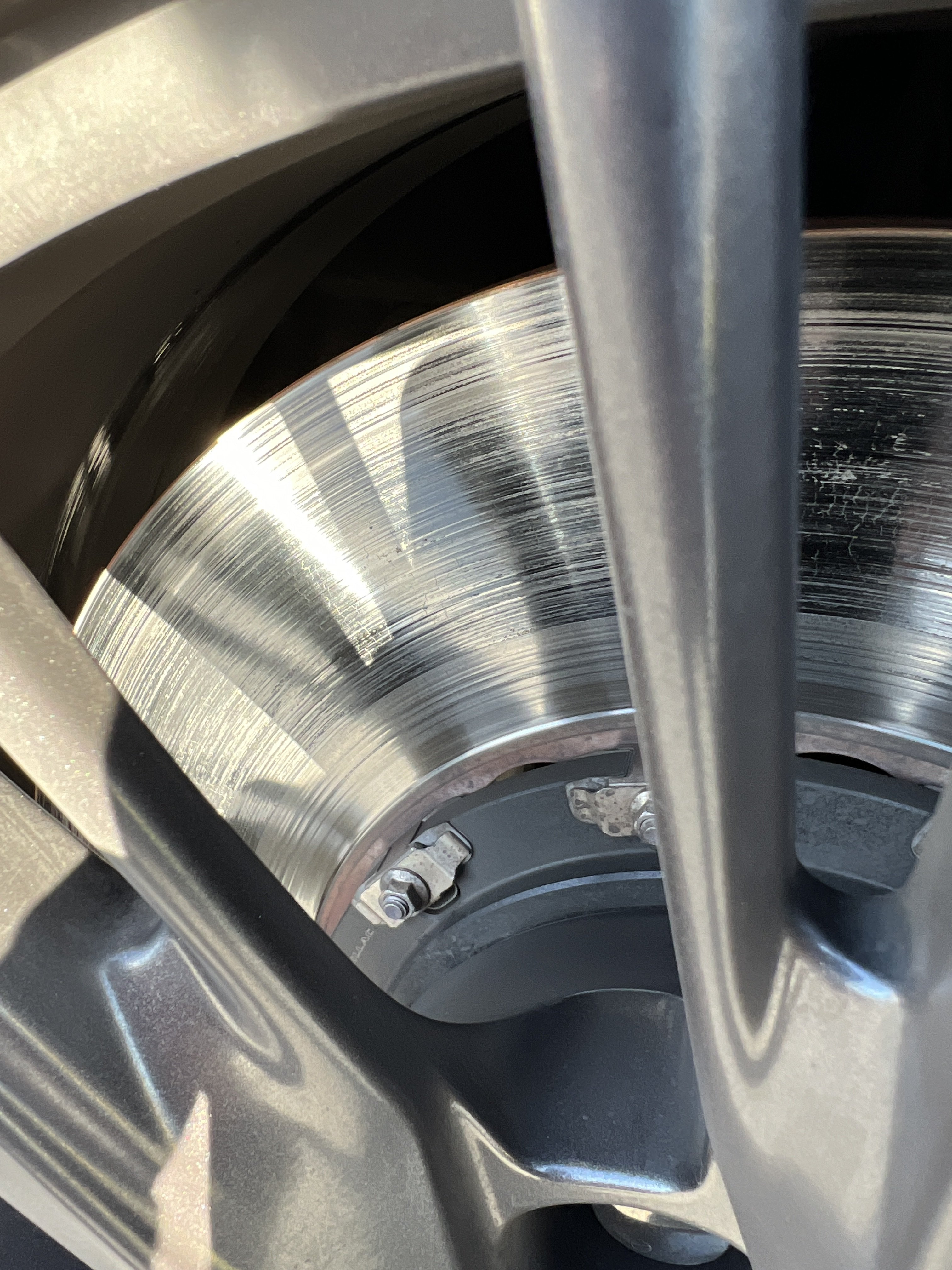

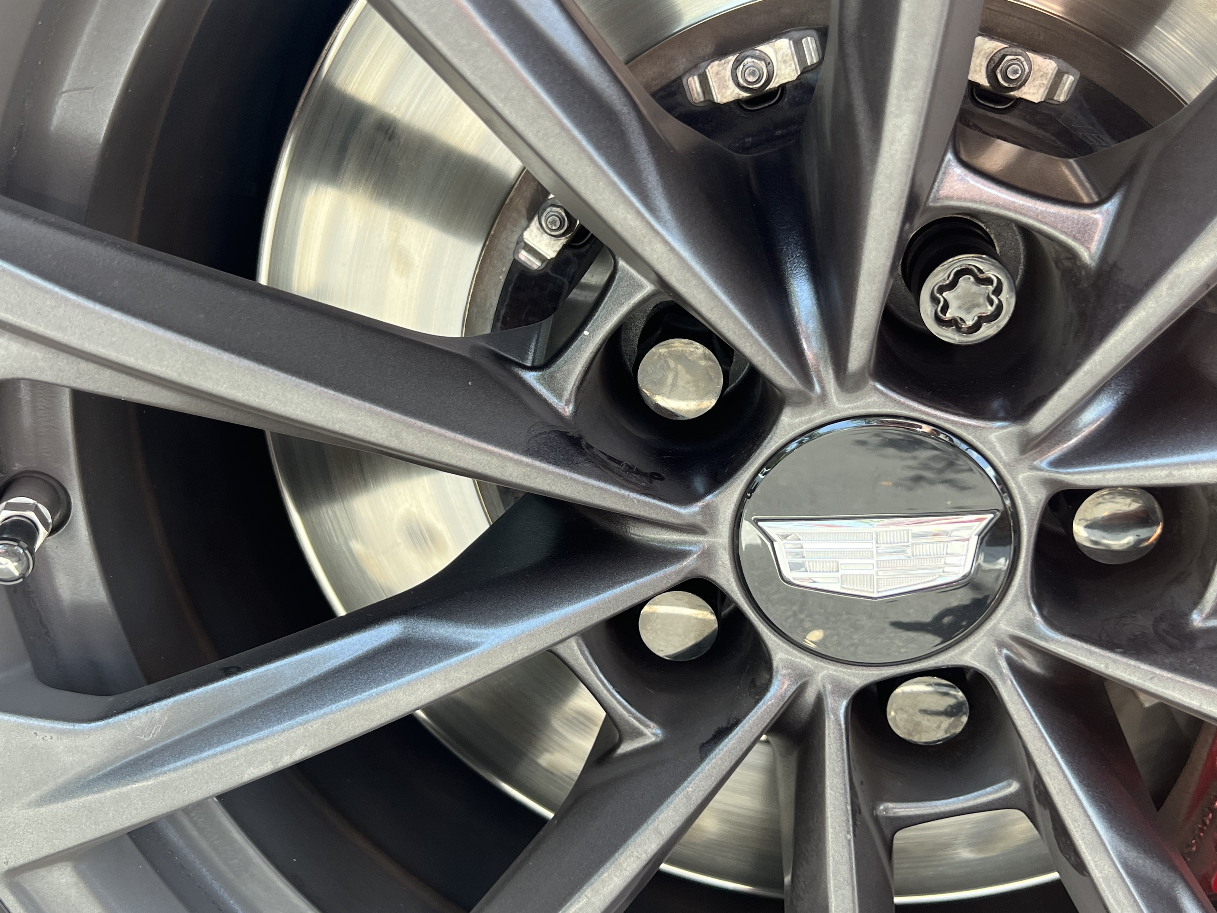

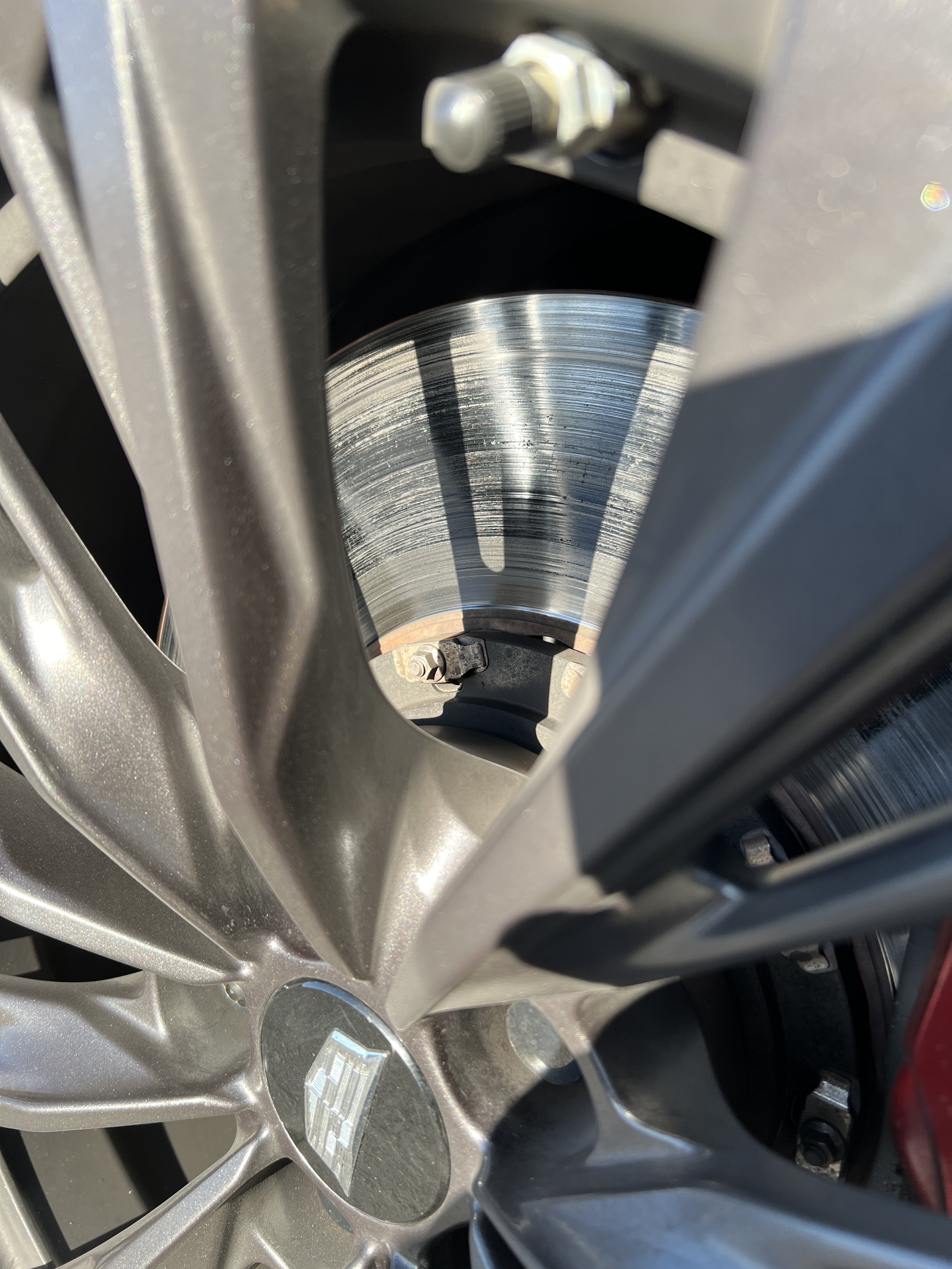

These are mine, I think you are fine. They can't resurface them, and if I have 27k miles on mine, and they aren't cracked or your depth is still in range, I wouldn't worry about it. If you have noise that's normal. To get rid of it I'd recommend a few hard stops from 60mph or so. I had some noise, did a track day and noise went away again.
