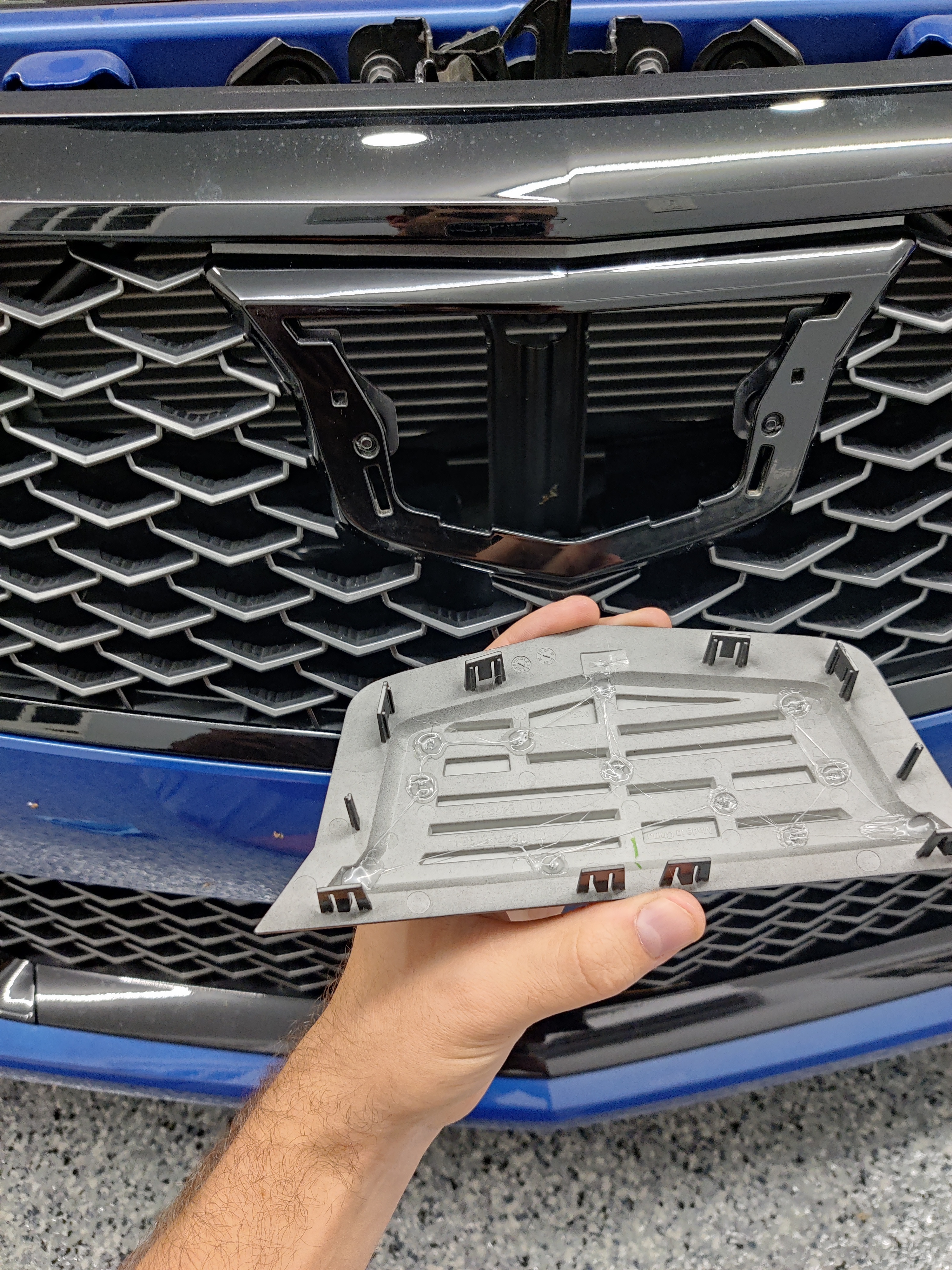

if you're doing the front, def buy a new badge, don't try and paint the existing. the clips can be broken with 1 finger sticking through the grille to pull it off.

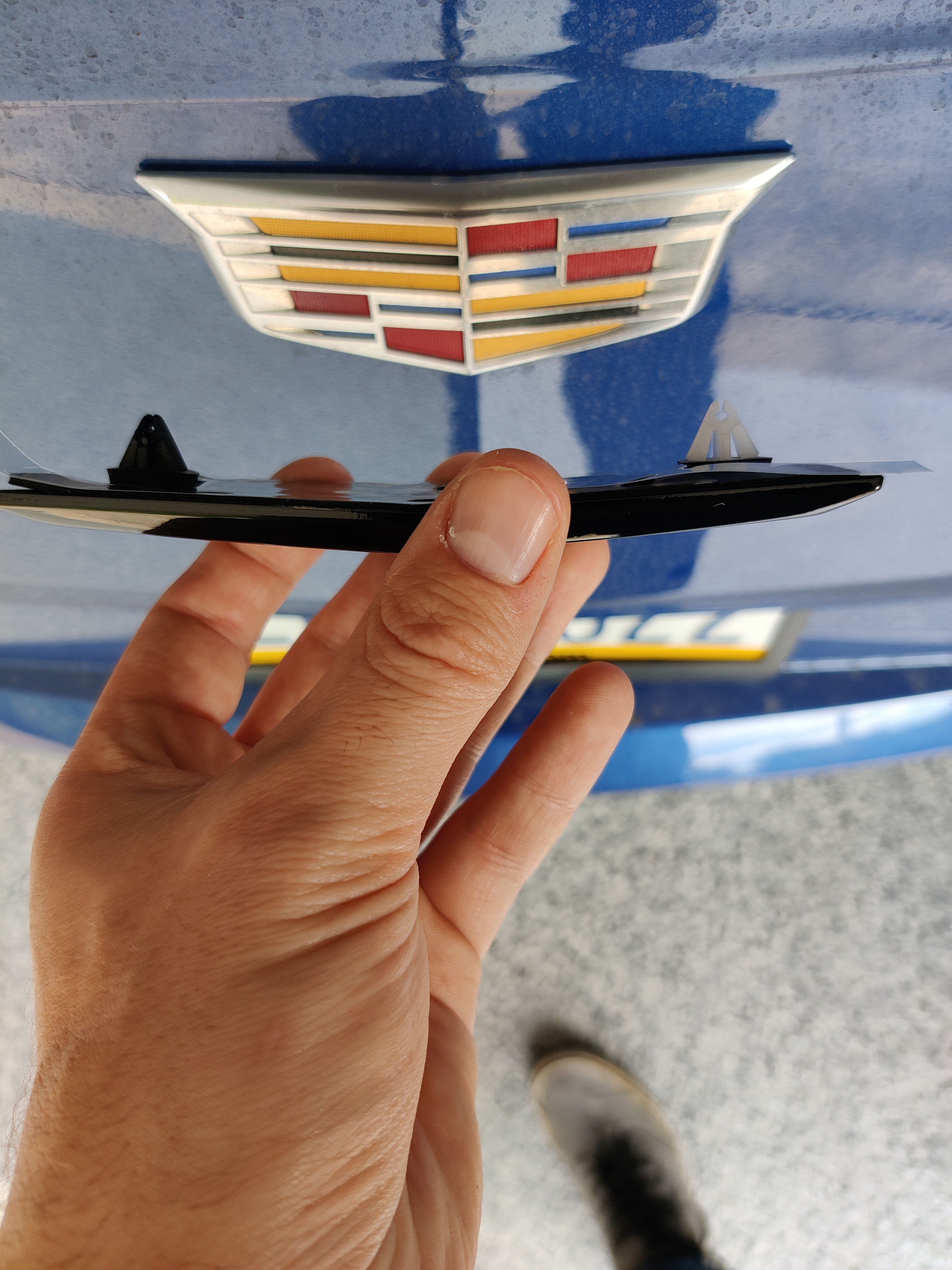

pics of rear and front for anyone else that needs to know where the clips are.
