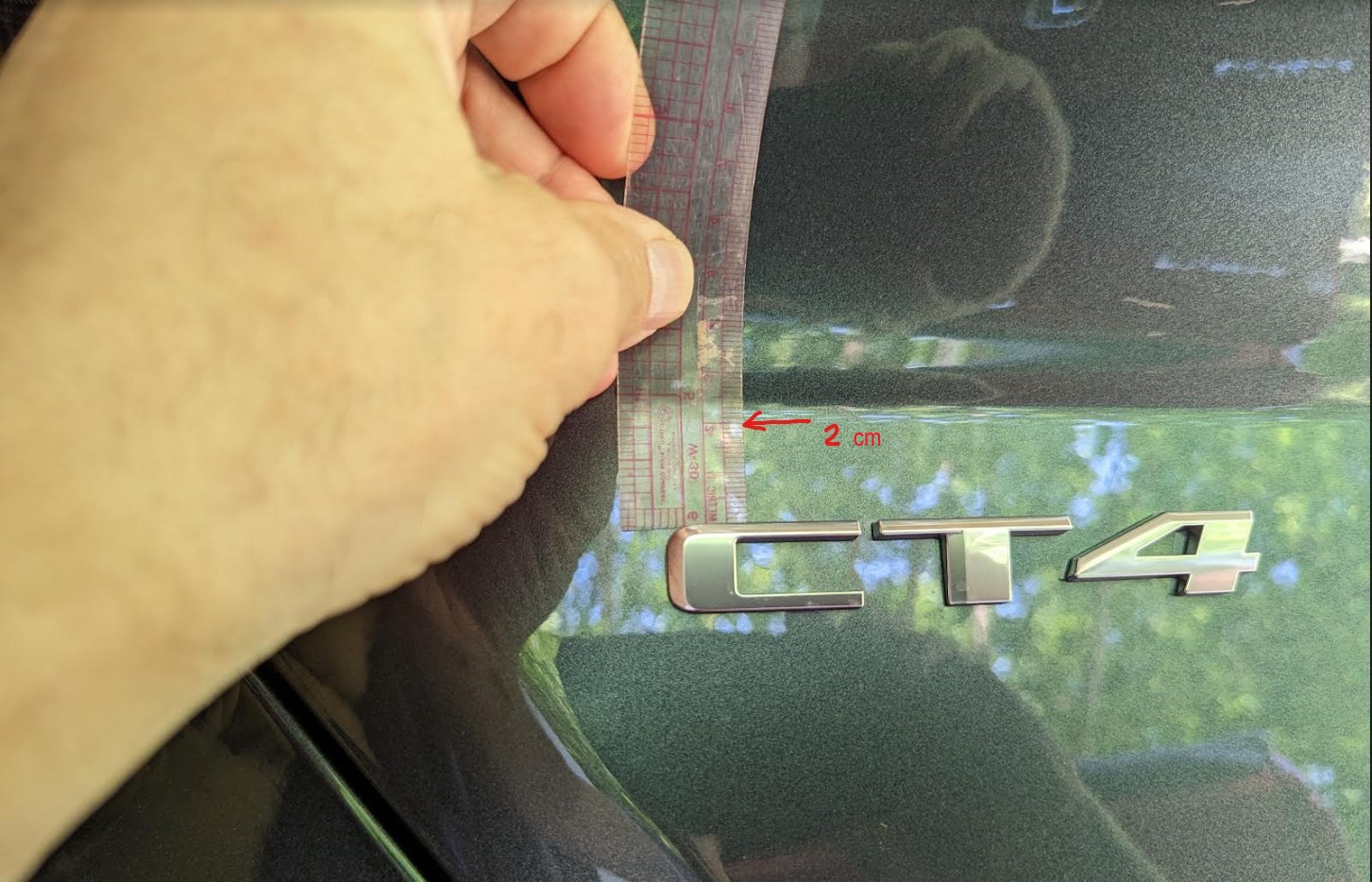

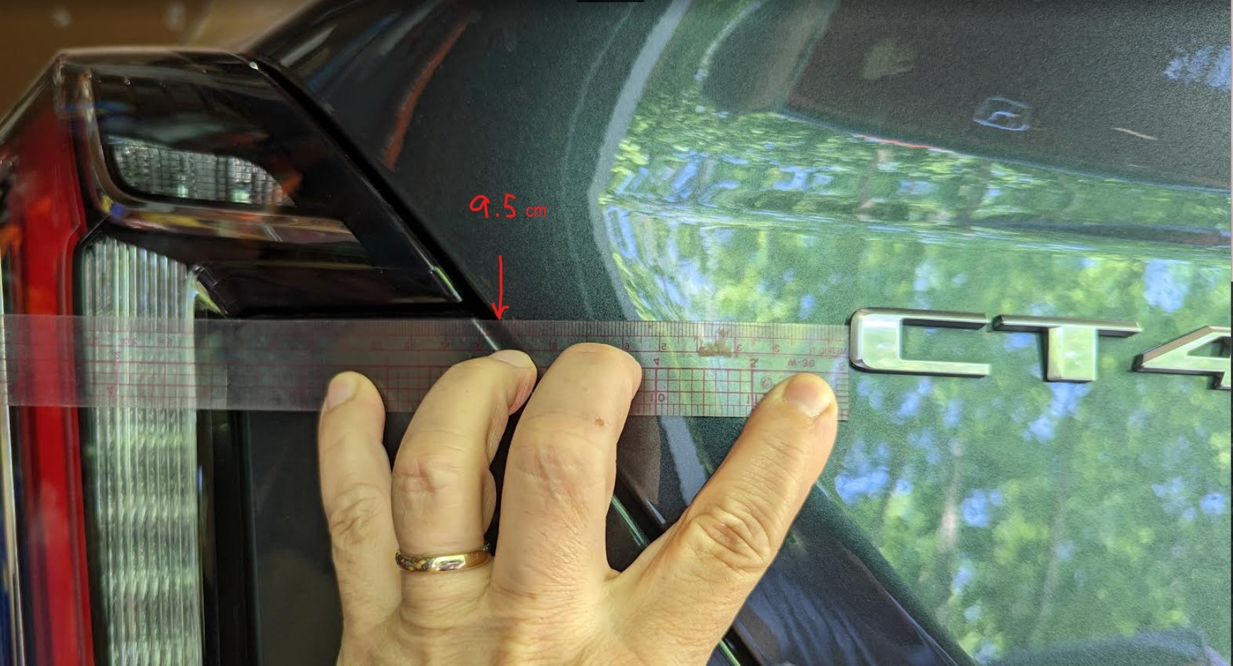

Can someone please be so kind as to provide me with some measurements to assist me in installing a new "CT4" emblem on the trunk? The body shop left it off and sent me the emblem for me to re-install and I don't want to guess as to the exact location. Thanks!
That's exactly what I'm trying to avoid. :)
On my car, the C is 9.5 cm from the edge of the trunk lid along the line shown in the photo (top of bumper edge). It is 2 cm from the bottom of the body line, just where the curve of the line starts. Both my Cadillac emblem and V emblem are 1.5 cm down from that body line, so it is lower by .5 cm than those.

Thank you so much!

cm not mm in case anybody references this post in the future.
