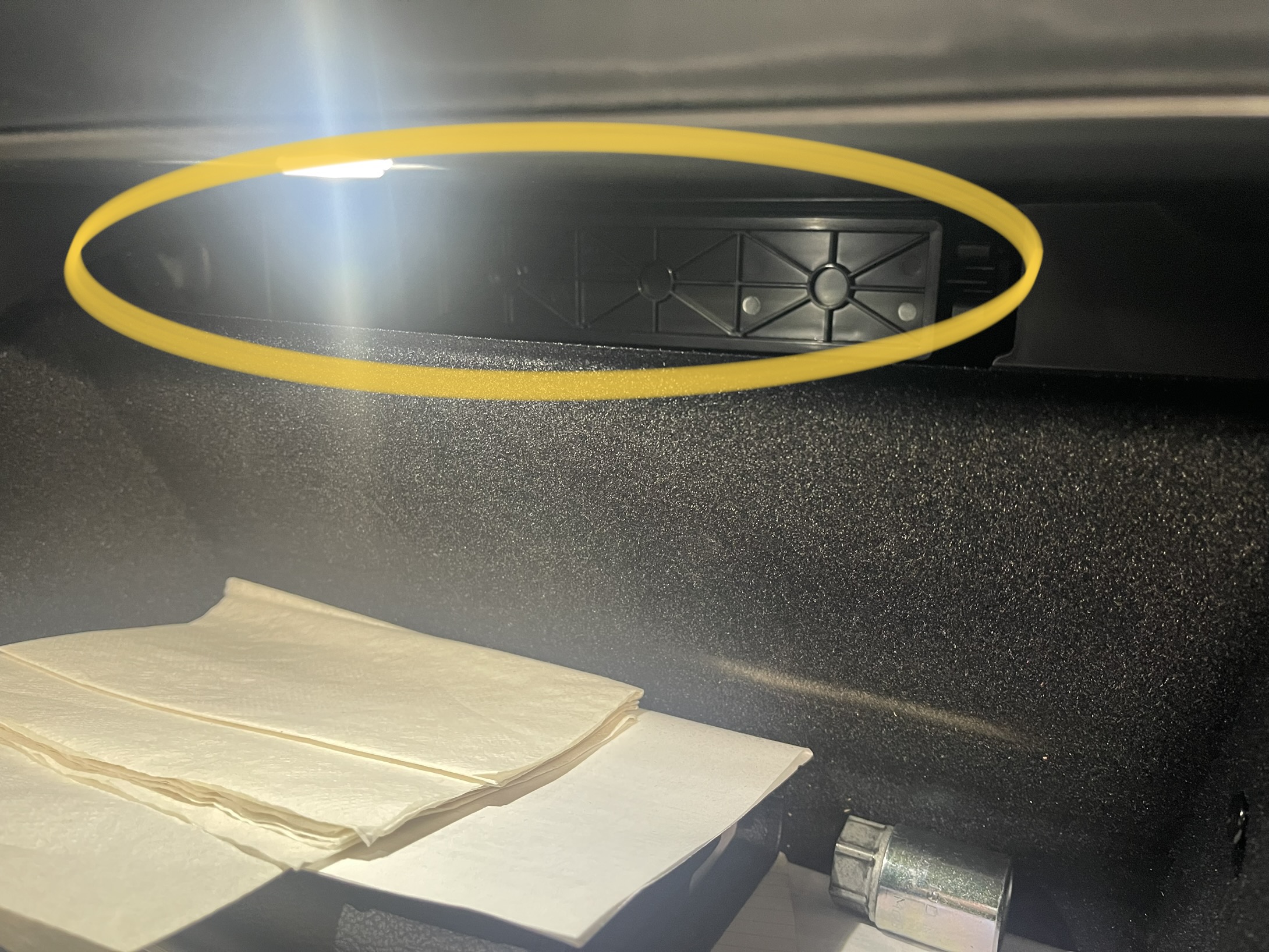

It's a 2 minute job. Sits right behind the glove box. Depending on finger dexterity, you may need to drop the box ot of the way by pressing in on either side. I didn't need to move the glove box. When you put the new one in, pay attention to the direction of air flow. The filter will have an arrow.

Filter Access

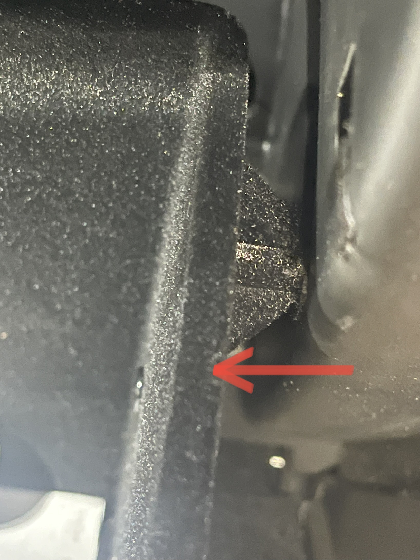

If you need to drop the glove box, press inward on both sides at the tabs.

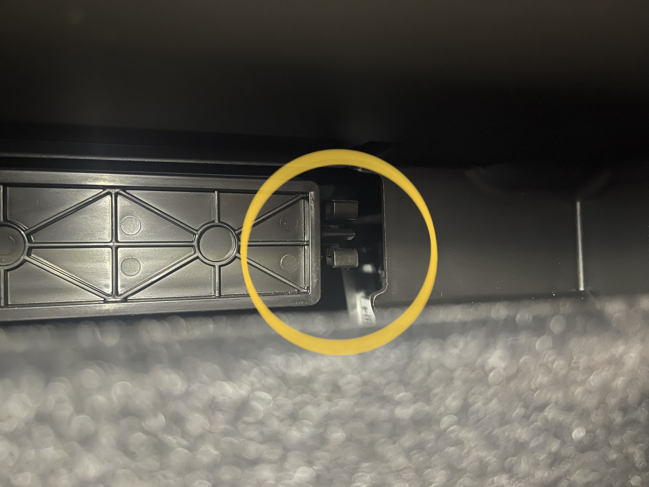

That's the clip for the filter cover. Remove, pull out old filter and replace.
It really couldn't be easier. With by big fat hands (did have to remove rings/watch), I can actually go in above the top of the glove box w/o displacing the hinges of the glove box and replace the filter in less than a minute.
