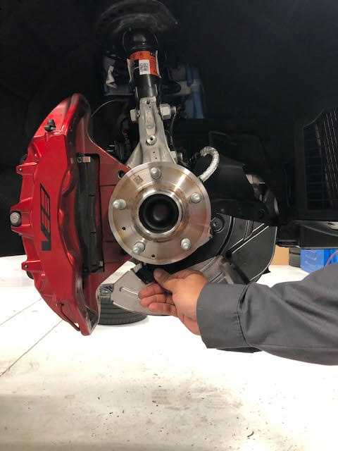

Are these part of the track items that are for track use only. The dealer stated that to put these on they would have to remove the others. I just wanted to confirm that these were part of "Track Use Only" including the brake air ducts.
Yes track shield. Opens lower portion of rotor to more airflow. The deflector in control arm needs to stay not track only. I am really worried how confusing this topic is to dealers. There is instructions in the bag and owners to not do anything to the brakes during PDI.

There is some downside, to the small Track Brake Shields, in that if you live in cold climates you will over-cool your brakes which isn't ideal for panic stopping or rotor wear.
In warm climates, it would be less of an issue.

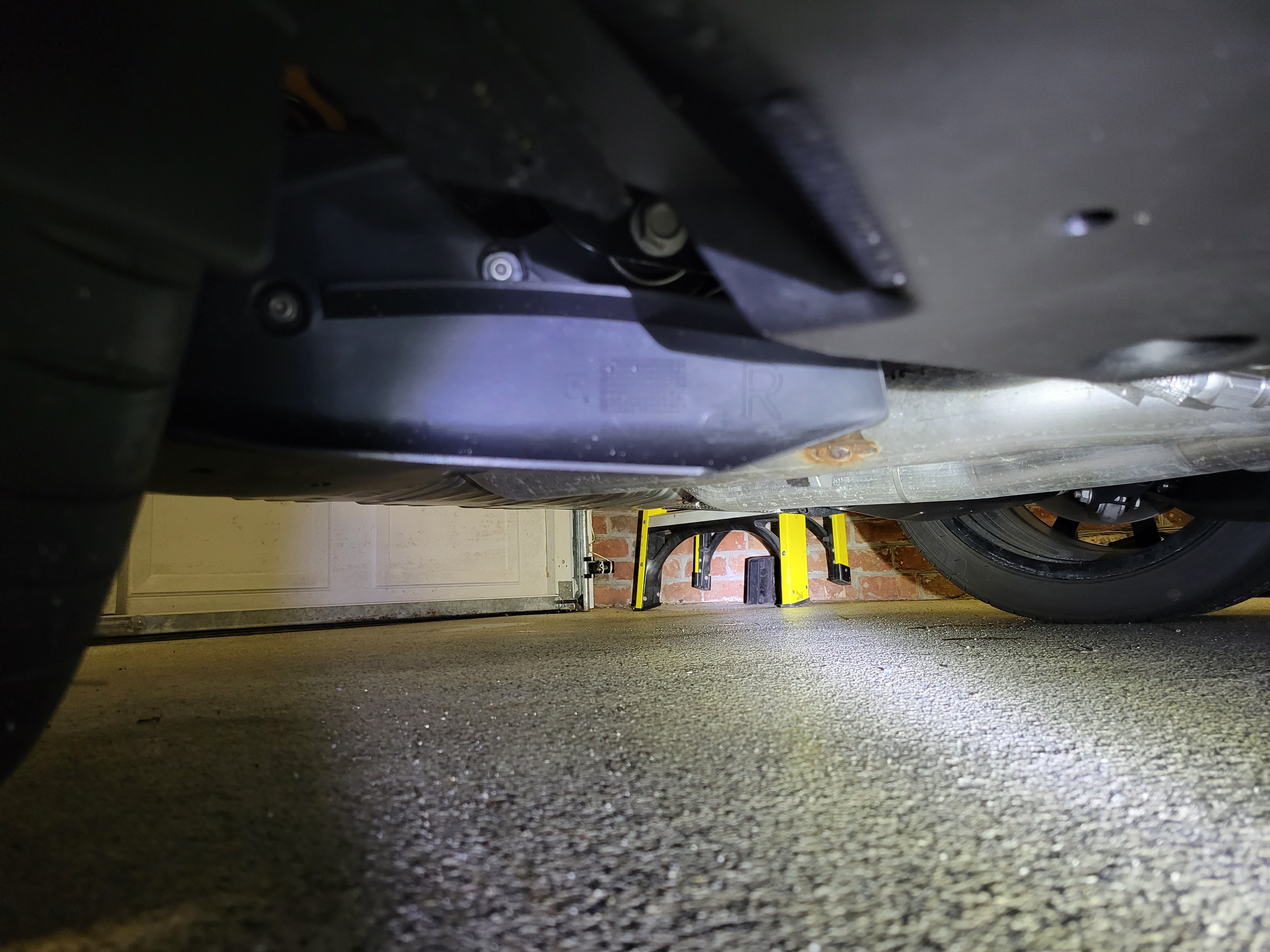

I just got my car last night and I sent my salesperson the exact instructions about installing front rock guards and not installing the rears brake shields. There is nothing in my trunk and this is a pic from underneath. Should I bring it back to the dealer for correction?

Its written in the owners manual and a big sheet in the bag with parts saying track only. A bulletin is not gona do much if the papers in the cars are not even read.
I would.
Yea, my dealer seemed a little confused. I guess it's not common to have a bunch of extra parts
