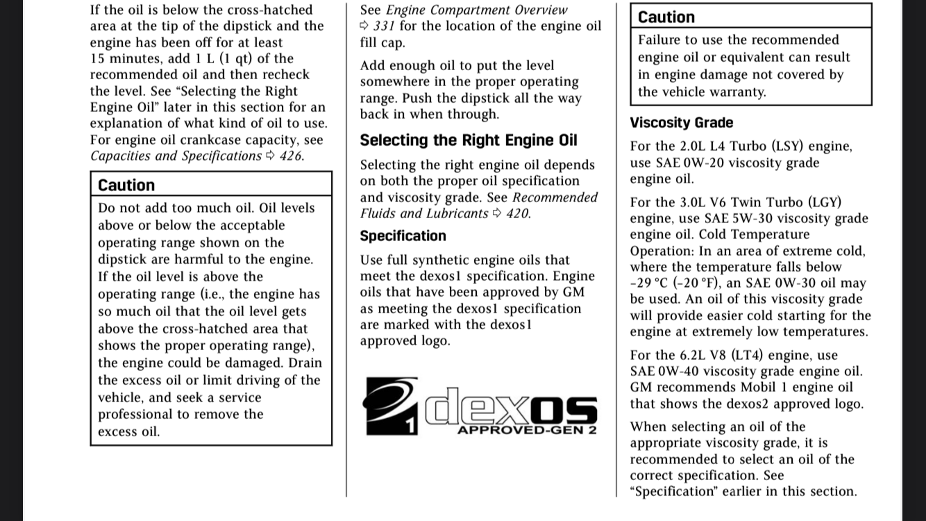

Took my CT5 in to the dealer for a break-in change at around 900 miles a few weeks ago, and the invoice worksheet shows that they used GM Part 88862479, which is the Mobil 1 Euro Car formula 0W-40. How much should I care that they didn't use the Dexos2 spec ESP blend from a technical perspective (beyond it just being incorrect)?

I’d complain and get them to put the correct oil in. The owners manual spells it out pretty clearly. Putting in non recommend oil that doesn’t meet the spec they ask for seems unwise. It’s pretty ridiculous a dealer would put in non recommended oil in a car under warranty.

As a prior ZL1 (LT4) owner I agree. The engine calls for 0W-40 ESP Dexos 2 spec, which is about $10 per quart vs. the $6.49.
You can use the Euro ESP Dexos2 stuff as seen on the label here but it is supposed to be Dexos2, which costs more and only comes in 1qt bottles.
