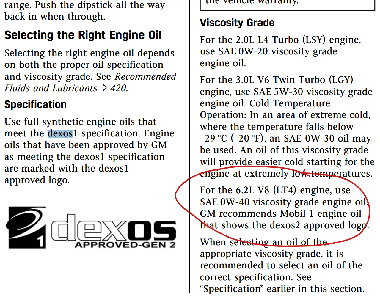

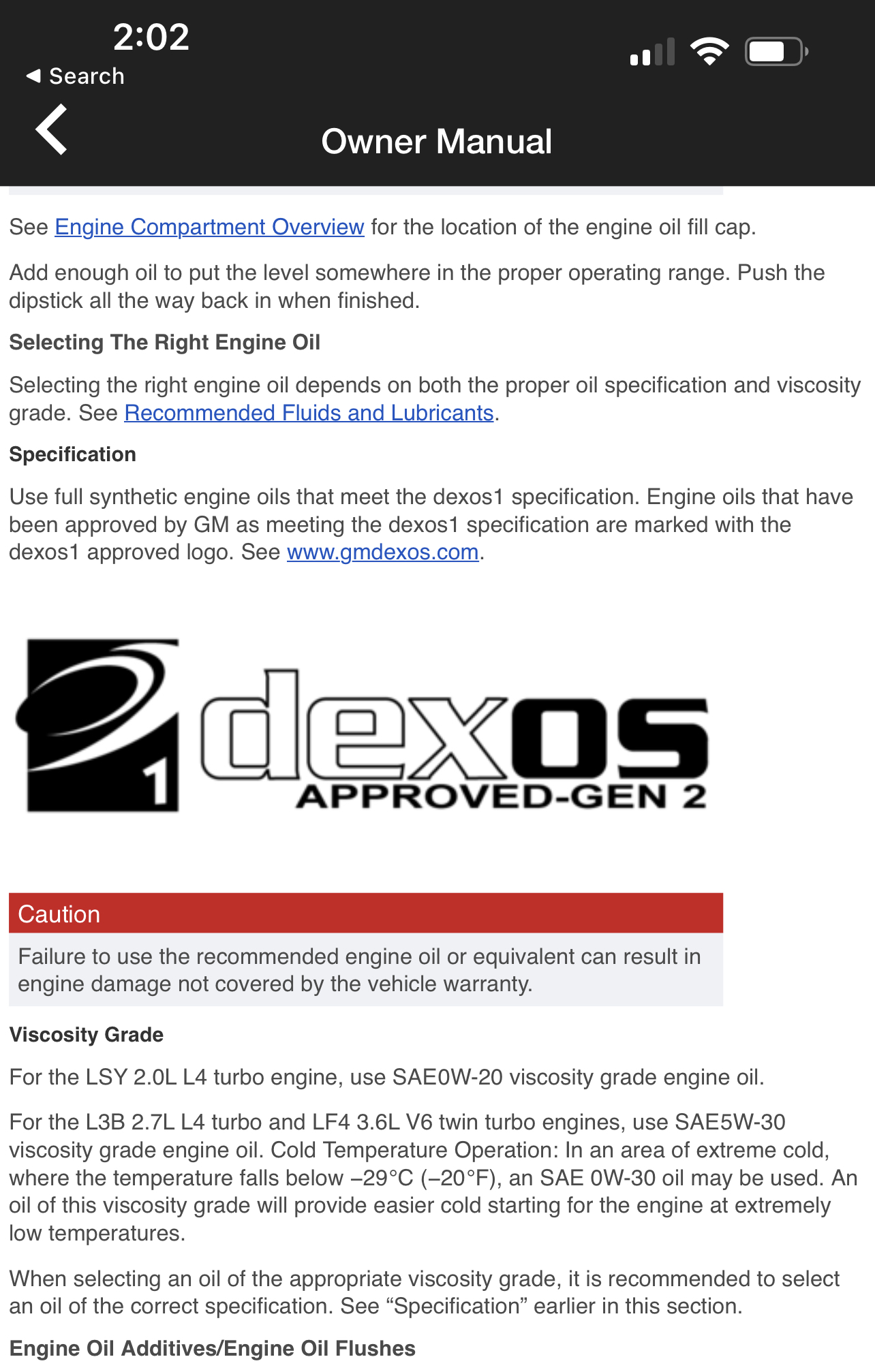

I’m seeing Dexos 1 Gen 2 or am I reading that incorrectly from the manual
It is confusing, but if you look further in the manual...
and Mobil 1 ESP is pretty much the only oil available in 0W-40 with Dexos2 approval.

Basically saying use dexos 1 gen2 oil unless noted otherwise, as is the special case for the LT4

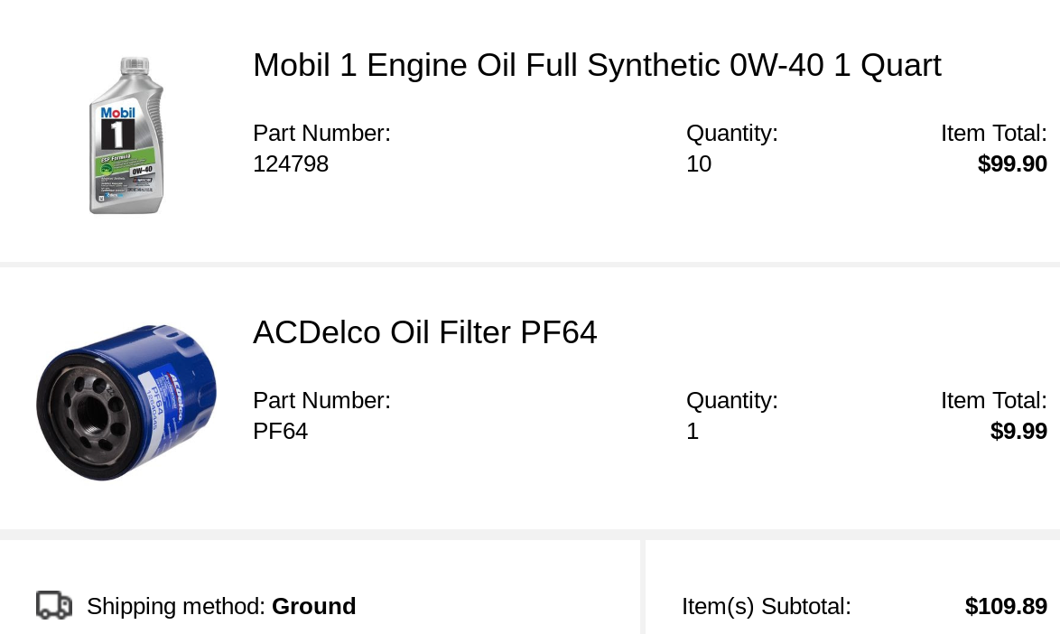

Still contemplating on how early to do the first oil change on the 5BW in order to remove the break in oil. I'll probably do 1000 miles, send it to Blackstone, then follow their guidance and the on-board oil computer (probably once per year, I'm guessing). Anyway, this stuff isn't cheap.

1,000 isn’t much. Remember first change is free at dealer

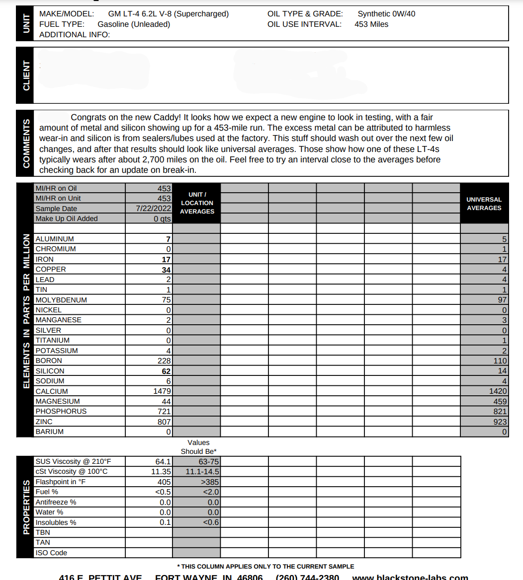

I sent my 500 mile oil change into Blackstone for analysis. This report looks like one shouldn't even worry about doing such an early oil change, but the large (1-2mm diameter) chunks of metal that were left in my oil catch pan say otherwise. I suppose those chunks would be blocked by the screen, but still happy to get them out.

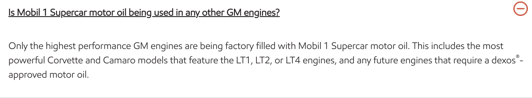

To make things even more confusing Mobile 1 ESP 0W-40 (Dexos2) is being rebranded to Mobile 1 Supercar 0W-40, with the DexosR. So, BW5 owners with the LT4 will probably hear more about this oil soon.
The BW4 cars can continue to use the much less expensive 5W-30 Dexos1 oil.

oooooh, Dexos "RRRRRRR"...because RRRRacecar. Should add at least 10hp once they get the labels changed...hope it's a red label for even more racecar.
