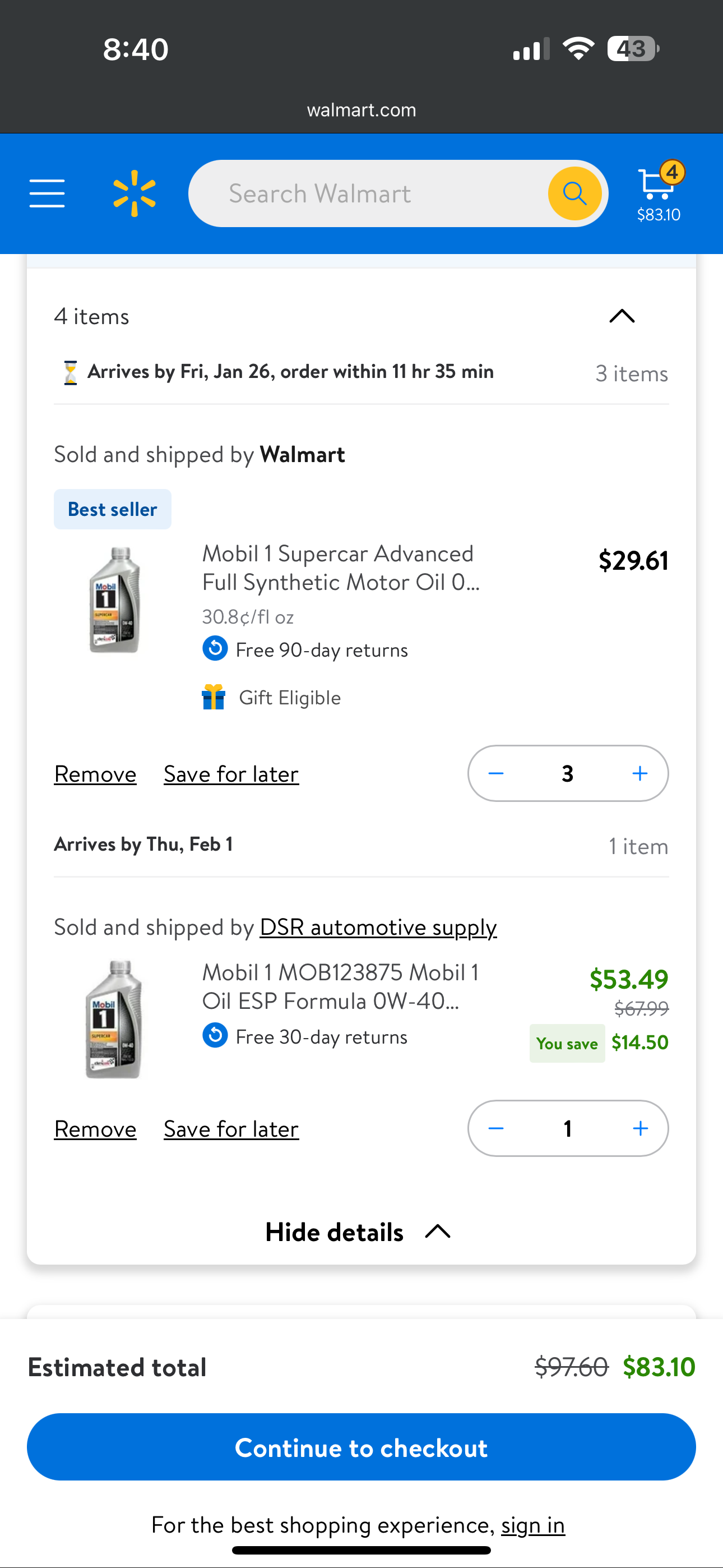

Walmart online has the best price on M1 supercar 0w40 at less than $10 a quart.
