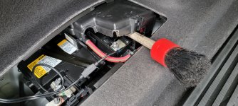

I used a wooden brush handle that I clean my wheels with, to wedge under the plastic cover that is over the positive connection. It gives you just enough room to use a small ratchet or open end wrench to remove the nut on the positive . It did take me about 40 minutes to get it done. The dealer tech is full of crap about half a day. With the correct tools , it can be done in under 2 hours even if you are a novice.
Are you saying the dealer said that your workaround at the battery would take half a day? Dealer guy is referring to the grey covering that is all over the trunk area. By no means am I being critical of you here, just wanting to make sure I understand all of your post.
While I'd still prefer to have easy access to the battery terminals themselves, right now my best option seems to use the connections under the hood. I used a Dremel and a file to shave down the plastic cover on the red/positive alligator clamp on my big Sears Craftsman charger (2, 15 and 45 amps) so that I can get a good connection.

I've resolved my battery charger issue. Don't have to and don't want to damage the area around the battery itself.
Used a Dremel and was able to carefully trim down the plastic covering the + alligator clamp. now it can securely attach to the positive terminal under the hood.

How did you make connections to the battery? There is a very large plastic cover on the positive terminal and no room to remove it. Thanks, Don
