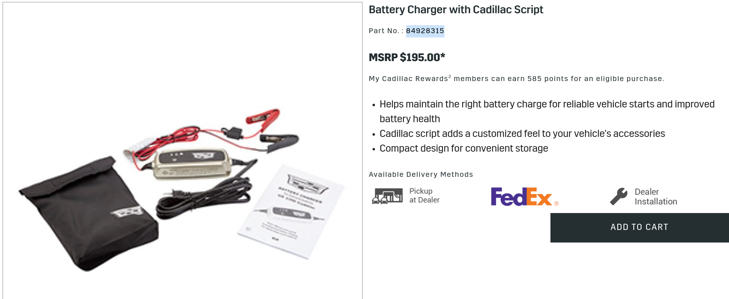

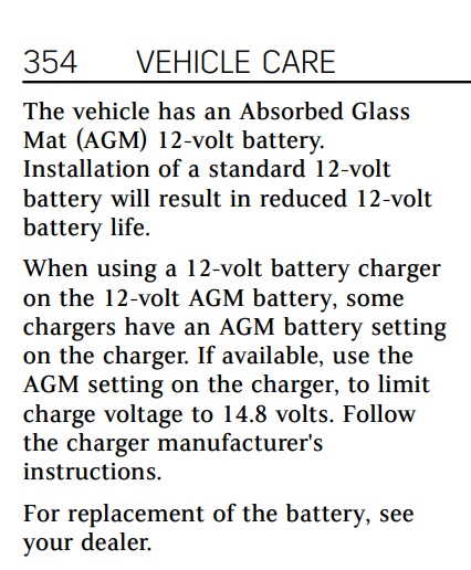

Does anyone know the type of battery in a CT5 Blackwing? Will the CTEK Lithium smart charger work?
It's an AGM battery. The CTEK will work. The "Cadillac" battery charger that you can get from the dealership is just a rebranded CTEK.

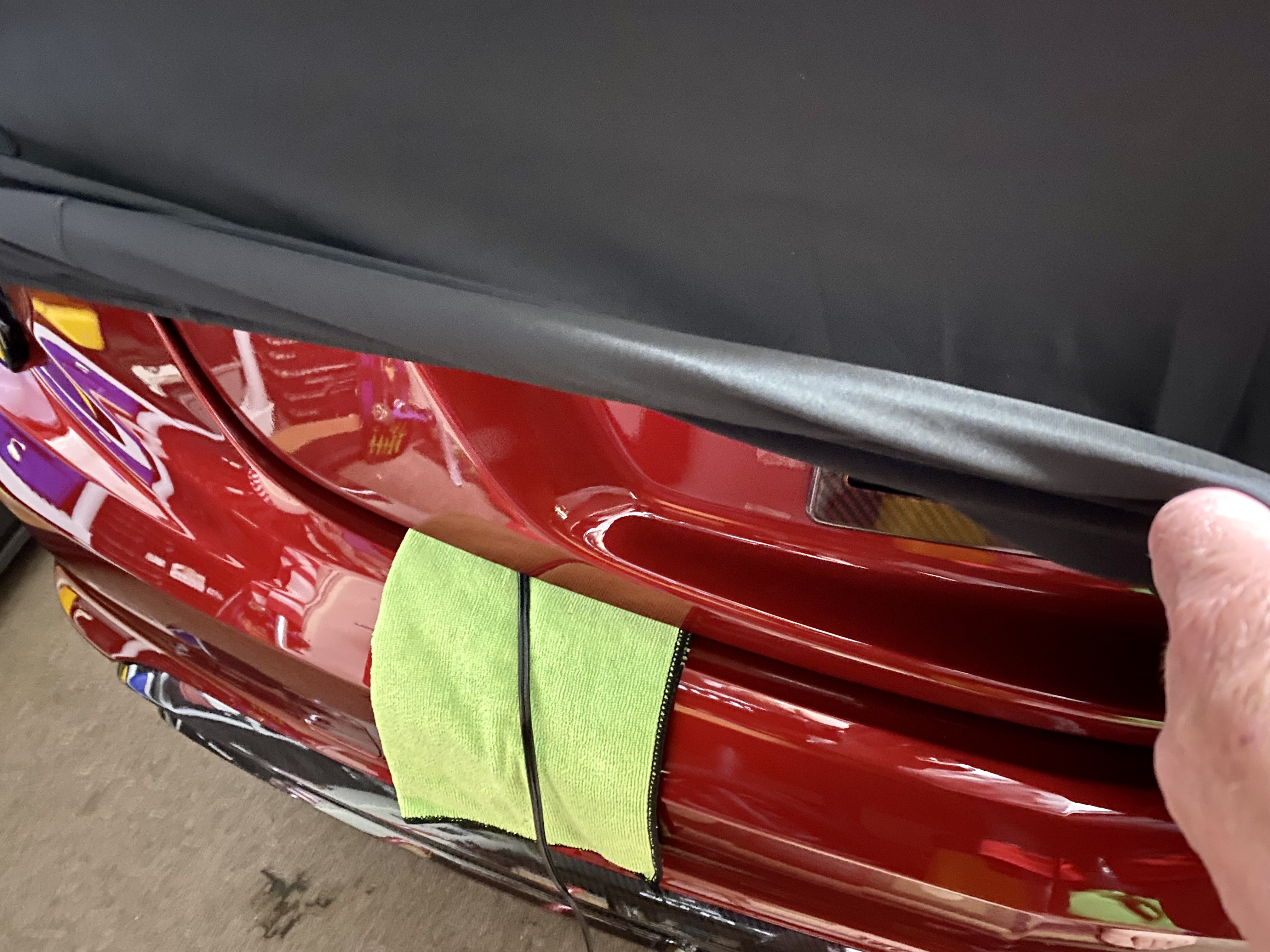

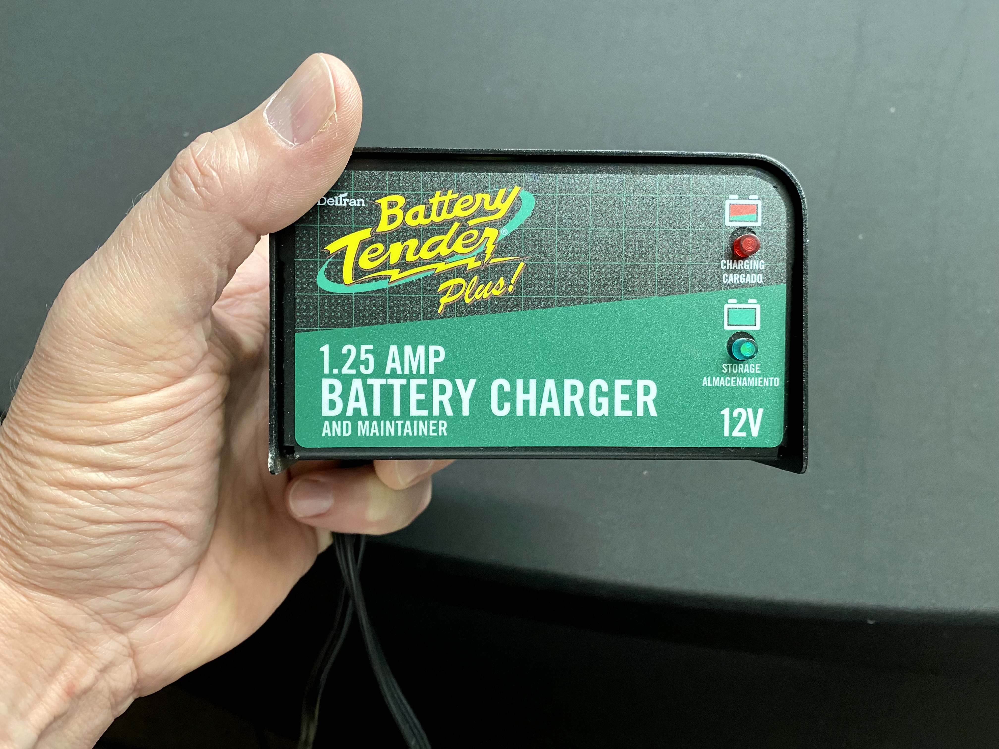

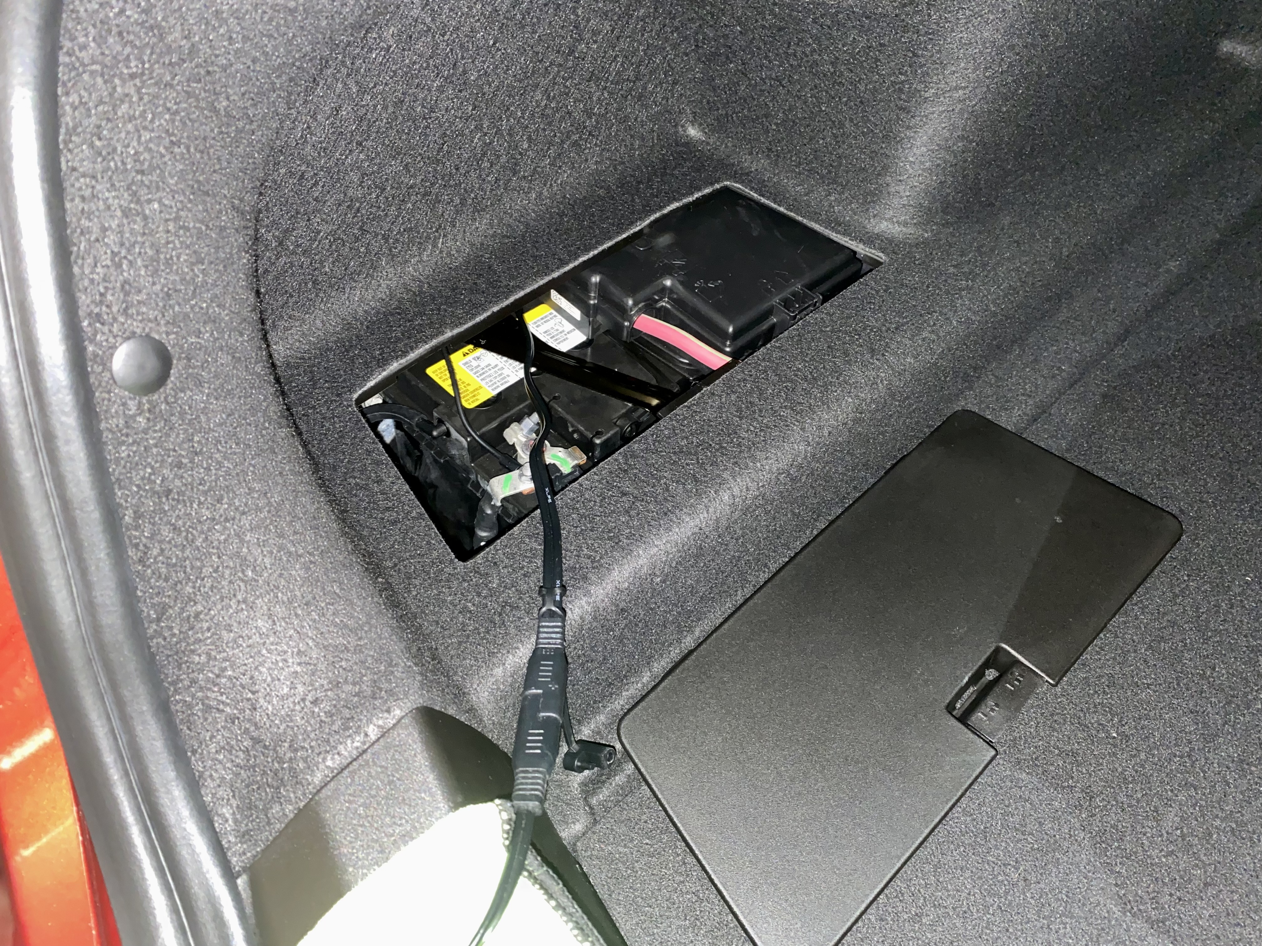

What I use and it worked great so far.

gave my Detailer my CTEK, hooked it all up but said it’s interesting trying to get to the positive side of the battery.
Has anyone ever hooked a charger to remote jump locations?
I just installed my Battery Tender maintainer today. I think mine is 4.25A or similar.
Once the black cover is removed fromt the positive side, difficult but possible, I just attached the eyelet ends right to the + and - terminal bolts. I didn't loosen or remove anything, just added new M6x1.0 nylon locknuts.

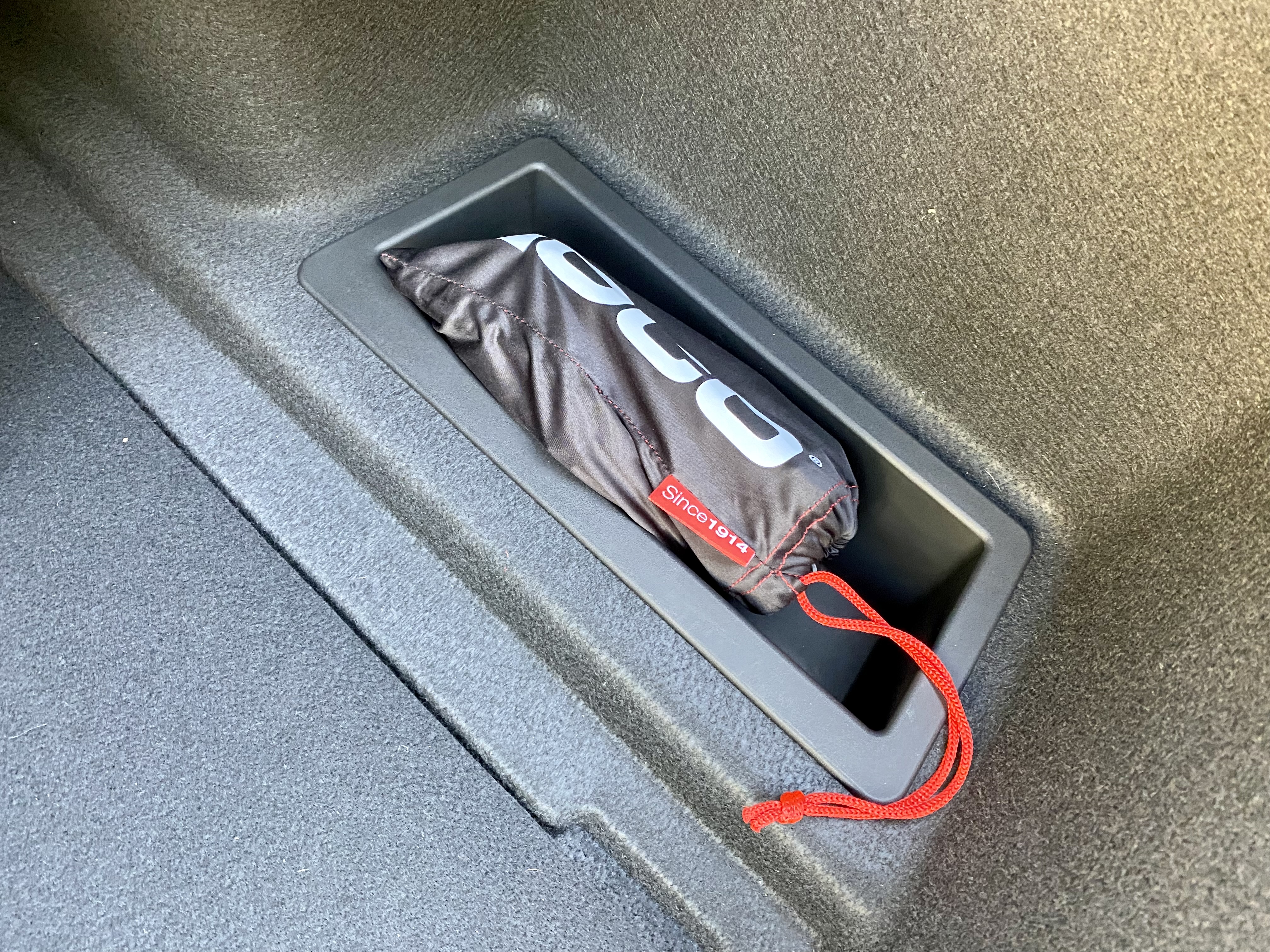

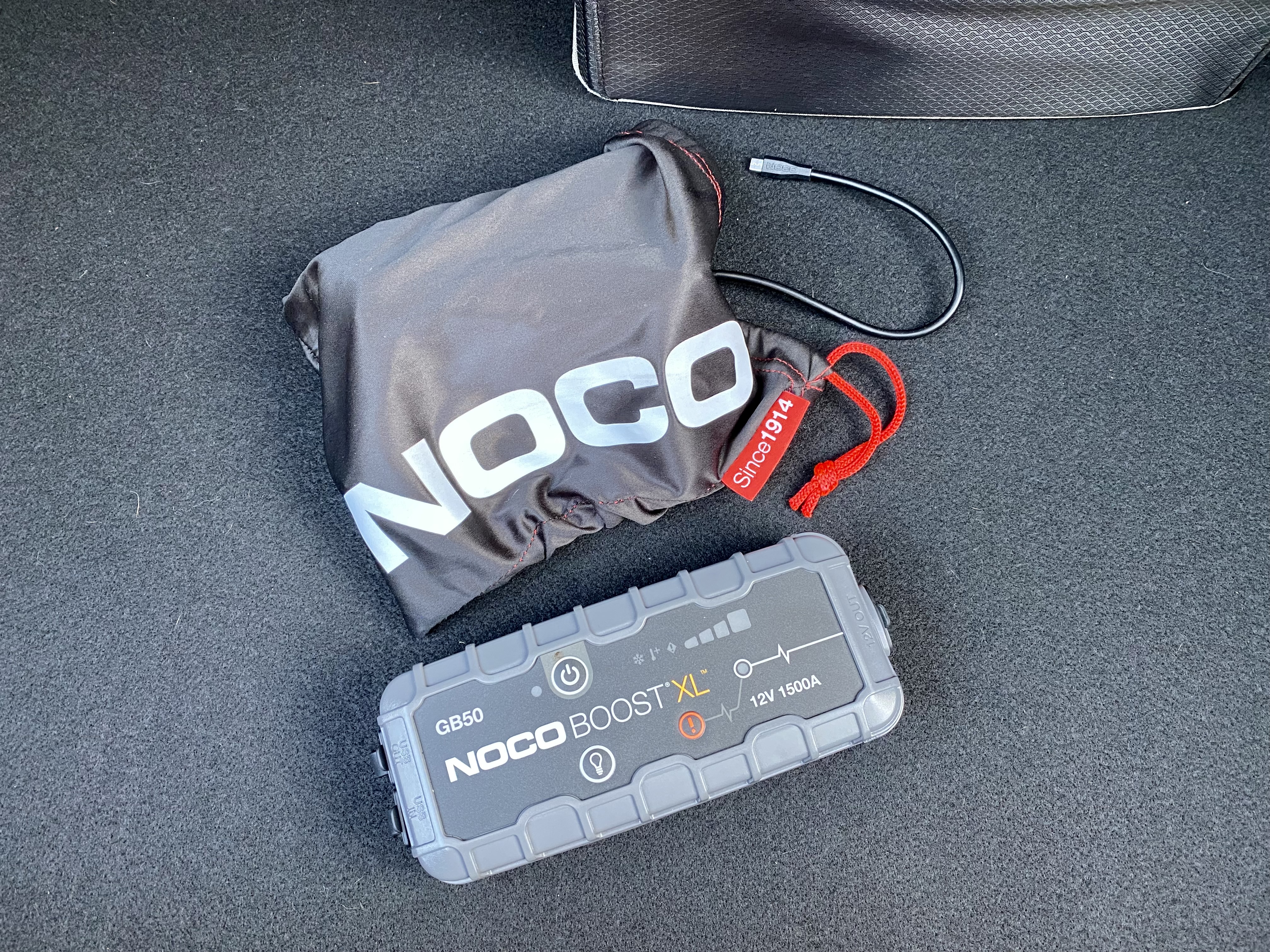

I keep this one in my trunk of the 4BW.. It has pulled me and a few others out of a jam a few times...

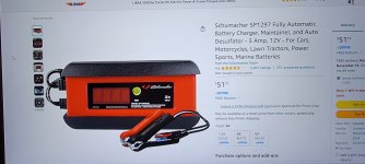

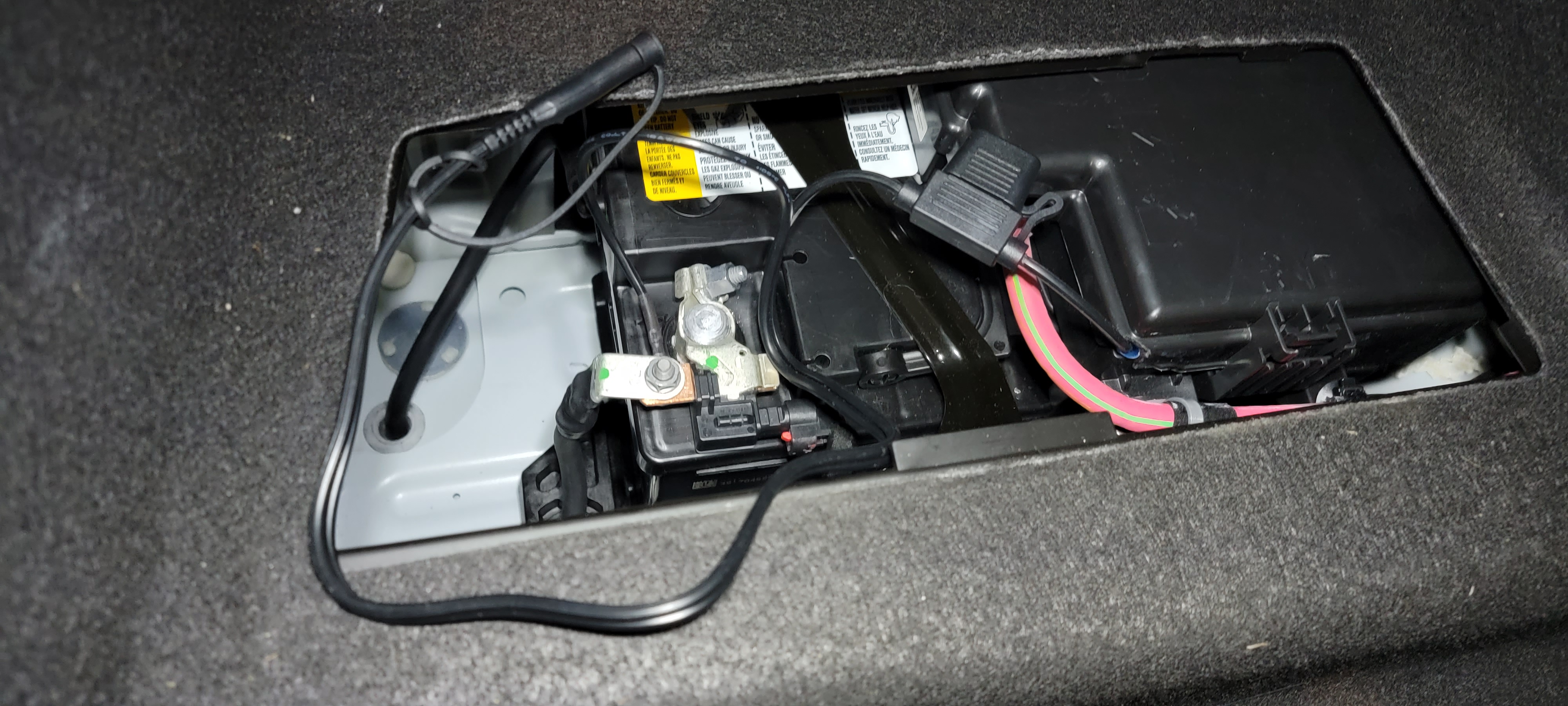

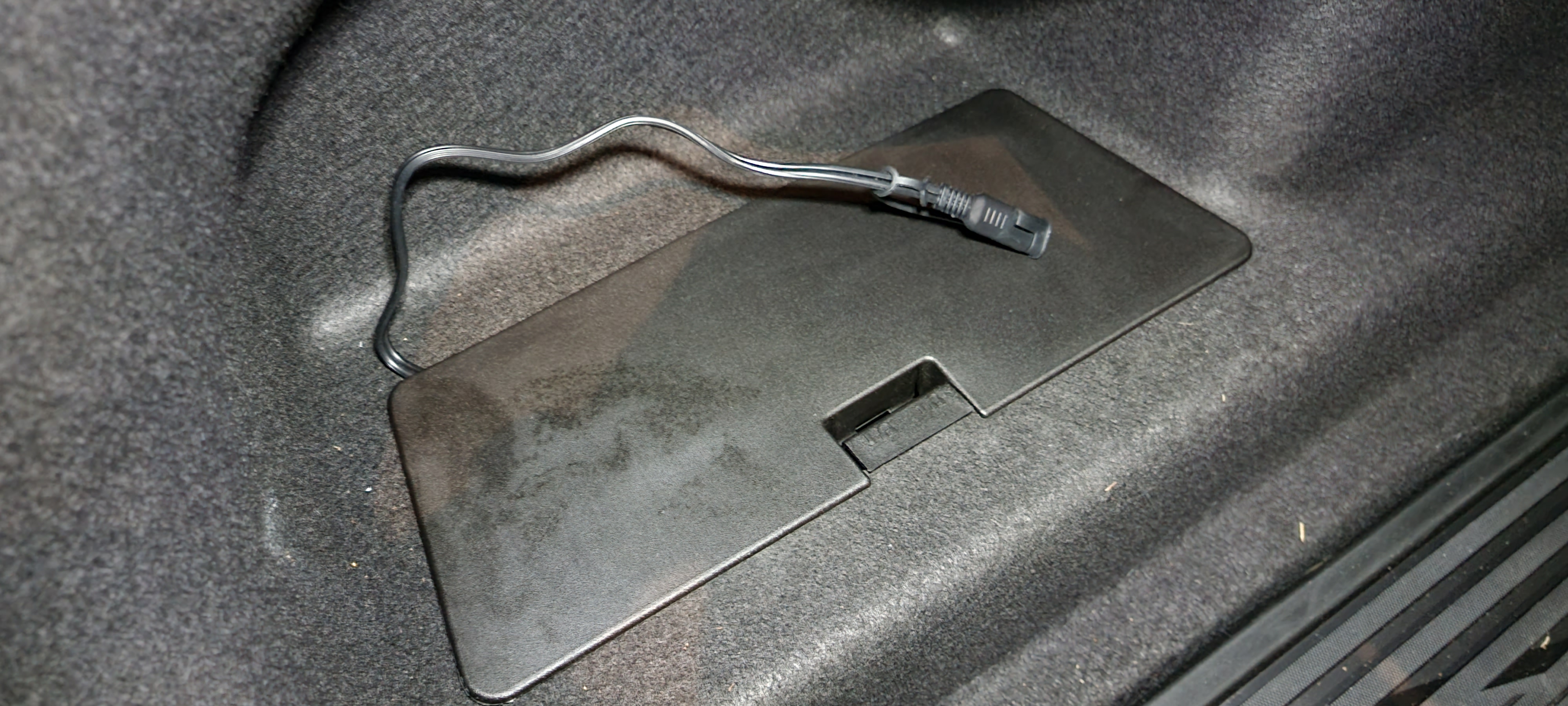

I have the Schumacher tender/charger for my rides. I like that it has a digital display as soon as you connect pos/neg leads and it tells you how much percent charge your battery is at. It comes with cigarette lighter, pigtail and alligator clips for attachment. Yesterday , I attached the pigtail to by trunk battery terminals for easy access, when I put my rides away for the winter.

The battery is covered and has a big plastic cover over the positive terminal. How did you connect?
Talked to the dealer's tech guy, said to take all the "dressing" in the trunk off is about a half day to remove and reinstall.
How did you make connections to the battery? There is a very large plastic cover on the positive terminal and no room to remove it. Thanks, Don
I mangled the trunk liner a bit to remove the plastic top and install the eyelet ones. But it’s really tight. I got a 2nd BW and I think I’m just going to do the clamps in the hood instead.

I used a wooden brush handle that I clean my wheels with, to wedge under the plastic cover that is over the positive connection. It gives you just enough room to use a small ratchet or open end wrench to remove the nut on the positive . It did take me about 40 minutes to get it done. The dealer tech is full of crap about half a day. With the correct tools , it can be done in under 2 hours even if you are a novice.
