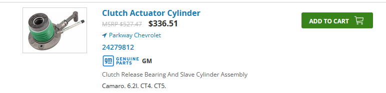

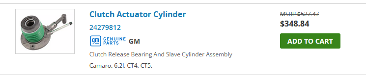

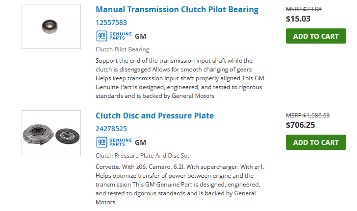

The front subframe has to be dropped/lowered 5" to reach the top bellhousing bolts. The steering linkage also gets disconnected. And there are lots and lots of cooler lines. And the exhaust usually comes out (although I dont believe it is listed in the service manual, but it makes it easier).
Parts list below ($1100 online for everything)

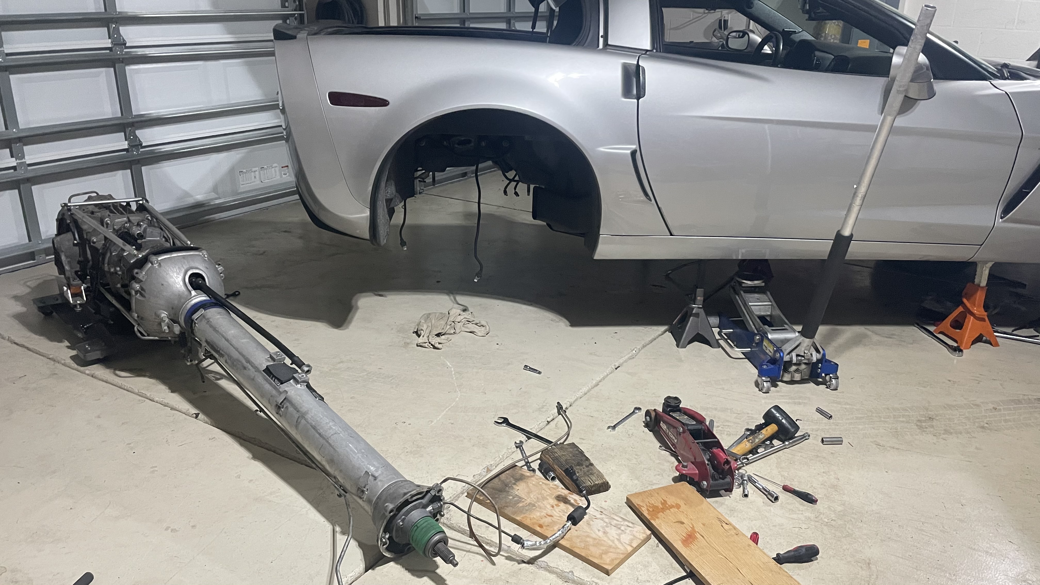

Figured if you take the clutch to get replaced by anybody but the dealer, you’d be in for $1K in labor. Cant be worst than doing a clutch in a corvette. 😅
