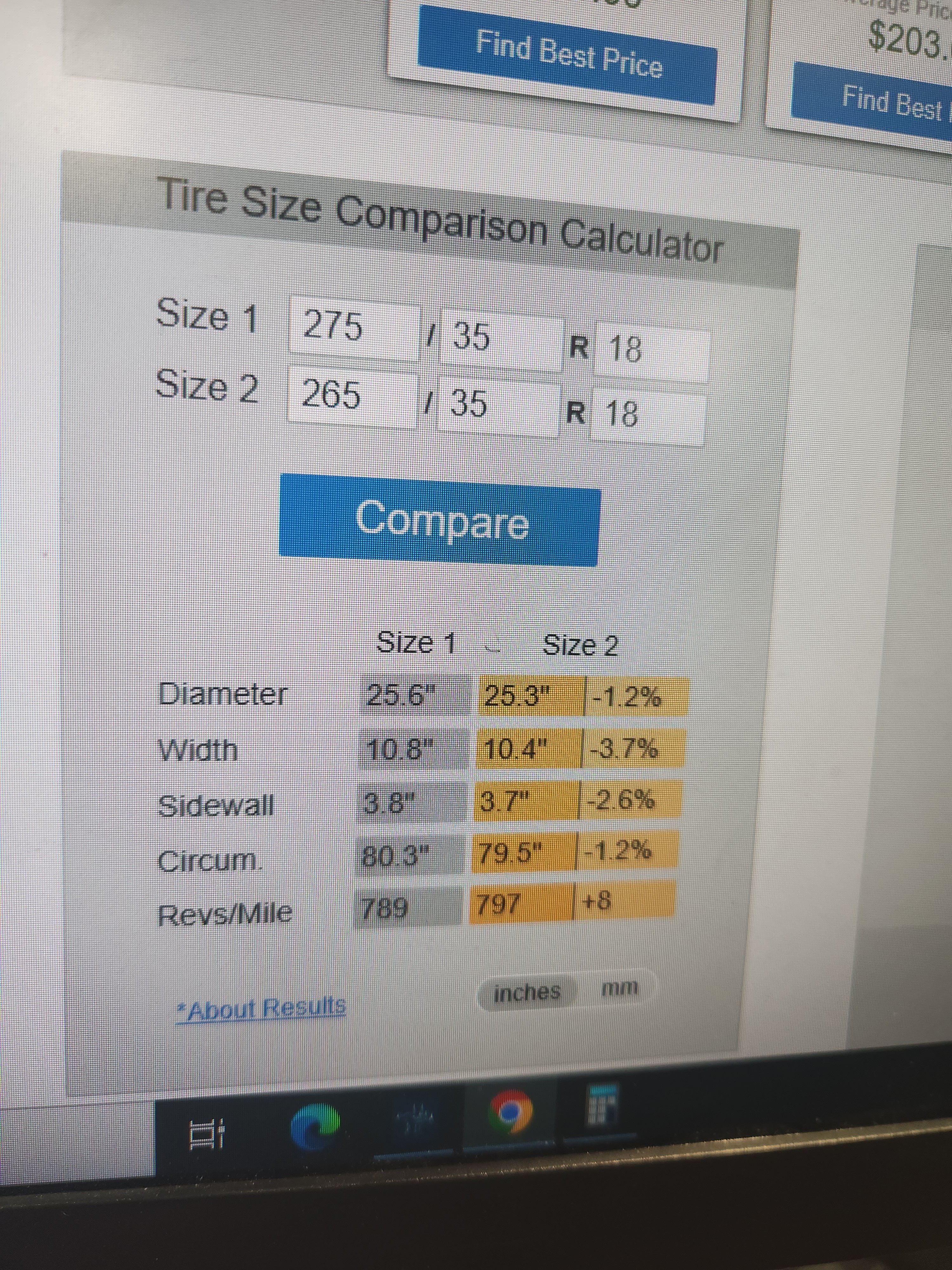

Based on this article from Car & Driver here: Our 2022 Cadillac CT4-V Blackwing Brought Smiles for 40,000 Miles they mentioned they reached out to GM directly for winter tire recommendations:
"We asked Cadillac's engineering team what they run, and they pointed us to a 265/35R-18 rear size. There are two such tires available, a Michelin Pilot Alpin PA4 and a Pirelli Sottozero Serie II, and both were hopelessly backordered. After much searching, handwringing, and considering sending our CT4 to the West Coast to ride out the winter months, we happened upon a set of discontinued Nokian Hakkapeliitta R3 winter tires on eBay in the correct sizes."
@Mirza Grebovic's also gives some suggestions in this thread and I treat his word as gospel - for those of you who don't know he was the Group Engineer Manager for both Blackwings at GM.
You cant run a 255 on the rear wheel, it will stretch tire too much and decrease your OD. Just buy as close to stock no need to overthink this, your talking almost no difference in cost.
Tire Selection
So based on @Mirza Grebovic's widsom I decided to go with a staggered setup and go close to OEM:
  • Front: 255/35R18 (same as stock) on a 18x9 wheel
  • Rear: 265/35R18 (a little narrower than stock but as mentioned in the article above from Car and Driver) on a 18x9.5 wheel
