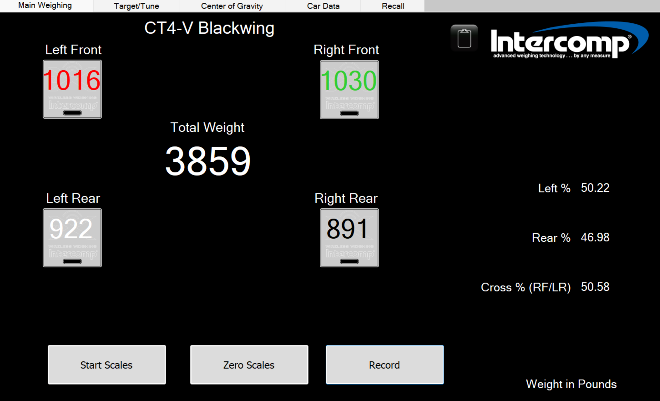

I didn't know this until yesterday, but the CT4-V (non-blacking) weights only 3600 lbs. Do the extra 2 cylinders really weigh 200 lbs? It must be the extra turbo
The brakes are substantially heavier than the non-BW car. The bigger wheel/tire package probably doesn't help either.
Also don't forget the added cooling capacity (extra radiators) for the BW too. Oh and the eLSD. And beefier transmission.
Honestly, I'm kinda surprised it *only* weighs 200lb more.

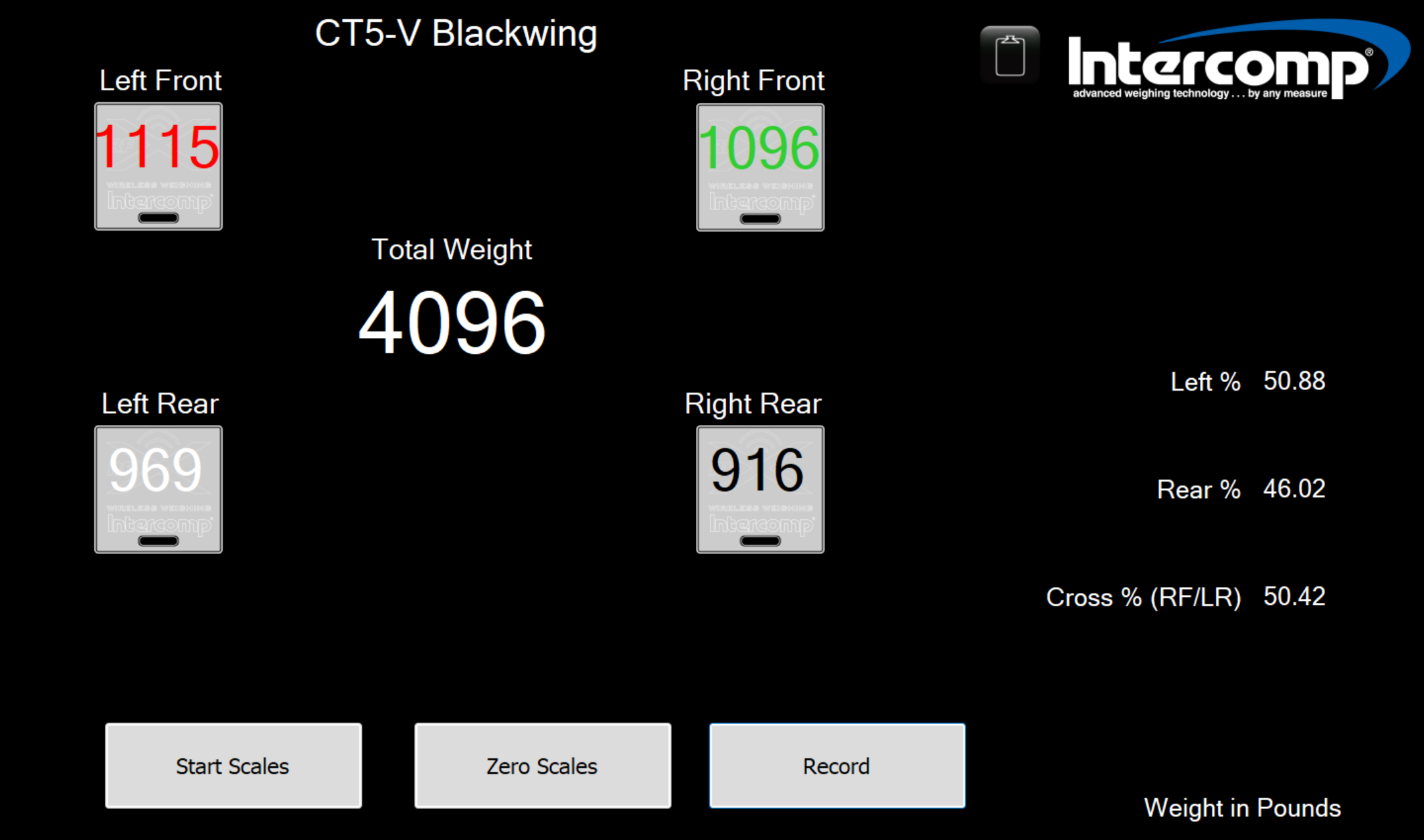

Stock 4BW manual with CF1, full fuel.
I've been looking at ordering a CT5-V BW and wanted to know what the car would actually weigh depending on how I optioned it. If others chime in with their weight and options we can get more datapoints.
CT5-V Blackwing Weight Comparison
SourceTransmissionBrakesWheelsSunroofSeats
Weight
Motortrend6-Speed ManualCarbon CeramicStandard (Q61)NoOptional HiPo Buckets
4,067*​
Car and Driver6-Speed ManualCarbon CeramicStandard (Q61)NoOptional HiPo Buckets
4,092​
poor-sha6-Speed ManualCarbon CeramicStandard (Q61)NoOptional HiPo Buckets
4,096​
Cadillac6-Speed ManualSteelStandard (Q61)NoStandard
4,123​
Cadillac10-Speed AutoSteelStandard (Q61)NoStandard
4,142​
Car and Driver6-Speed ManualSteelStandard (Q61)YesOptional HiPo Buckets
4,207​
Motortrend10-Speed AutoSteelMesh (RHL)YesOptional HiPo Buckets
4,253​
Slick Blackwing10-Speed AutoSteelStandard (Q61)YesOptional HiPo Buckets
4,260​
* Despite having the same options (even the same paint!) as Car & Driver, Motortrend found their car was 25lb lighter. Data from poor-sha matches Car & Driver's weight. This indicates Motortrend most likely made a mistake.
** According to Car & Driver: "optional discs shed a claimed 62 pounds of rotating mass and 53 pounds of unsprung weight." I believe this means the rotors are 62lbs lighter, but carbon ceramic calipers must be 9lbs heavier.
Notes
  • Manual Transmisison saves 19lbs (high certainty)
  • Carbon Ceramic brakes save 53lbs (high certainty)
  • Optional Mesh (RHL) wheels add 27lbs (low certainty)
  • Sunroof adds 62lbs (low certainty)
  • Carbon Optional hiPo buckets save 22lbs (low certainty)
  • Not able to determine the effect of car color (Metalic or multi-stage paints can add a measurable weight penalty)
  • Not able to determine the weight of electronics options like the rear camera or supercruise (probably not significant)
