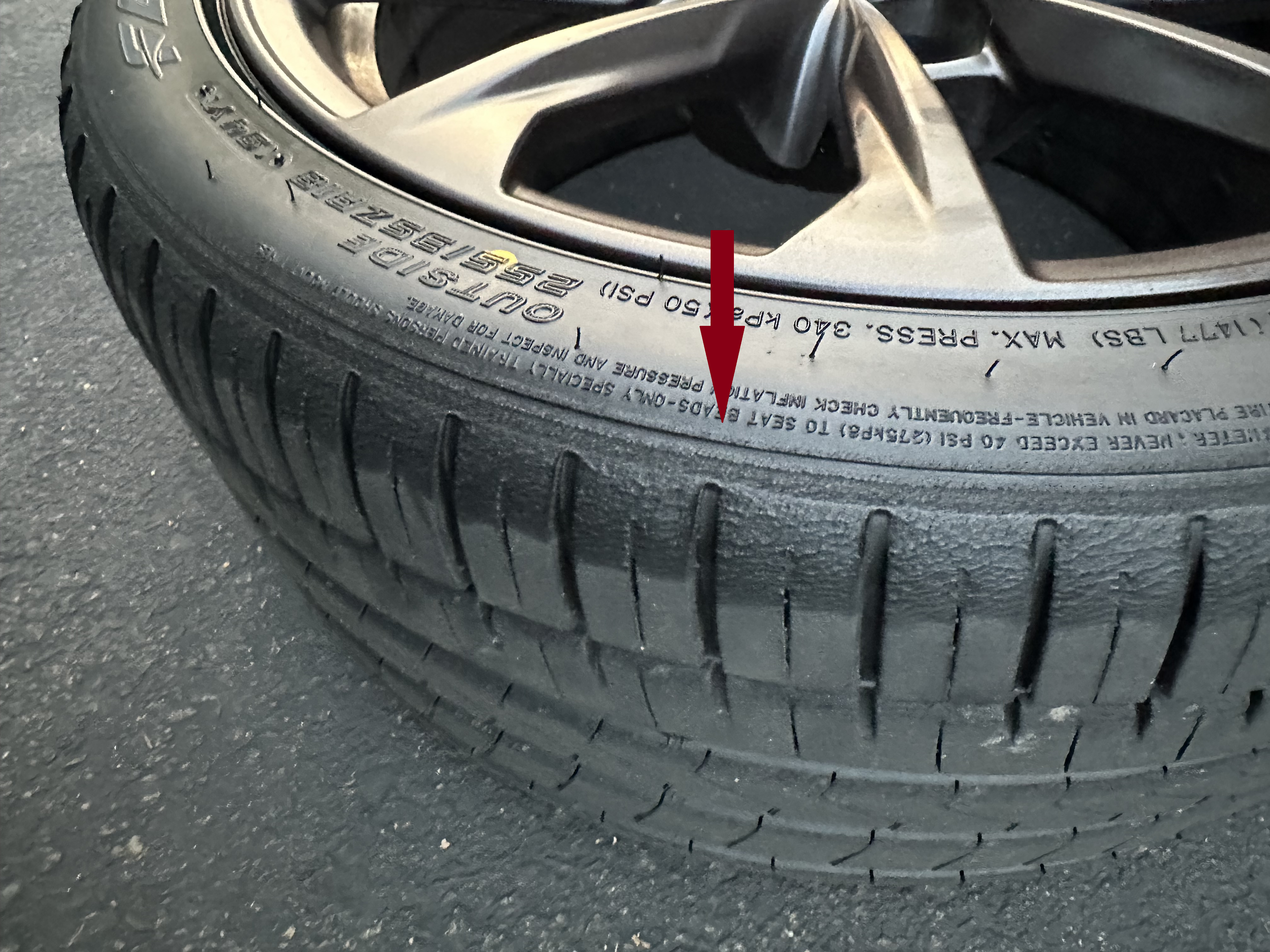

Below is a picture of the second set of fronts. Notice the 1 inch on shoulder wear. They had about 2 track days on them when this picture was taken. The Falken Zenis FK510 lasted 5 or 6 track days. But they were not as good as the Michelins for grip. So I went back to Michelins for my fourth set.
I then received information from the Texas V-Club and it was confirmed by Michelin, that if you track your car and run at high speeds, you need to INCREASE the PSI to run near the max pressure when tires are hot.
Proof of concept (POC) - For the last two track sessions, I have started with cold pressures of 42 on all four. I then monitored the PSI during my multiple runs. I hit 48 and 49 Hot tire pressures consistently. I will let out 1 PSI to stay at 48 max for the next session. I will probably start at 41 going forward. The result is a much better shoulder tire wear result. Running in this config for 2 track days I have not had my wear on the shoulders of the tires.

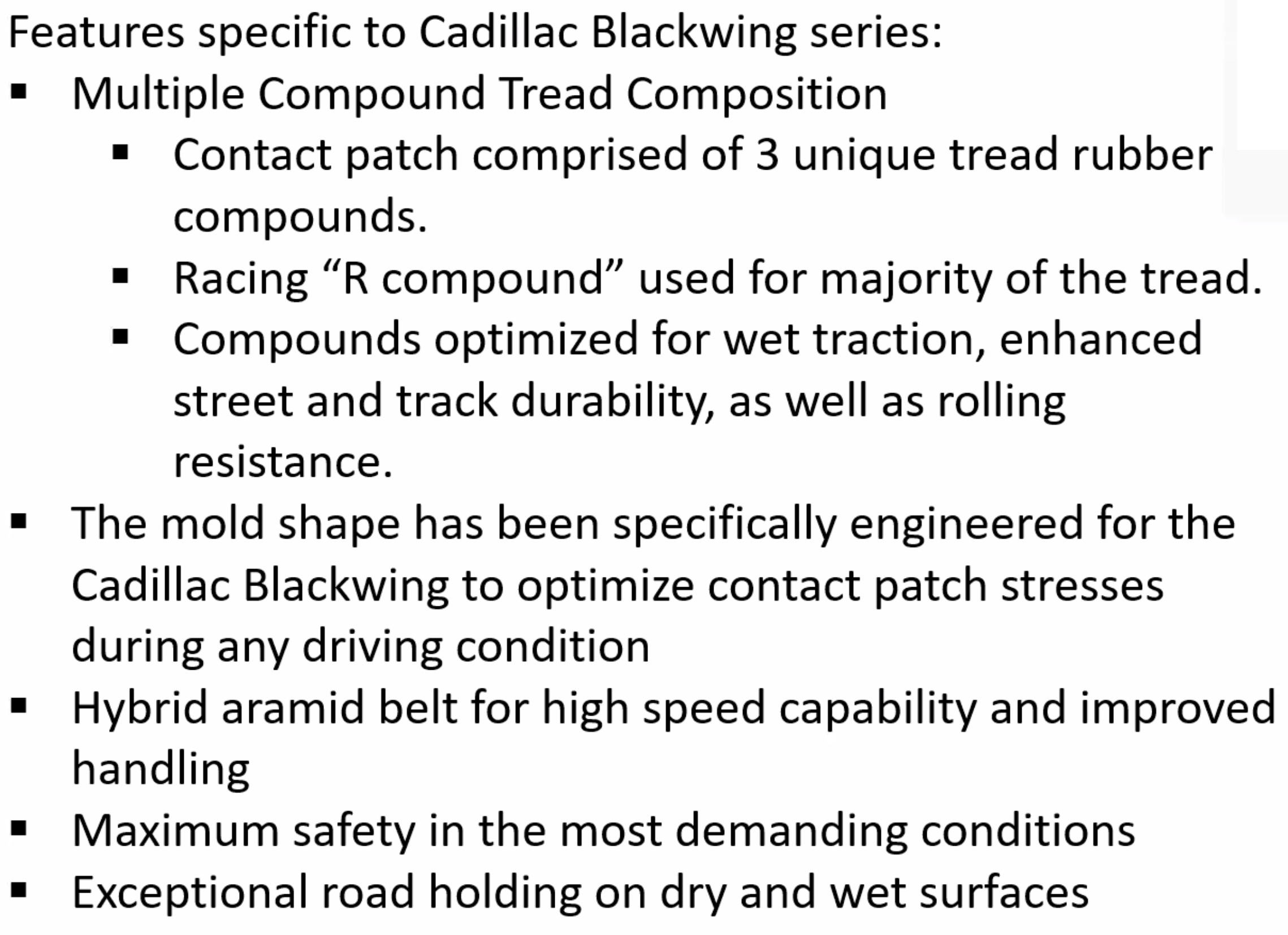

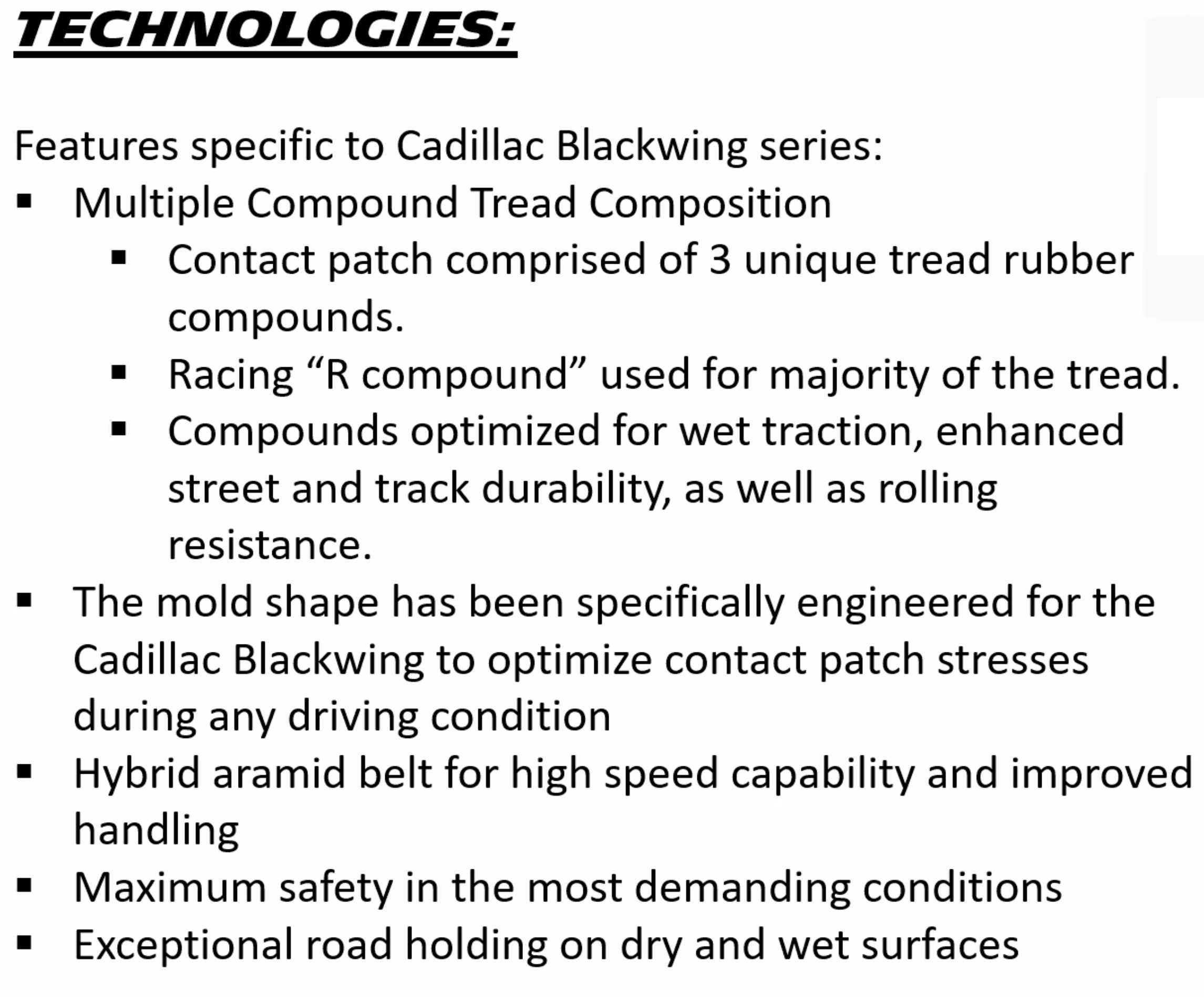

FYI (part1) - regarding the difference between the TPC versus regular Michelin PS 4S:
TPC spec tires-

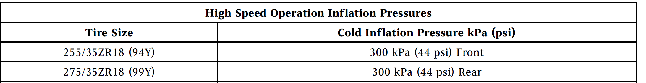

FYI (Part 2) - Per the CT4V-BW Owners Manual:
" Tire Inflation Pressure for Track Driving
For driving on a race course, if your vehicle is equipped with 255/35ZR18 (94Y) and 275/35ZR18 (99Y) tires, set
cold (stationary) tire pressures to 30 psi. During track sessions, set the pressures at 35 to 38 psi for hot tire
pressures. If pressures exceed 38 psi, bleed pressures down to 35 to 38 psi. Return the tires to the recommended
cold tire inflation pressure when track driving has ended."
"Warning: Track/course loads wear tires both on the tread and internal to the tire. When driven in track/course
conditions, even if tread is not worn down to the treadwear indicator, tires must be replaced after the equivalent of two tanks of fuel or approximately 160 km (100 mi)."
Based on the guidance in the Owners Manual, you need to replace all four tires about every track day!
FYI(Part 3) - Page 372 gives conflicting info on "track event" tire pressure guidance.
Analysis: Based on information from the Michelin V-CLUB teleconference - "If you are wearing the shoulder of the tire, they are under inflated", and my POC results; I will set the tires pressures for Road Course HPDE events at 41 to 42 PSI and monitor the pressures during track day sessions to ensure that I do not exceed 48 PSI. Max rated PSI is 50.
Also, I would never run @ a event with tires that were cording. The most I would tolerate is about 25% chunking of the outer thread block before I would replace the tires. I will routinely hit 120 to 130 at my "home track". You are seriously risking your safety and those of the other participants if you are on track with known faulty tires.
This picture below shows what was happening to my tires, but I replaced them way before the tires got to this stage, 100% chunking of the outer tread block. If you compare my wear pattern from the top picture, it included wear on the shoulder/sidewall of the tire. These BMW M4 tires are losing half the outer tread block, but there is no wear on the shoulder/sidewall of the tire.
TPC spec tires-

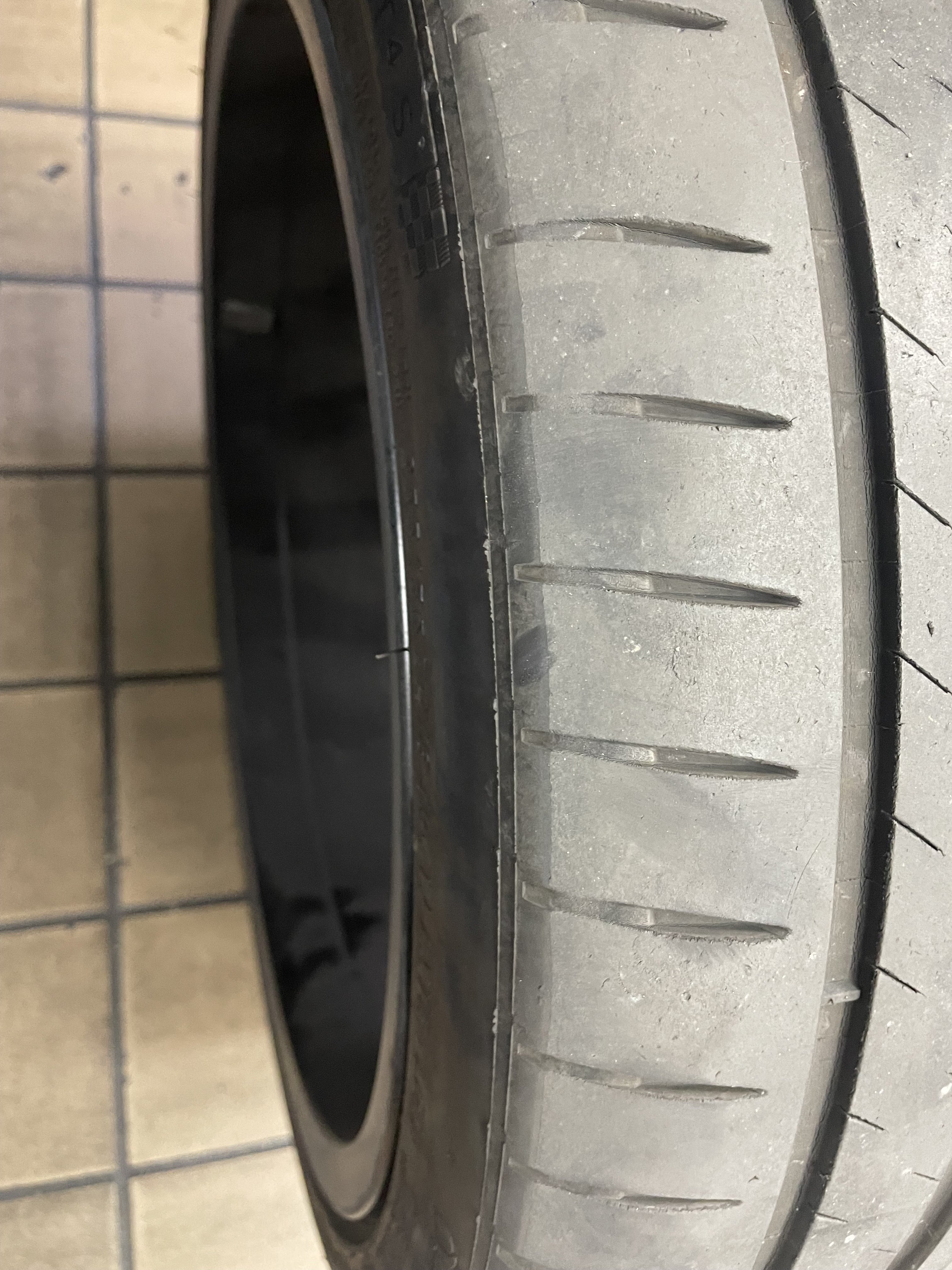

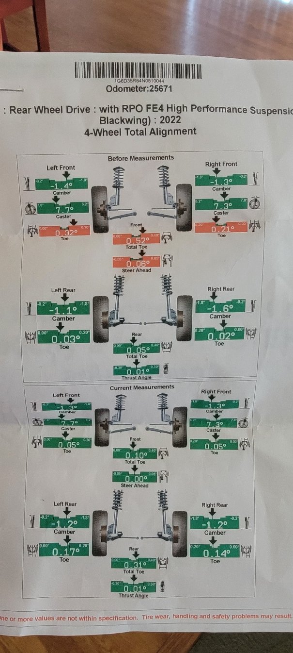

I need to download some pics to add to this thread because I had a flat last week and my tire wear shocked me... I purchased 4 new tires and had an alignment..Stand by for pics..
What kind of mileage did you get? What did you replace them with (TPC spec or regular aftermarket)?
Huh...come to think of it, I wonder if I ever had an alignment before my tires shredded like that?? I had similar toe issues on my 5BW. We might need to get these things aligned as soon as they come off the transporter. Will be interesting to see if my newer set of tires after alignment have the same problem.
I had the exact same separation on my 5BW and similar toe challenges - makes me think the car may have been misaligned coming off the truck:
I replaced mine with non TPC spec, just regular aftermarket PS4S's. I cant say if it was due to the OEM tires being warn our not, but the new tires are super quiet, much quieter than I recall the OEM tires being even when new, also turn in is way faster. Could just be because they are new vs old and warn, but I don't recall the OEM tires being either as sharp or quiet. They feel great.
