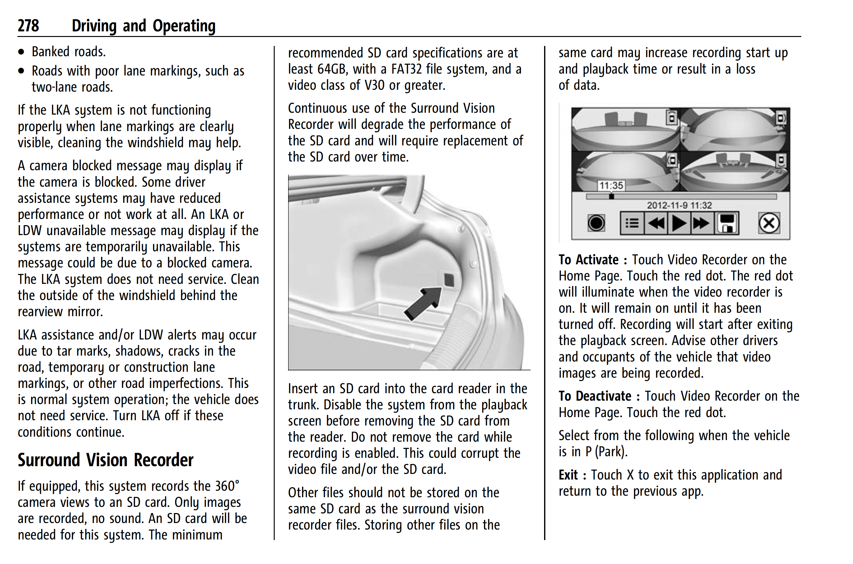

On the 23 5VBW, it recommends a 64GB V30 FAT32 for the Surround Vision Recorder
I’ve tried 128GB on my 22 5BW and it records and plays back fine in the car. However, some video files are unreadable on a Mac or a PC. I switched to 32GB to see if that still happens, will need to check it in the next couple days. The thing is that FAT32 only works up to 32GB so the recorder must be doing something funny with the file system. I don’t have this problem with other dash cams with 128GB cards. But those dash cams also format the card. It’s kind of stupid that the Cadillac recorder won’t format a card.
I run a 256GB Sandisk U3 and it worked great on my C8 and was easy to playback on my Mac. I took that card out of my C8 and put it in my 5VBW but haven't bothered to try and play any videos back yet. Might check it this weekend and see.
I tried the Samsung Pro Endurance 256GB. It worked fine out of the box (ExFAT format) in the PDR, but not in the SVR. I reformatted it to FAT32 multiple times, but could not get it to work in the SVR. So I tried the 128GB version of the same card. After reformatting it to FAT32, it works fine in the SVR.
