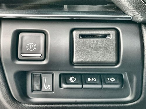

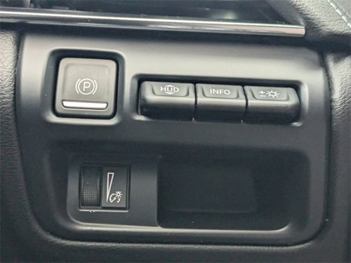

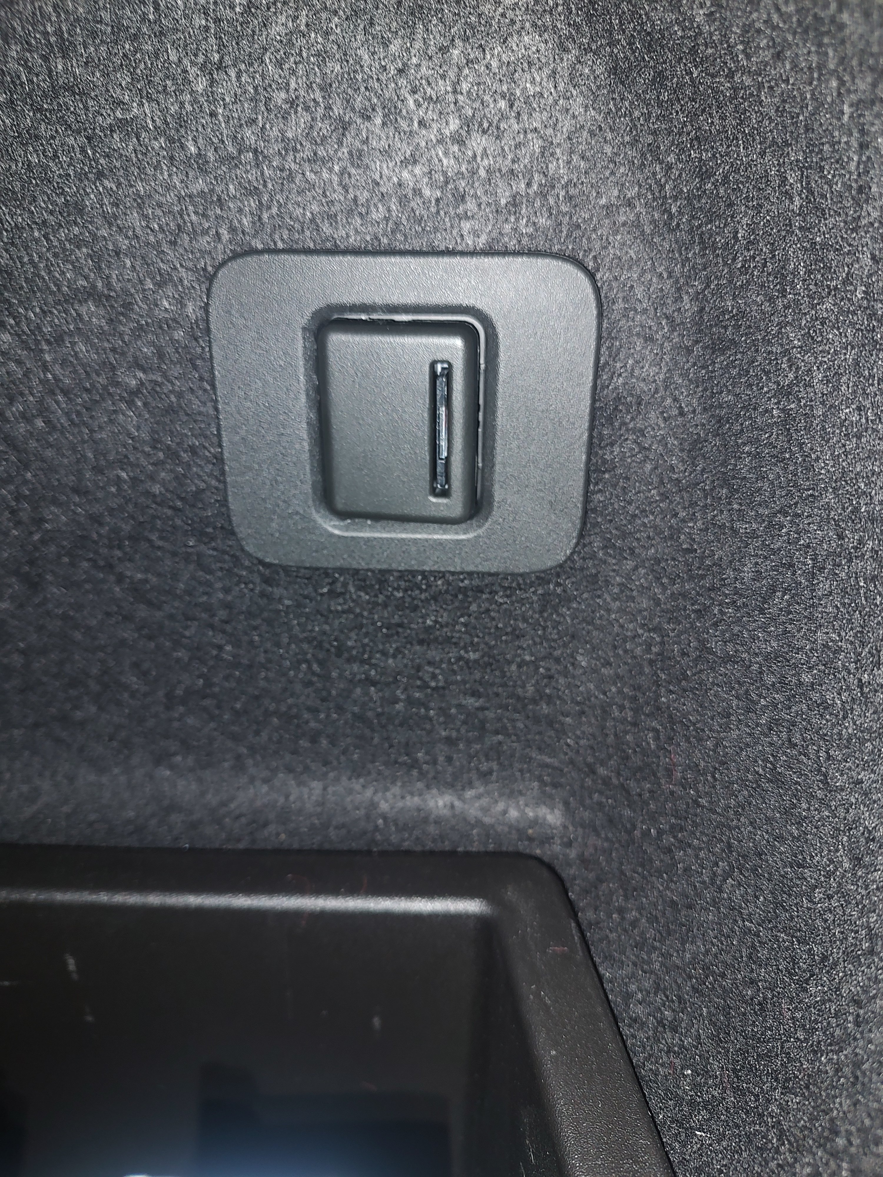

it can only record while driving if you have the performance data recorder option. If you don't track the car, it's good to have as it can monitor and record your drives (SD card slot near the parking brake). If you don't have it, the 360 camera records when someone approaches the car (the trunk SD slot).
I have a 25 5V BW and no trunk slot (and no PDR) unless I’m looking in the wrong places.
With PDR:
Without PDR:
Surround vision: Open trunk, look at the right side by the fender, just ahead of the taillight, above the storage bin:
Thanks for the info. Unless they moved it, which I doubt, it’s another thing deleted from the 25s. Will check the OM to be sure, already read that section though and there wasn’t a lot of info on it.

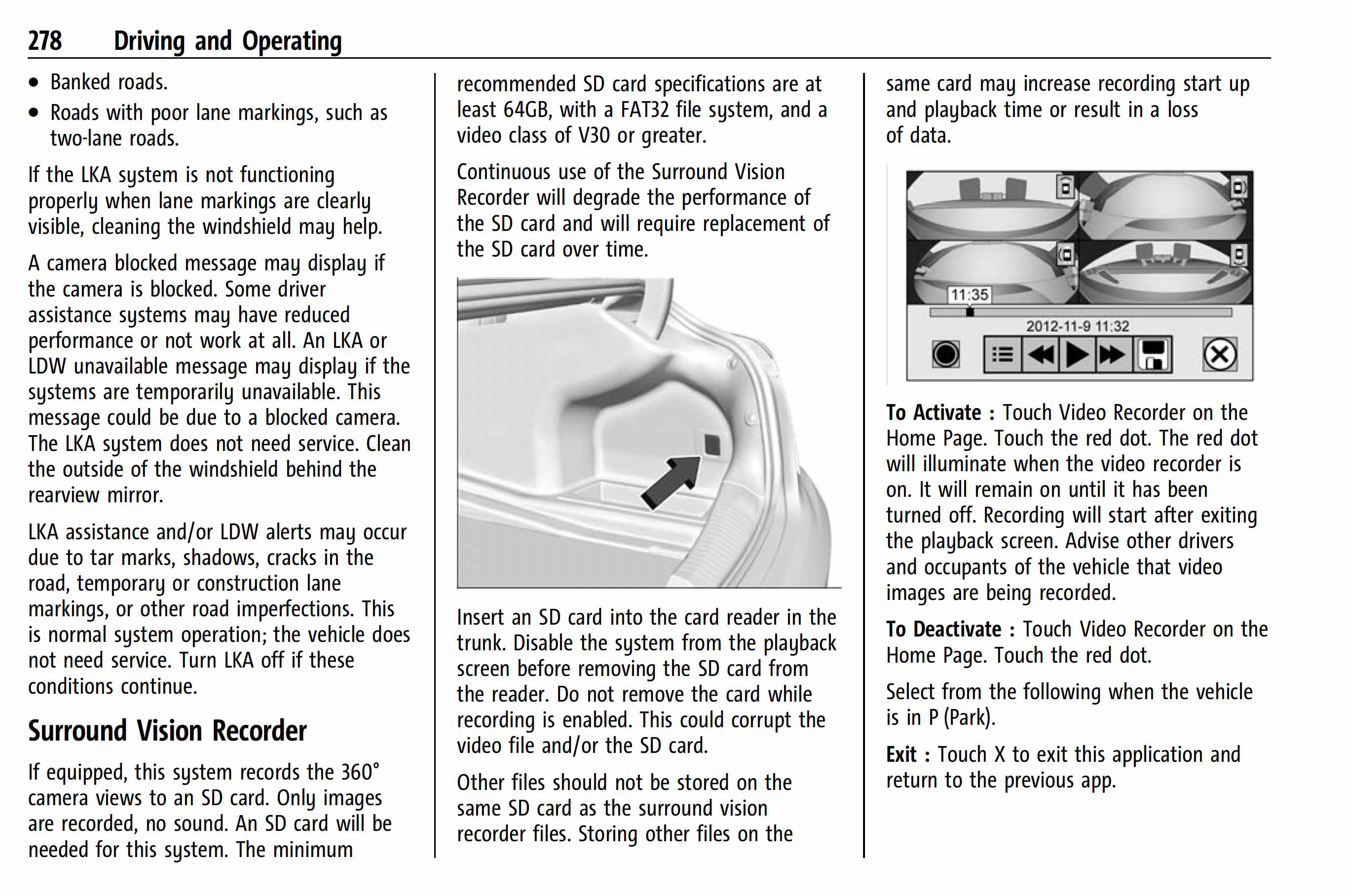

Cadillacs website does state "HD surround vision" is still standard. I'd look in the manual to see if they did move the SD slot. The location in the trunk was kinda strange to begin with.

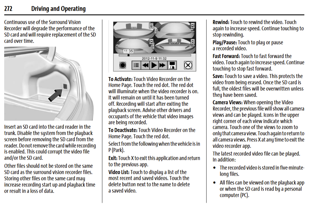

The '25 Owners Manual has the SD Card slot in the same location.
