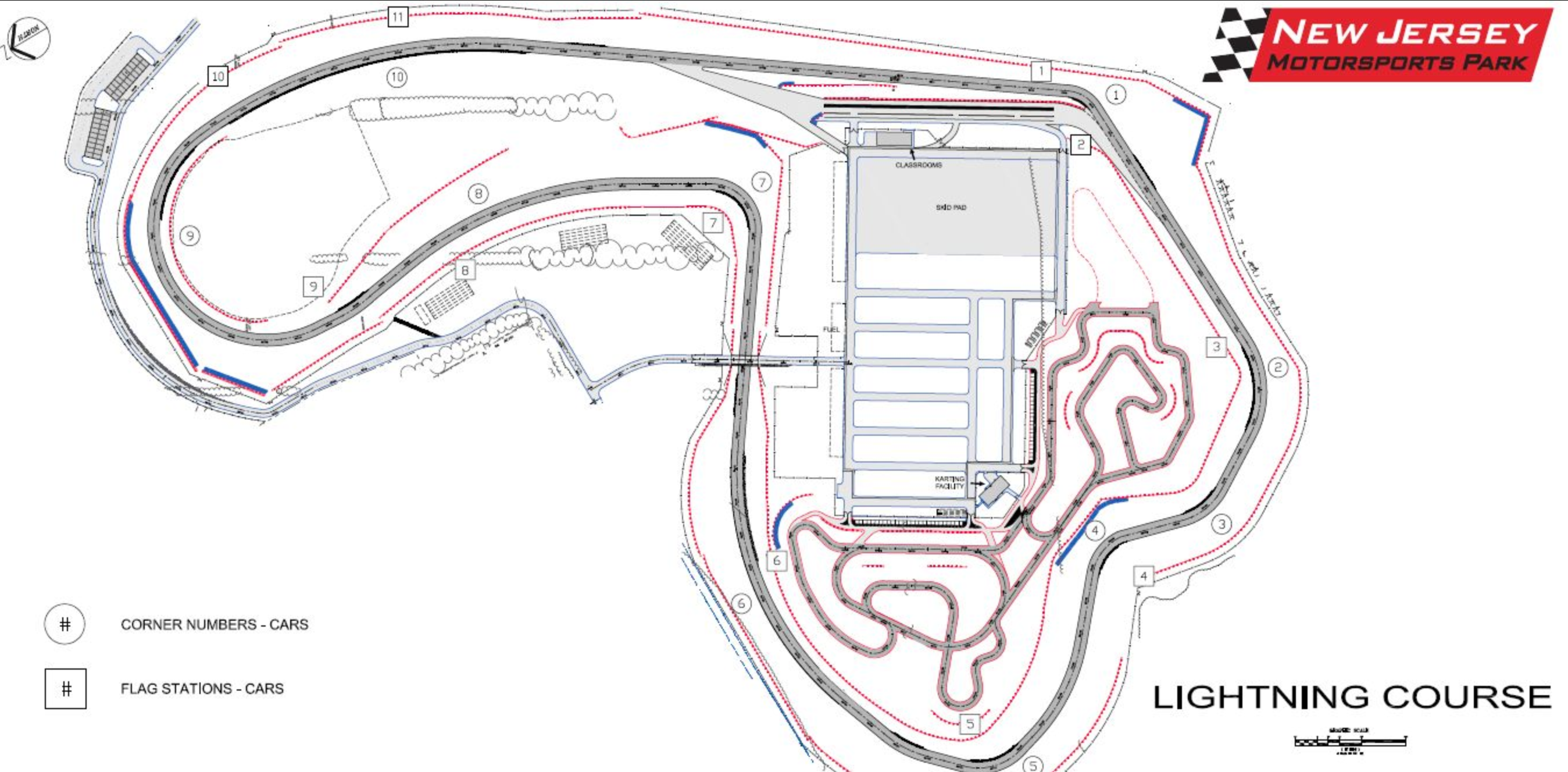

I am getting over-confident, driving over my skill level/experience. In so doing, I am also beating on the vehicle hardware. Specifically, I am killing the brakes doing hard ABS stops @ 130+ off the front straight and then destroying the tires going all out at turns 3-5 and again on 9.
