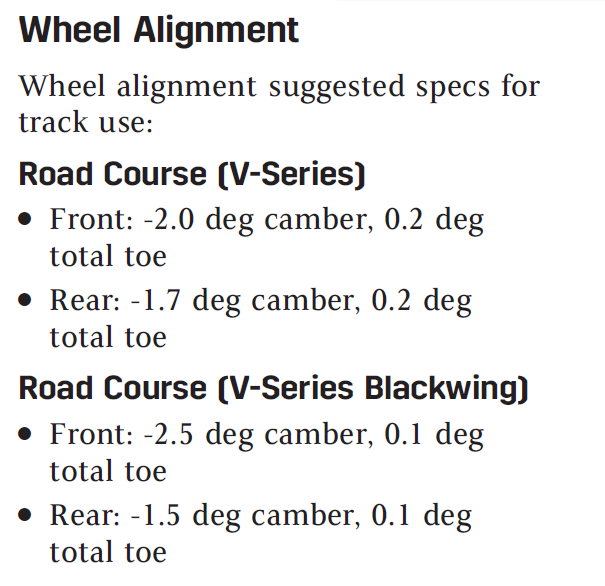

I saw a track alignment with -2.5 deg camber up front mentioned in one of the 5BW reviews. Does this car have have the cool track alignment rotating struts from its ZL1LE cousin or camber adjusted the old school way?
It has to be the old school way as the ZLEs are DSSV not magnetic. By the way, those DSSVs aren’t magic like they were portrayed to be. When you rotate them for camber, it throws the toe out so, you have to get an alignment.

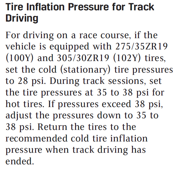

Just posting a few things here for future owners. This is out of the owners manual.

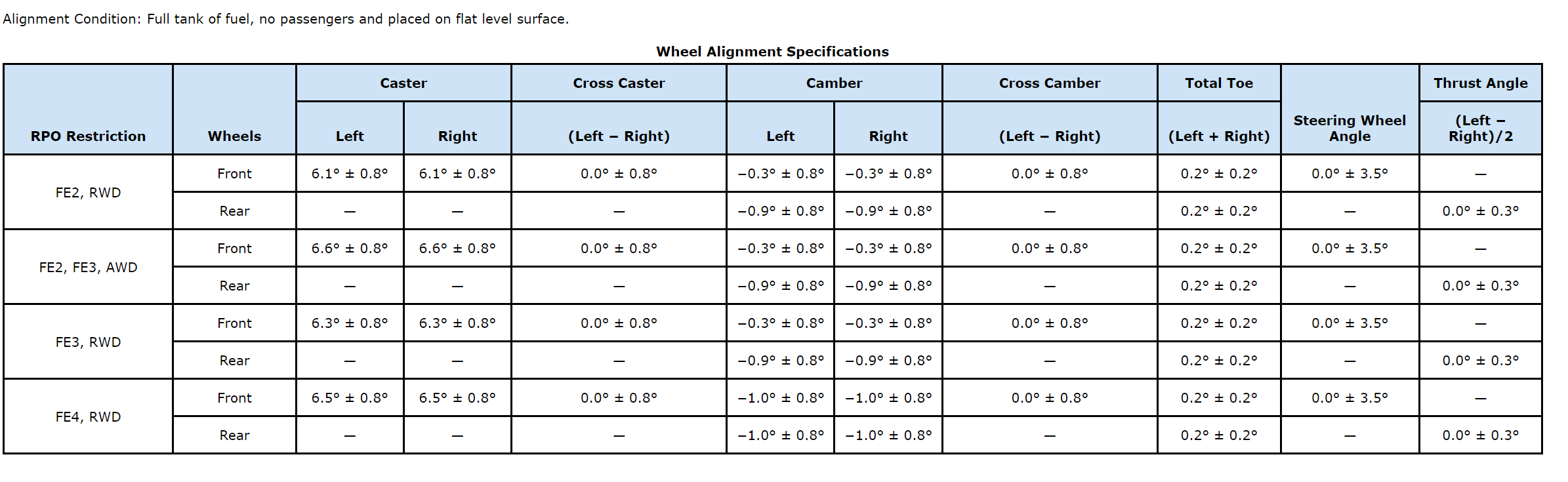

What are the street alignment specs for a 5BW?
Interesting. Mine will be a daily driver, I’m trying to decide a good aggressive street alignment spec. I may just do -1.5 front and stick with -1.0 rear.

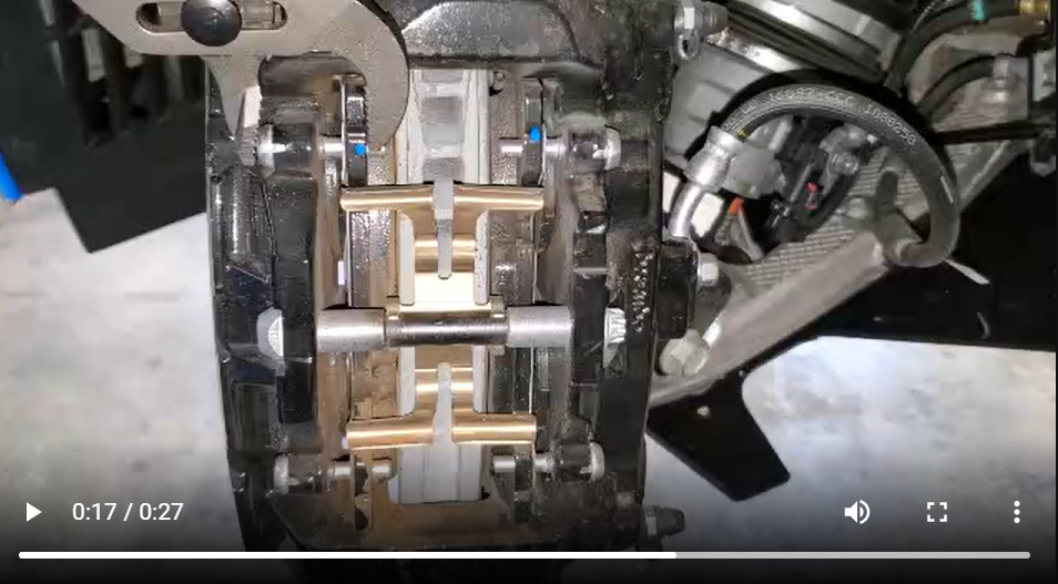

Here's another bizarre reference related to brake bleeding. This is under the section for J56 brakes which I can't find listed as an RPO in the order guide but at least on the C7 it was the non-CCB brakes. They get very specific about bleeding by compressing the pistons in a certain order multiple times. This is with a pressure bleeder on the system.
This is just an excerpt of the entire process and this is per caliper:
  1. Open the UPPER bleeder, allow fluid to flow for 10 seconds, close bleeder and repeat the step two more times before moving on.
  2. Reopen UPPER bleeder, use channel locks to quickly squeeze pad to caliper in locations by each piston beginning with Sequence A, then repeating with Sequence B:
  3. Sequence A:Beginning with the pad section furthest from the UPPER bleeder (2) and ending with the pad section nearest to the UPPER bleeder (2):
    1. Outboard leading piston
    2. Inboard leading piston
    3. Outboard trailing piston
    4. Inboard trailing piston
  4. Sequence B:Beginning with the pad section nearest to the UPPER bleeder (2) and ending with the pad section furthest from the UPPER bleeder (2):
    1. Inboard trailing piston
    2. Outboard trailing piston
    3. Inboard leading piston
    4. Outboard leading piston
  5. Use a rubber mallet to tap 3 times behind each piston and 3 times gently on the top and bottom of caliper.
  6. Close bleeder and wait 5 seconds to allow pressure to rebuild and pistons/pads to spread back out to rotor.
  7. Repeat step 18 four more times.
It even includes two videos showing the order to compress the pistons with channel locks.

do you have a link to the video? this seems like a lot of work to bleed the brakes and replace with better track fluid (I plan on castrol SRF).

That video you can only get to through the AC Delco TDS system. I don’t have the link to the site handy but you can pay $20 for a 3 day access pass.
