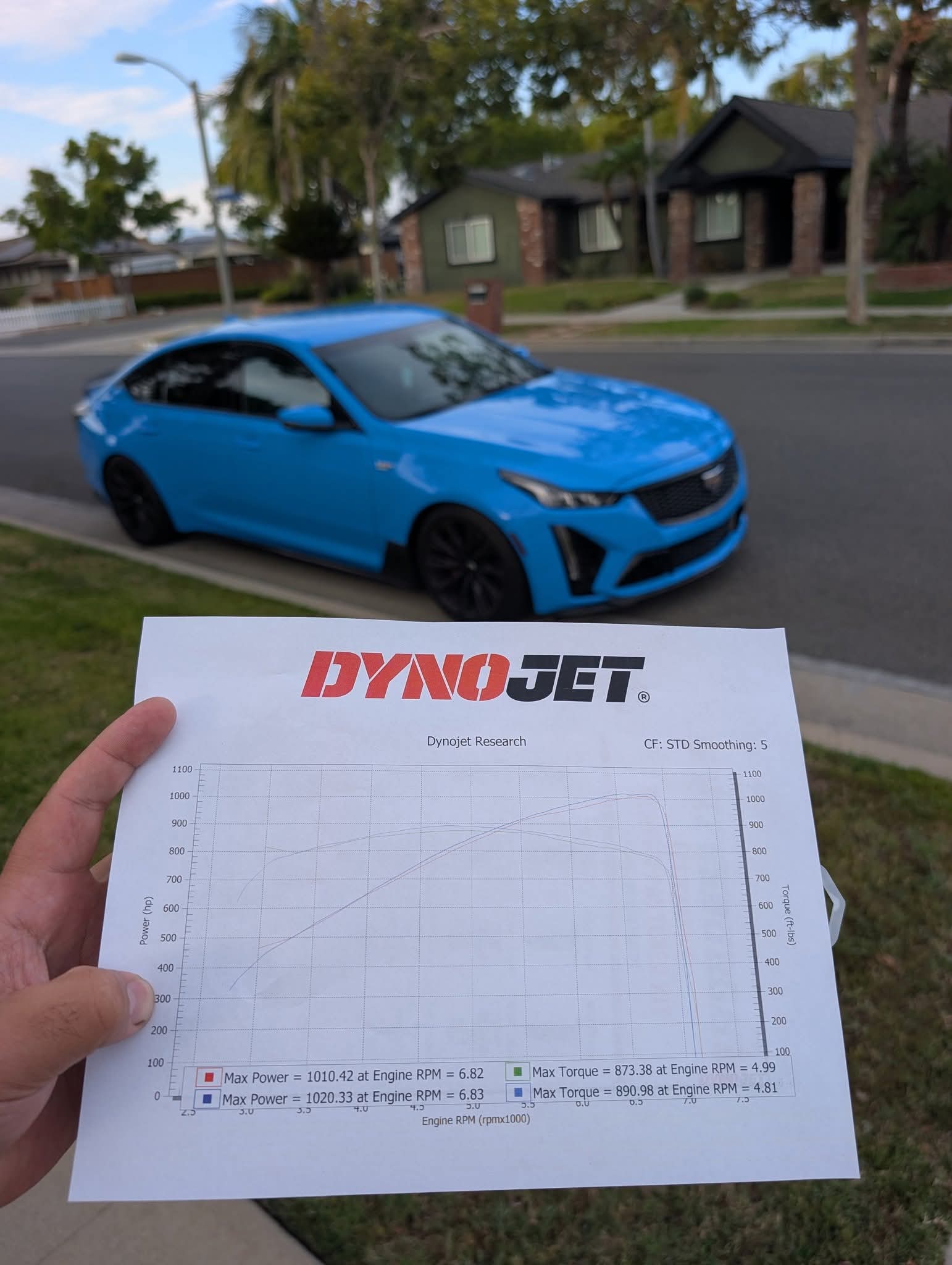

A few weeks ago I finished performance modding the 2023 CT5-V BW manual 6 speed to my liking (for now). Wanted to share my mod list and power #'s for others looking to go down this route.
Note: we are on a conservative tune and pulley setup; I didn't want to go more aggressive as I did not upgrade the bottom end when I started this journey. The car is running great, zero issues, as a daily. I'm considering an LTR long block so we can really spice it up as the next step (eventually).
Fuel: E85

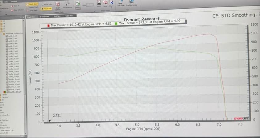

Max WHP - 1010 @ 6,820 RPM
Max TQ - 873 @ 4,990 RPM
Shop: Omni Motorsports in Anaheim, CA

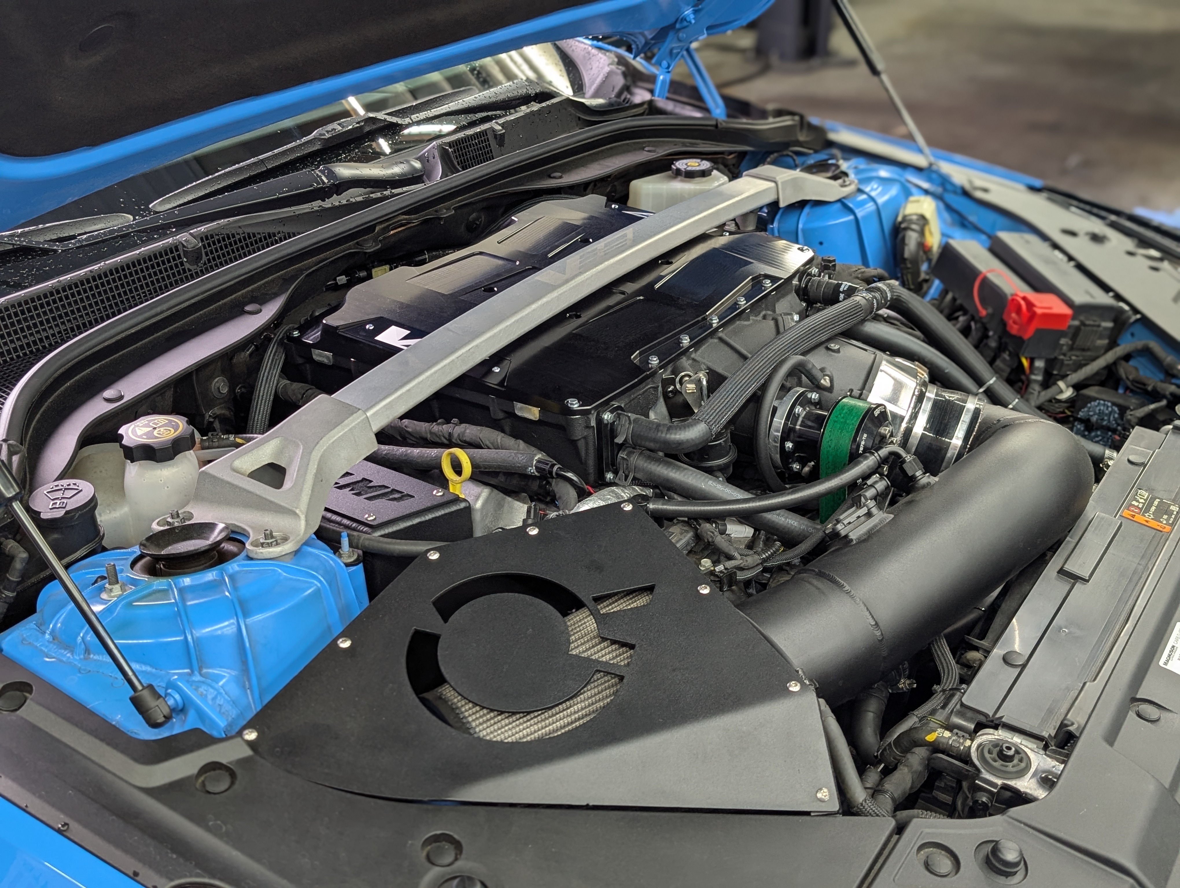

Here are the mods for those interested:
Suspension
  • SPL Toe Arms
  • Ferodo DS2500 Brake Pads
Engine
  • Cordes Cold Air Intake
  • Custom Cam Motion Cam kit
  • Kooks headers with Green cats
  • DOD delete
  • LME LT4 head porting
  • Ngk Spark plugs
  • Gates belt
  • NW103 Lt Throttle Body
  • OMS flex kit
  • Aux pump
  • ATI balancer
  • DSX lower pulley
  • LME Billet VVT delete front cover
  • TooHighPsi reflex controller
  • TooHighPsi billet plates
  • FIC 1000cc injectors
  • Lmp black wing heat exchanger
  • LMP black wing hx expansion tank
  • LMP Catch can
  • Motion raceworks valve cover fittings
  • Magnuson 2650
  • Toohighpsi 2650 Billet Lid
  • Kong x-port

@LF Audio, how's the LMP catch can workong out, is it pulling out any "sludge"? It was going to be my first mod just to help keep things clean. Looks good in there.
