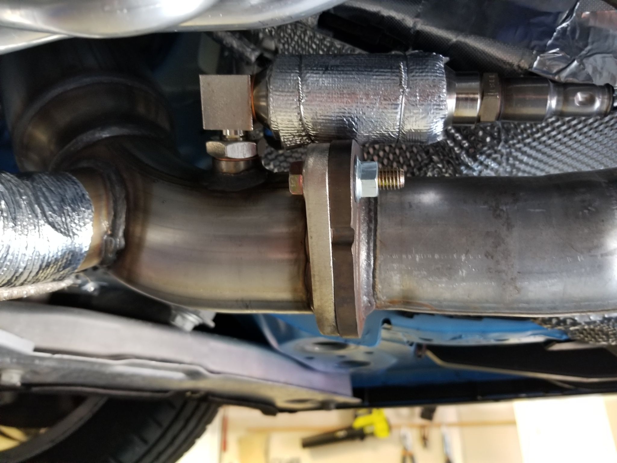

Took me about 2 hours of touch time. Maybe an hour or so of figuring out how to do things. I had to order some wobble/swivel impact sockets. Both deep and shallow in 3/8th's. Unplugging the primary o2's was probably the hardest part.

You'll want those swivel impact sockets, a couple ~10" extensions, a 2-3' pry bar, a good headlamp or magnetic flashlight and a deep and shallow 15mm socket. Every bolt you touch is pretty much a 15mm. A few 13mm's on a bracket that holds the 2 stock downpipes.
No tune is required for downpipes. The resonated ones will set Check Engine light, which you can address by using oxygen sensor spacers or our new DTC Assassin product.

Without tuning, boost will remain the same as before, since our boost is controlled by the ECM. Aftermarket downpipes alone make very little performance difference on LF4 engines, and they definitely won't harm the turbos in any way.
Where these downpipes really shine is by making your exhaust sound louder, meaner and better than it already does. Our resonated pipes can be rowdy in Track mode with the active exhaust valves open. In Touring mode with the valves closed, you’ll barely notice a difference. The EPA Catted option still improves the sound quality and raises volume over stock, but by approximately half as much.

@strohw The spacers are on there right now. These are pretty fancy versions though. No check lights yet.

Wow! The deecel pop's and bangs you usually hear during no lift is way more prominent sounding with those downpipes. Brutal sounding, in a good way of course
With the vales open, it cracks hard between gears. If only I had an exhaust mic haha
