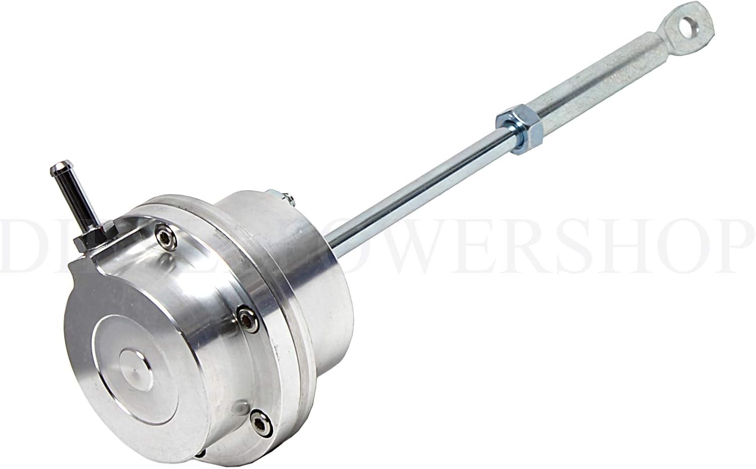

And your 100% it’s that exact part making the noise vs the TB? It’s my understanding that even when in service mode, the only part that moves is the TB. Not the WG.
You can see the arm move on the wastegate aligned with the noise. Here is a picture of a wastegate and it's arm.
The arm clearly moved during diagnostic startup. The TB is under the intercoolers, your have to remove the top of the engine to see them.
Photo of a sample wastegate attached.

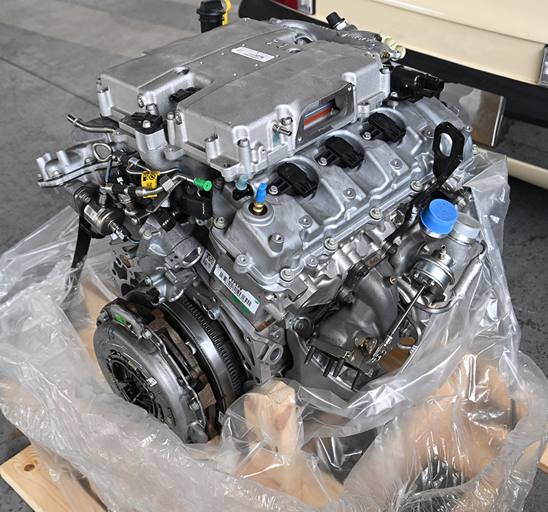

LF4 engine, you can see passenger side wastegate in this photo:

Let us know what the dealer does. I am editing my response as I learn more. The Arm and "bell" that I am showing in the pictures is the wastegate ACTUATOR and arm for an internal wastegate in the turbo. Now, with this being said, it is entirely possible that the wastegate within the turbo, is the problem. Which would explain why they replaced turbos for some people.
Ok, I don't want to act like a mechanic, I am really just an owner solutioning. Either way, my videos do show the noise coming when the actuator arm moves, whether the noise is from the actuator arm and bell, or from the actual wastegate itself inside the turbo who knows. Report back your findings!
