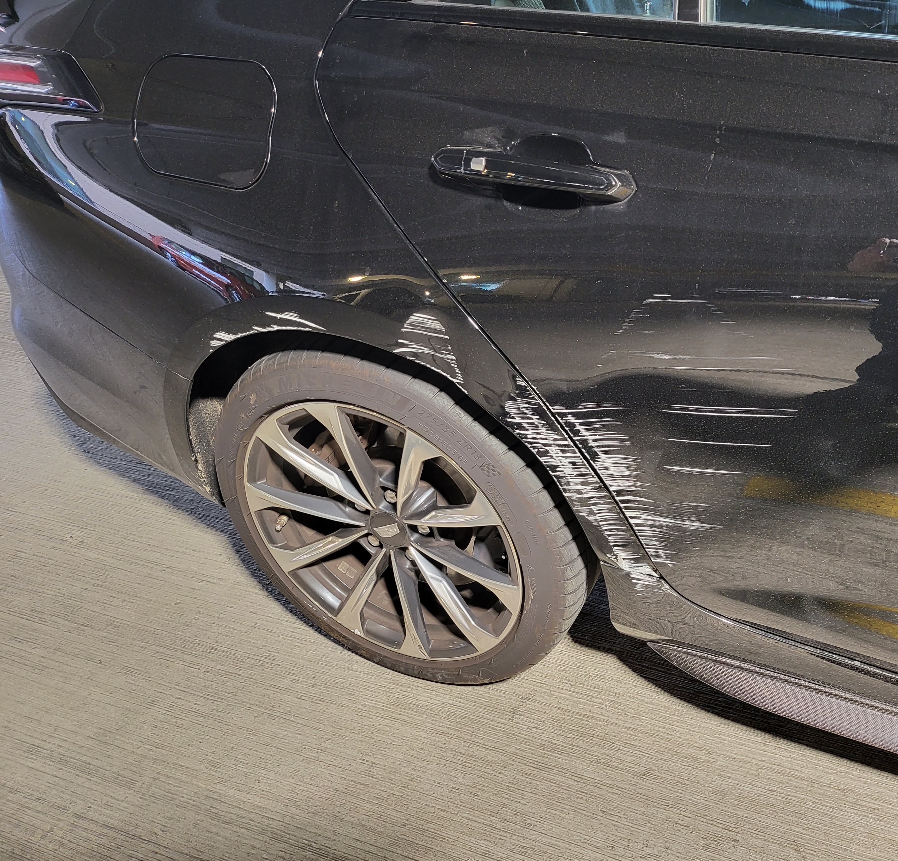

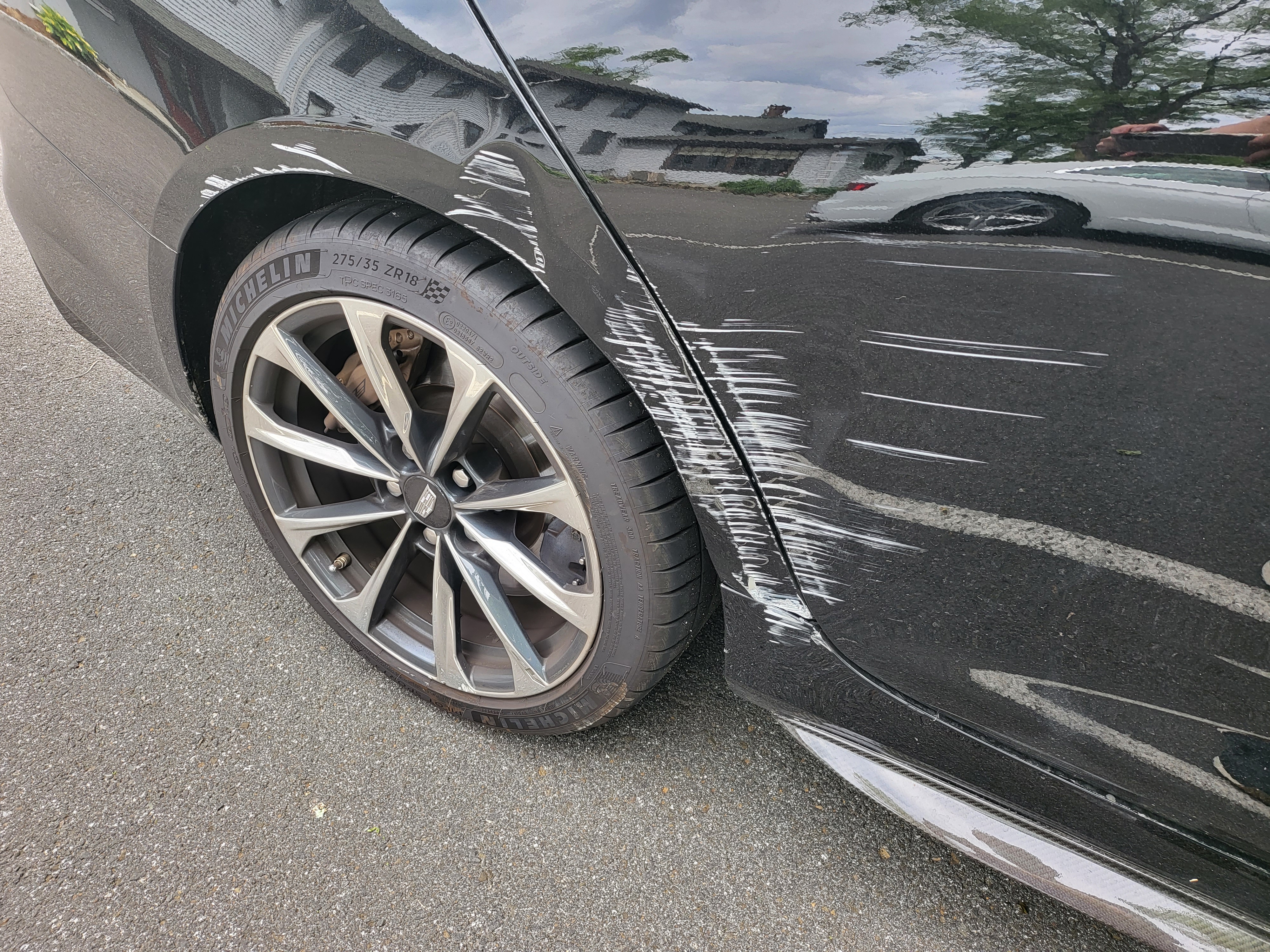

I'm gutted right now. My parking garage has a horrible 2 way traffic design which often results in near accidents with people not giving enough space. Yesterday when driving up, a driver zoomed around the corner, which caused me to turn in to avoid, and I side swiped a concrete pillar going around the corner. The damage looks pretty bad, the rear fender in particular. I haven't needed auto body repair before, so I'm not sure where to go from here. Should I contact insurance, the dealership, or try to find some independent shop and get a quote? Pictures NSFW

Good to know, I'll leave it alone for now. Anybody have any clue if bent metal like that on the quarter panel will be repairable, or do you think it will need to be replaced?
When you get a crunch in a creased edge area, it's much harder to repair and make look perfect (you don't want anything less). I'd suspect qp replacement would be done.
If metal is there it can be pulled and reworked. Being that this is a door from a standard Cadillac ct4, they'll likely get a new panel. My gf's 2017 civic got t boned at 15mph and they just went ahead and replaced the whole door, quoted insurance about 1400 for the door itself if Irecall correctly so actual cost was likely decently lower. For that that looks like, they would probably replace the door and rocker and repair the fender by pulling it straight and a bit of Bondo. They'd then blend the fender and paint the door /rocker as those would like arrive just primed. Being black and not metallic makes it a bit easier to get looking right in my opinion too.

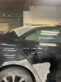

A little update for you guys. I finally was able to bring it to a well reviewed auto body shop in the area. They quoted me 3,500 for repairs, no replacement needed for the rear quarter panel or door. I'm gonna be bringing it there on Wednesday with an estimated repair time of 1.5 weeks. The rear quarter panel and door are steel, had they been aluminum, repair wouldn't have been possible, and it's apparently a really severe job due to needing to un-weld the rear quarter panel and weld a new one on, so I'm really glad he says he can repair and repaint it. I will not be going through my insurance despite having a 500$ deductible for obvious reasons.

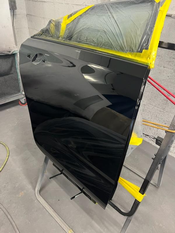

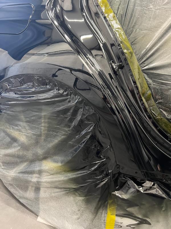

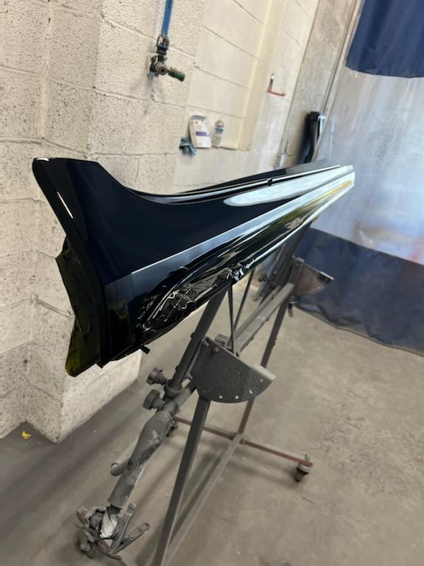

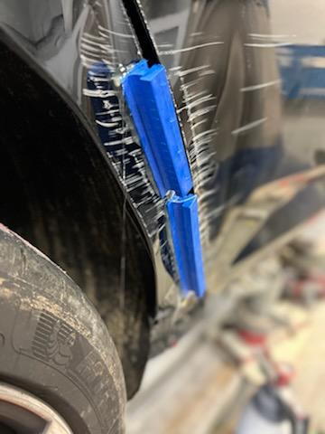

Thought I would update you guys, the body shop repaired the panels, no replacement was necessary. They sent me pictures of the process along the way, $3500 in total. I'm very happy with the results!
Here's a before and after
View attachment 10027View attachment 10028View attachment 10030View attachment 10031View attachment 10032

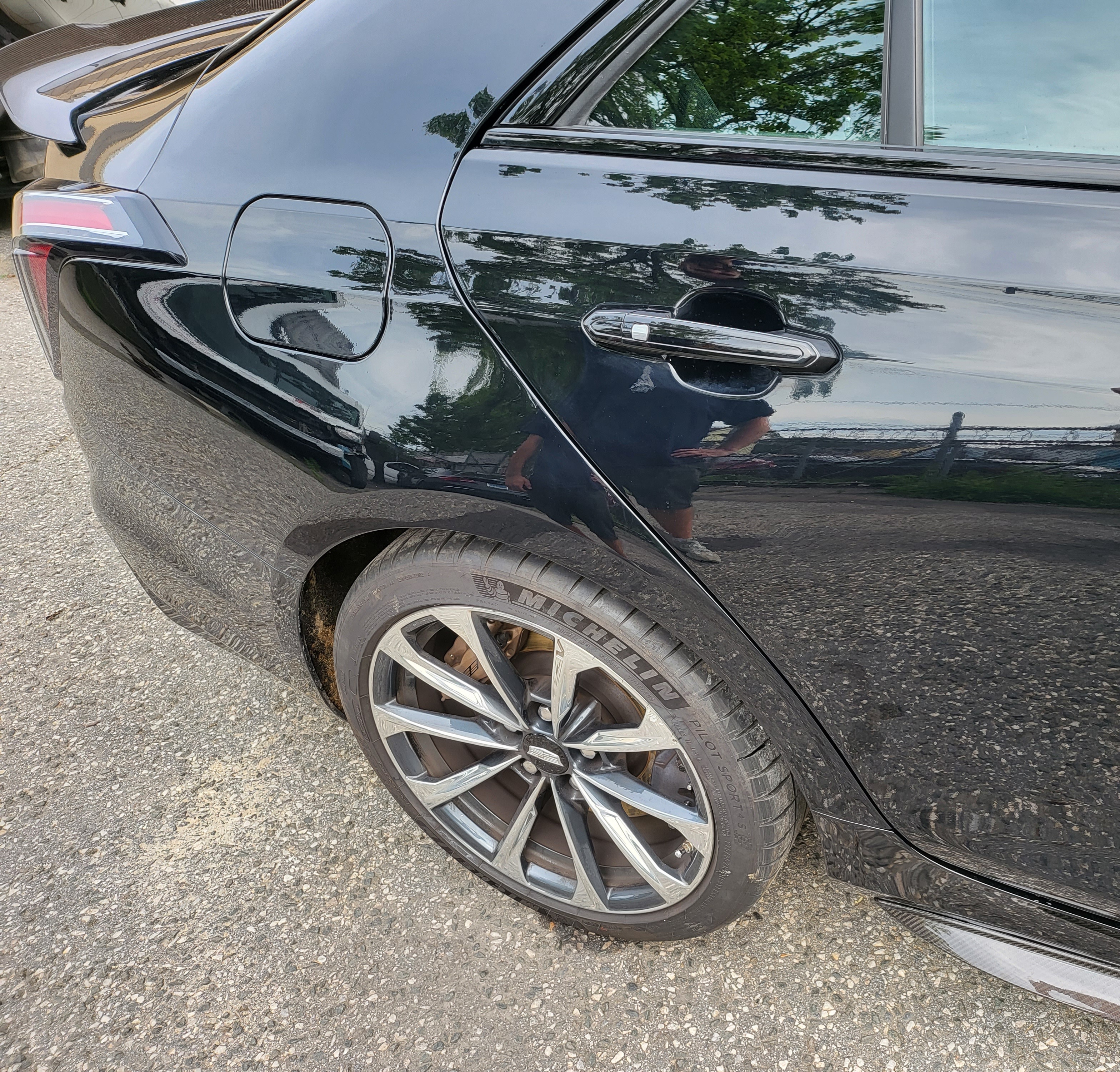

View attachment 10033View attachment 10034
Sorry to see this brother, sucks, glad you have a good shop repairing this. You'll never know it even happened.
